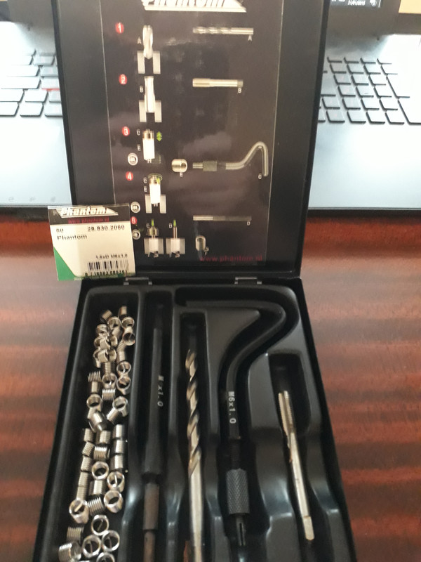

I also did replace some helicoils for my tiger 1.
I have a set from the brand Phantom size 1,5-D M6-1,0
If you buy a set the tools to place the coils are included.
I will post a picture later in the afternoon.
Best regards Yves

Hello Simon,
Here is the picture of the Phantom set coils.
Best regards Yves

Hi Yves,
Thanks for the reply. Did the Phantom helicoils fit without having to re-tap the existing holes? Do you have a source for them as I couldn't find after a quick search.

by yves mouton
Hello Simon,
You can take out the helicoil with a narrow pliers,
and if necessary you can re-dril the hole, but normaly if you can take out the helicoil
you dont need to re-drill.
The Phantom set i bought in my country: Belgium and the company name is Tollenaere.
Best regards Yves
