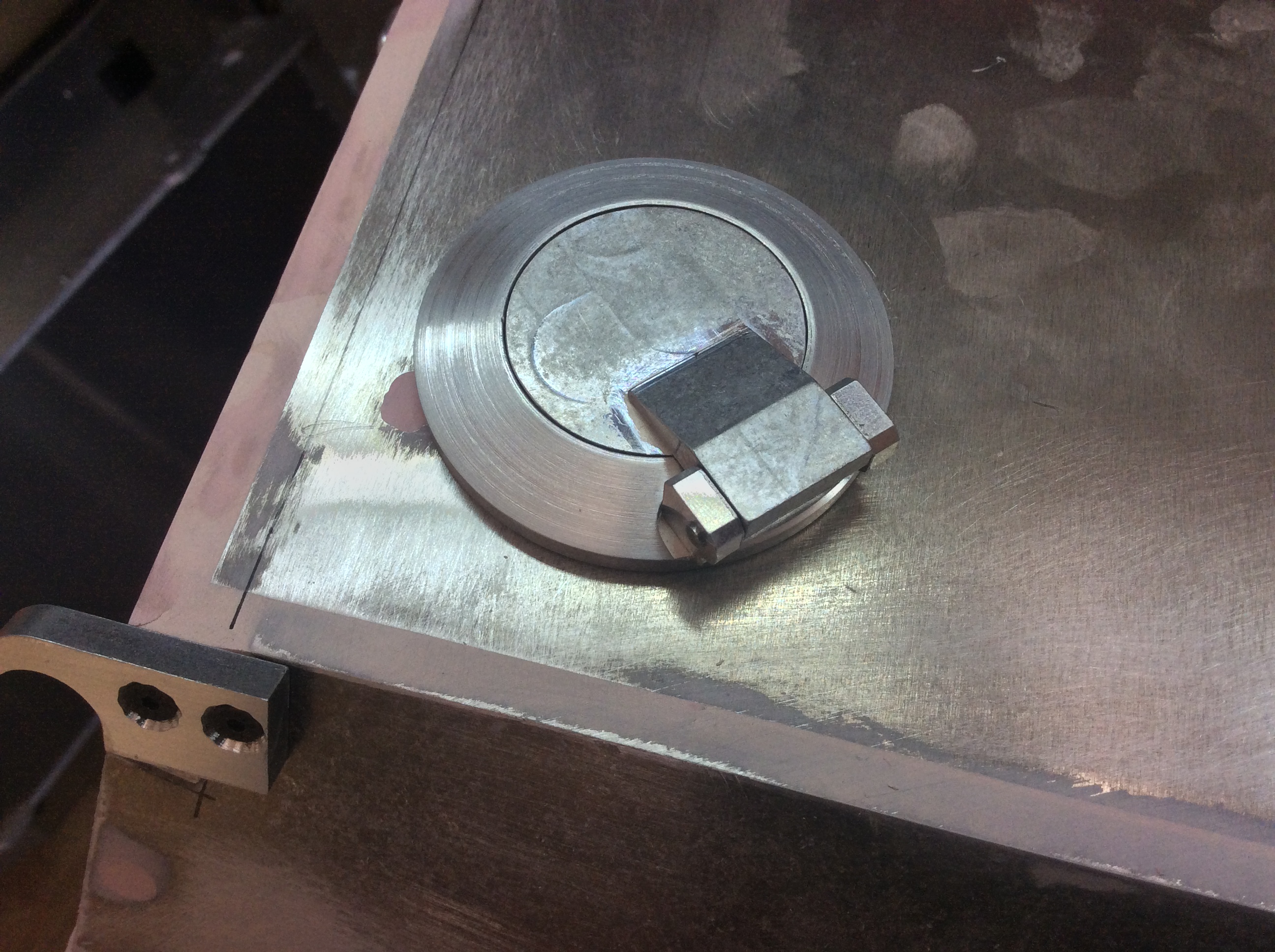

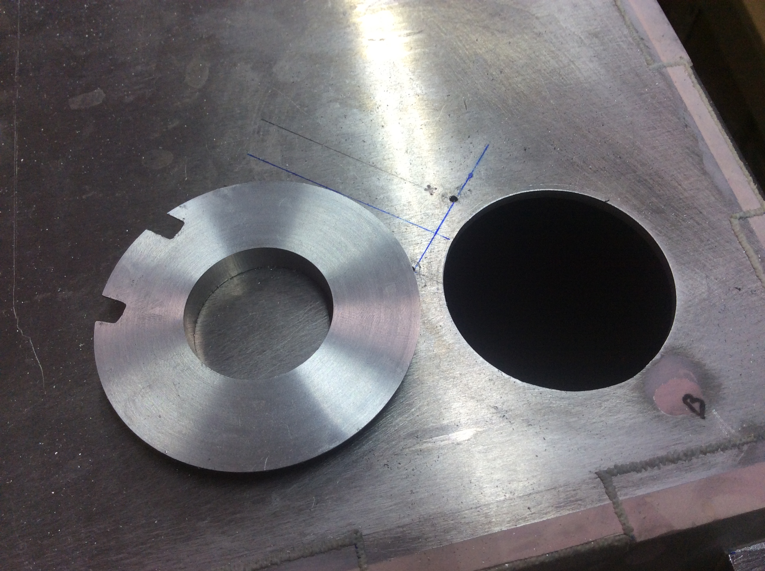

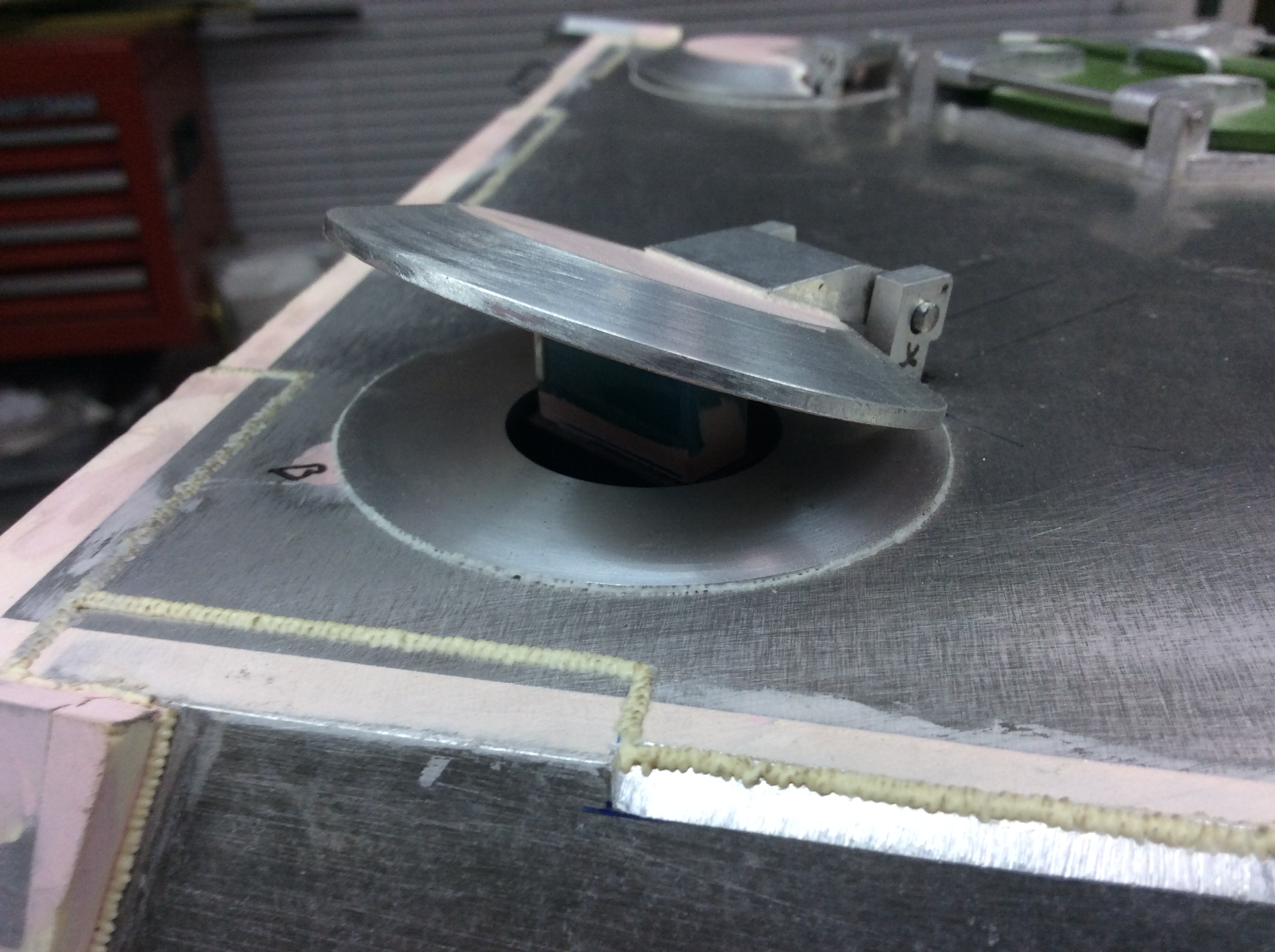

One of the first things we check was that the rear sight covers are not accurrate, so we correct this re working the original pieces with the lathe and filling the gaps with automotive filler... May be the pictures are not in a correct secuence, sorry... :wink:

Told you, the images are not in order, excuse me, the last ones shows how this pieces comes originaly, the next ones show the final result, by the way the big piece betwen the cover and the roof was turn in aluminium

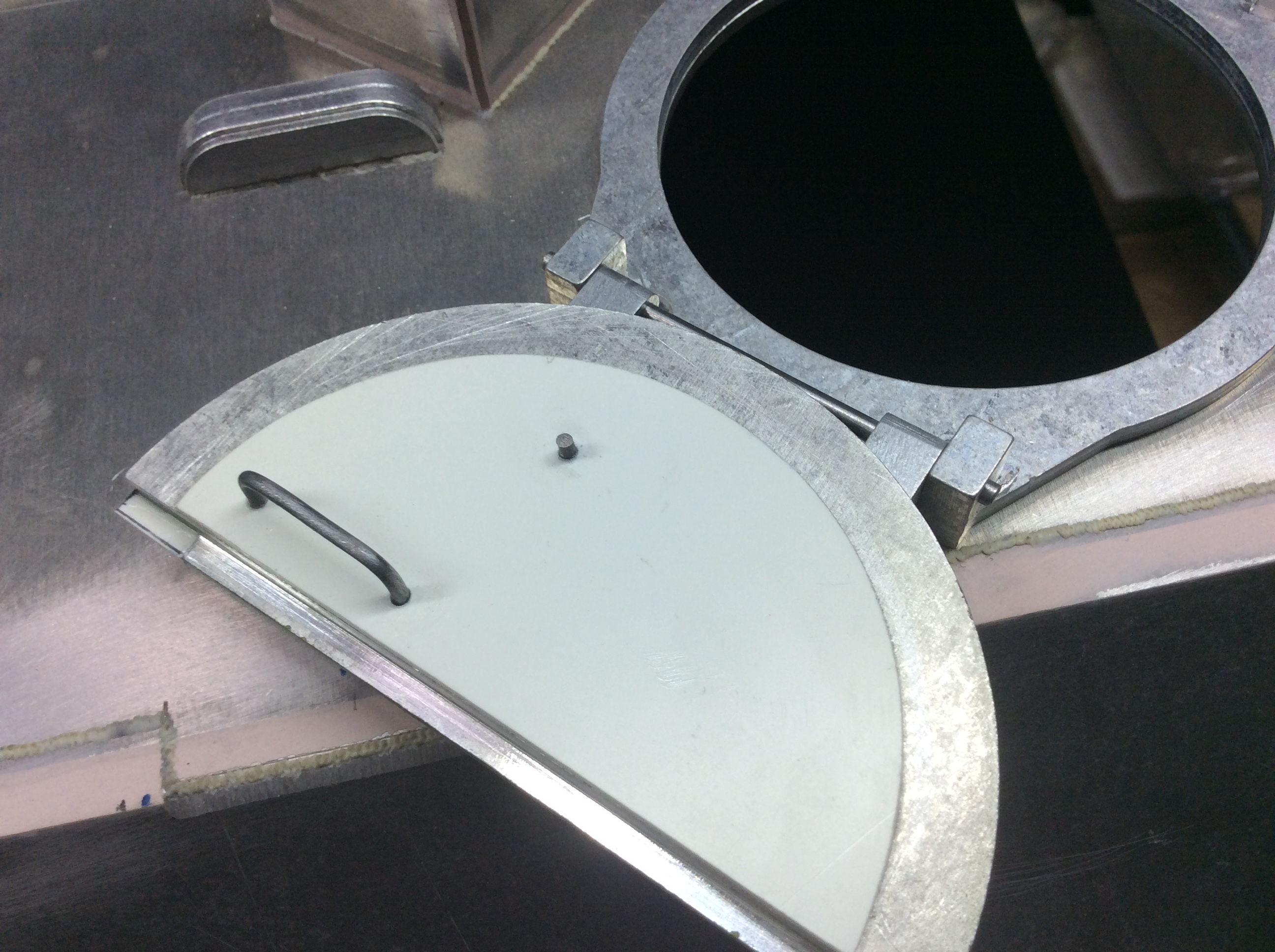

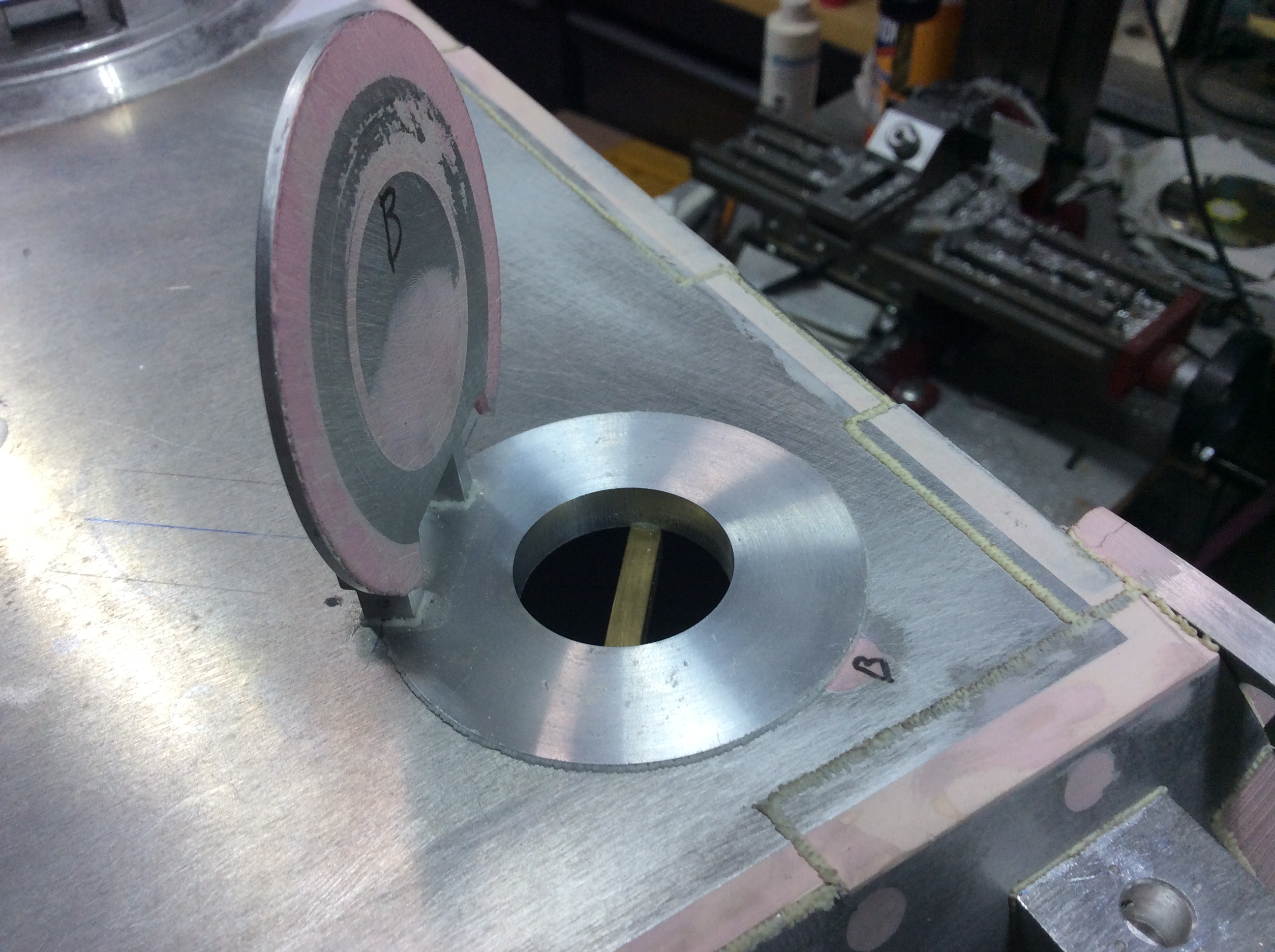

We like to hide all the screws that not exist in the real thing, so they are changed to be covered with filler, also we make details missing in the loader and commander hatches...

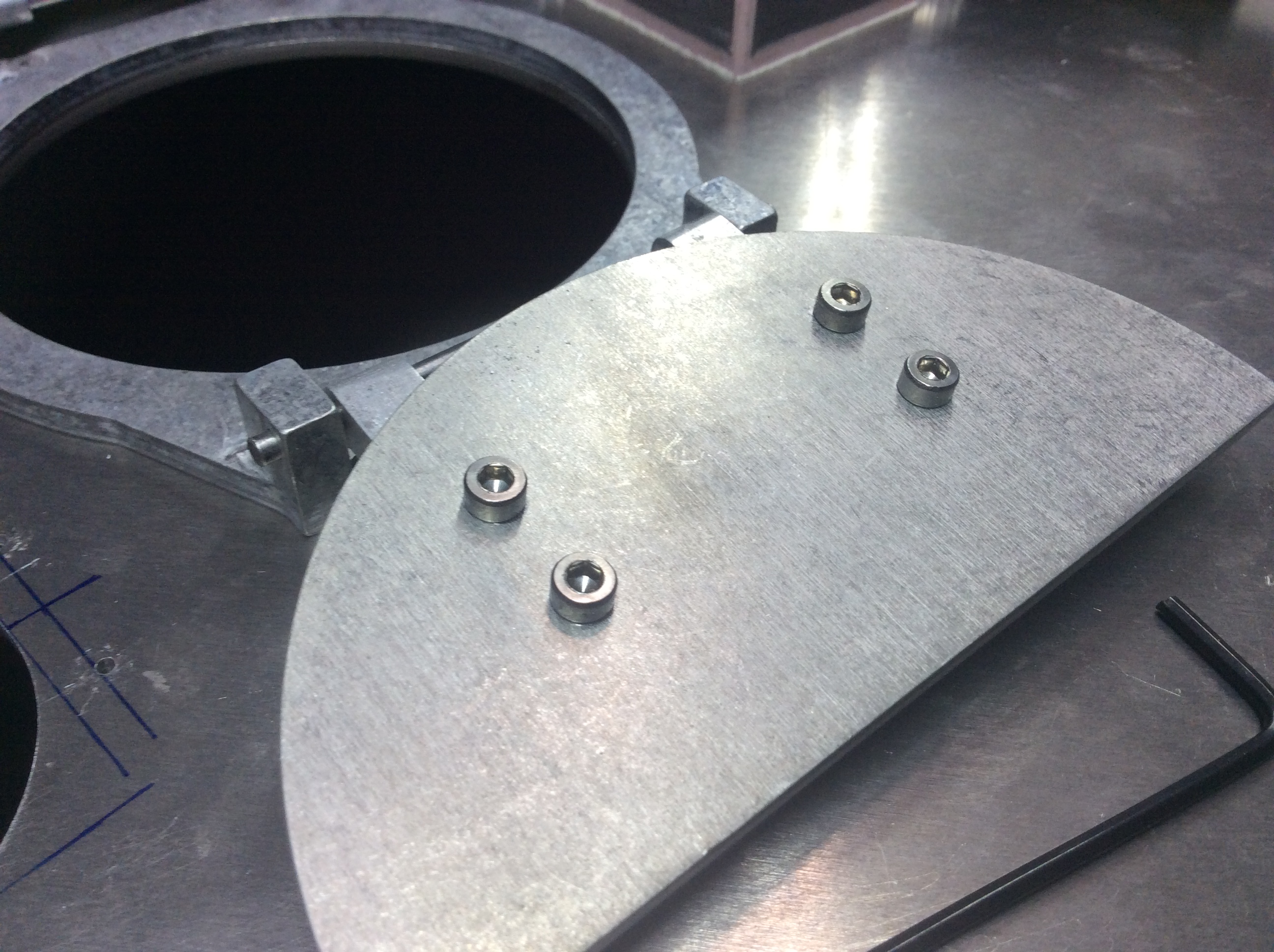

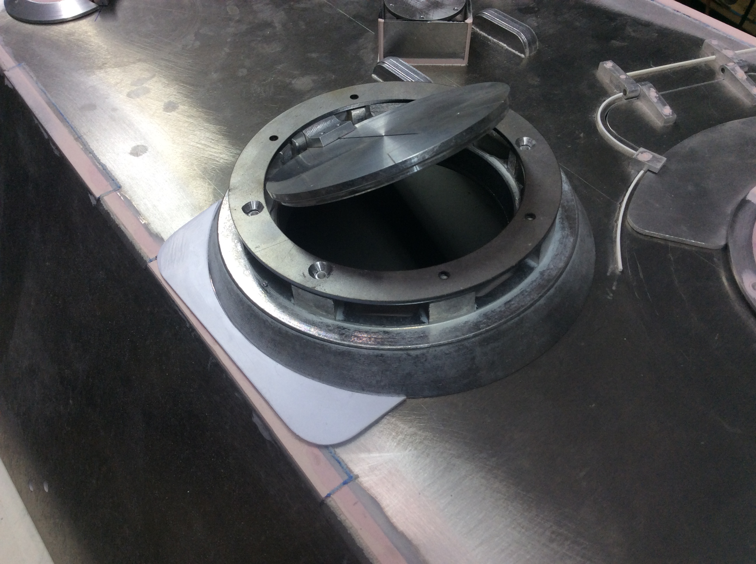

Example of how to hide screws, how the kit screws are provided and the replacements

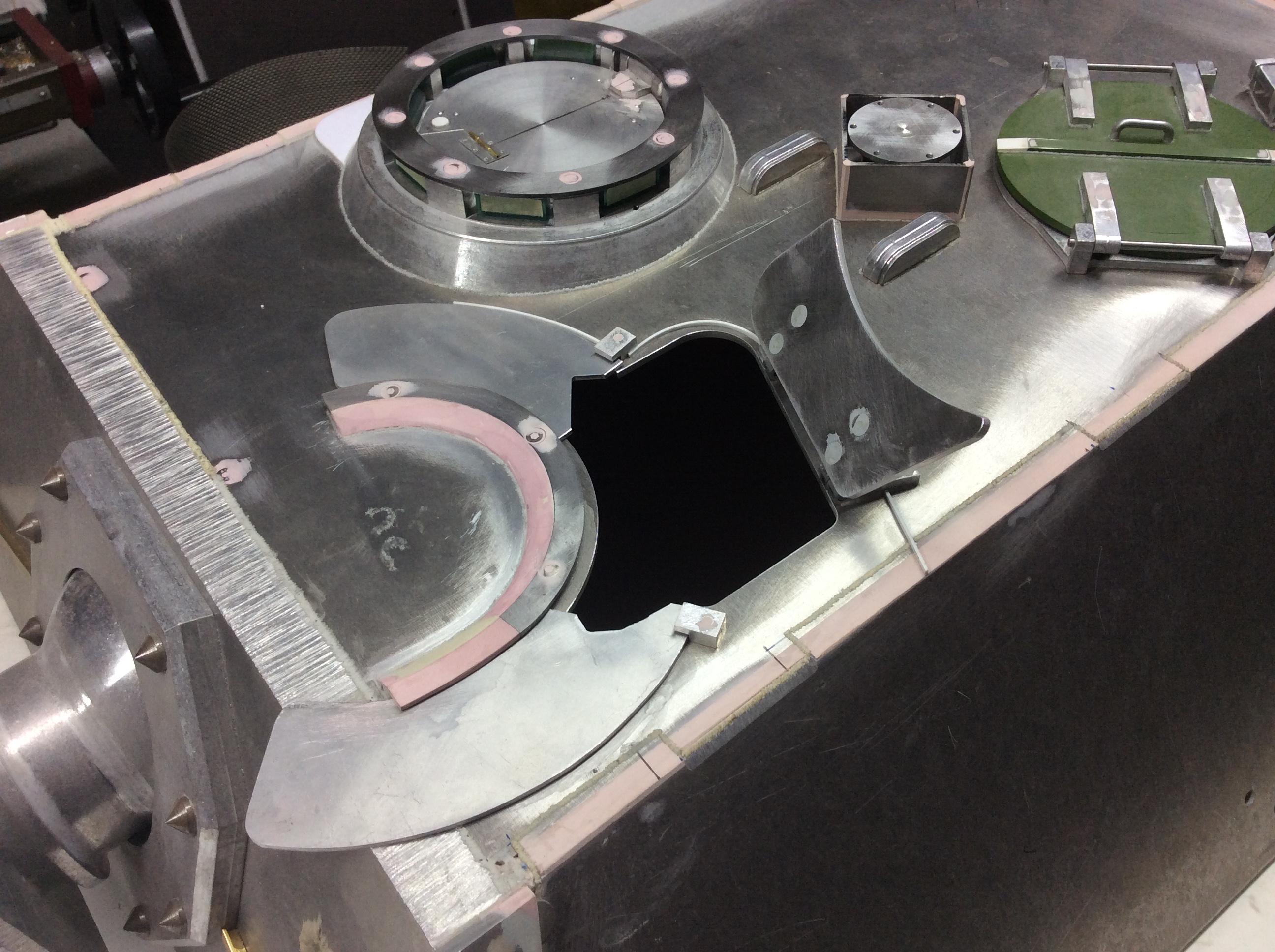

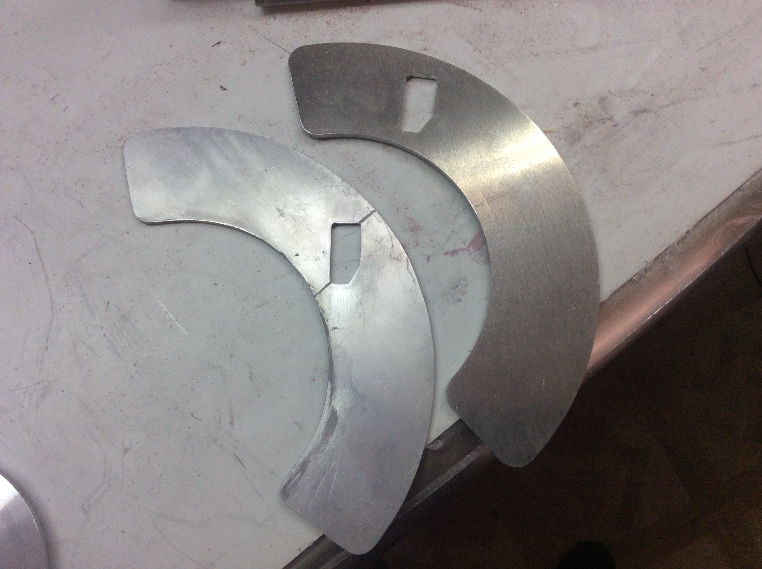

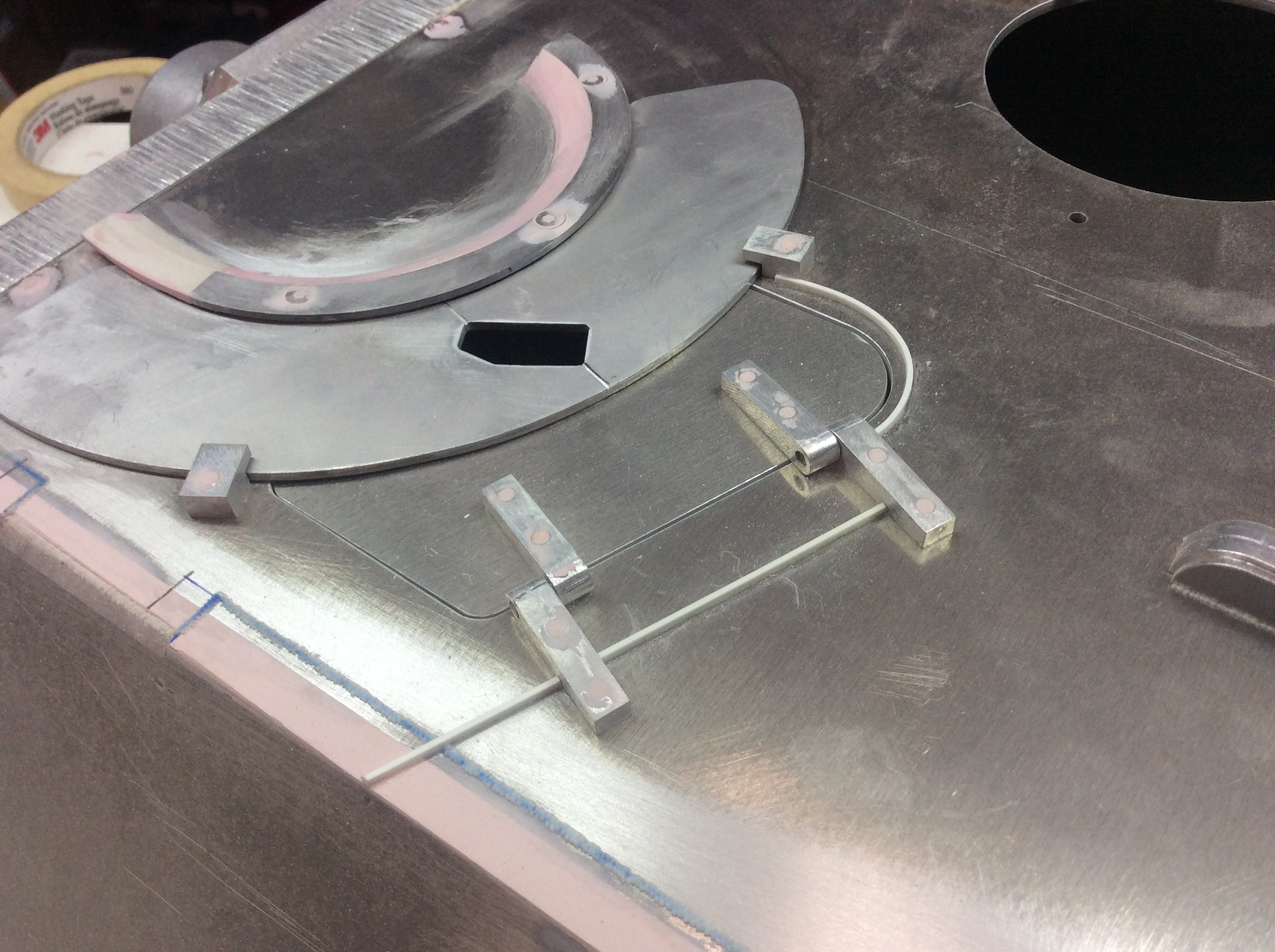

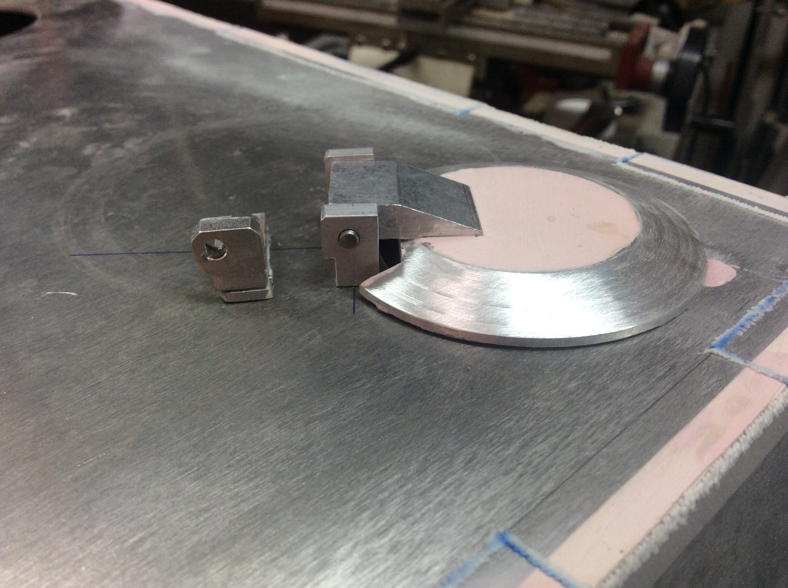

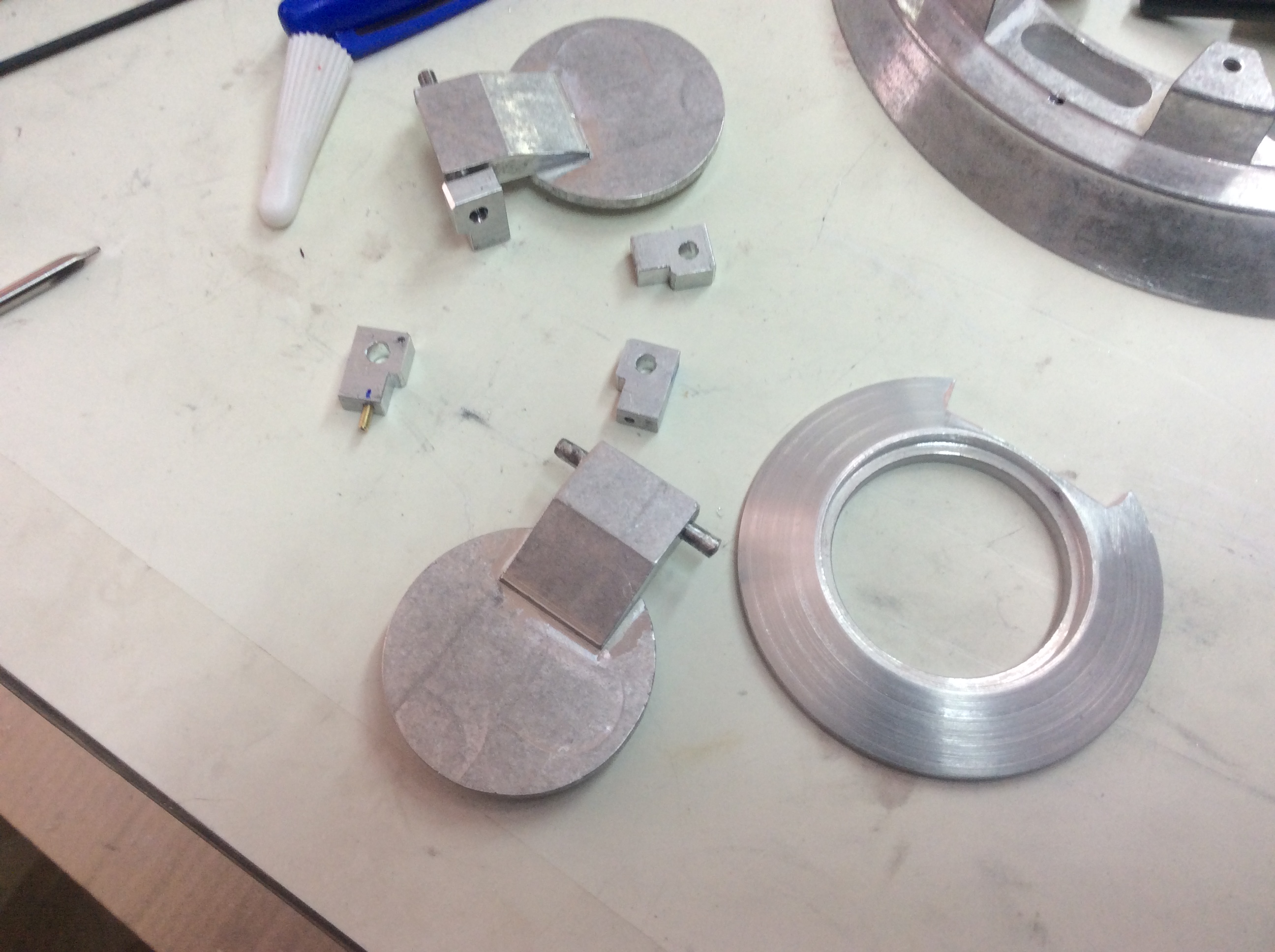

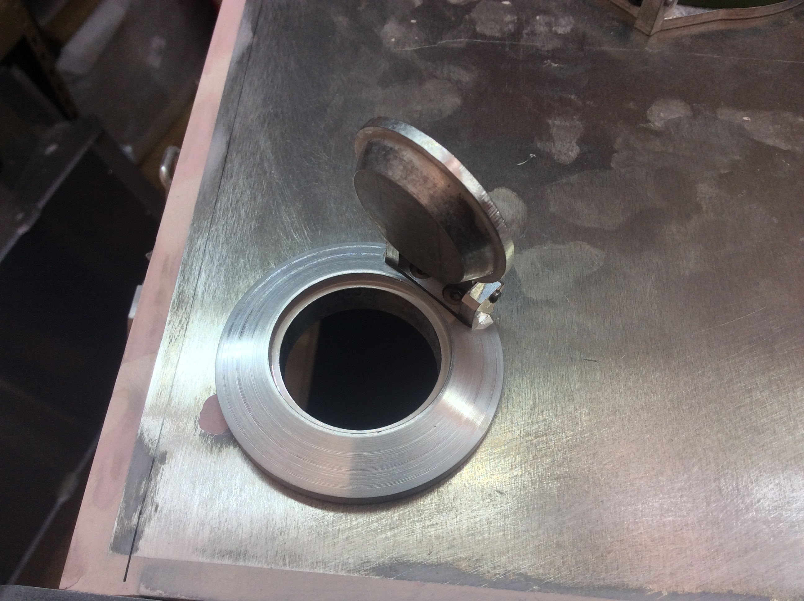

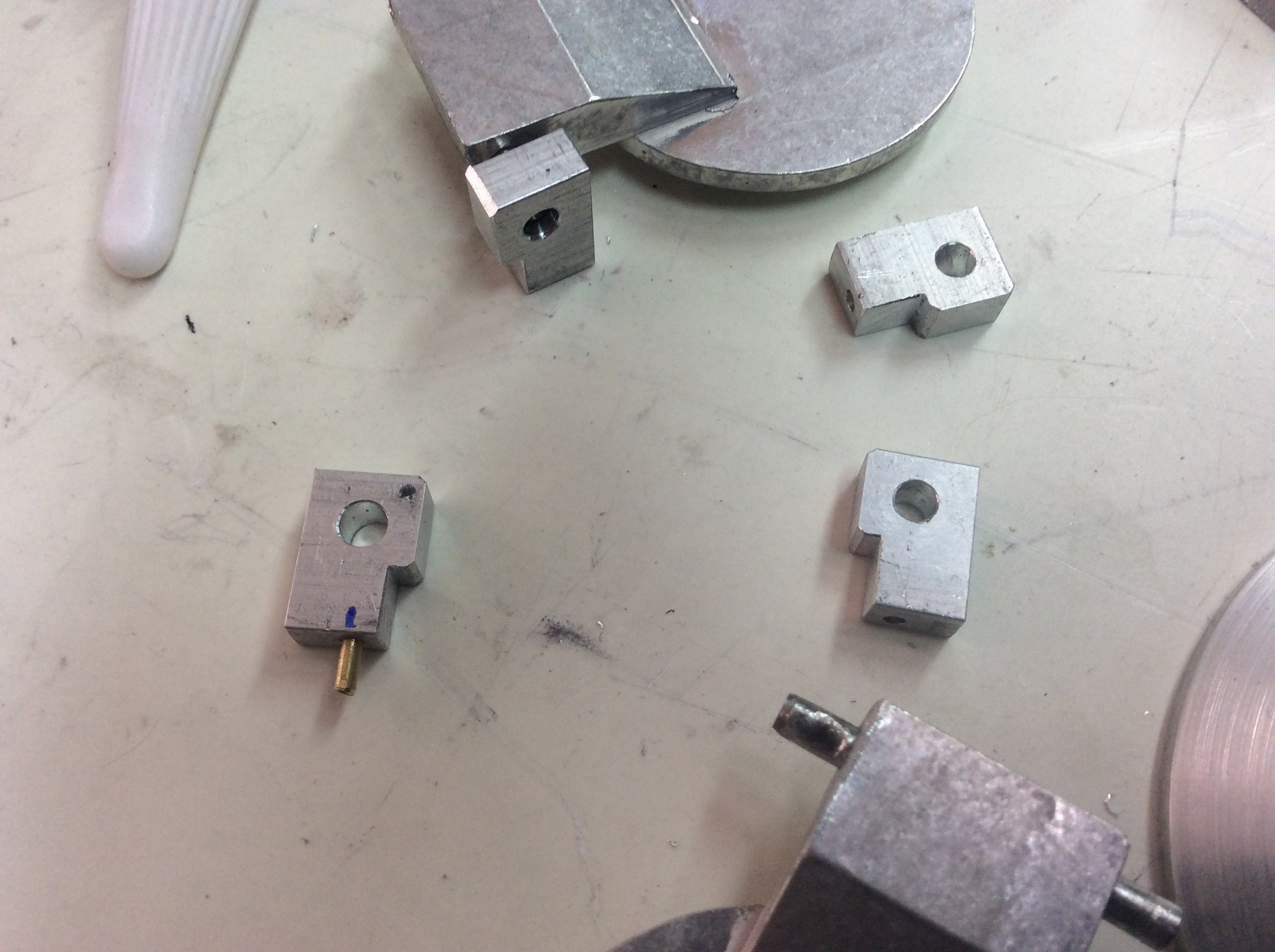

We remake the sliding cover for sight, to correct the posición of the hole for the sight and we make it in two pieces to allow open the gunner’s hatch... sorry I don’ know why the pictures do not show in the correct sequence

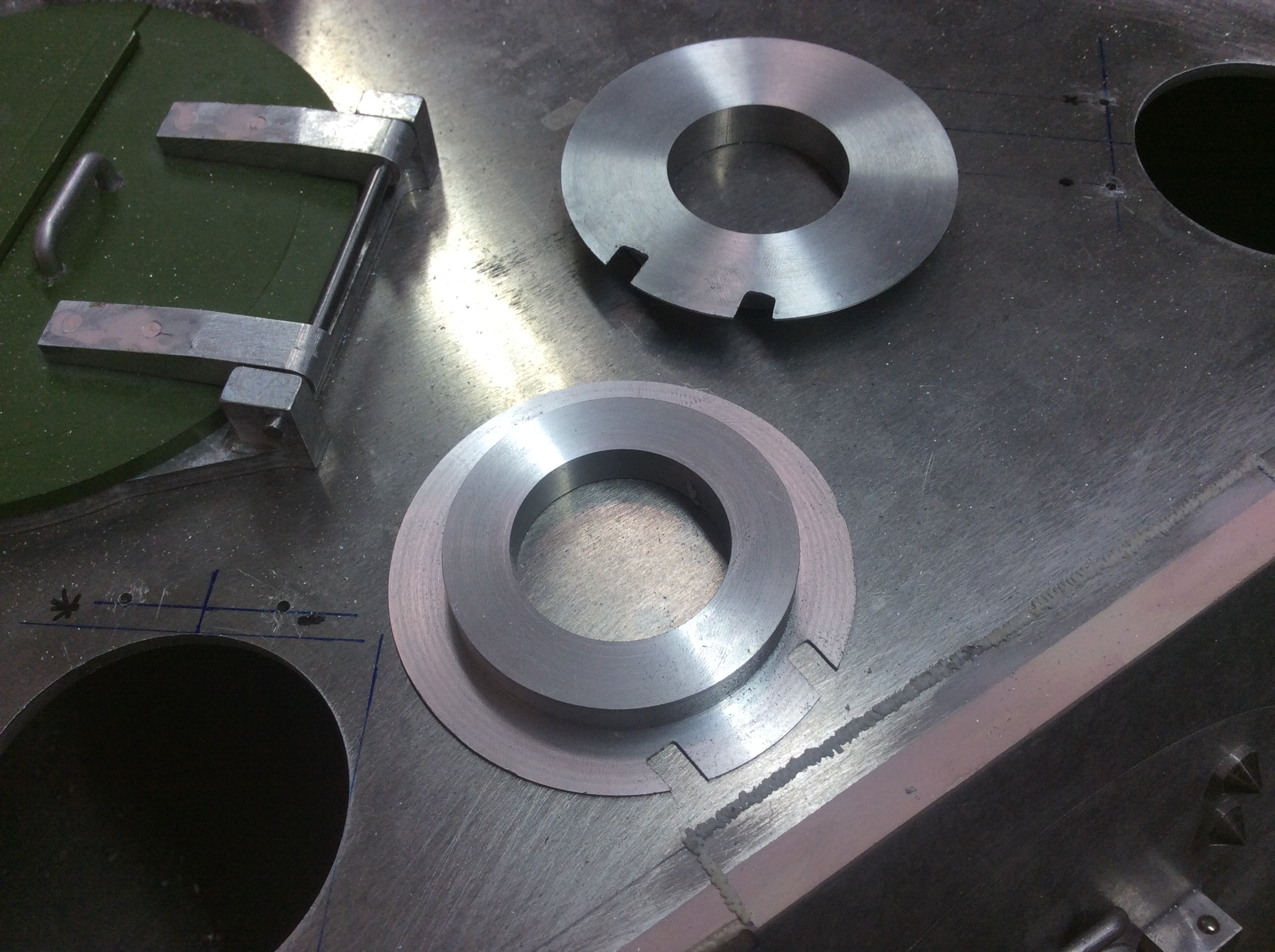

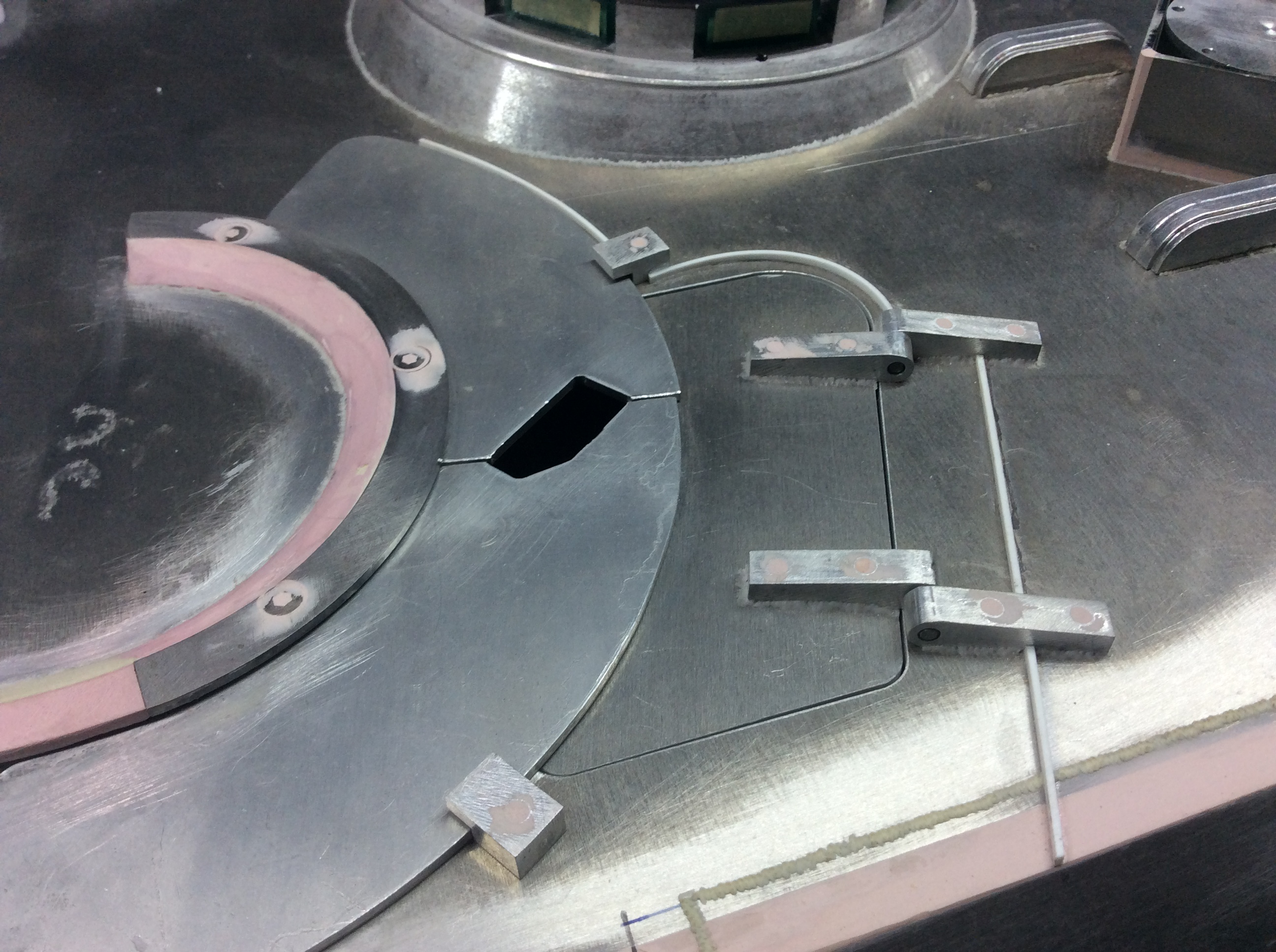

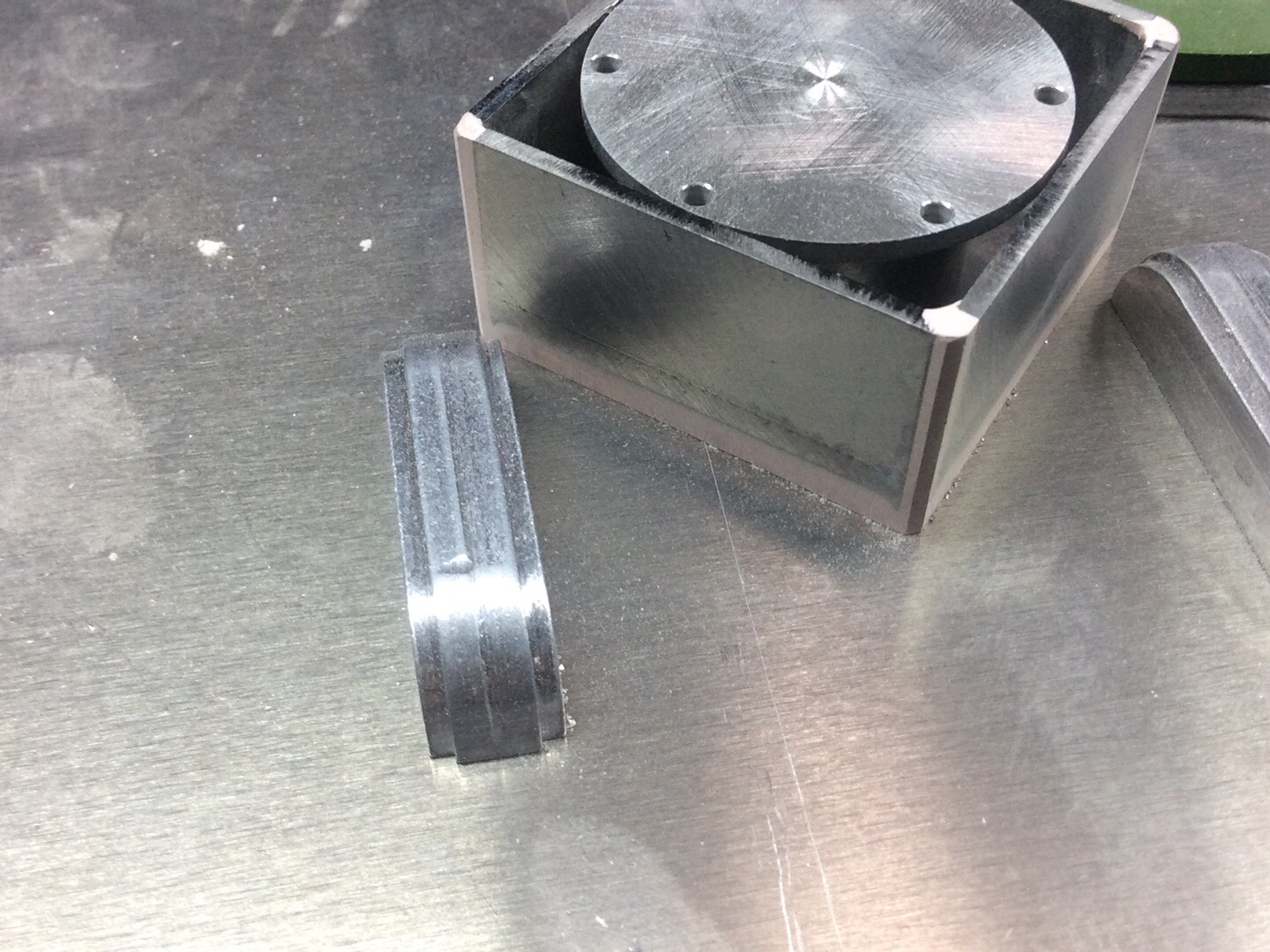

The sliding cover rail was reworked to get the proper shape and size
Rain gutters was added

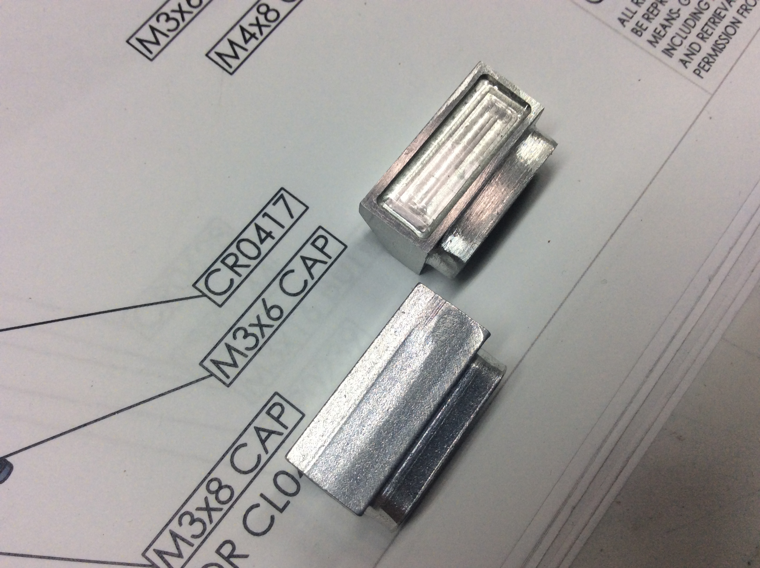

We rework one of the sights to make a mold and cast all the sights in clear Blue and green poliurethane resin...
