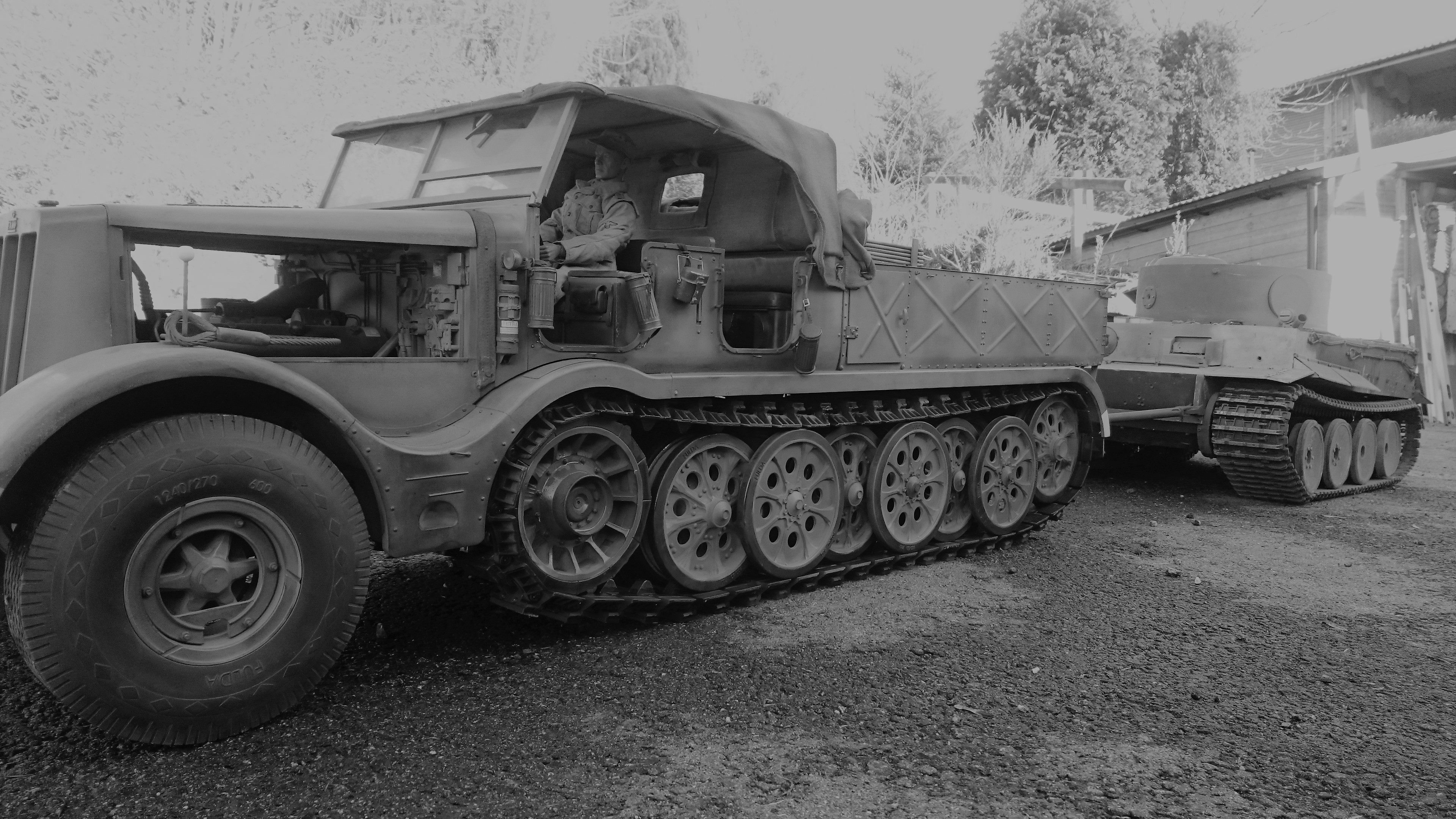

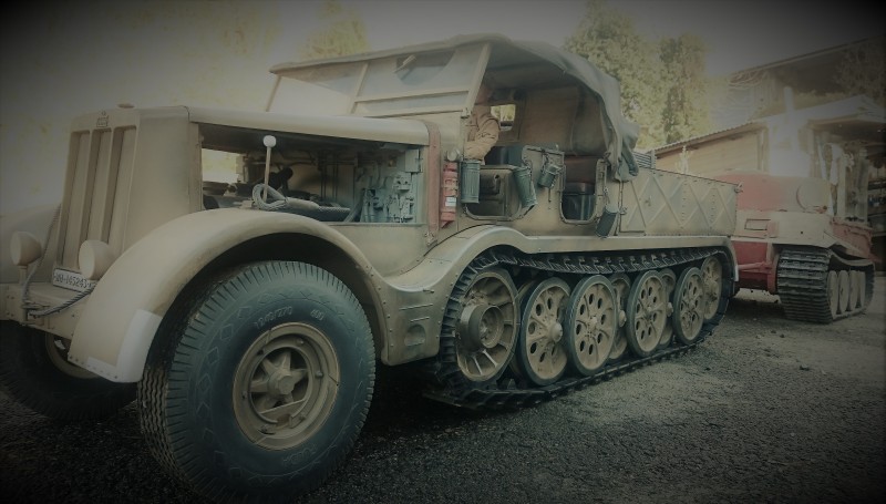

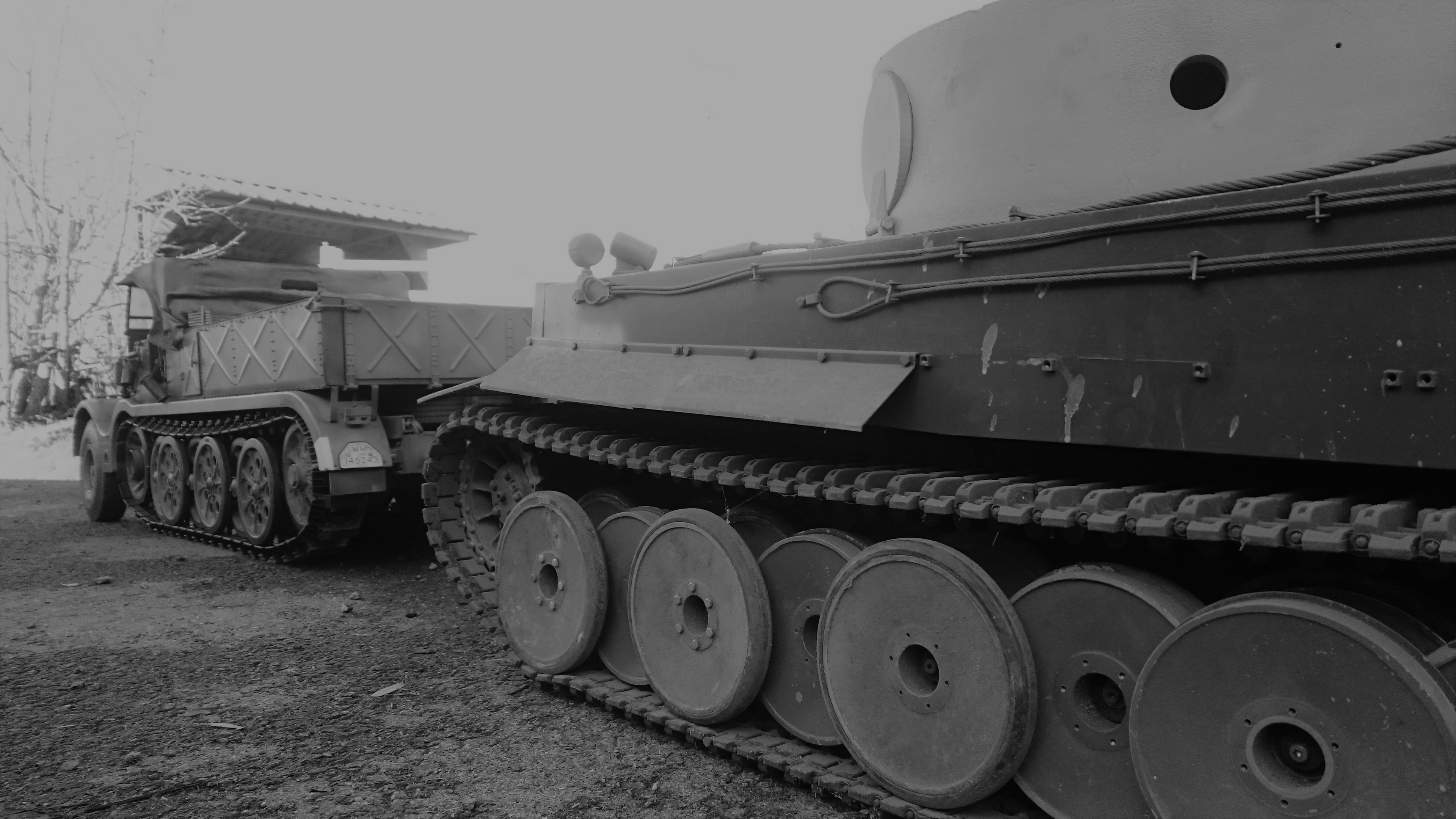

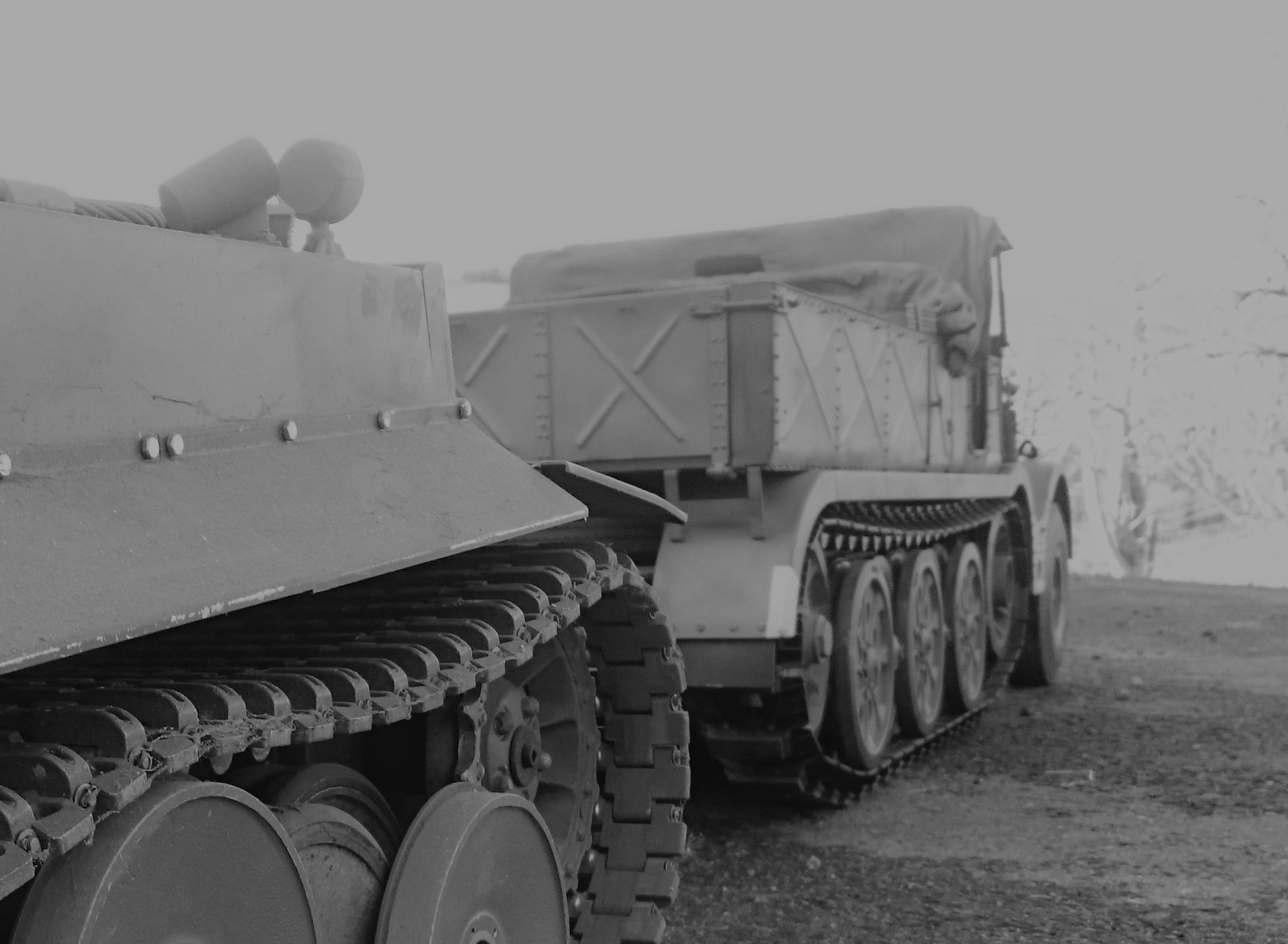

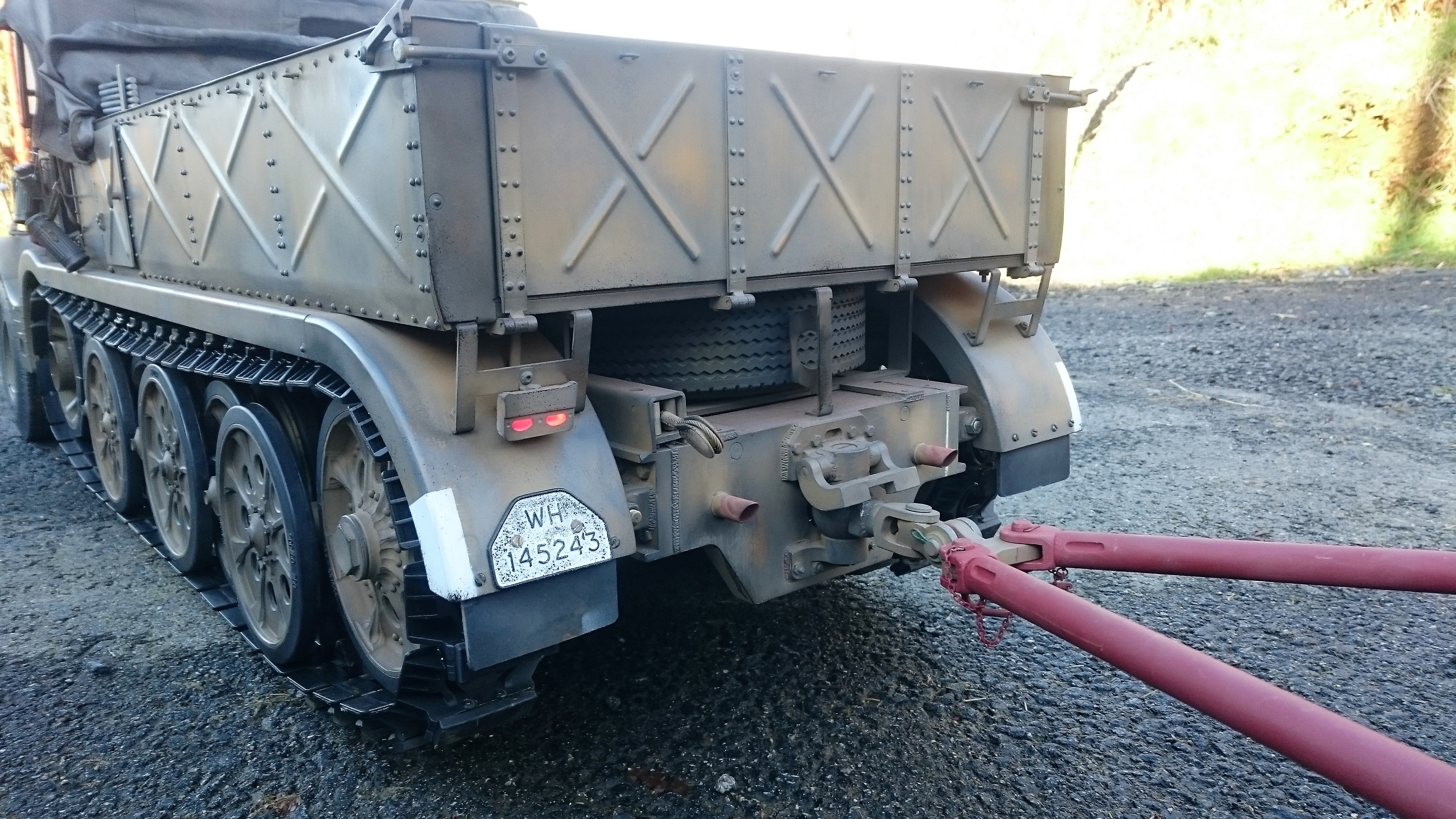

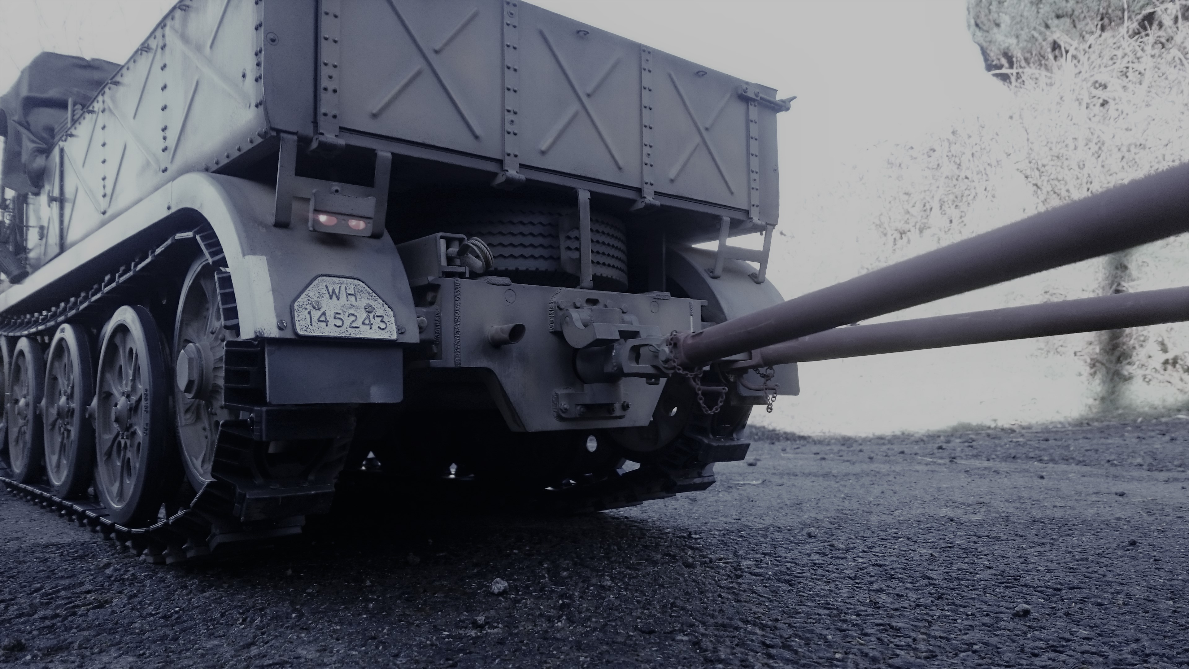

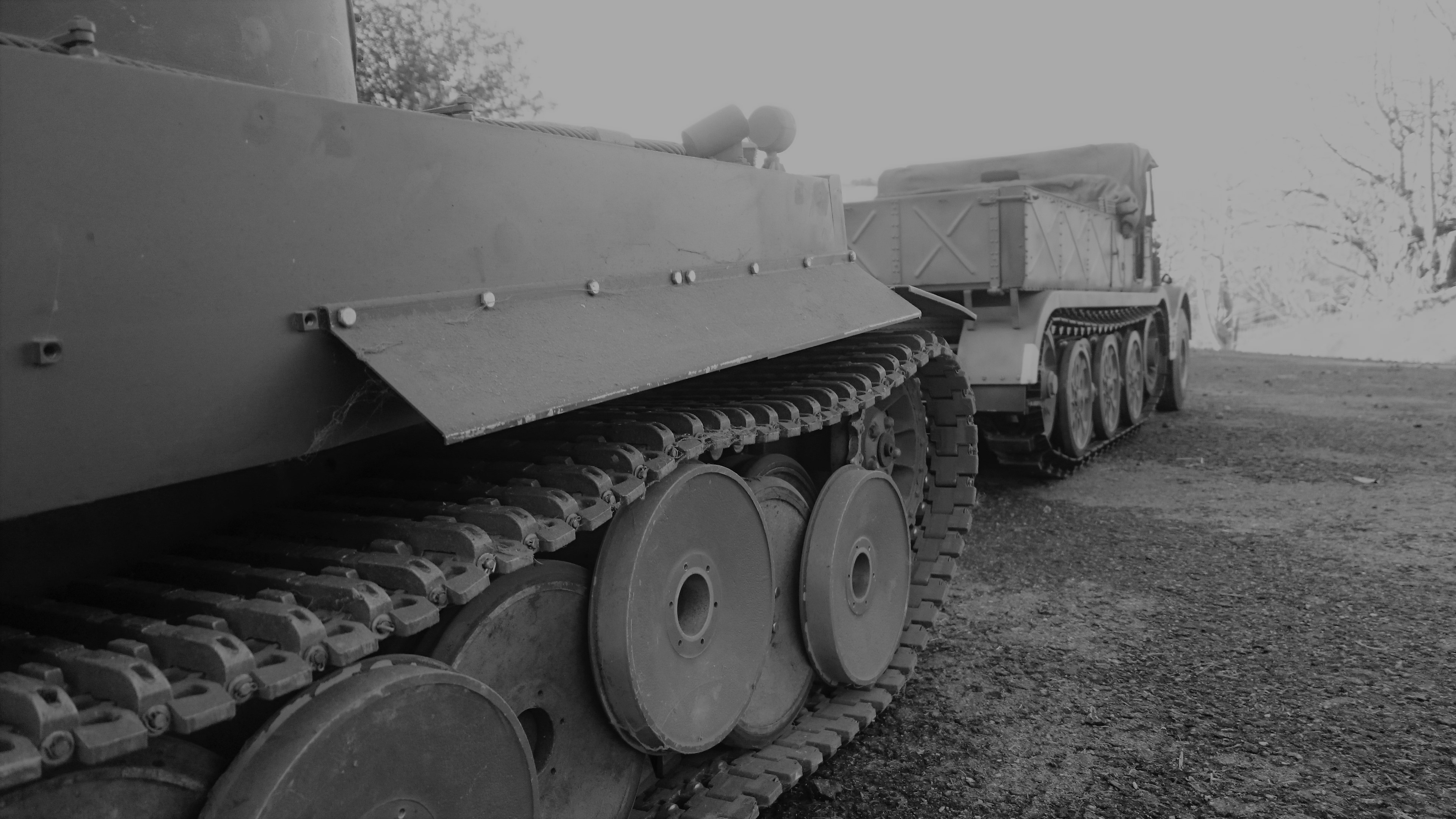

Some photos from the video i managed to shoot today before the Famo was crated up for shipping. Video to follow.
In conclusion towing a clapped out Tiger 1 range target with running gear issues with no drive train.
A single Armortek Famo can and will pull an Armortek Tiger 1, although it struggles on an incline a straight pull over flat ground is no problem, down hill is no problem, tight turns are difficult, gentle turns are recommended but reversing is not recommended.
Two Armortek Famos linked together would be better and three would be desirable to pull a disabled Tiger !
An Armortek Panther would be lighter and therefor easier to recover, I have an old FOA Panther which weighs not much at all for video recovery work and may be more suited with less strain on the Famos drive train.
All in all very much like the real thing!
You guy's at shows will have a lot of fun experimenting with different towing techniques!

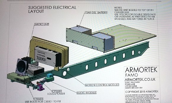

If the FAMO is not sold yet. where do you plan to instal the Motion Control Module, Audio Module----when the engine bay is nearly full of the dummy engine, cooling fan, and many tubes, wires, etc.-----?
The manual has shown this figure, but even with an empty engine bay, I don't think the steering wheel rod can be inserted into the engine bay, when the Motion Module was on the way. Now the big question (for me) is: "Where is the best position for the Motion Control Module?"

Hi Chang, if your not going to install a dummy engine follow the Manual, you will need to shorten the steering wheel column to suit.
It's a whole new ball game to insert a dummy engine with hours of work to put together bespoke wiring harnesses and electronics/electrics hidden under the seats ( I wouldn't recommend it ) .

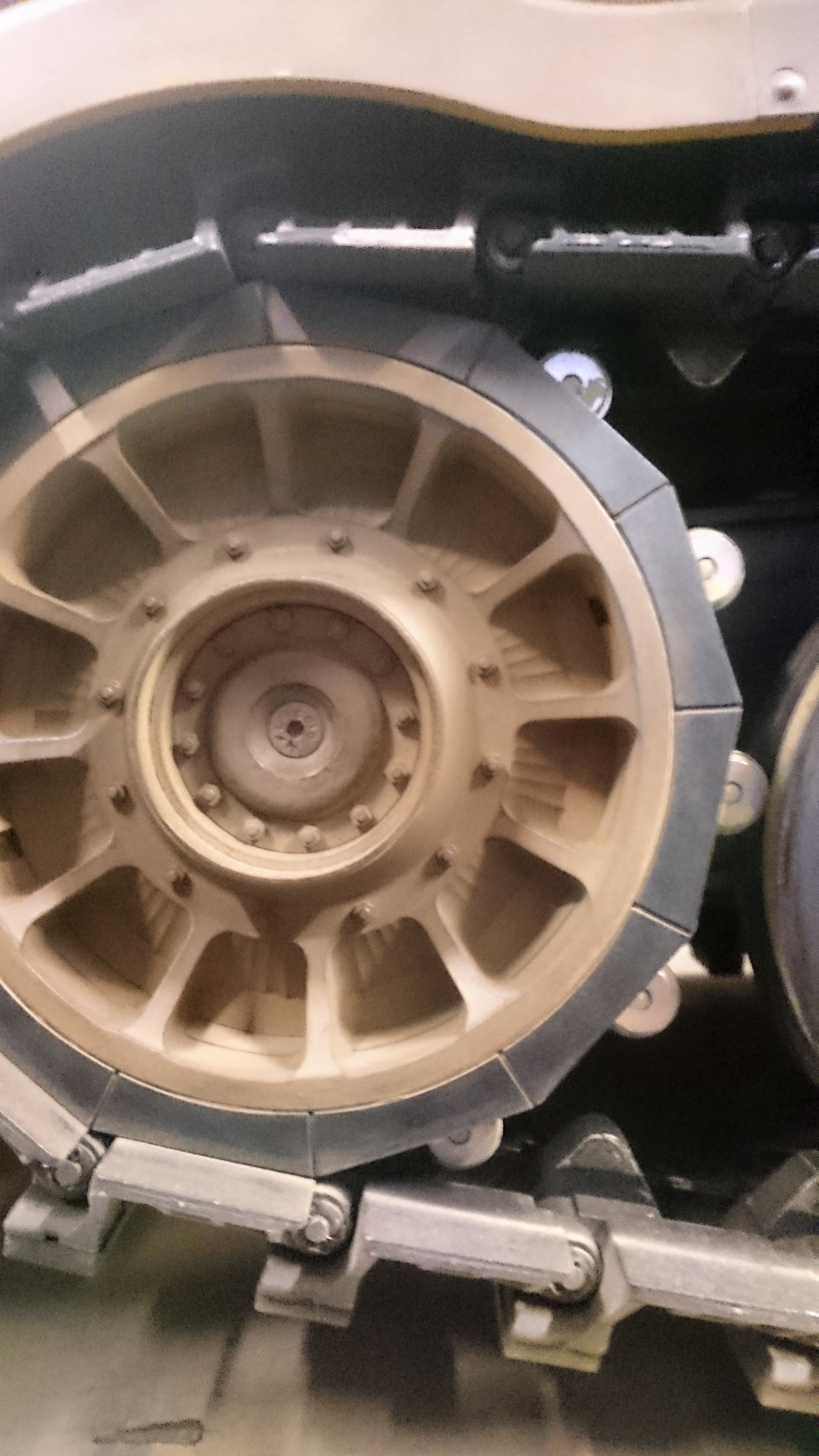

A quick but important tip regarding the smooth running of the Famo, use a light oil like 3 in 1 for the sprocket rollers. I was amazed how much smoother the Famo ran after a liberal application, maybe after a period of "running in" things will be even smoother but it sure helped.
Don't be shy with oil I gave the rollers a good dose. Now obviously oil and dirt is not a good combination so it's your choice.

or those who like to run off-road, an alternative to oils and grease is a dry molybdenum lubricant such as Oxylube. It's far from cheap but a can lasts a lifetime. When I last spoke to Mark about whether to lubricate or not, his recommendation was not to use wet lubricants if you intend to run over any sort of rough terrain. As you say, it's a builder's choice.
Looking forward to seeing your next project.
