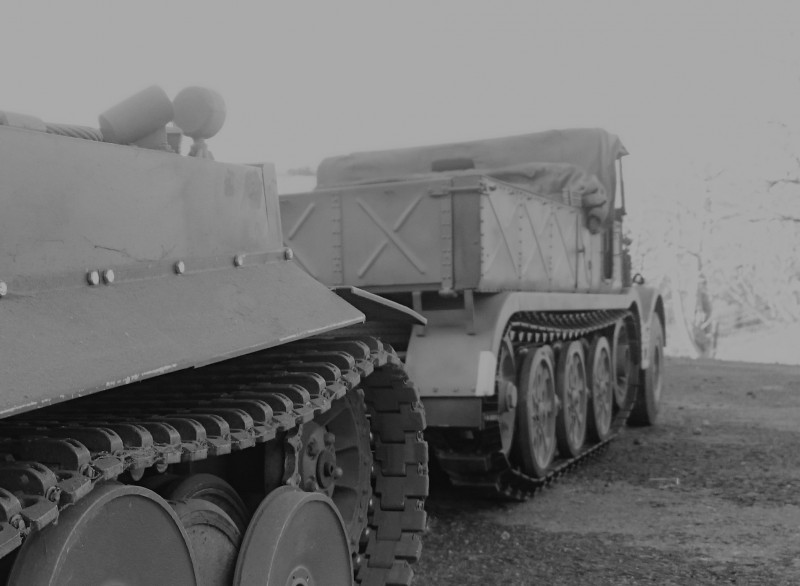

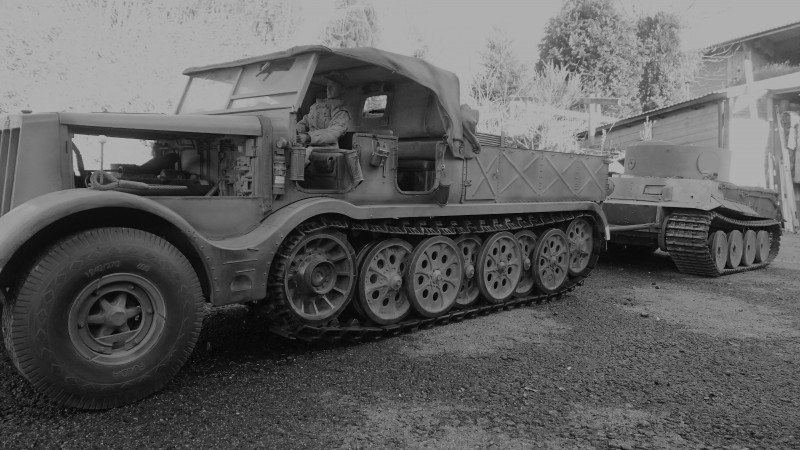

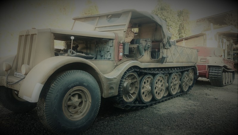

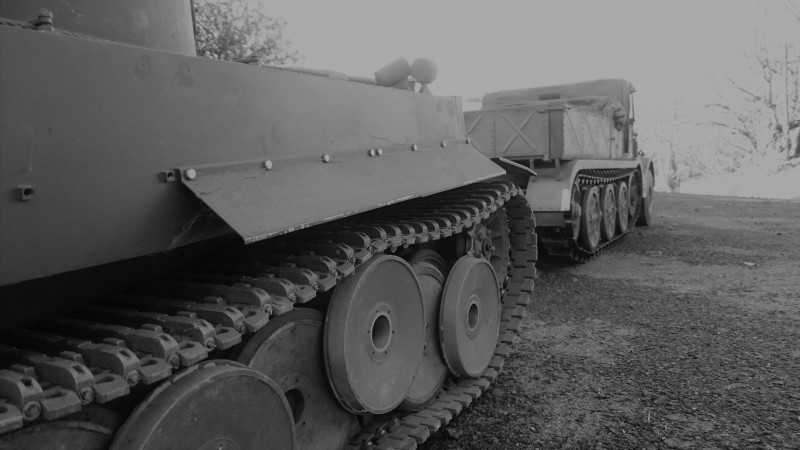

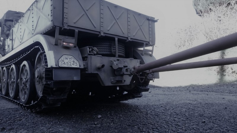

Some photos from the video i managed to shoot today before the Famo was crated up for shipping. Video to follow.
In conclusion towing a clapped out Tiger 1 range target with running gear issues with no drive train.
A single Armortek Famo can and will pull an Armortek Tiger 1, although it struggles on an incline a straight pull over flat ground is no problem, down hill is no problem, tight turns are difficult, gentle turns are recommended but reversing is not recommended.
Two Armortek Famos linked together would be better and three would be desirable to pull a disabled Tiger !
An Armortek Panther would be lighter and therefor easier to recover, I have an old FOA Panther which weighs not much at all for video recovery work and may be more suited with less strain on the Famos drive train.
All in all very much like the real thing!
You guy's at shows will have a lot of fun experimenting with different towing techniques!
