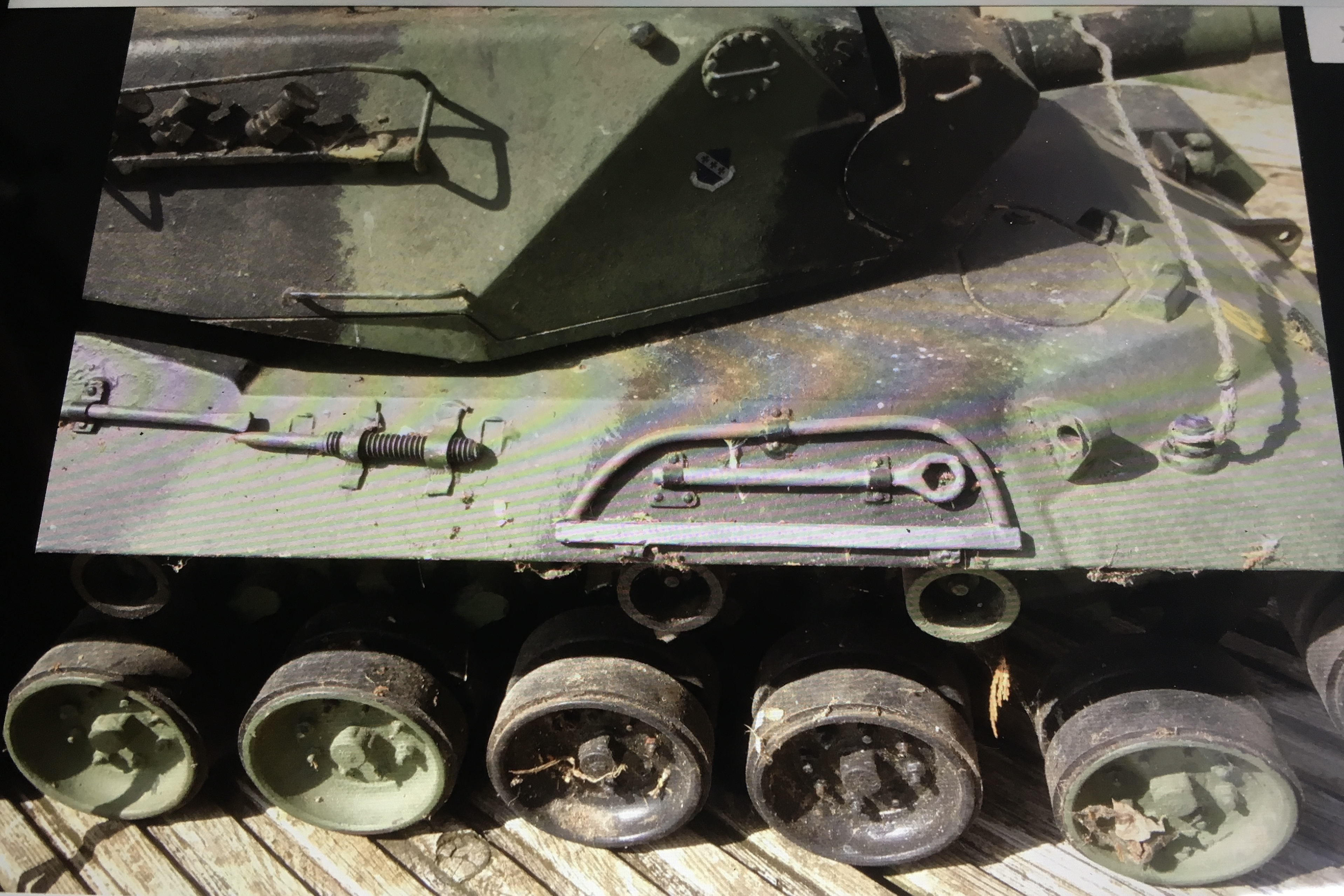

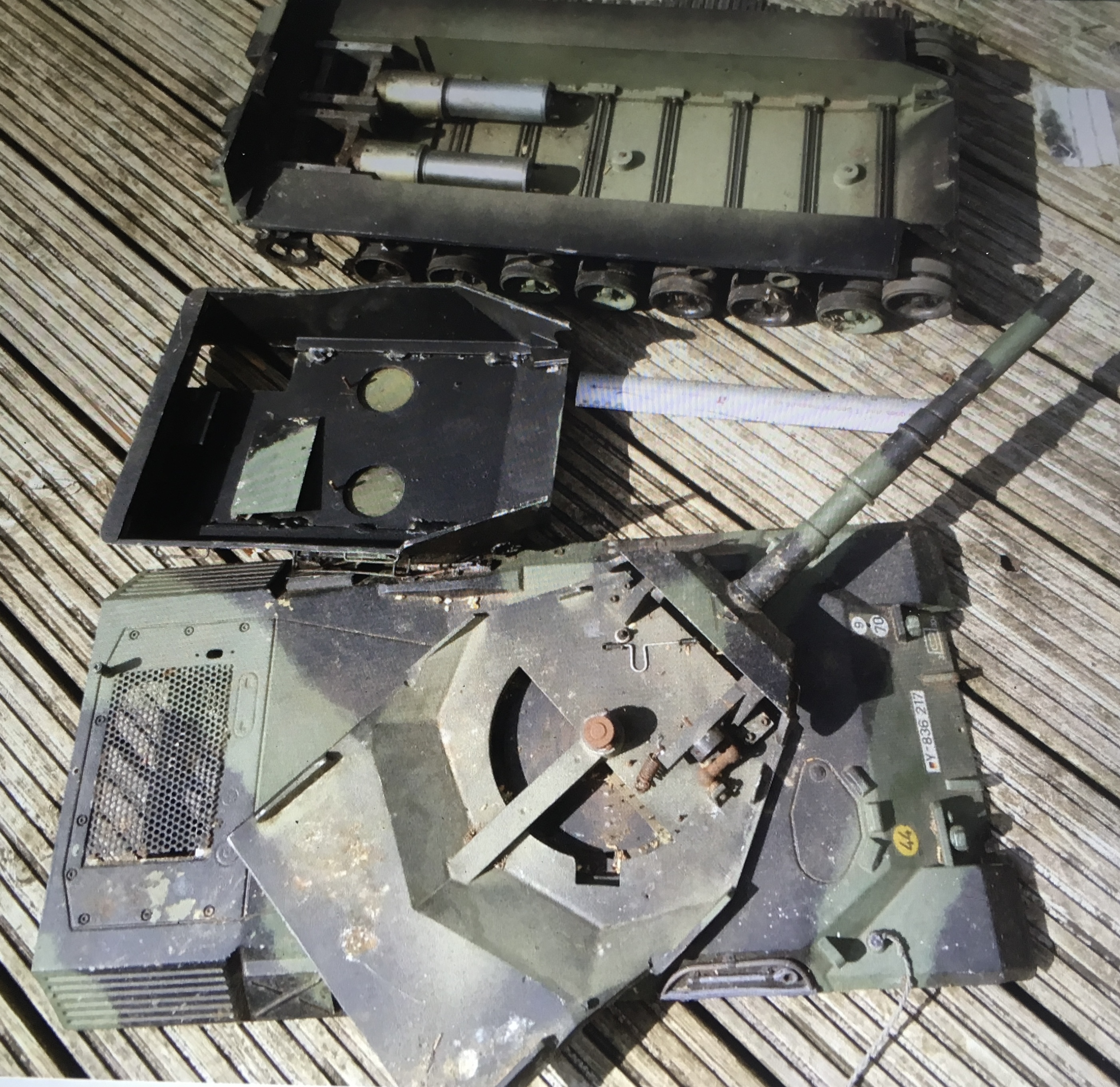

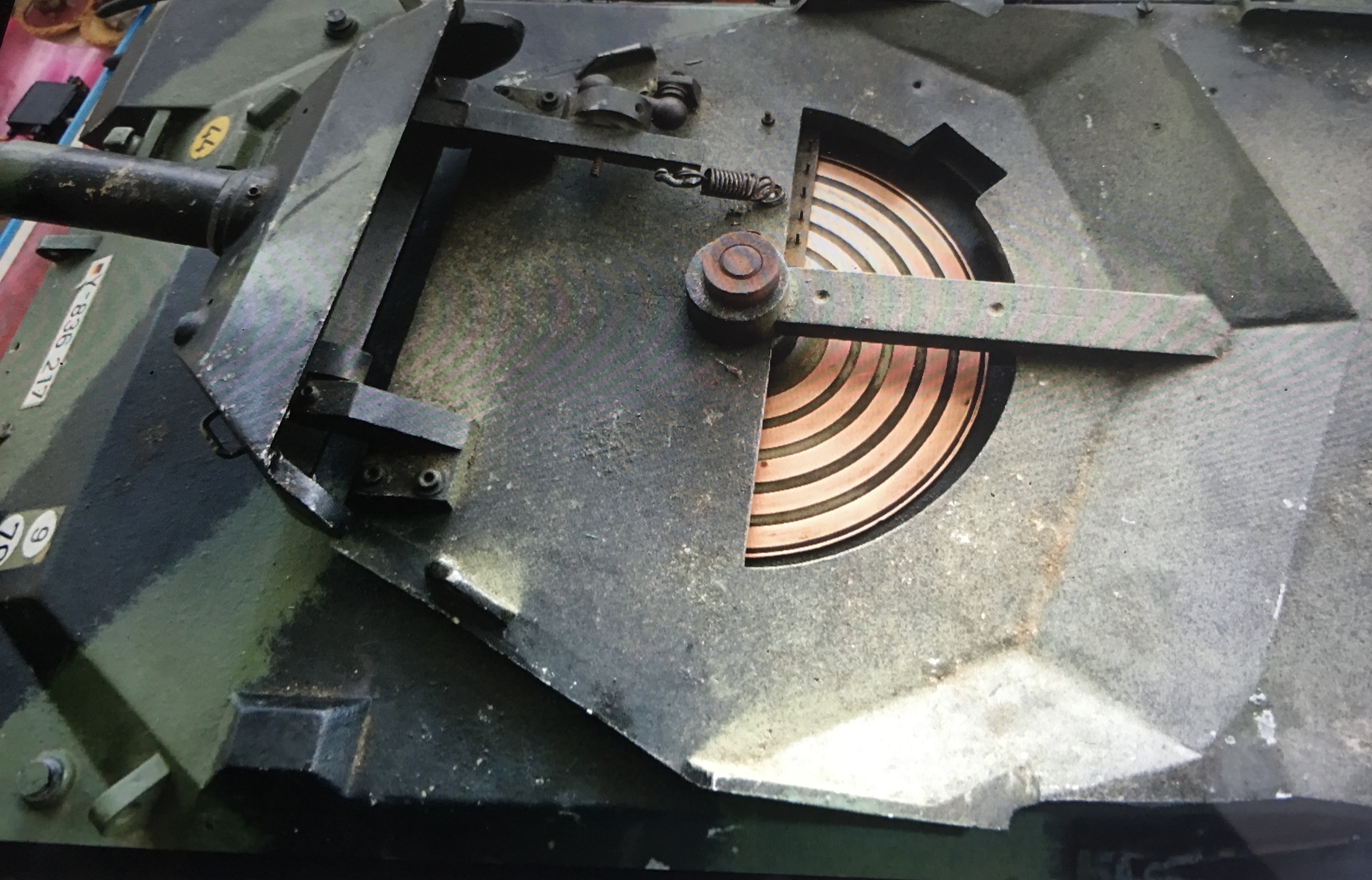

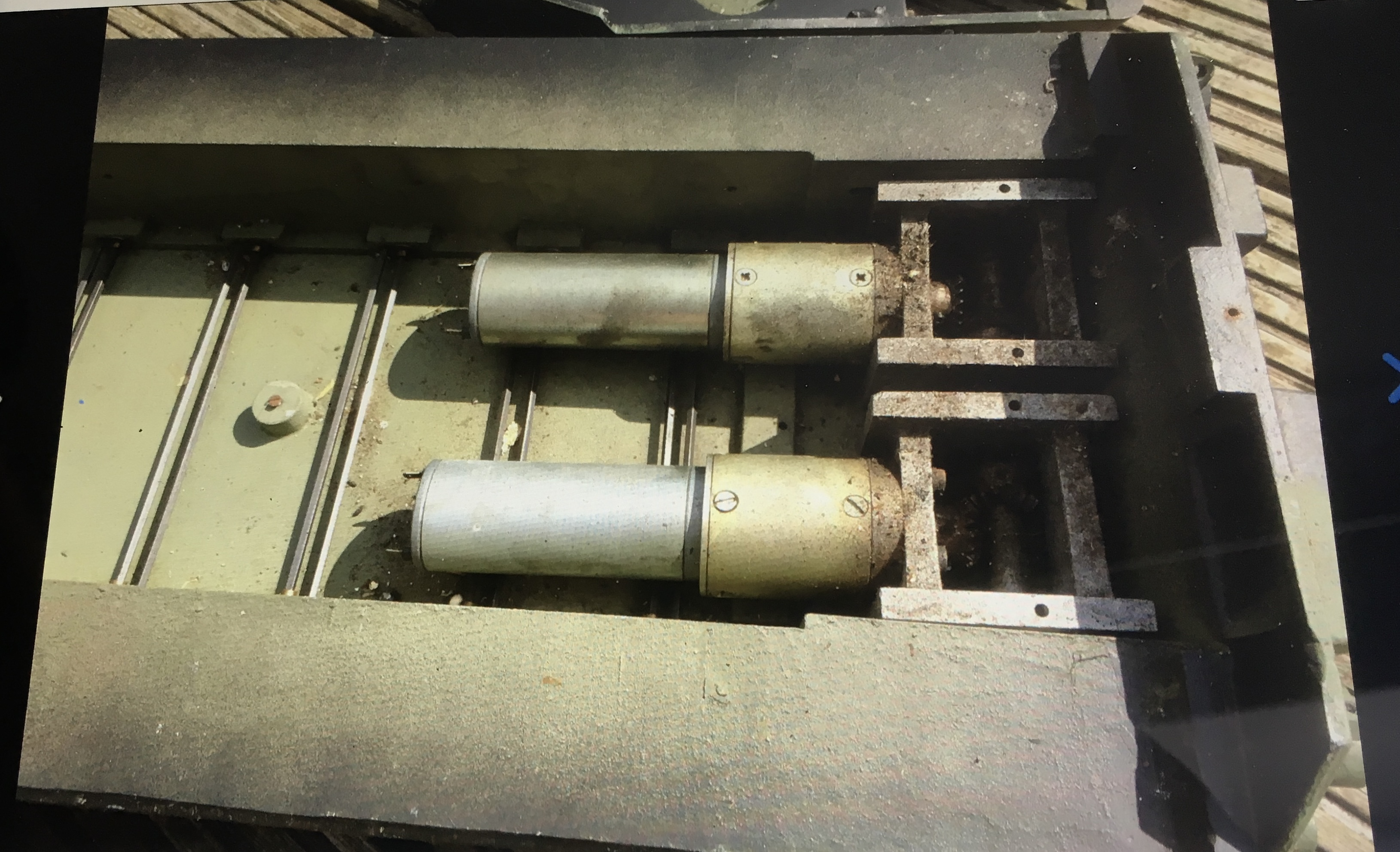

Well I have not had any adverse comments, so will try to post some pictures and describe the renovation, all major pieces cast from alloy and welded, torsion bar suspension, deck with a multi circular copper track with electrical brush pickups in the turret, a novel way to provide power to the turret without getting wires twisted, overall dimensions were good to scale but fittings were naive, electric motors driving rear sprockets, each unit could be adjusted for track tension, tracks were duel pad in a hard wearing plastic / nylon with steel pins, but rusted stiff, this is what it looked like
if this is of interest to anyone let me know and I will show its progress
regards Jeff

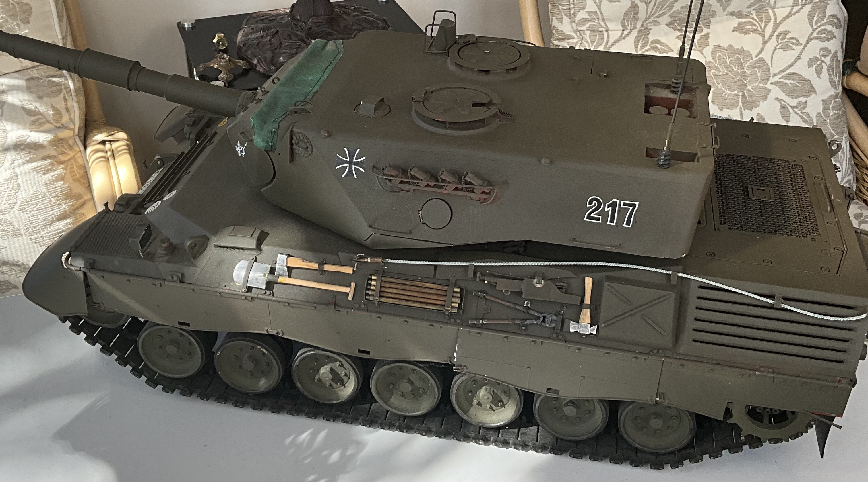

There were a couple of visual discrepancies on the tank, no side skirts, main deck with cast front mudguards, and the rear of the tank with a square telephone box, the 1A4 had a round t/box, so mudguards and t/box sawn off, and replaced, I also put in the armoured side sights in the turret and the engine decks cut out and hinged, some pictures to show progress
regards Jeff

Just a few more pictures of the build, I wont bore you with all the details, but I wanted to be as accurate as I could, when researching the tools for the sides of the tank, there was one I did not recognise, it turned out to be the jack for lifting the engine decks and was housed in its bracket on the side, and the only way to make it was to see how it worked
and just a couple more
regards Jeff

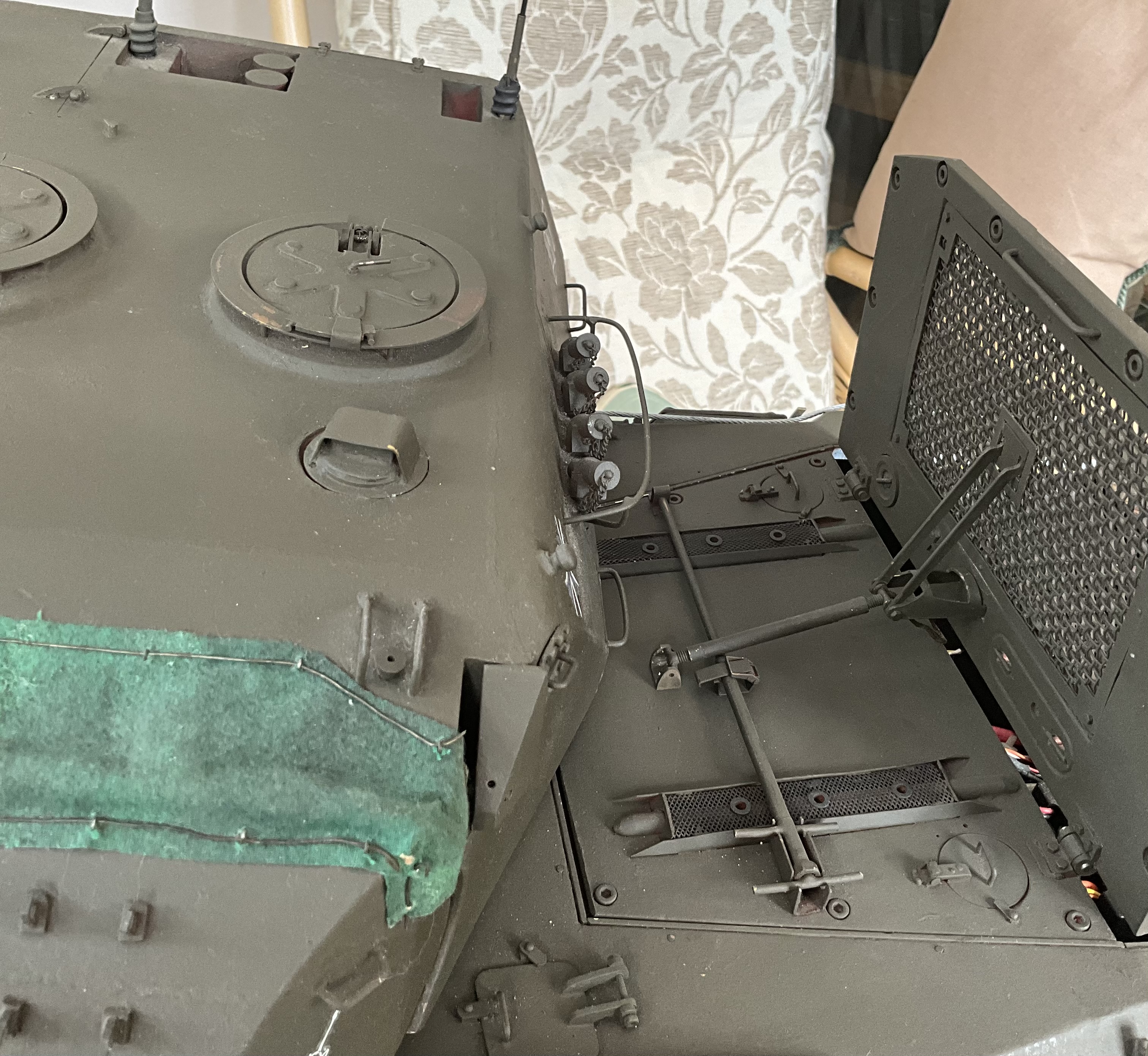

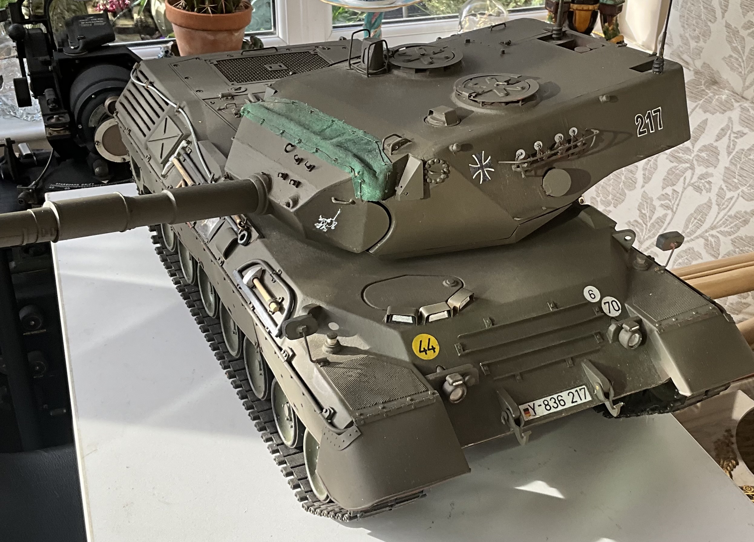

With the interest in the new Leopard kit, I looked back through some of my old posts, and realised all the photos were missing on my Leopard 1a4, so took a few this morning
regards Jeff-

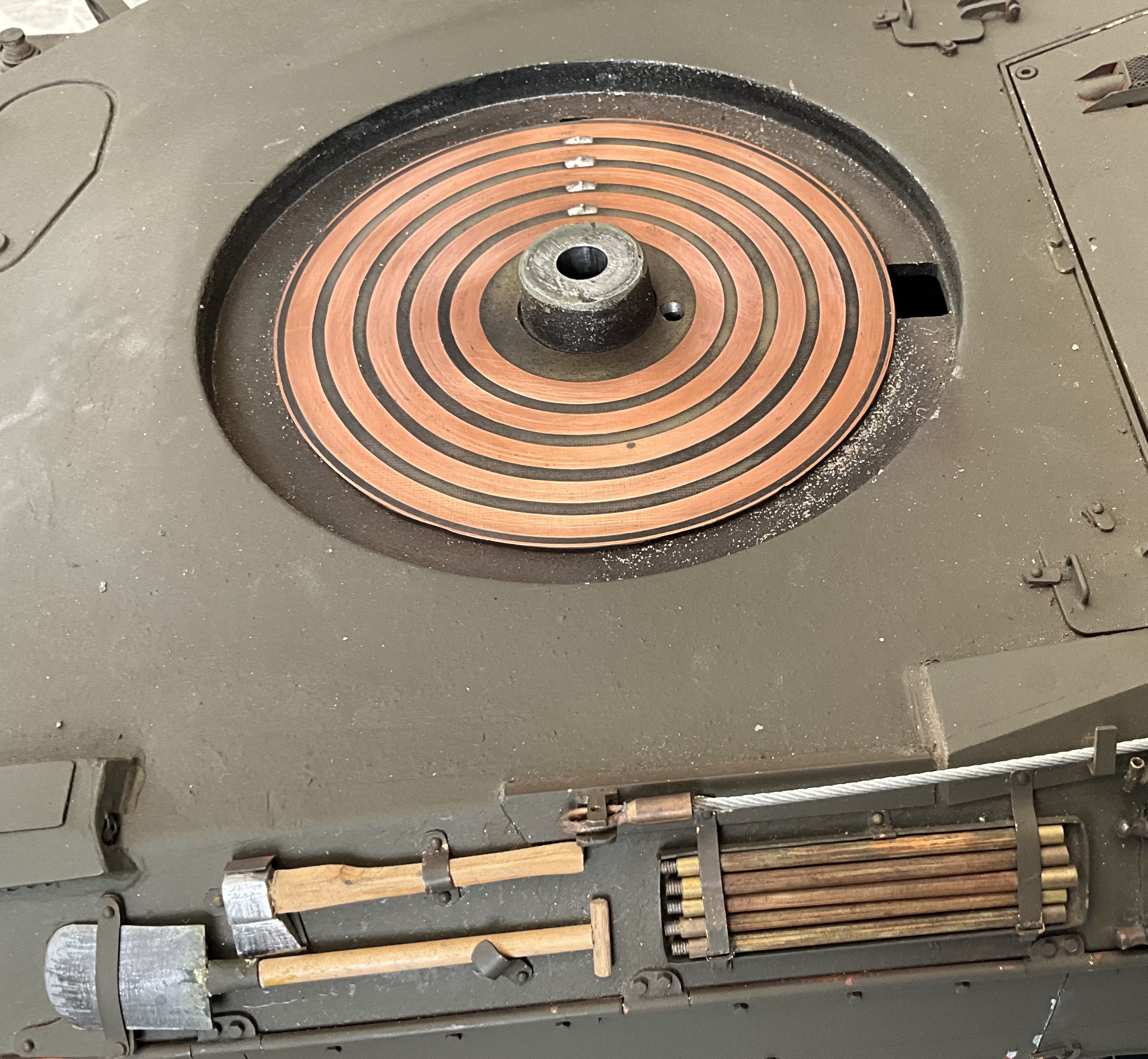

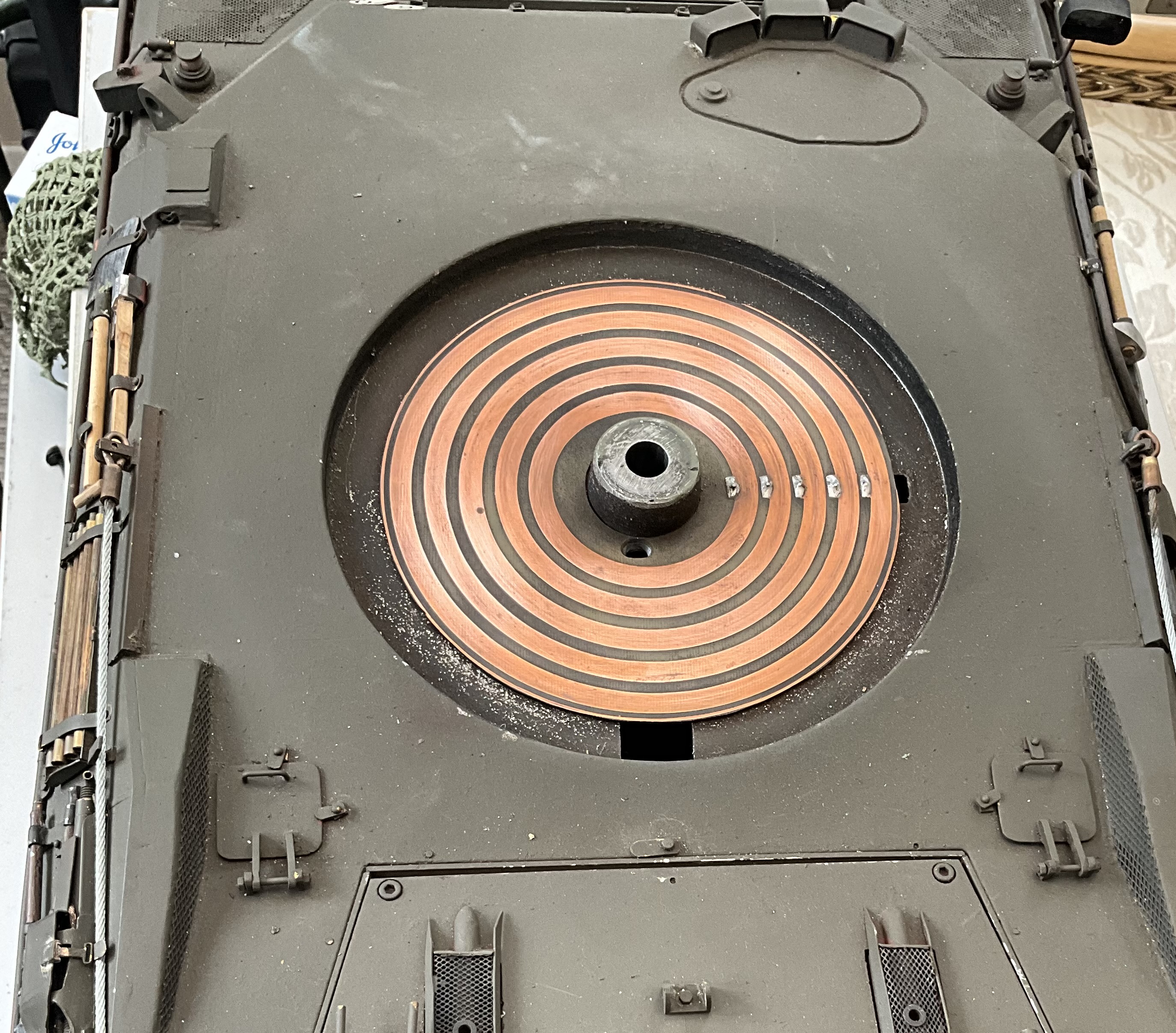

Thought I would share how the turret connects to the power, allowing it to turn continuously with tangling the wires
regards Jeff- Chang
