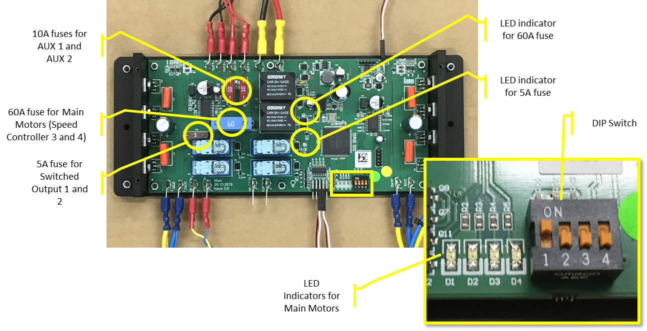

Hi John, on the Motion Control Module try pushing DIP SWITCH 1 into the up position.
Switch Description
1 ON = Newer Transmitter systems with faster transmission rates (e.g FUTABA S-FHSS). DEFAULT POSITION
OFF = Older Transmitter systems with slower transmission frame rates (e.g FUTABA FASST and analogue systems)
Switch Description

Thanks everyone, It was the DIP switch, after flipping it, it worked like a charm! thanks!!
