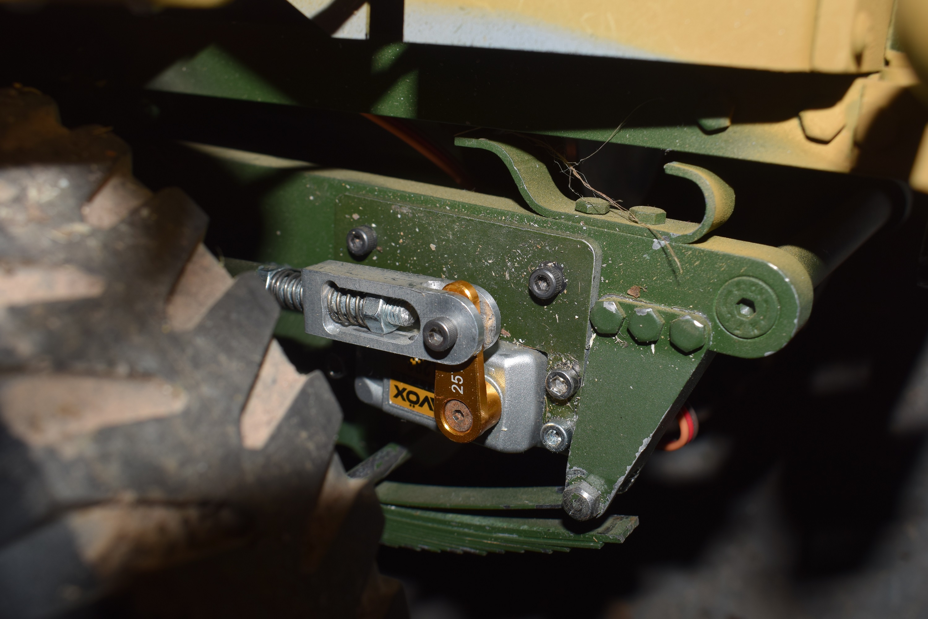

My colleague, Andy, is into his RC Cars and I saw that the servo arm on his car was 'deeper' than the servo supplied.
This meant there is much more clearance for the linkage as reaches the end of its travel, but also allows the servo to be mounted inboard on its support plate. This gives much more clearance for the Tyre, maximising the steering lock.
It is a neat solution, so thanks to Andy!Steve
