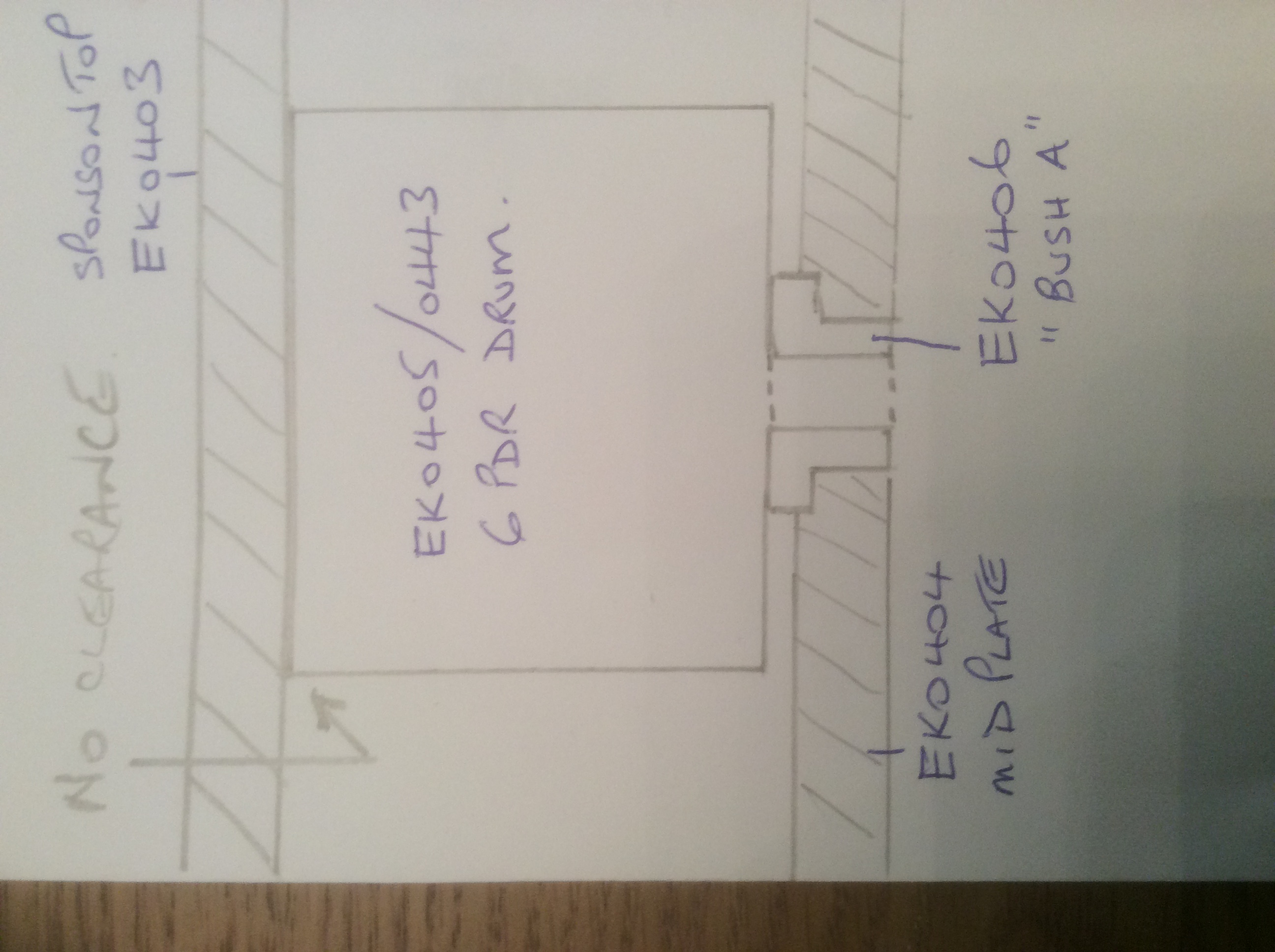

Thanks Daniel, but I wonder if we're talking about the same parts?
I don't see how the bush I referred to could go inside the drum, as the hole in the drum is too small and is also threaded to take the pivot bolt. I accept that the drawings are misleading as the bush appears to be inside the 6 pdr drum.
My problem shown below
As it stands there is no way either drum will rotate unless a couple of mm are skimmed from the drum top (allowing for paint also)

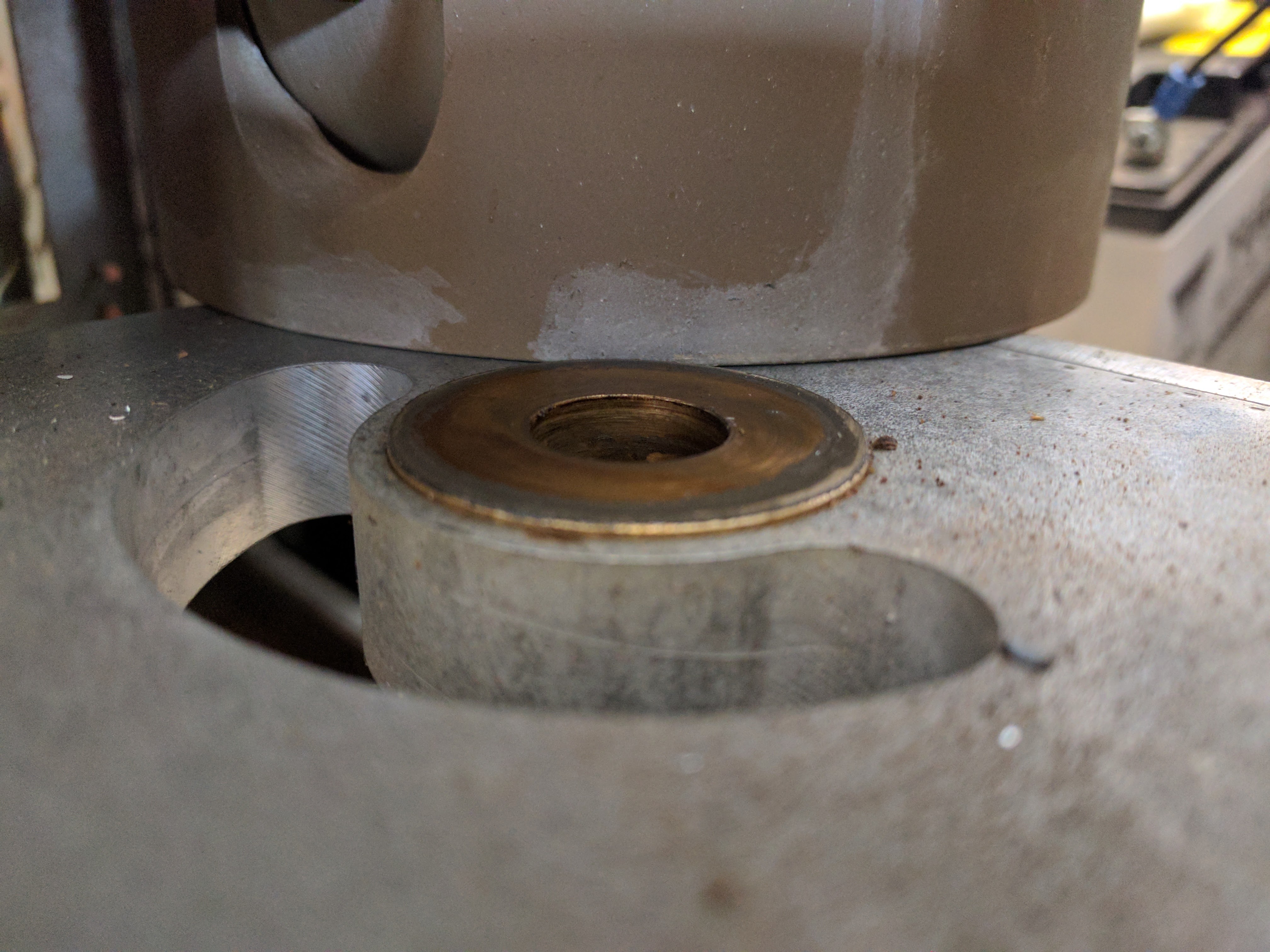

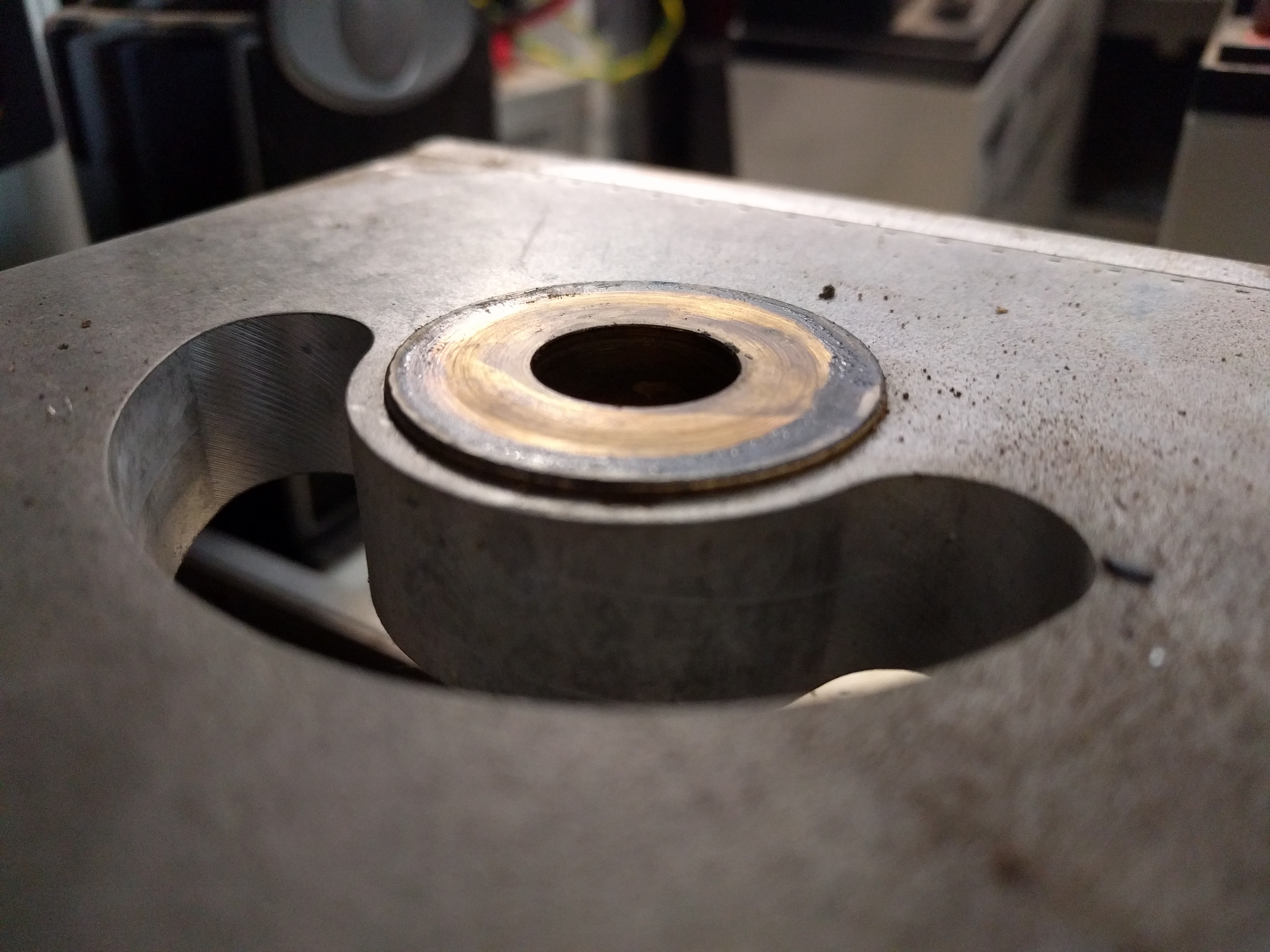

Kevin, you are right, I shouldn't go off my notoriuosly unreliable memory! I was curious how it fits so I removed the sponson drum so I could see how proud the bush should be for it to clear. The drum came out with no restistance and I had never had to grind anything down, that being said it could be that there is too much 'meat' on the bushes you have. Here is a look at how mine looks:-

Once again, thanks Daniel. Your photos are really helpful. The bush in my sponsons certainly protrudes no more than yours ( and as mentioned before is flush beneath the "mid floor" so I'm happy they are in right).

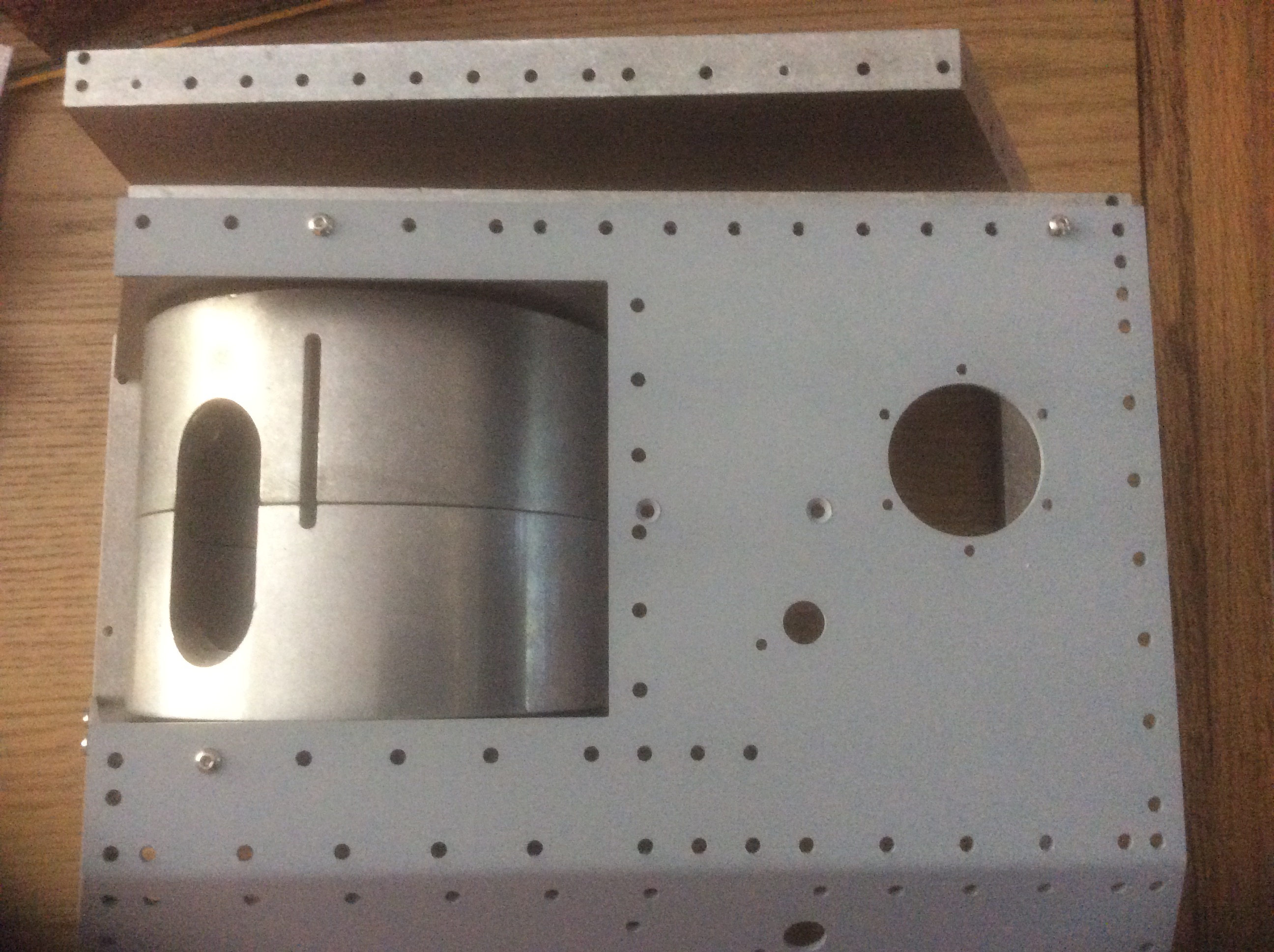

Ok, have now established that the male sponson roofs are definitely "handed". As the photo shows, the holes on the 3 outside faces are offcentre such that depending on which way up it goes there is more or less space for the 6pdr drum.
Having swapped my roofs I now have clearance for the drum to rotate freely. However the roof now sits proud of the sponson sides ( see pic) by almost 5mm. I also have a spurious single hole at the right hand end and no idea why.
Previously my roofs were flush with the sponson sides but of course I couldn't fit the drums properly. :(
Which way round is right?

Ok, well the bad news is that I think the proper way to fit the roof is with the holes at the upper edge, otherwise the roof will not sit flush and the sponson will not fit to the hull. I think the two vertical holes are meant to line up with the top two holes in the side plate (I tried to verify that on mine but it appears I just glued rivets in them so it is inconclusive).
This of course leaves you with your original problem which is a mystery - if the 'floor' section is bolted in correctly and the bush is no higher than mine why is there not enough clearance? I don't recall anyone else having this issue so I don't think it's a dimension issue with the kit (like the track tensioner trays).
