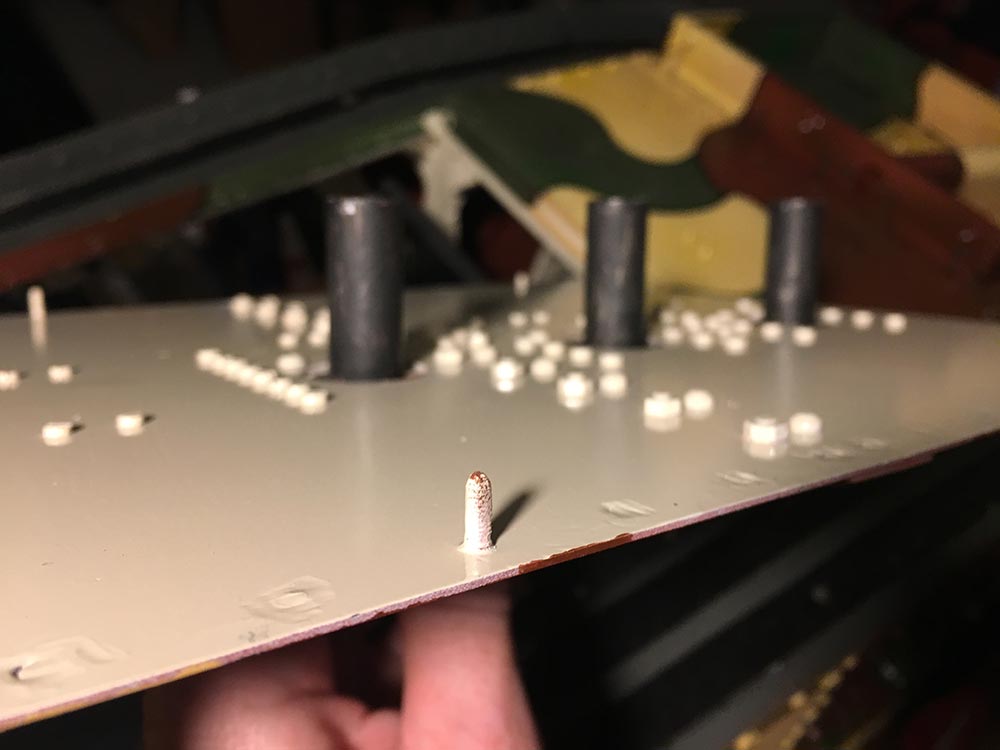

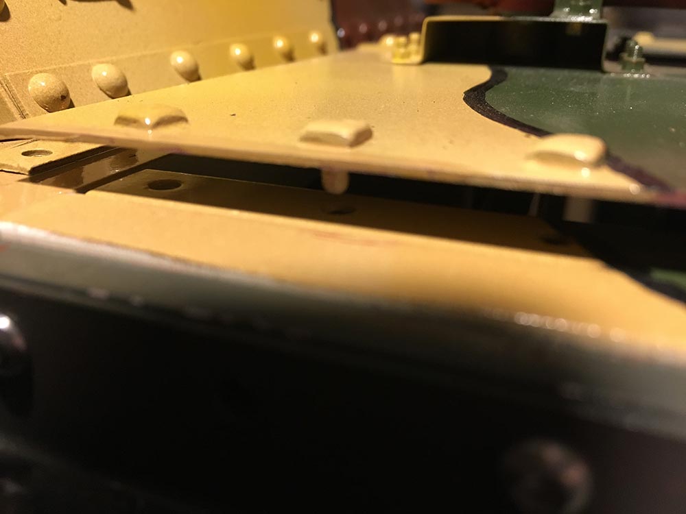

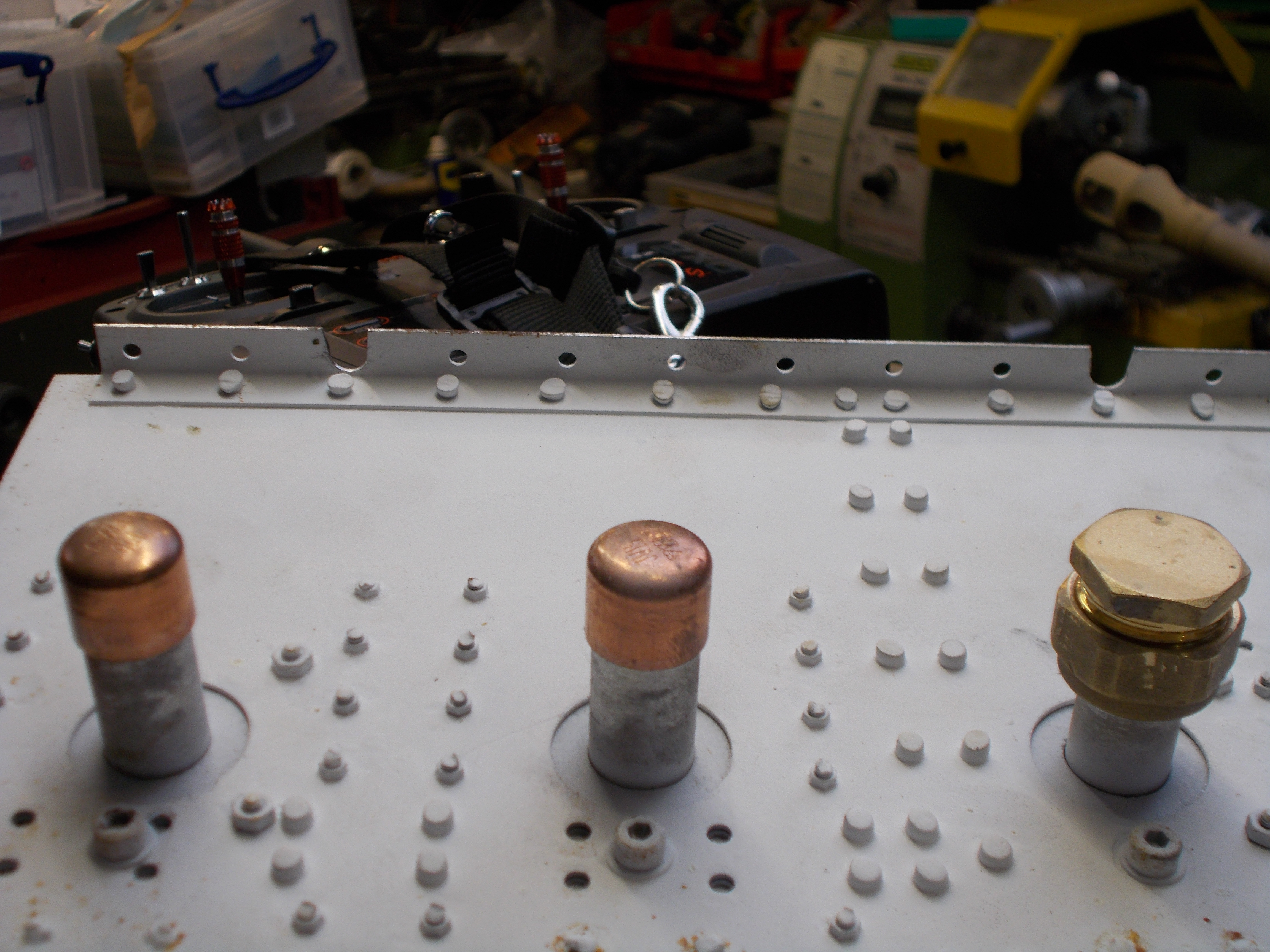

Re: How to (not) fit the roof.
Just for reference here are two pictures of my roof:
We look forward to more progress reports!
The Angle pieces give enough rigidity, but also provide flexibility so the Roof wedges in securely and hope fully gives a certain amount of stiffness to the structure.We look forward to more progress reports!
So THAT's how you did it ! Looks good to me, but a bit above my pay grade ....

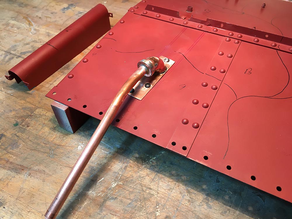

Hi Adrian,
I was a little bit lazy, followed your method 2 and glued six rectangular rivets into the roof with approx. 2,5 mm dia.
These pins fit into suitable holes of EK0126
I though that the roof needs no structural reinforcement.
The exhaust pipe is held into a bracket covered unter EK0637
I positioned the smoker in the rear between the two drives and connected it directly to a new plumbing on the roof.
regards Oliver
