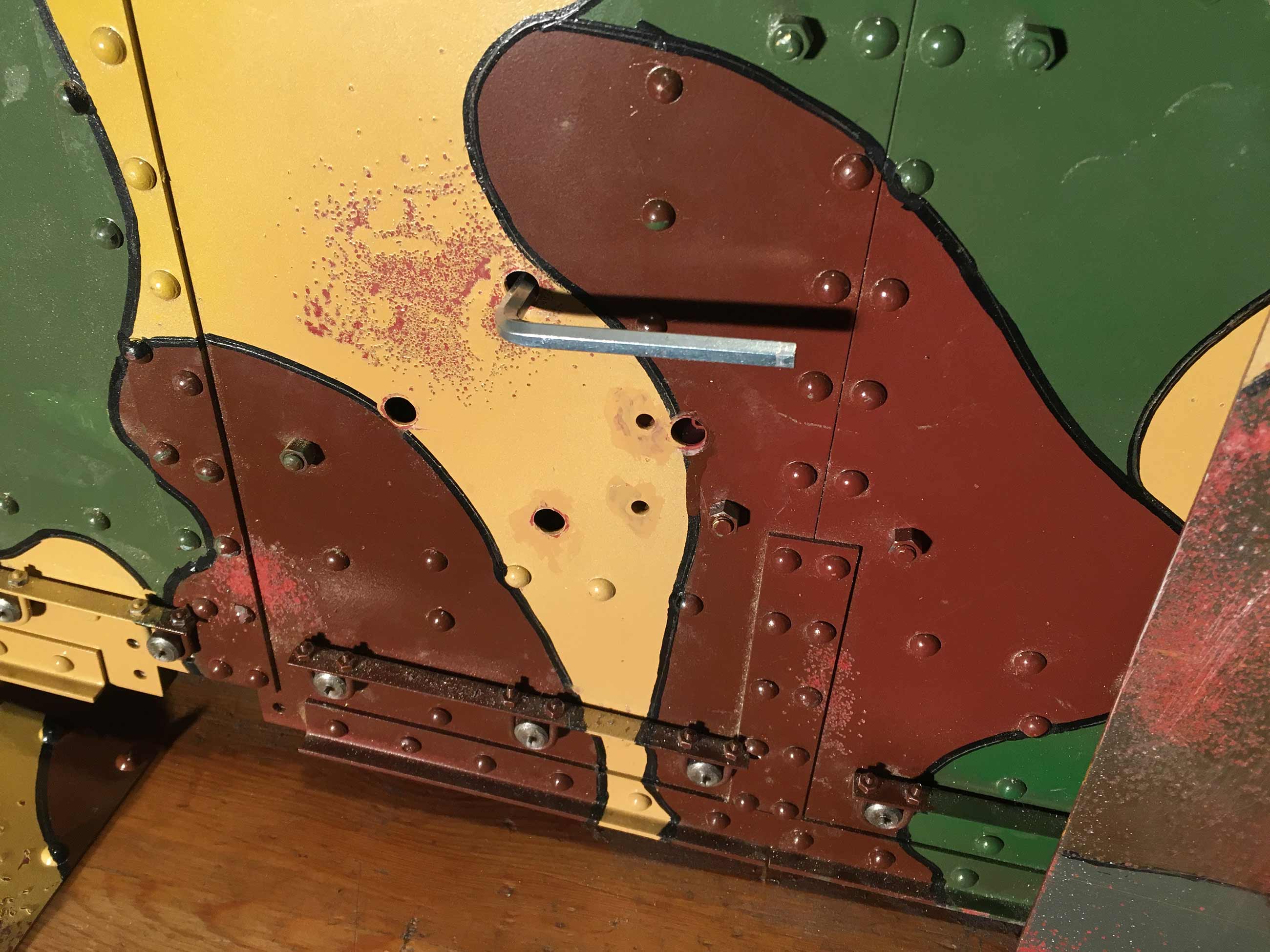

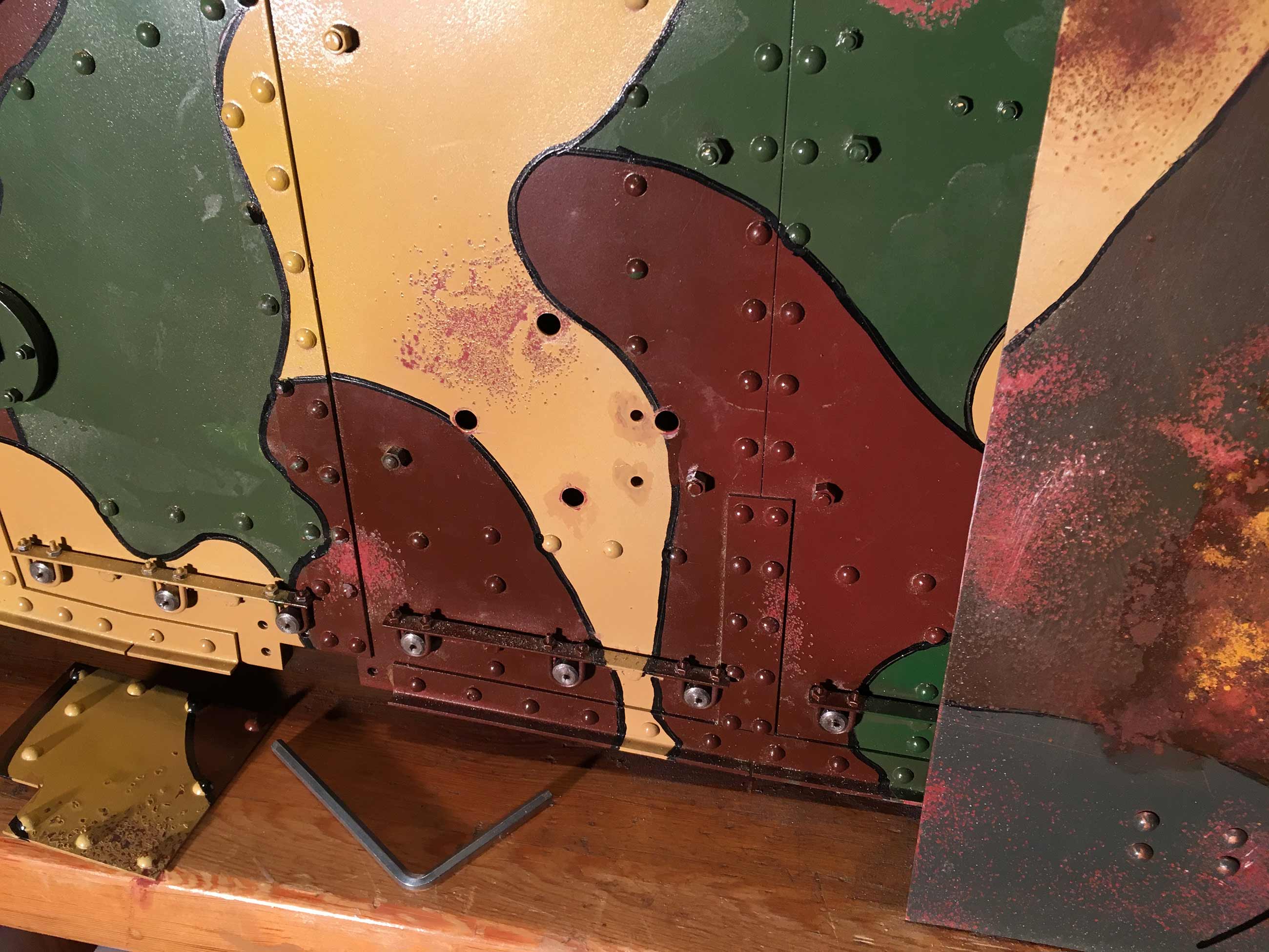

Hello,
Regarding the reports about the maintenance of the drives I finally decided to take a more convenient way.
The „Beutepanzer“ in my worksop got 4 „bullet holes“ on each side of the rear armor plates with 6 mm dia.
That provides direct access with the hex allen key to the mounts of the drives.
Adjusting is now a real fun and the armor plates never needs to be removed. :-)
four "bullet holes" on the right side
easy handling
easy handling

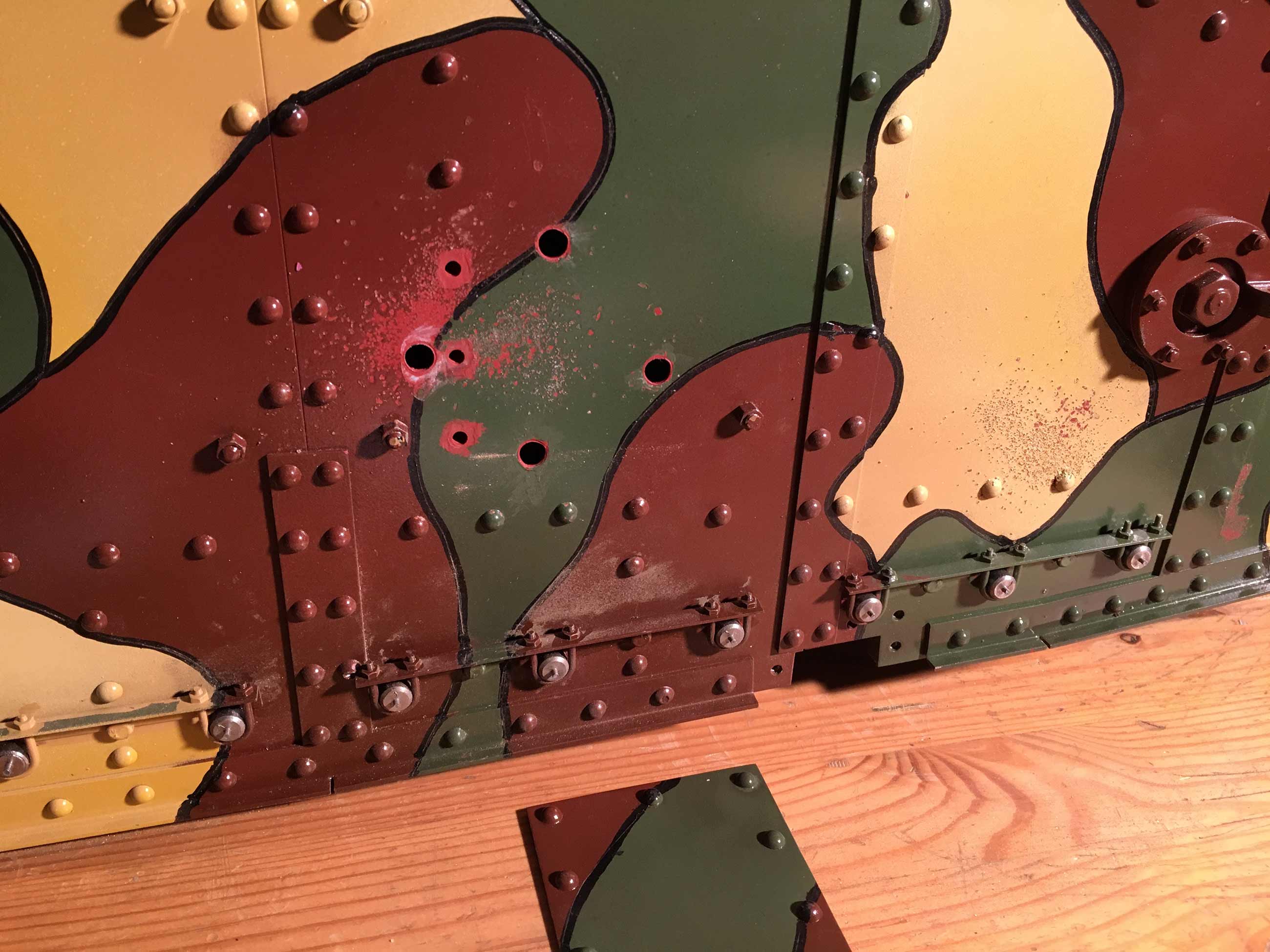

the "bullet holes" on the left side

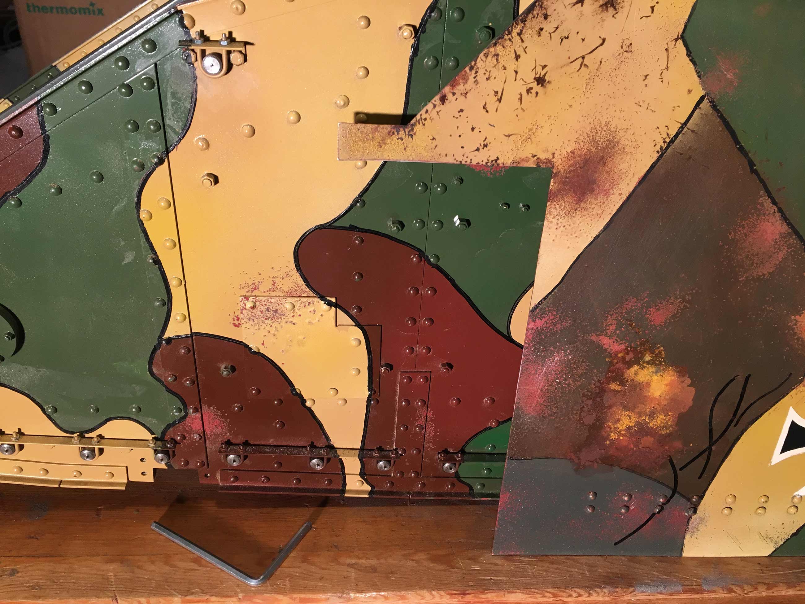

To cover the damages the refurbished Beutepanzer got additional armor plates in B.A.K.P. 20 to get the tanks back to service.
repaired! right side
covered! left side
covered! left side
To sheets of steel, a few rivet heads and some neodymium magnets did the job at my model.
Maybe for British tanks the holes could be covered with some painted and weathered adhesive foil.
Hope this could be an inspiration.

Certainly a novel suggestion. However, won't the top, left and right holes need to be larger to allow for the motors being pushed down a bit as the drive chain stretches a bit ?

Having just taken the plates off mine to remount the motors I can appreciate your elegant solution to this problem. I would echo Chris in that the left/right holes might need to be enlarged as should the motor move the bolts would no longer line up. Nevertheless, well thought out.

Removing the drives a few times, I saw that the hex allen keys provides you a little freedom to work in a slightly angled position. I could reach the screws in every position of the drives. So I never faced the need to enlarge the holes. But if this case occur, the holes can be optimized afterwards without any problem.

As for Oliver's solution, it certainly works for the Beutepanzers as they often had extra plates bolted over damage. However, I adapted the idea on Liesel (and will do on Flaming Fire II) by drilling the holes, tightening through with an allen key and then gluing a thin piece of aluminium behind each hole, using filler to fill in the hole prior to repainting. Should I ever need to tighten again, I'll take the tracks off, put another piece of aluminium behind, refill and repaint.
