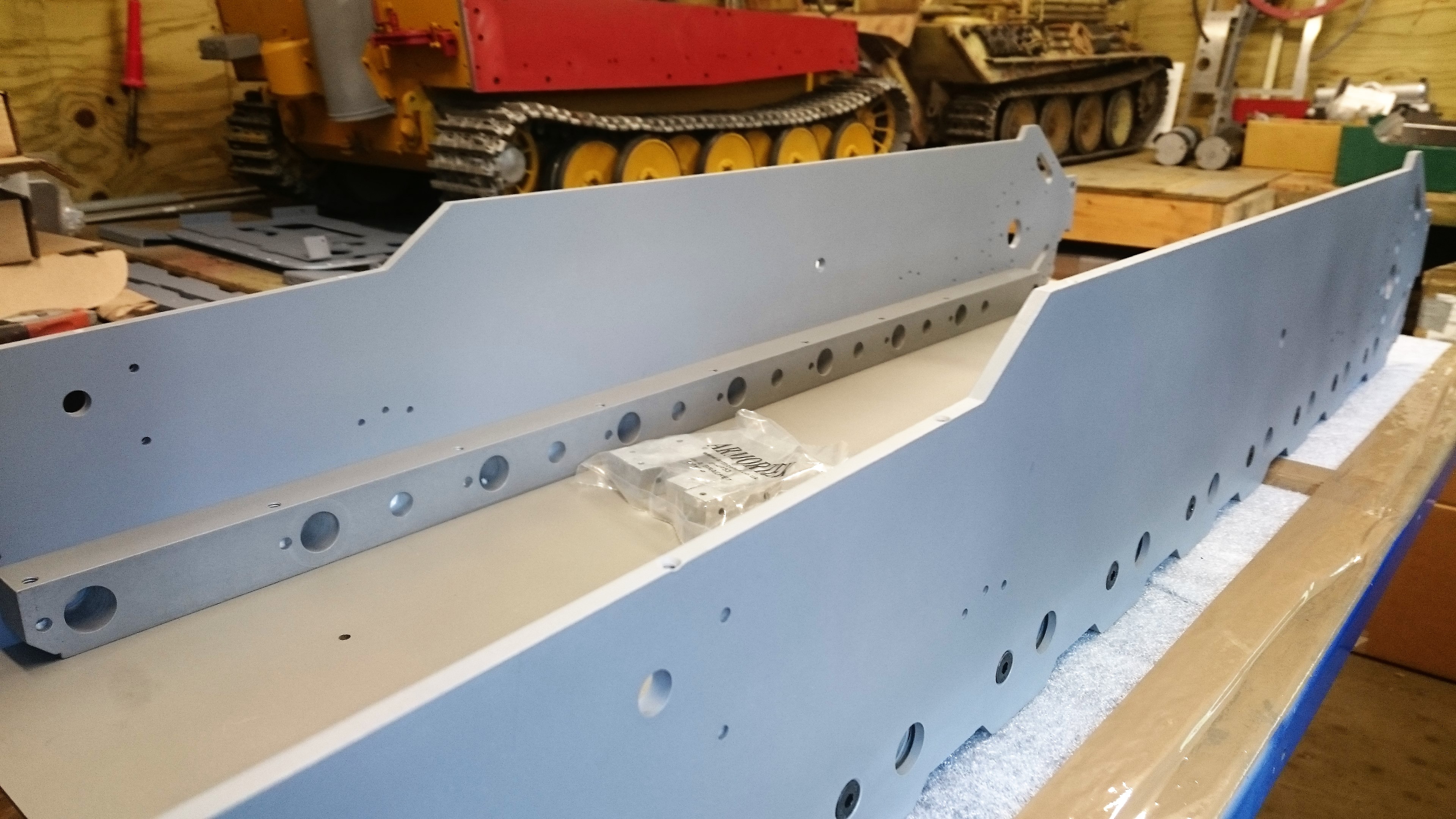

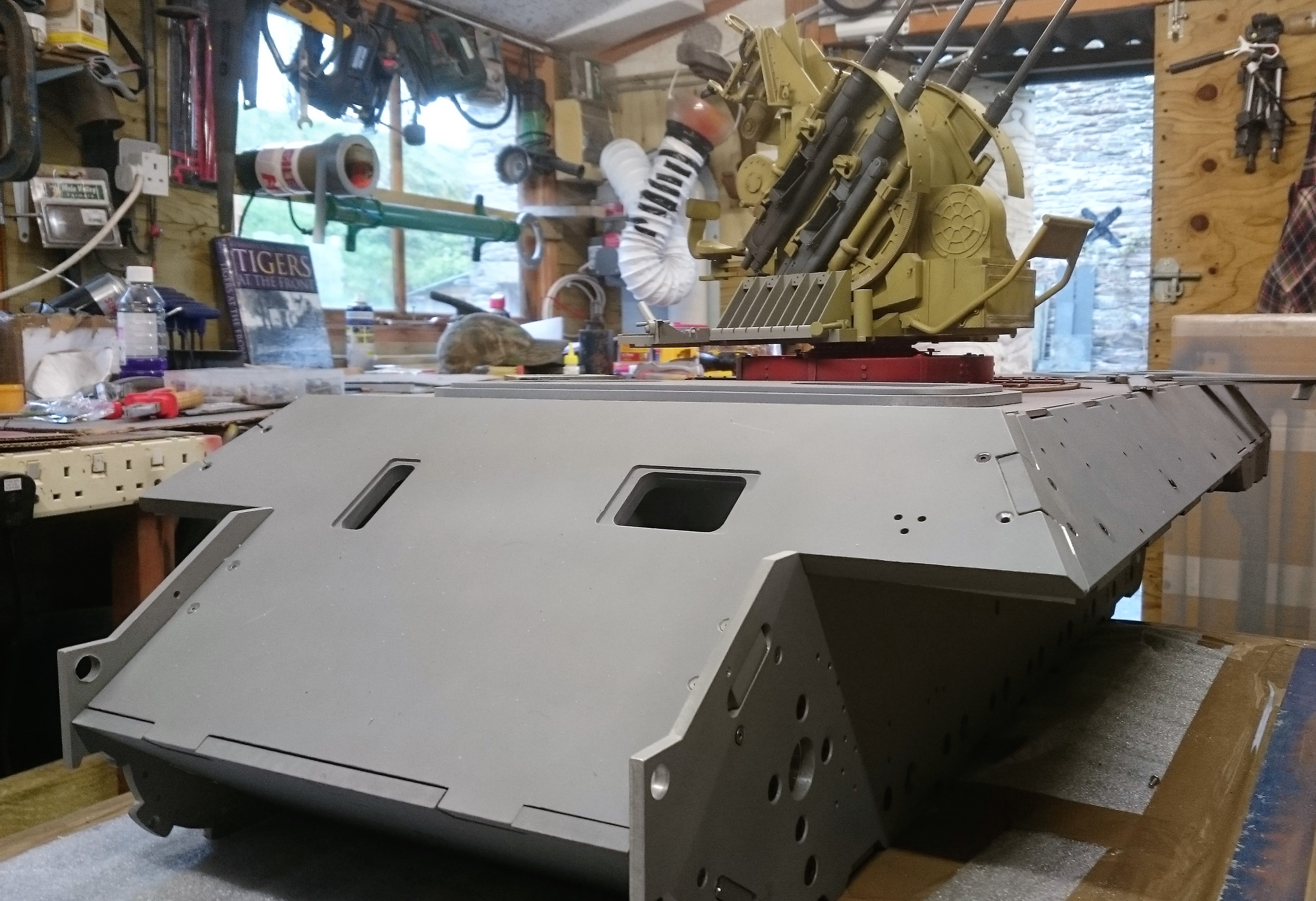

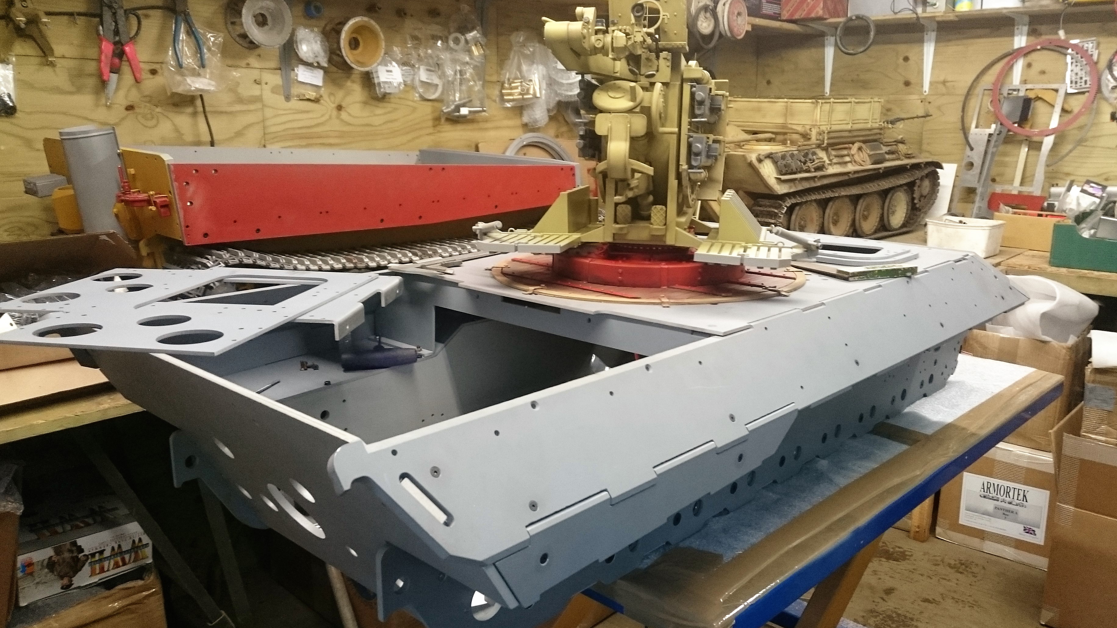

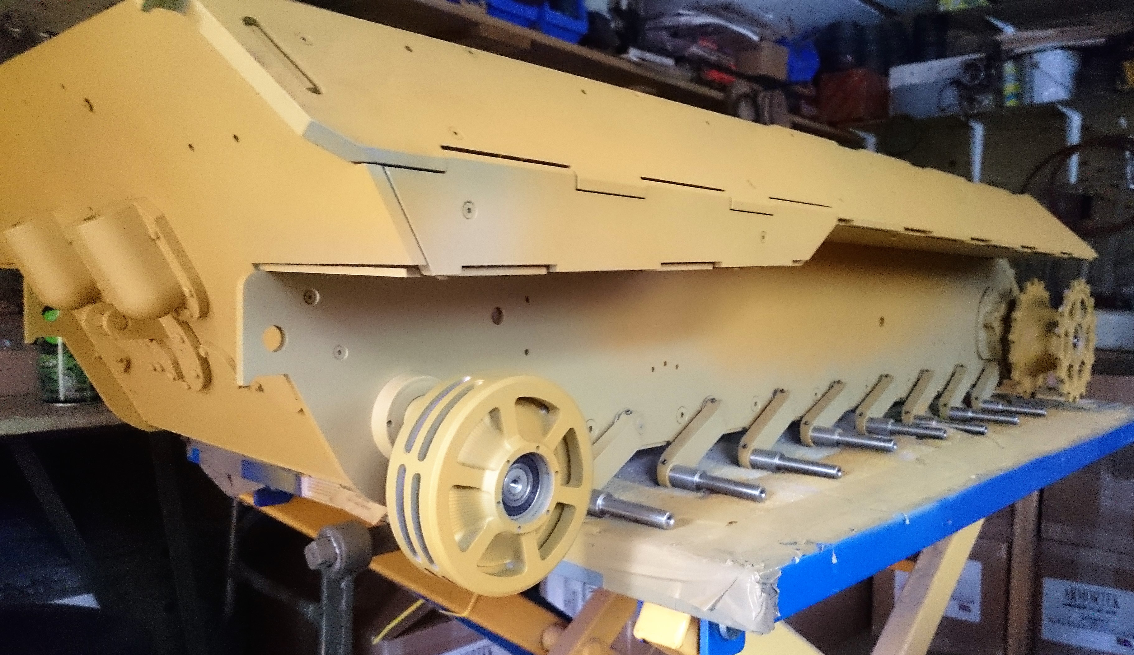

The new Panther "A" chassis build Flakvierling variant, fairly straight forward build from the box, just remember to keep everything square, build on a flat surface,I'm using a heavy duty handdraulic lift table, couldn't do without it now. Don't tighten chassis bolts until it's all fitting together correctly.
Everything is etch primed, I am using a new brand of etch with a very large fan nozzle, which really covers a huge area, making the painting of the large parts a breeze.(a very achievable 200mm fan wet edge).

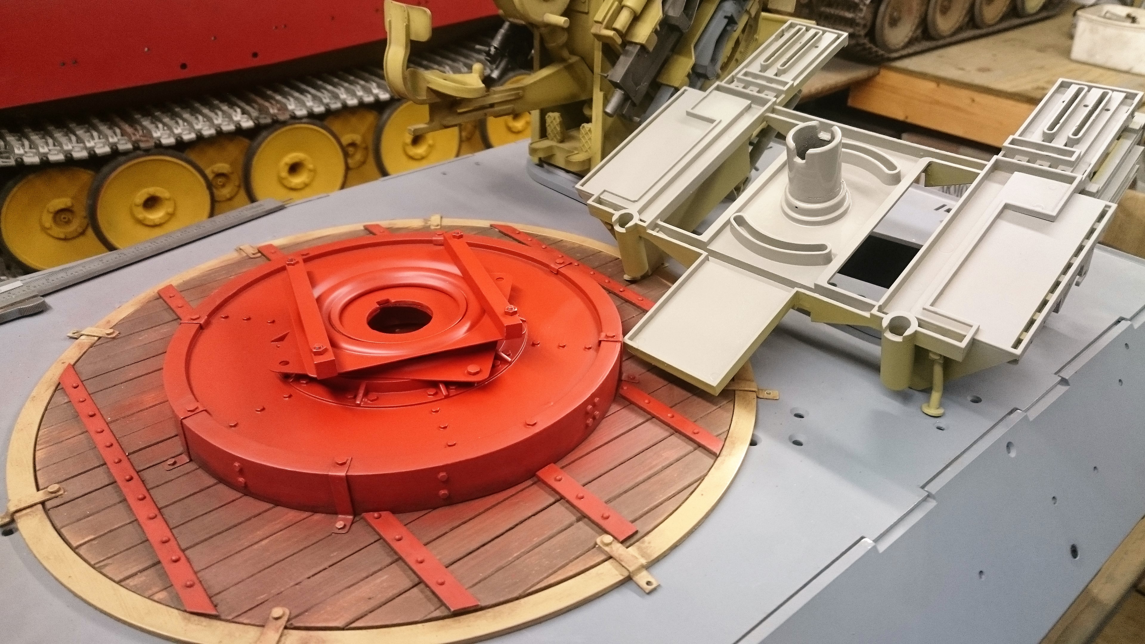

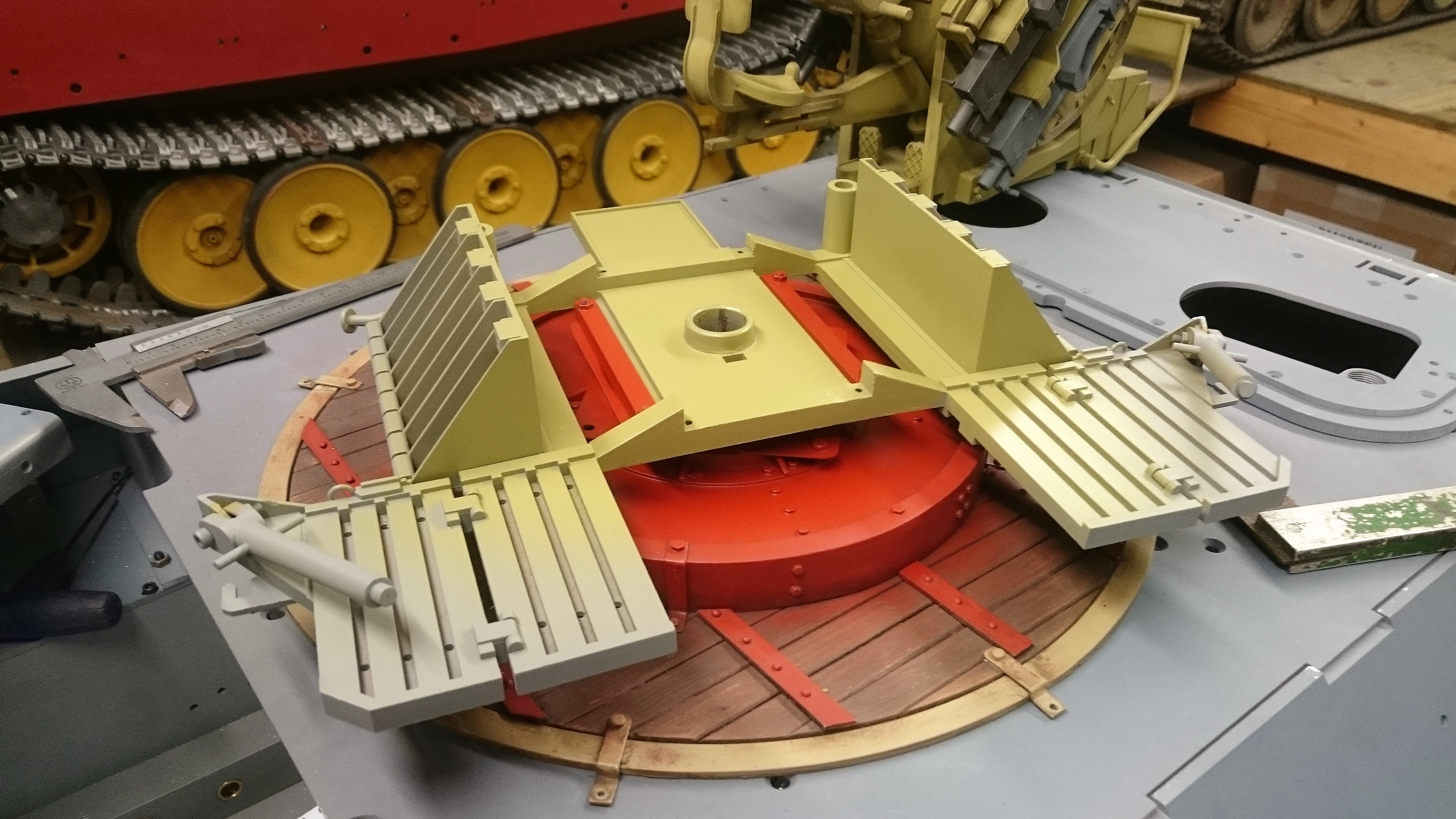

As usual I just can't help myself and have started work on the pointy bits, I needed to get the quad rotation drive system out of the way, I have kept it simple and robust. I have used a large high torque 360* metal geared servo for the rotating mech. An all metal "lazy Susan" for the all important thrust bearing which takes all the weight with ease (you could sit on that bearing and spin yourself around) and a simple dog coupling with a sacrificial male piece as a servo saver.

Hi Phil,
Another fascinating build to watch, love it :D Who do you get your Lazy Susan bearings from?
Phil
Re: Flakpanther/Flakvierling/2cmquad variant
Hi Phil, thanks I hope it will be fascinating if a little different, Ebay for the lazy Susan. Some are very similar to the kit turret bearings, I do have a 100mm of that type but the square section that I used looked more in keeping. Regards Phil

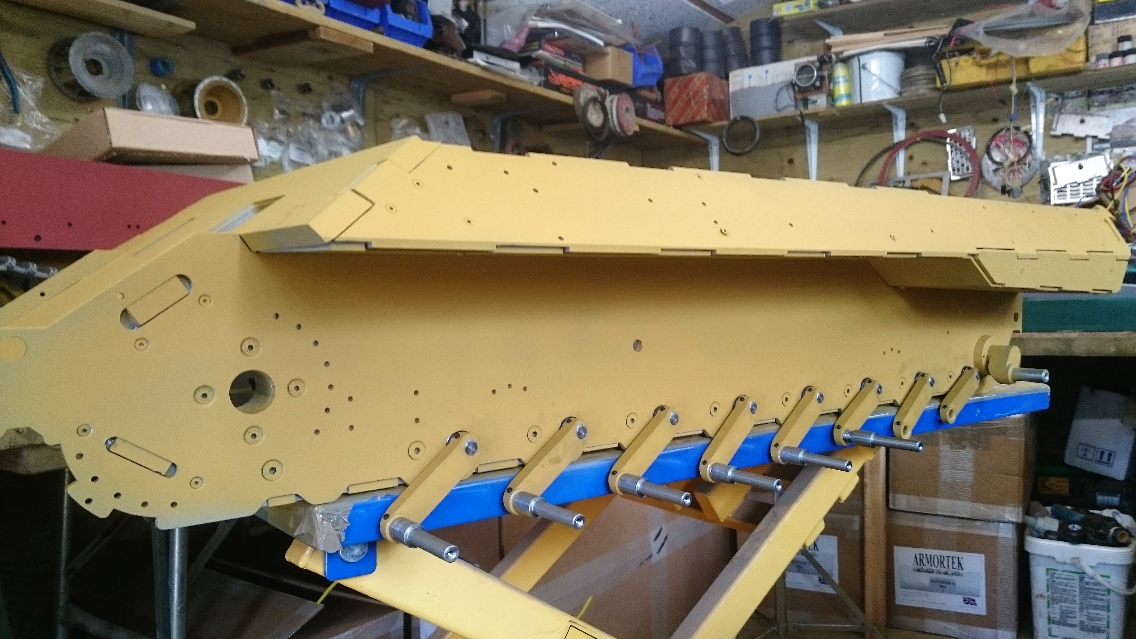

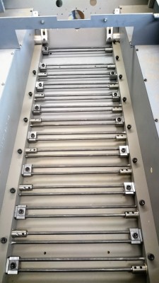

Double torsion bar system is just great and looks the business. I shall leave naked steel as its good contrast, maybe a clear coat to keep it fresh.
No dramas putting this lot together, although a stout rubber mallet will help no end.I'm not joking either , used correctly a mallet be it hide or rubber faced is a god send when fitting.

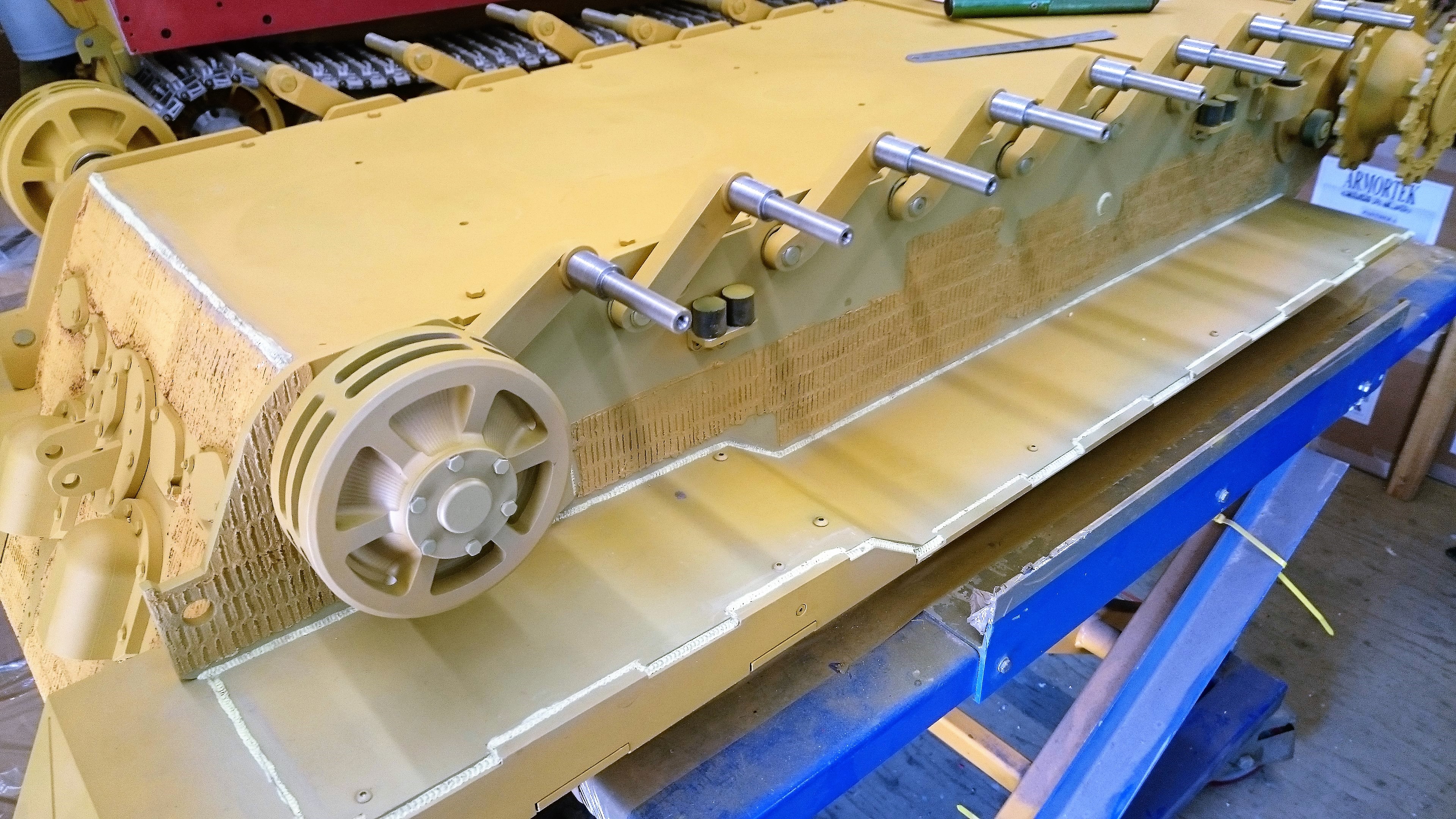

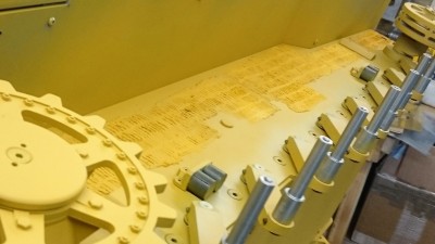

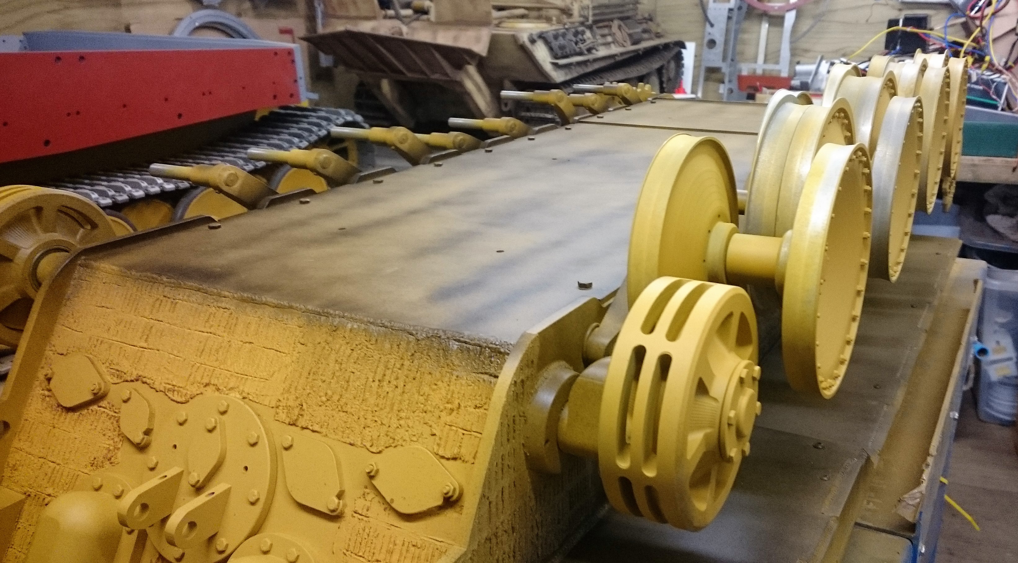

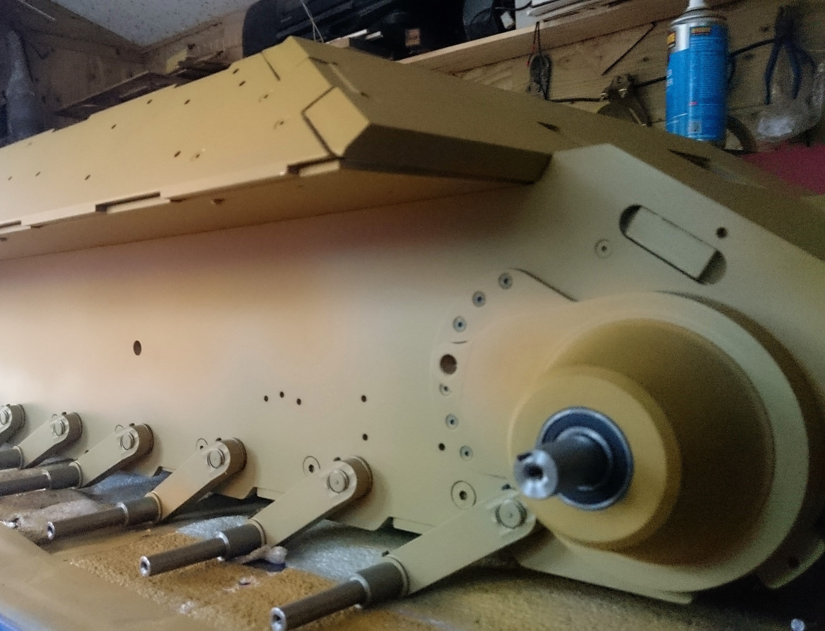

I have been prepping areas ready for some zim, it's a whole lot easier to apply the zim to the hull side before the wheels go on.
I have touched in the awkward and hard to get at areas around the suspension arms with TS3 spray paint, again do it now or those wheels will be on and off more times than a toilet light when the squits are in town!

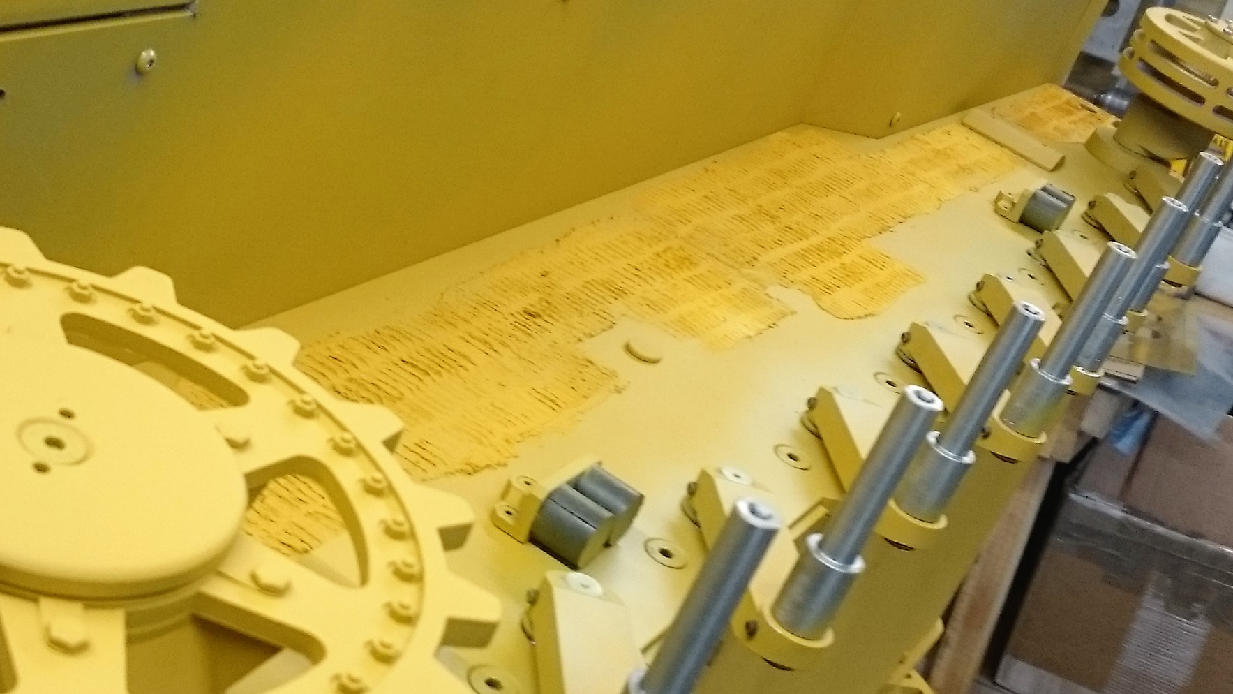

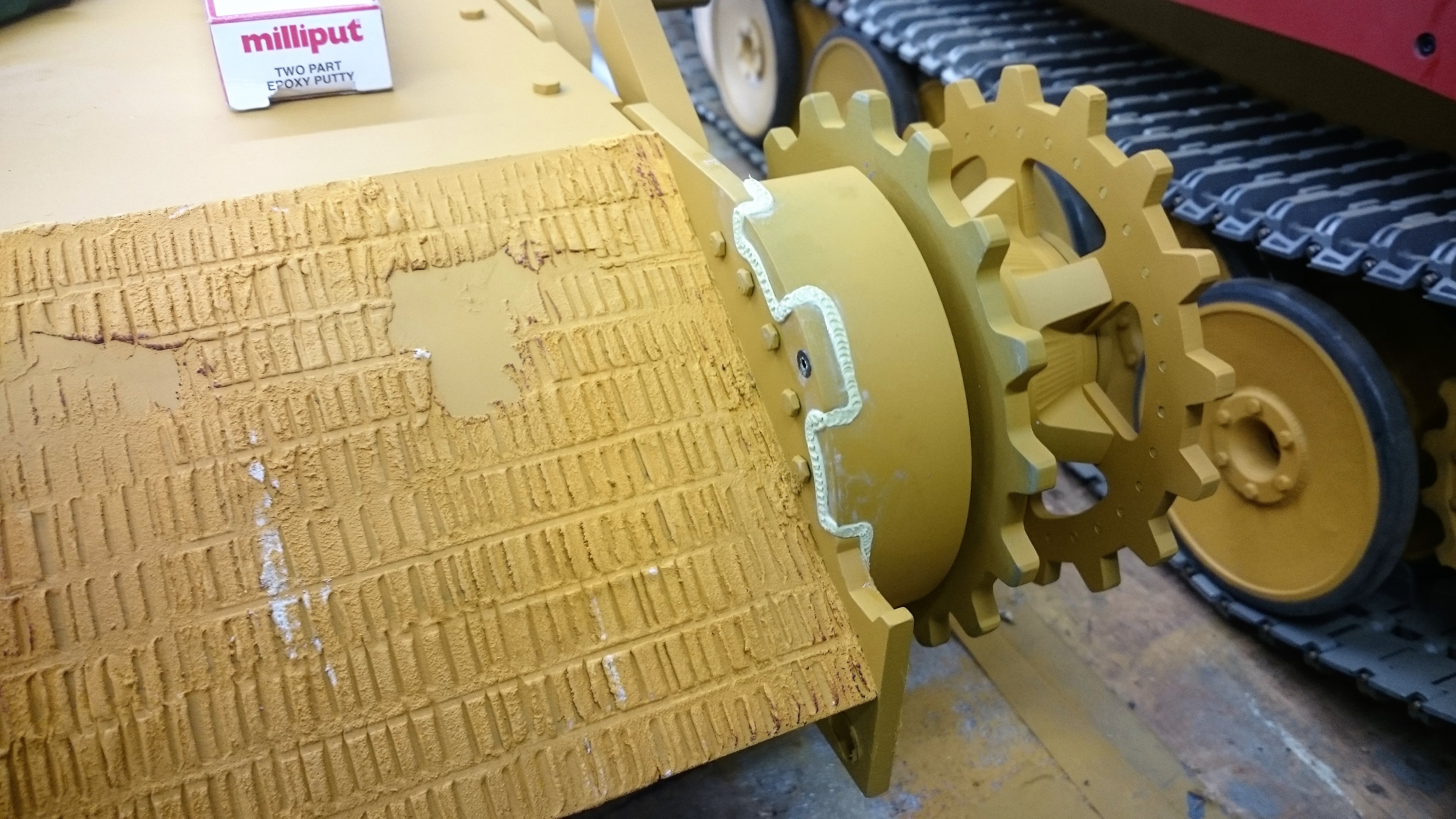

Some more progress, weld beads, weld beads, weld beads and the zimmerit applied to the hard to reach areas.

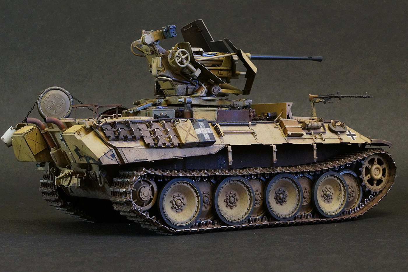

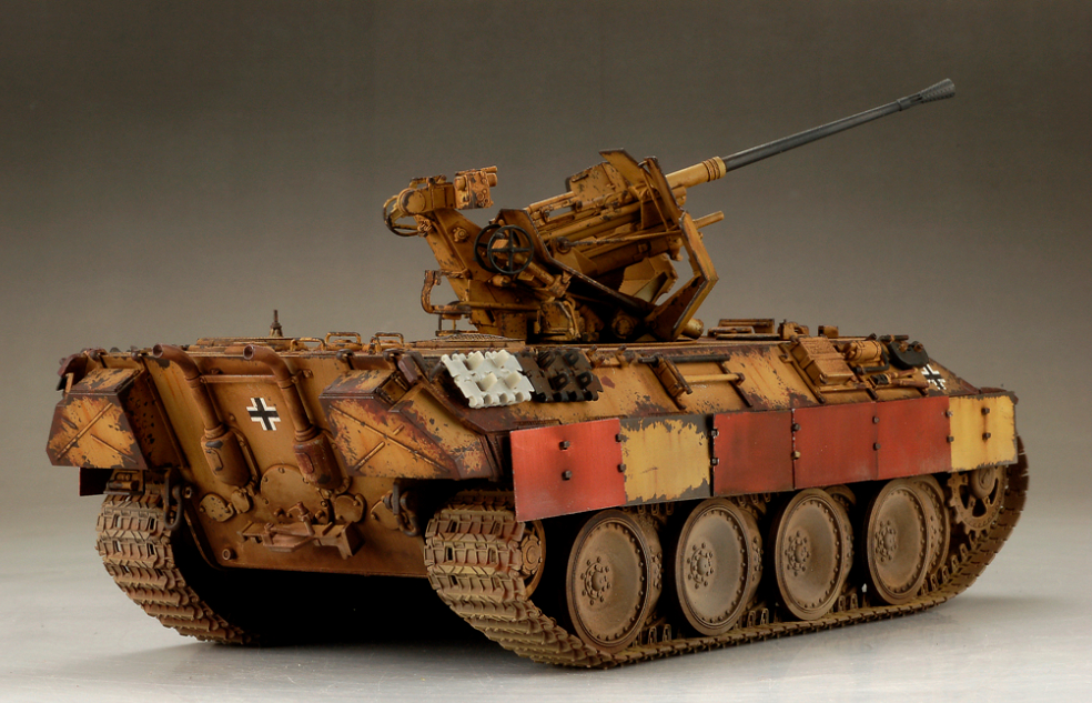

A few reference photos of smaller scale variants but very nice examples all the same.
the middle photo is superb, 1/35 i should think, an interesting vehicle, regards simon manning.
Hi Simon, now I like the last one, if it was my decision the Flakpanther or any of my vehicles would be a mono tone colour scheme, reason...the different camouflage schemes were intensely researched and applied to different theatres of war.For example a 3 colour scheme in 1/1 works fine and breaks up the out line of the vehicle making it more difficult to see and identify, but 1/6 in my opinion it's more contentious, ( it generally looks more like a model) a mono colour scheme works well in our scale in most conditions, (huge blades of grass and twigs the size of your arm not so prominent) and applying shade and weathering enhances this no end.
The Flakpanther customer would like a tri colour scheme similar to the first photo, so that is what he shall get! I can't wait to apply the pencil lines and fill in with the red/brown and green, now do I paint over the tools and fittings as would have been done in the field, or remove them, paint and replace? Decision decisions :D

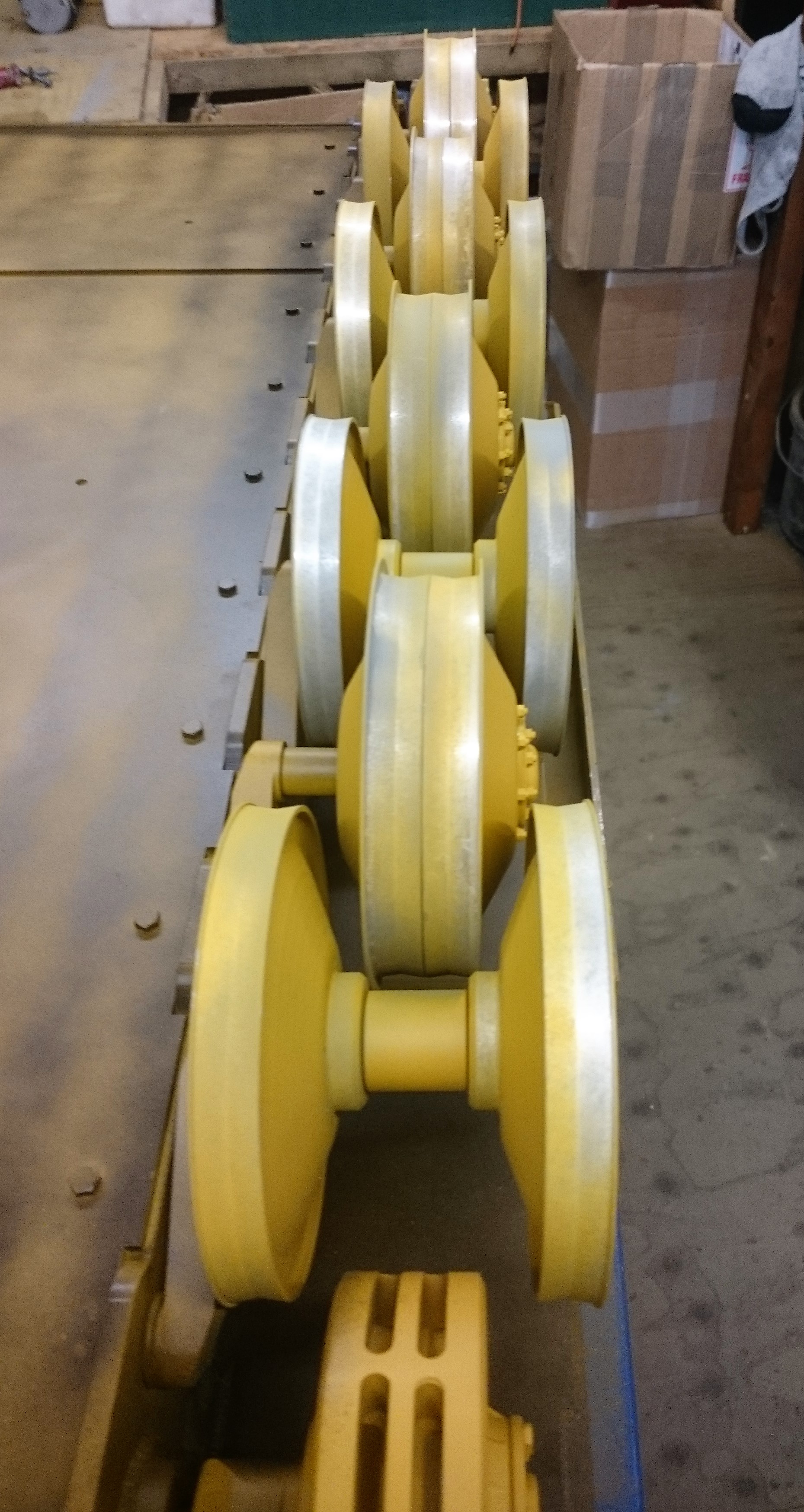

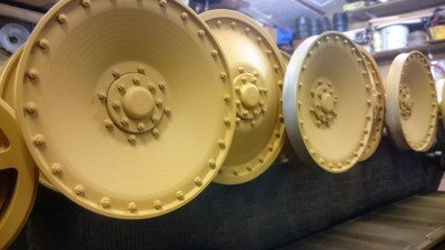

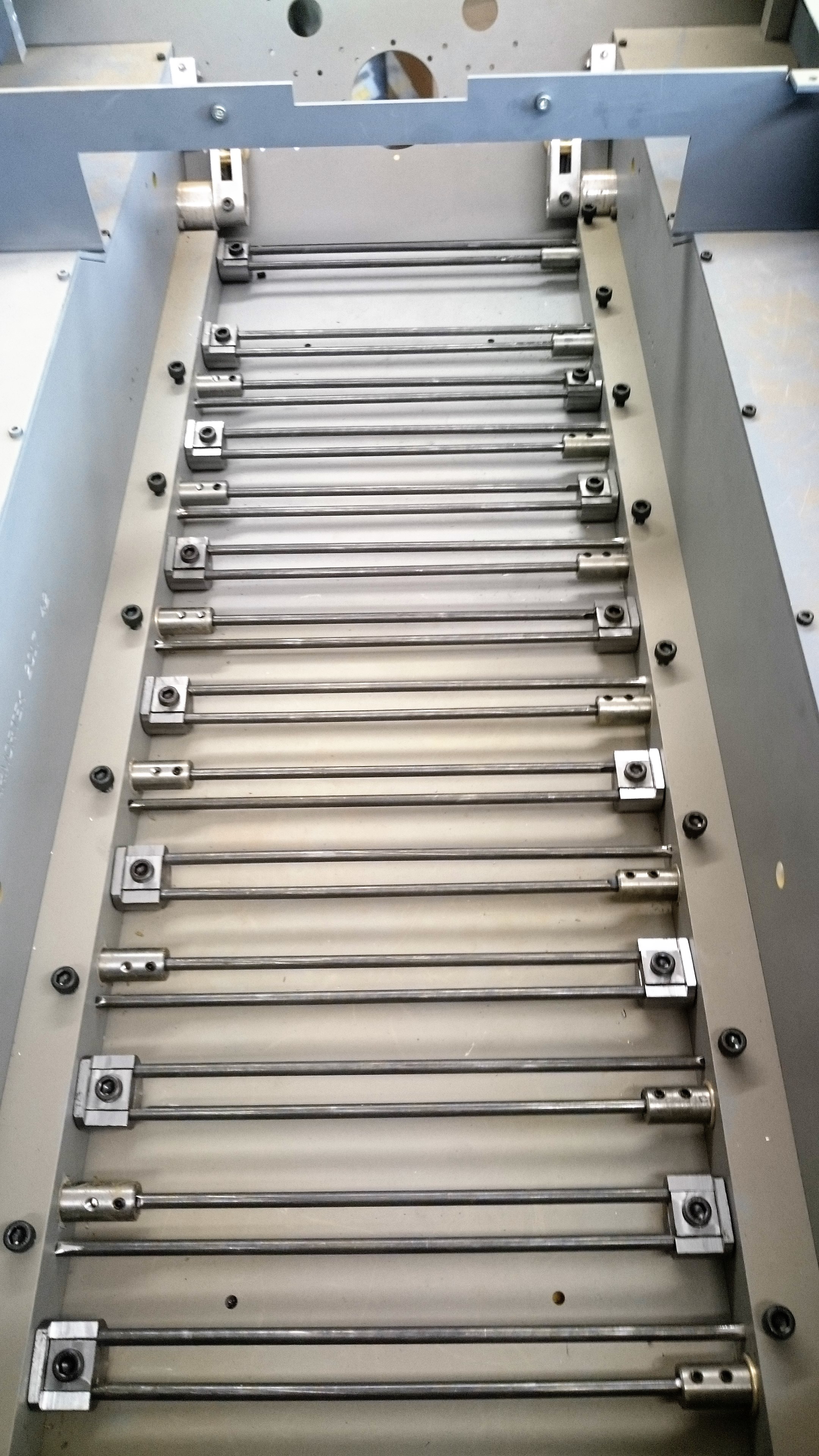

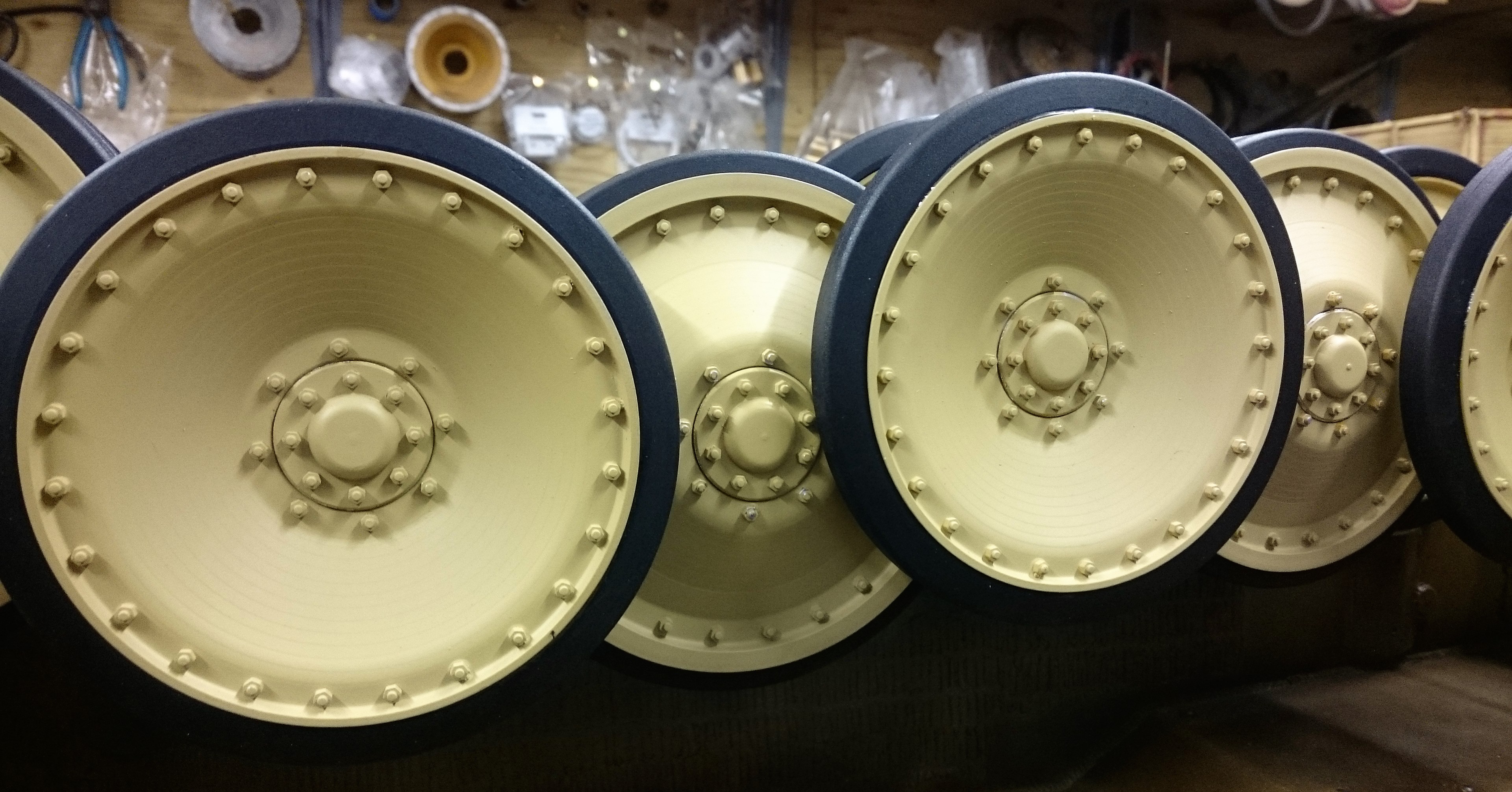

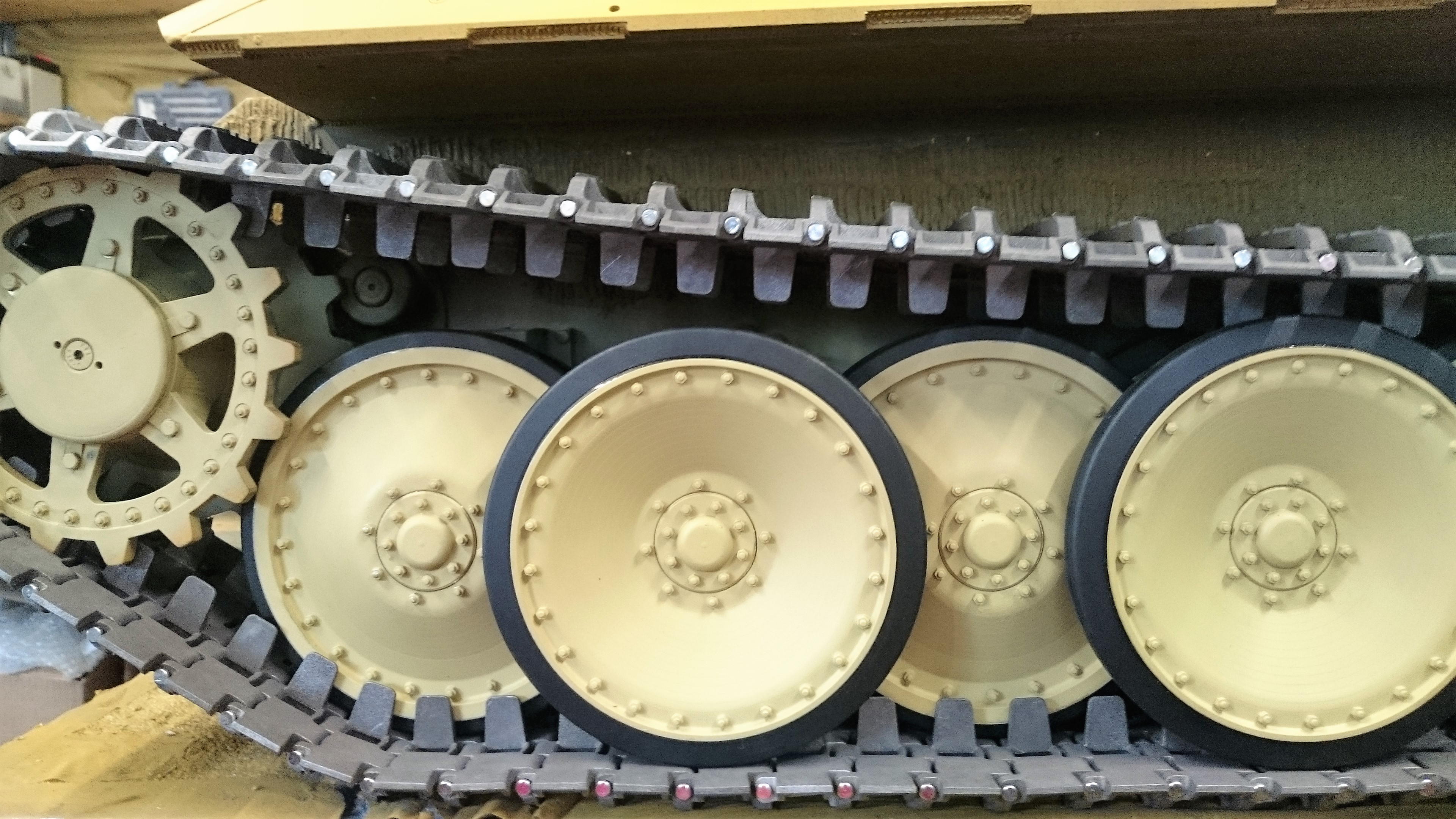

The wheels, a brief look at alignment while it's a turtle.
I have weathered the pannier floors, hull sides and the hull floor, these can easily be overlooked as you can't really see them when it's the right way up. The dark shading of the hull and panniers create a good contrast and so create the illusion of the size and weight of the real thing.
A top coat to the wheels, then epoxy resin adhesive to fix the tyres and she can be flipped over before it gets to heavy.

Don't you just love those wheels.

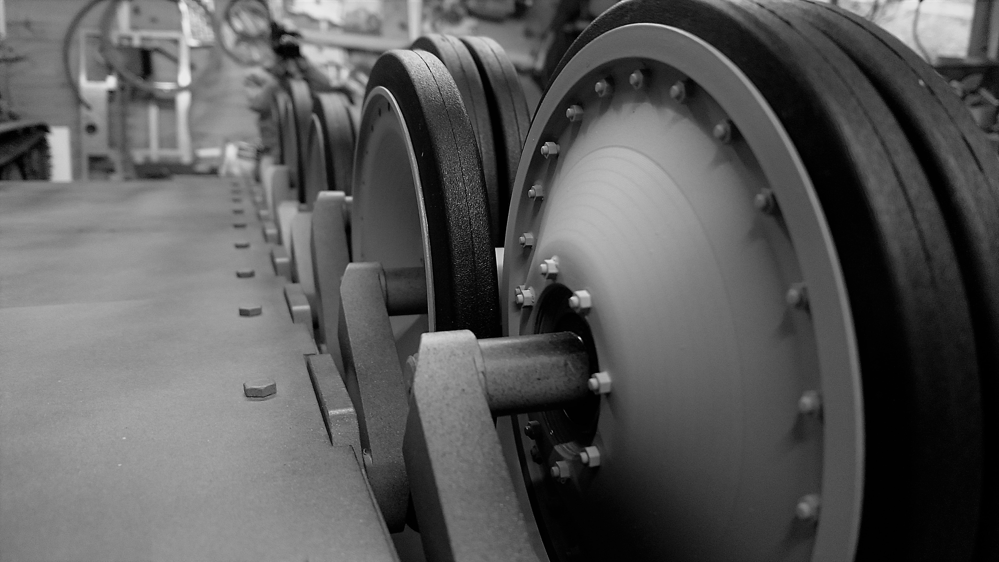

Near perfect alignment from the box.
If you leave the inner road wheel bearing next to the idler without cyno, you can slip it in place without removing the idler. The cyno bearing technique requires just a dot or two to hold in place.The same goes for the road wheel nearest the sprocket.

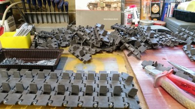

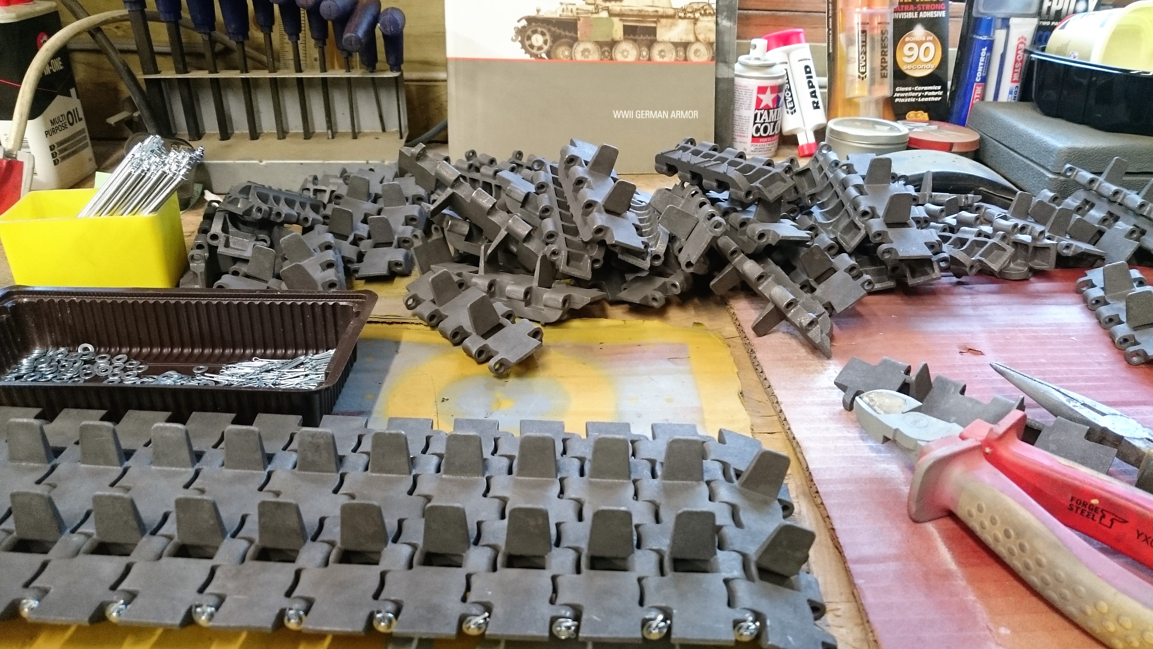

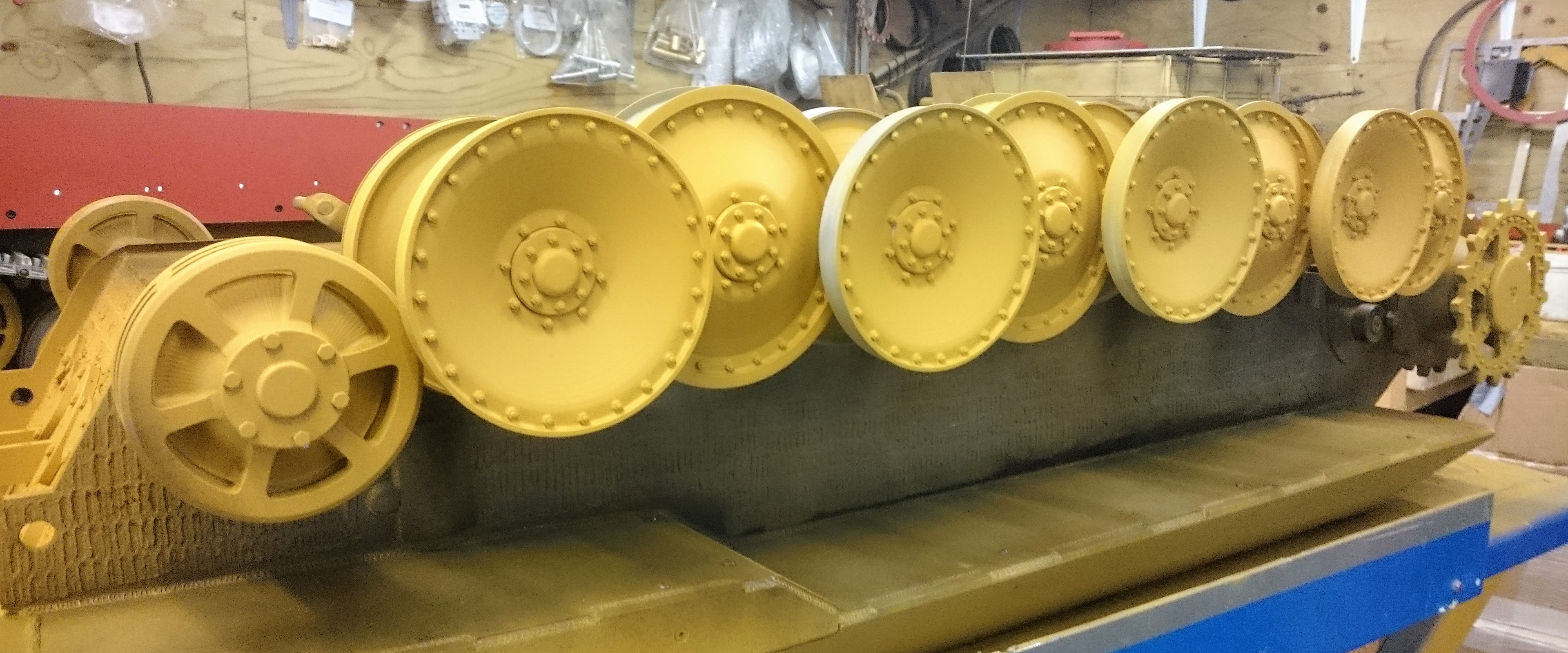

Those lovely wheels in place with tyres fitted, I shall leave over night for the epoxy to set really well as I don't want any flats on the tyres, in the mean time I have started putting together the tracks.

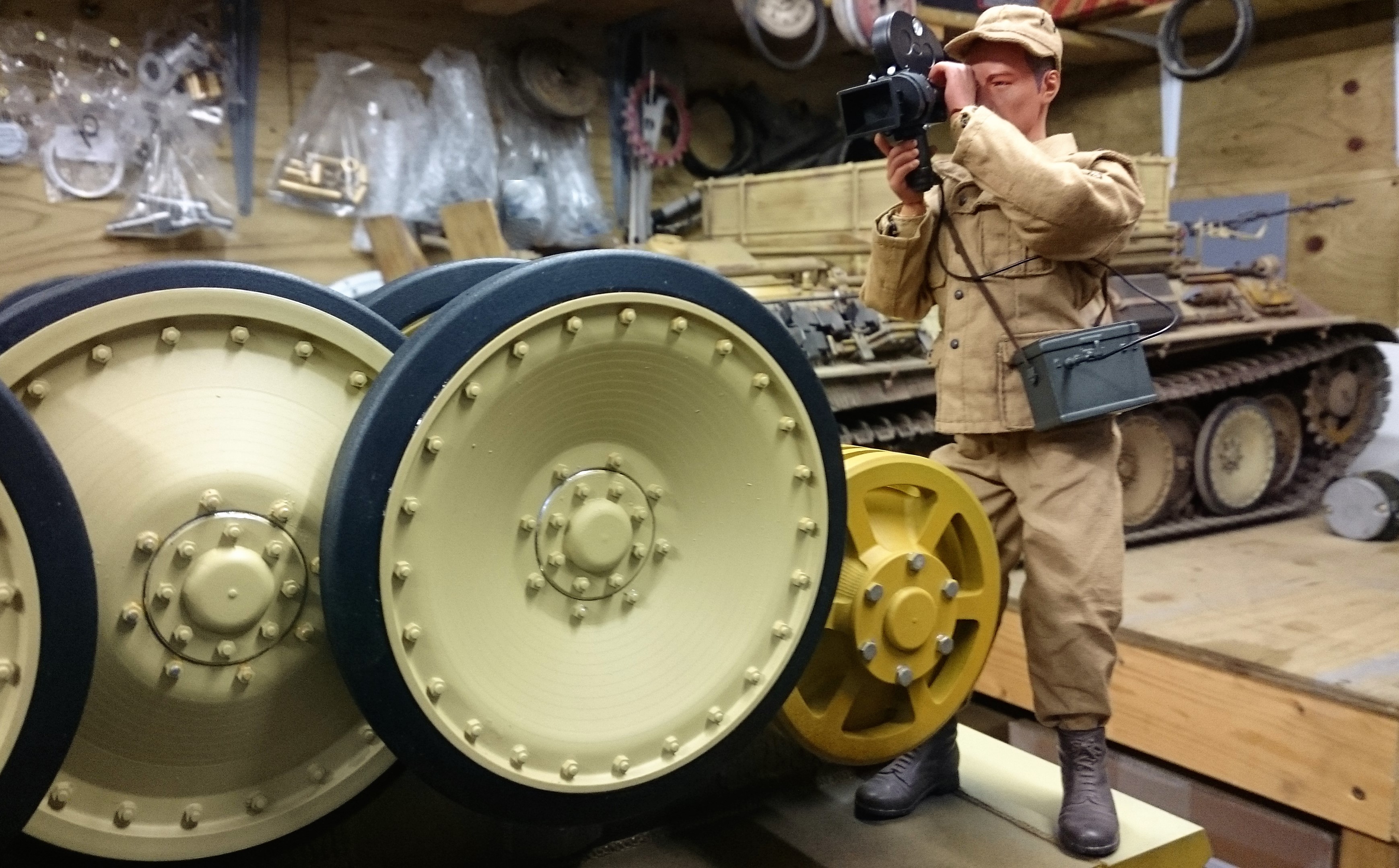

Got this new bloke started and all he wants to do is film every thing
I would say that you need to keep the paint away from the hub cover thread areas and use a soft wire brush to buff the threads with a smidge of light oil to prevent the ali on ali picking up
I have added extra false bolt/nut heads to the outer inner wheels
He's doing it again
He's doing it again
Not my favourite job in the build but need to get it done.

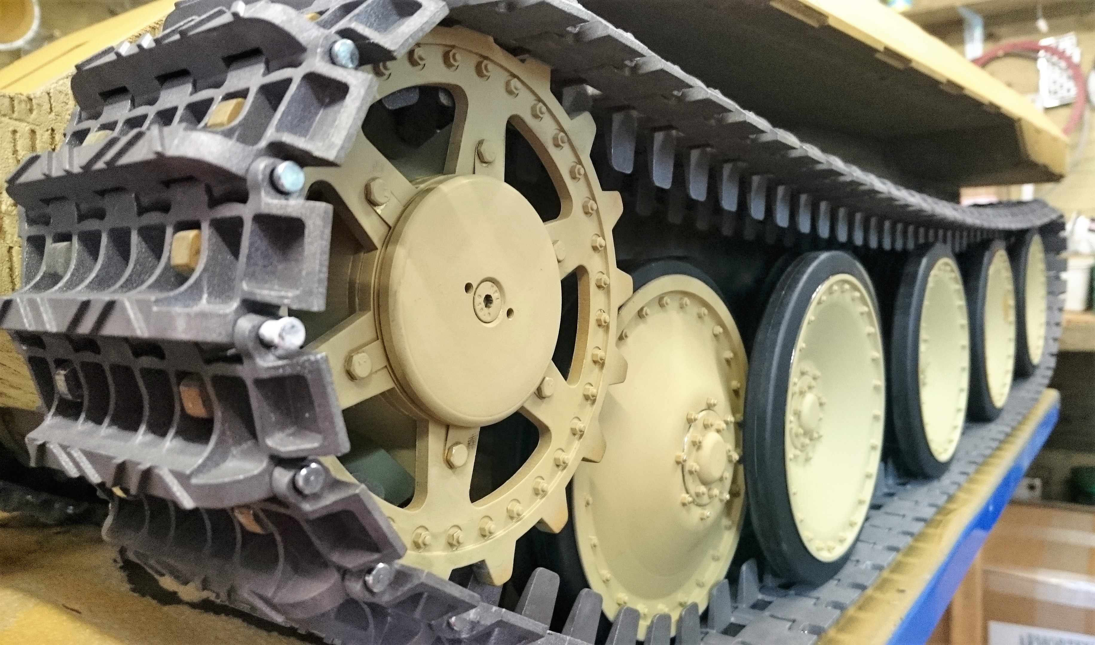

More progress, she's now on her tracks, it's such a mile stone to get this far.

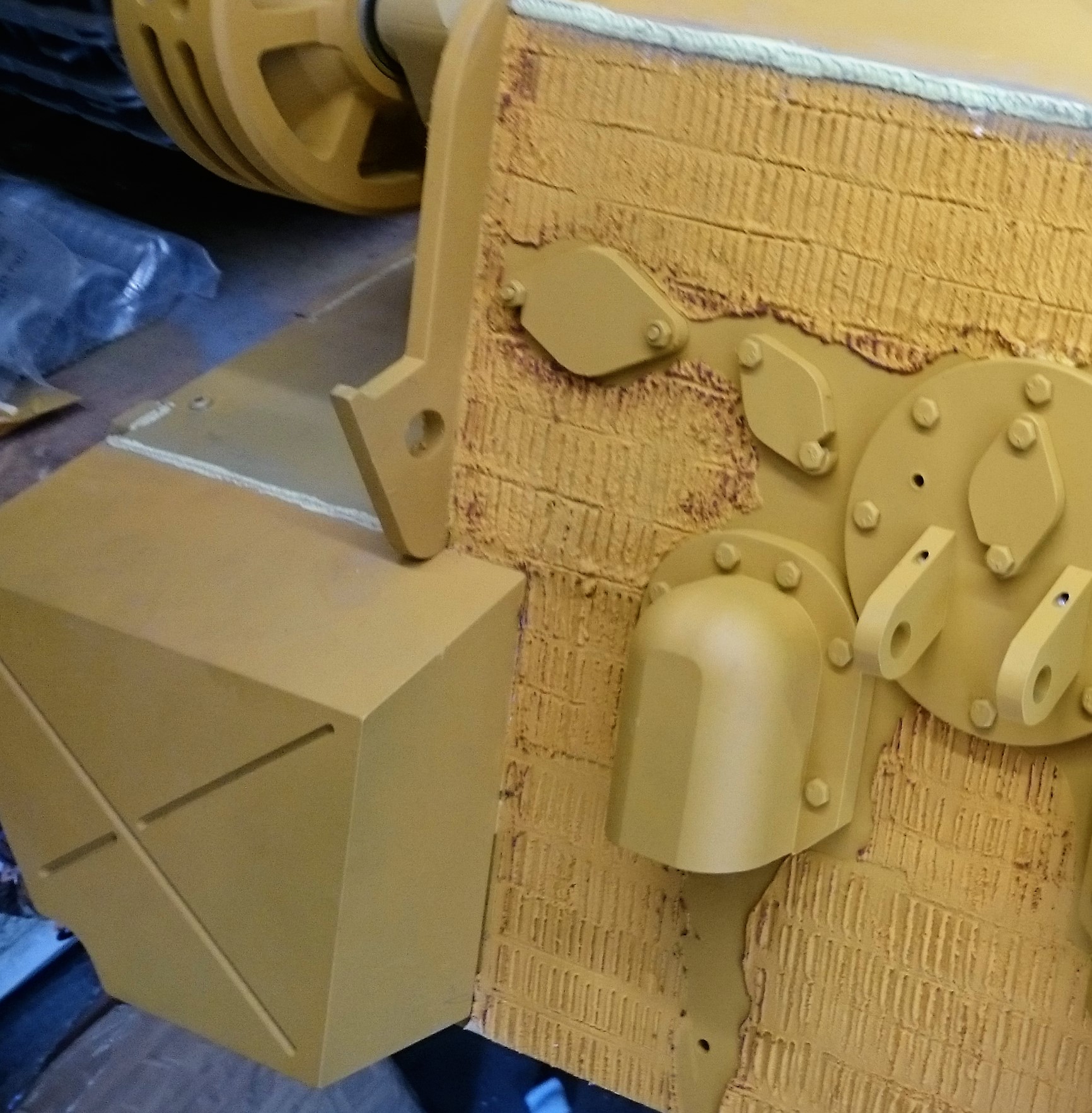

A question guys.....should the stiffening slots in the rear stowage bins be "outy" or "inny" ? I am guessing outy.
The loose track pin head is painted white for obvious reasons.
Tightish track tension but will soon bed in, 84 links and the idler almost fully forward to start with.
I shall paint/weather the tracks much later in the build as I am bound to get over spray on them at some point.

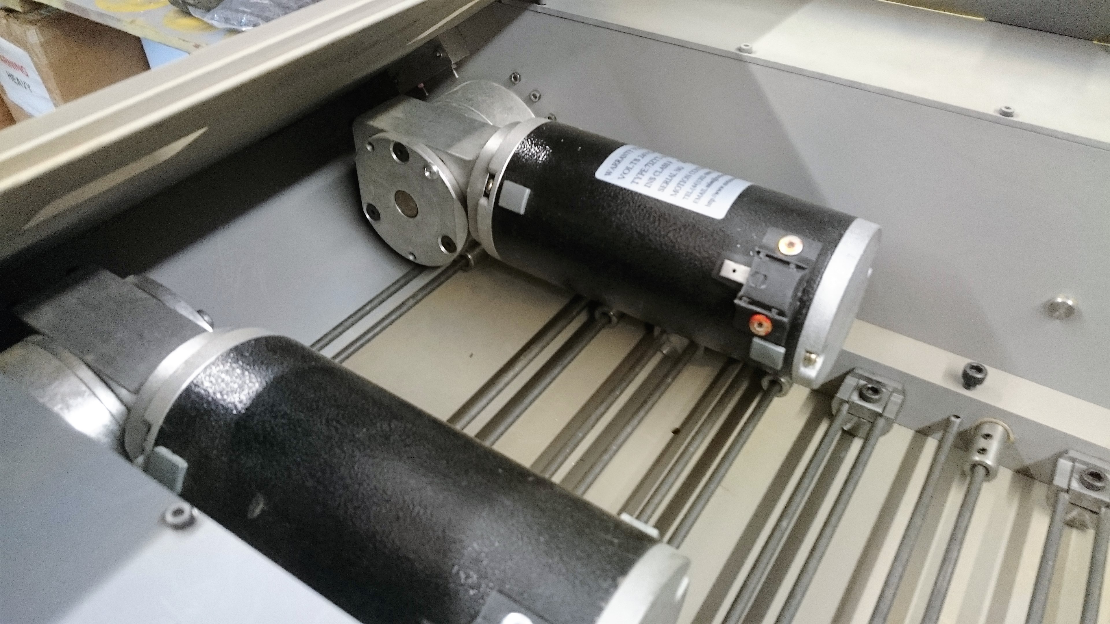

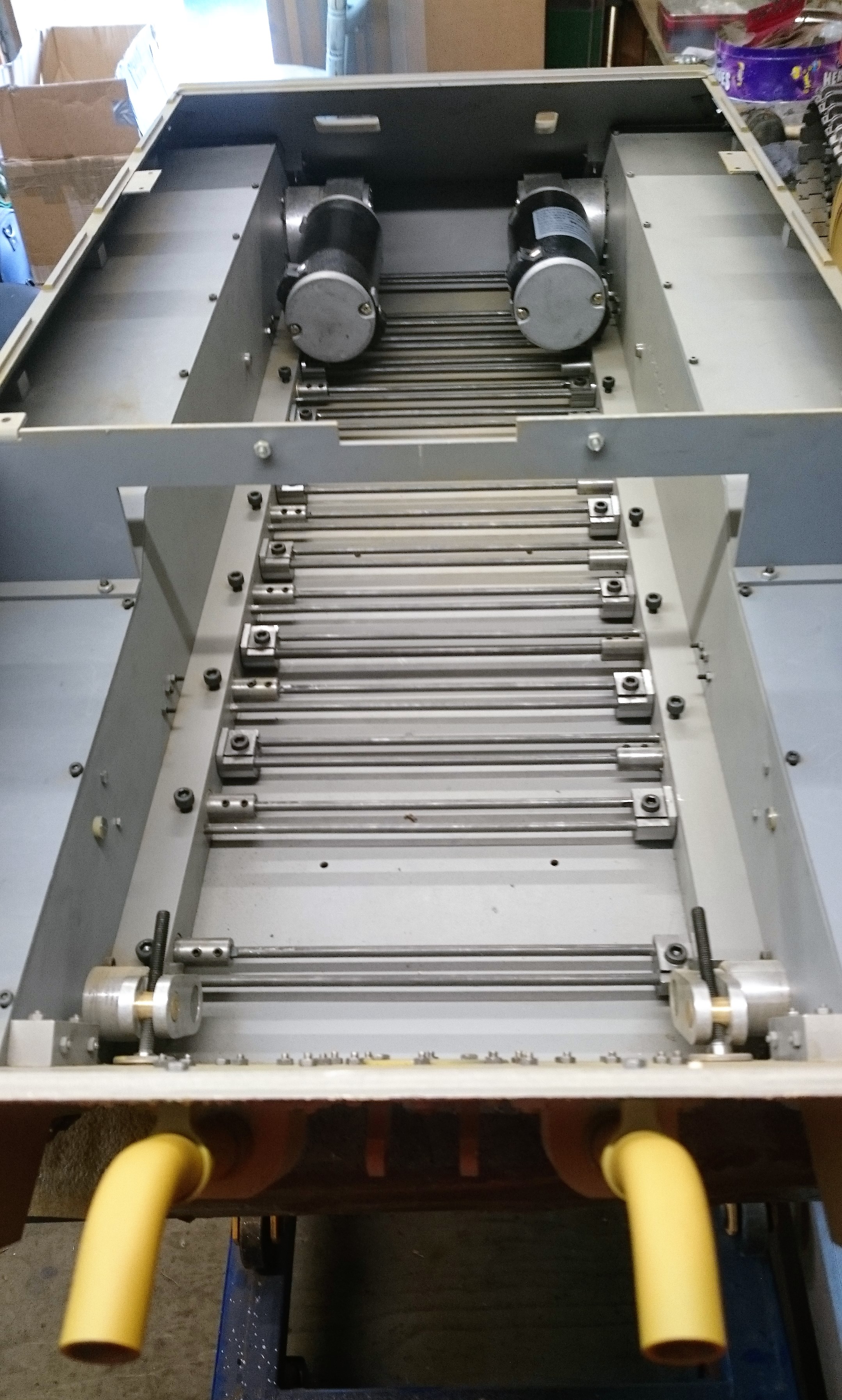

Test fitting the motors.

Hi Phil,
Nice progress, me like!
Regarding the box, always "outy".
But covered with zimm no one could tell...
Regarding the zimmerit on Bergepanthers Ausf A so please note in the photo abowe of one of the 50 made Demag Panthers Ausf A how the Demag zimmerit pattern looked like.
Very different from MAN, DB or MNH, but very much like the Tiger 1 pattern.
Demag Bergepanthers Ausf A had the same zimmerit pattern.
Kind regards
Kent
It´s all in the details!
Re: Flakpanther/Flakvierling/2cmquad variant "A"
Thanks Kent, very interesting photo to, I want a bit of contrast with the zimmerit so maybe apply to one bin and not the other, the stowage bins will have a plasticard profile to bring the stiffing groove out then. It's amazing just how rough the zimmerit was, have you ever seen evidence of vertical and horizontal tool marks on the same vehicle other than the application to the access plates? .......Phil
