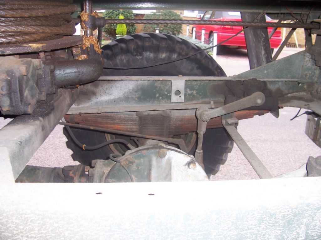

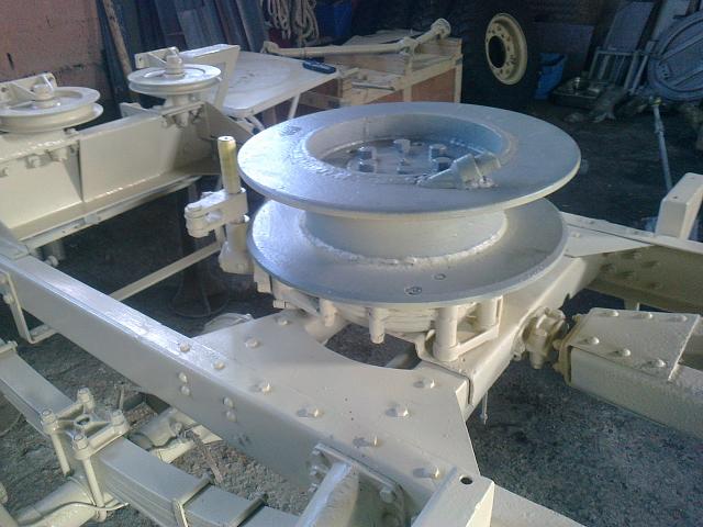

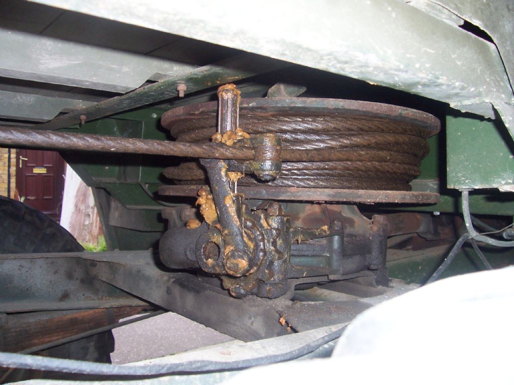

Re: Quad Winch Cable Diameter
hello phil,
I think your correct that the cable follows a figure of eight pattern, the picture shows the drum and pulley arrangement, there is a guide roller next to the drum so I presume the cable winds/exits the drum on the right hand side looking at it from back to front, goes around the n/s pulley anti clockwise then around the other pulley clockwise then out the back of the vehicle over a guide roller, I would think this was the arrangement to stop the winch pulling the cable against any of the bodywork.
cheers, Chris.
From what I can see of walkarounds, the object to the left of the main winch drum os a cable layer, which appears to move up and down as the winch rotates.
There is a set of vertical and horizontal cable rollers on the front nearside bumper on all the Quads I've looked at, so I can't think why they wouldn't use the same on the back to act as a guide.
The fact that there are two quite large diameter pulleys make me wonder whether they are there to assist with mechanical advantage, rather than just to act as a simple guide. Does anyone know if the Quad came with a snatch block ?
Also, the offside pulley is twice the thickness of the nearside one, which might mean the cable can be wrapped around twice ?
hello all,
looking at it now I think the n/s pulley is to direct the cable to the front pulley guides on the front bumper, so the winch can be used at the front of the vehicle. like Adrian said a lot of pictures of the quad have cable guides on the n/s front bumper so this would explain the other rear pulley position.
all the pictures I have seen of the cable only using the o/s pulley has the cable coming out of the back of the vehicle only.
