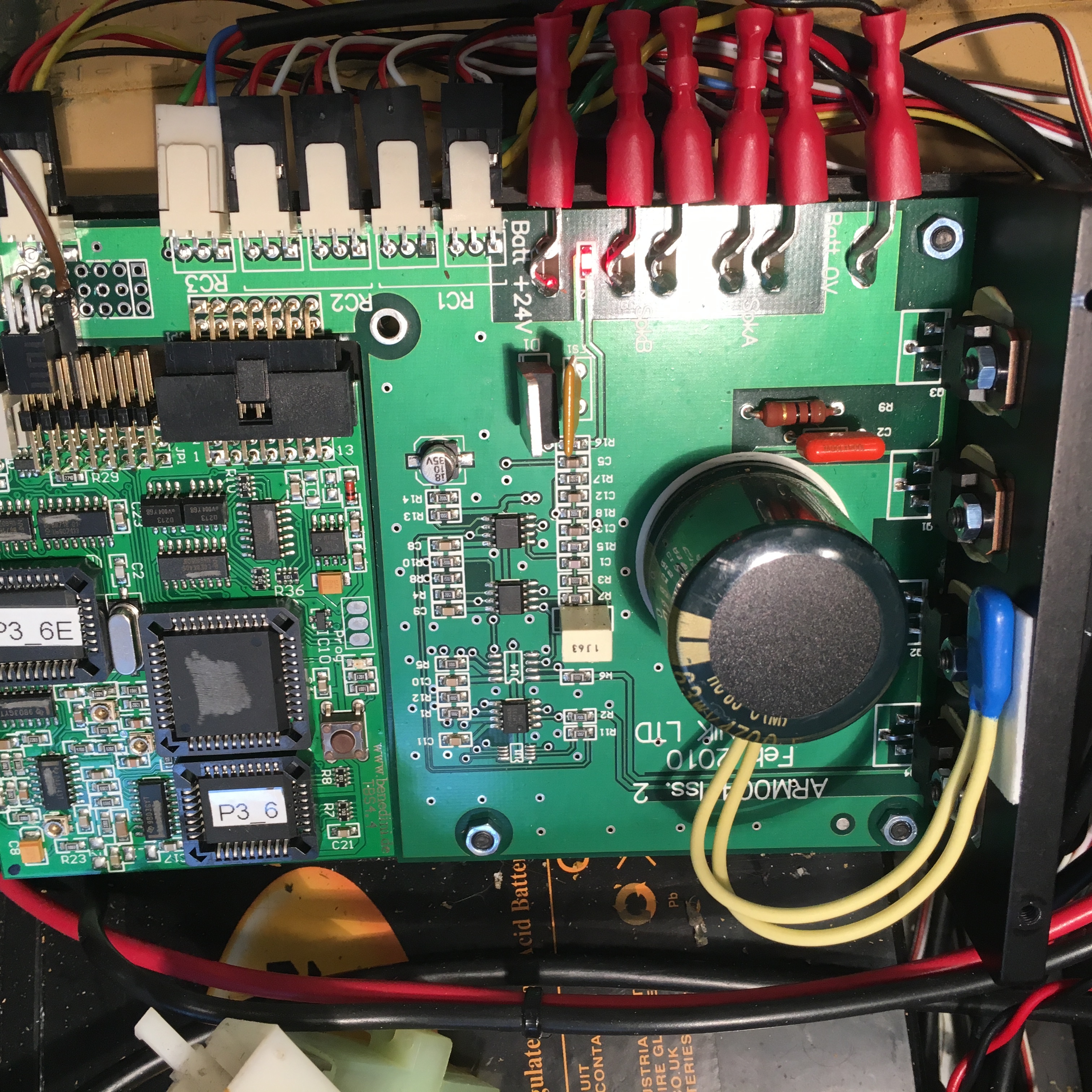

I think I may have inadvertently shorted the ServoRelayXL unit because the flash on start up I mentioned was in fact coming from that unit whereas if I remember correctly it was on all of the time before I investigated the fault in the LED on the top turret. Plus there is no response from the top left lever that dialled through the various functions which is I guess why the smoke has stopped working too.
So should I attempt to carry out the procedure you have mentioned knowing that I may have barffed the unit hopefully in the enclosed picture.

OK I tried the above method but the red LED on the module is permanently on, pressed the small button but no response at all. There is definitely a machine gun sound when turned on that eventually stops after about 30 seconds.
As I have mentioned the status light on the ServoRelayXL flashes momentarily but does not stay on as I think it used to and one of the wires I may have accidentally shorted leads straight to that module.
Posts: 5119

Disconnect the three pin servo plug and the brown lead which are on the very left hand edge of your picture and see if the sound system behaves normally.
The three pin plug is for the machine gun LEDs and the main gun recoil. The brown lead is for my smoker fan control unit. Neither of these are needed for the sound system to operate, they are there to react to sounds as they are played.
Posts: 5119
Has liked: 1475 times
Been liked: 1674 times
Re: Strange sound problem.
From that second picture, it doesn't look like the TBS5 is seated properly in the sockets, which might not help things.
It may have Velcro underneath, so you may need to lift the free end to be able to slide forward to seat it on to connectors properly.

Ok I have tried that and it makes no difference the red LED on the sound module continues to be constantly on and the machine gun type sound persists.
Looks like I may be in a bit of bother
