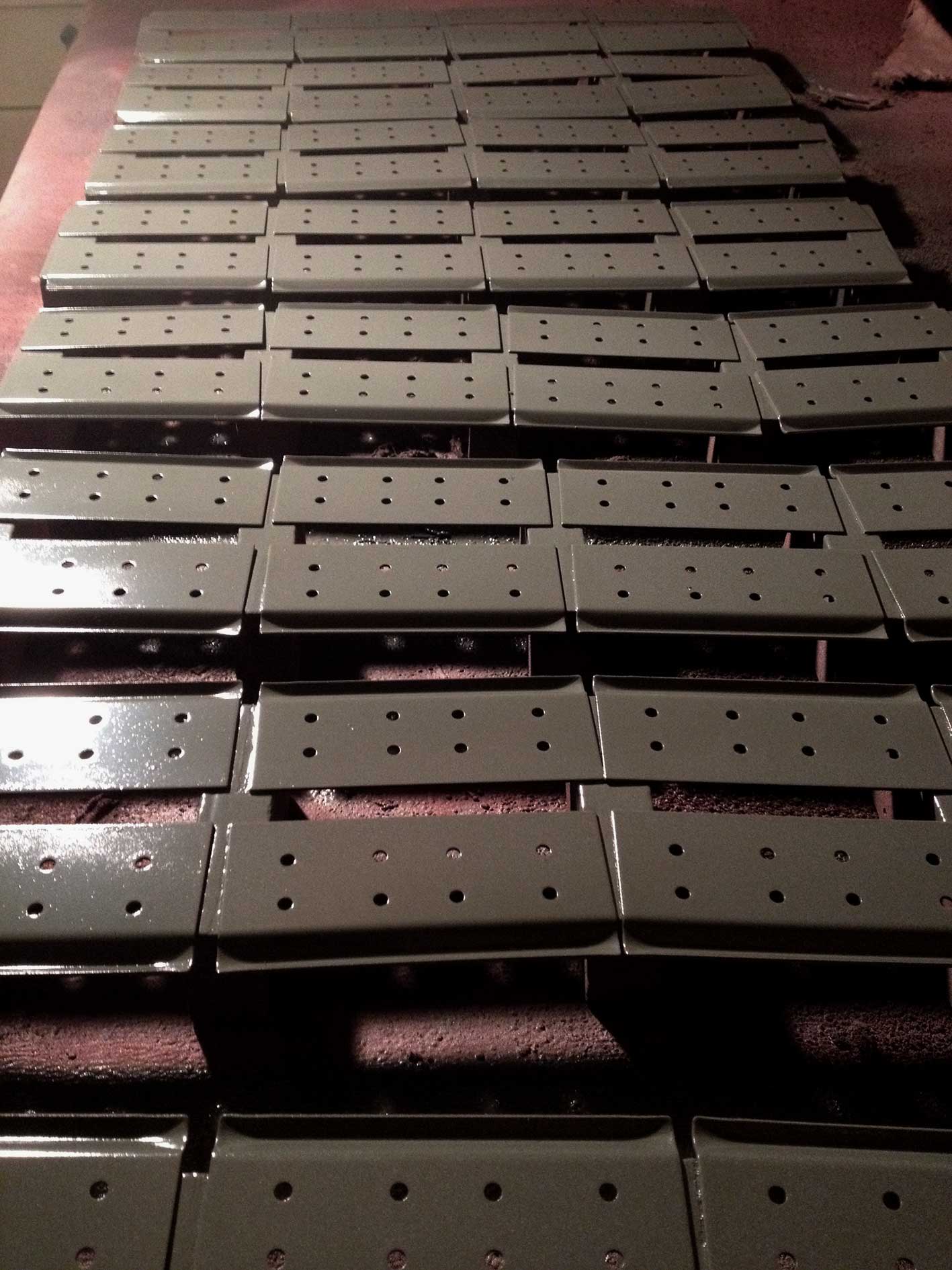

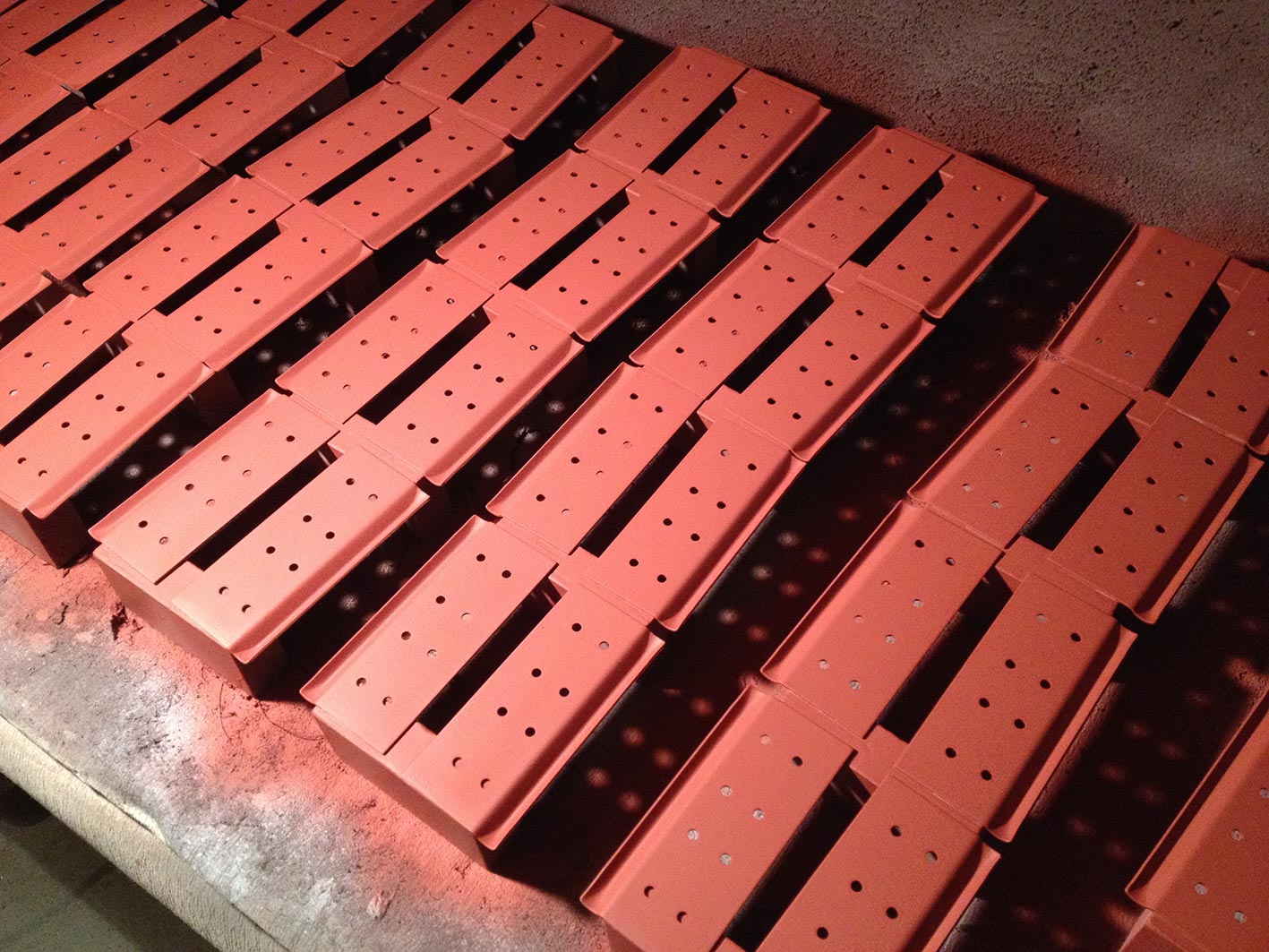

Hi Adrian,
for myself I answered this question in January by degreasing the track plates, sanding the inner side, using some U-Pol etch primer, afterwards oxid-primer and finally dark grey top coat. Maybe that’s to much rust prevention but I have a better feeling.

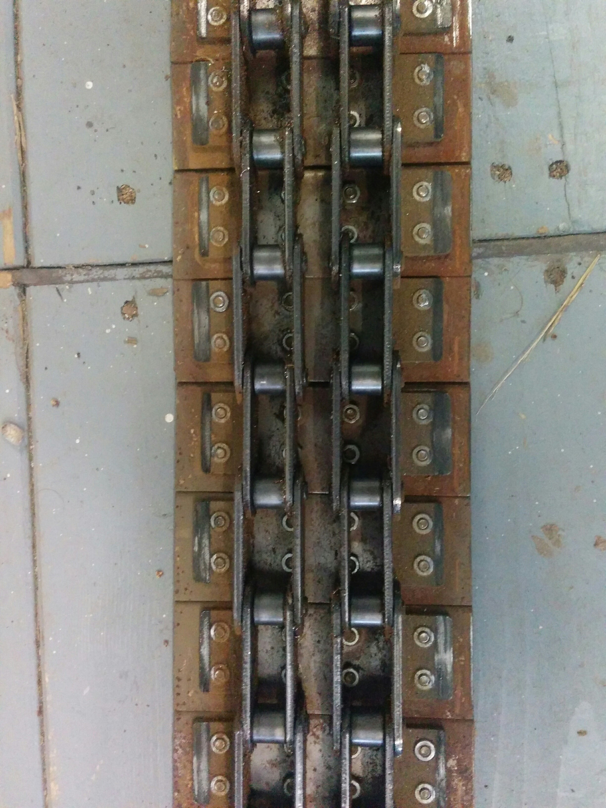

Re: Track link protection
Having removed the lefthand track from my Mark IV (as part of the process to fix the bad track slippage issue it developed at Tankfest) I can share the state of my untreated tracks with approx eighteen months worth of usage.
I will put up some more pics of the general state of the track runs and the wear patterns tomorrow for reference in case anyone is interested.
Many thanks for the picture Daniel.
It's interesting to see the witness marks on the links, although I admit I don't know where they are rubbing, but more pictures are sure to help.
I wonder if more rubbing strips might ease the rubbing, and reduce friction in the process
That looks quite reassuring. The chain looks in good shape, so the only question is over the track plates. Some shots around the track run will be of great interest.
