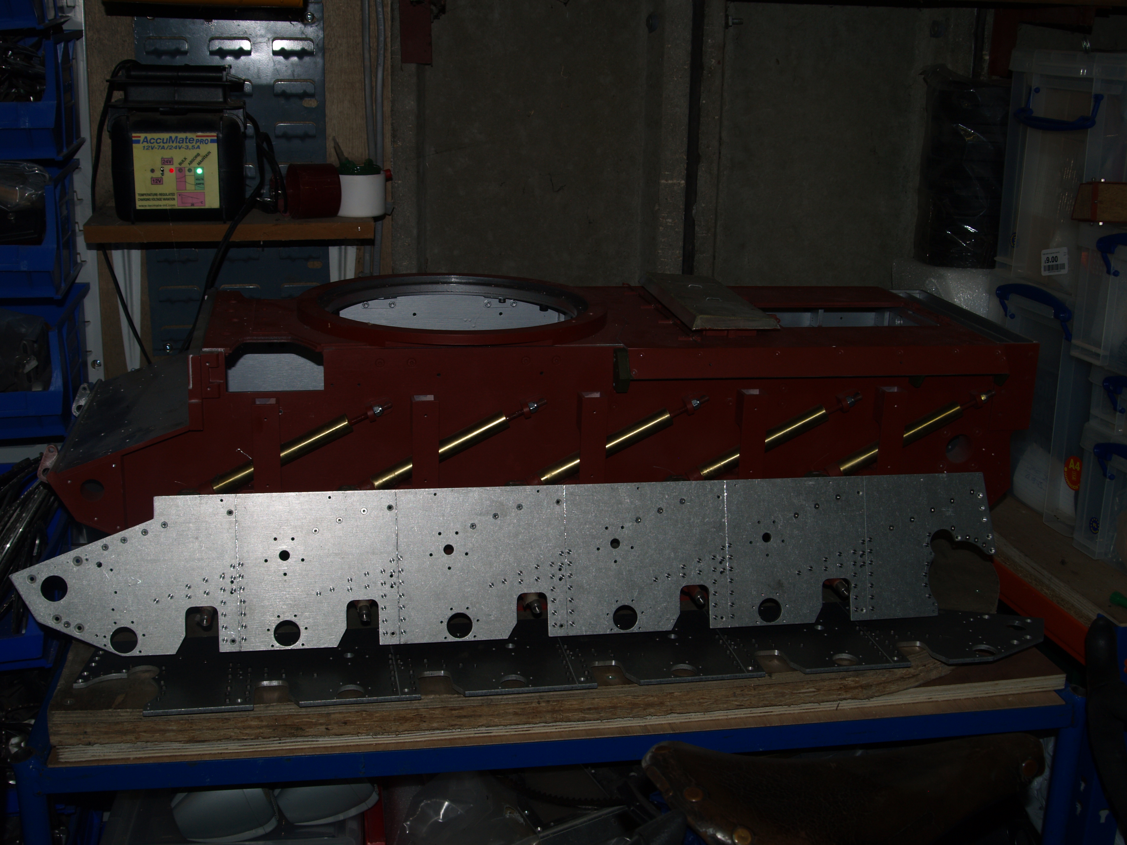

It starts with a few small steps..... Comet No 34 is now organised for building.

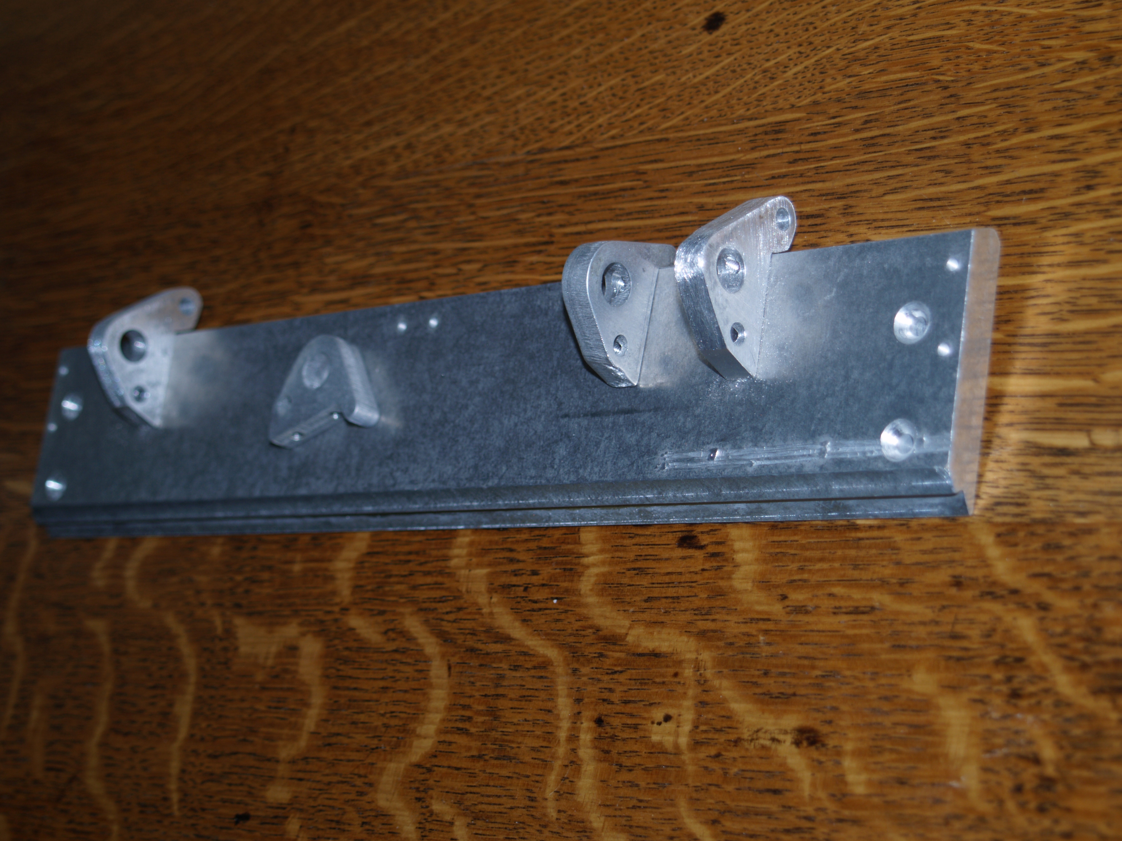

Following Stephen White's prompt with regard to the Front Tow Hooks I have remade them with the upper eyes! The Rear Deck is the next step, but somewhat bigger!

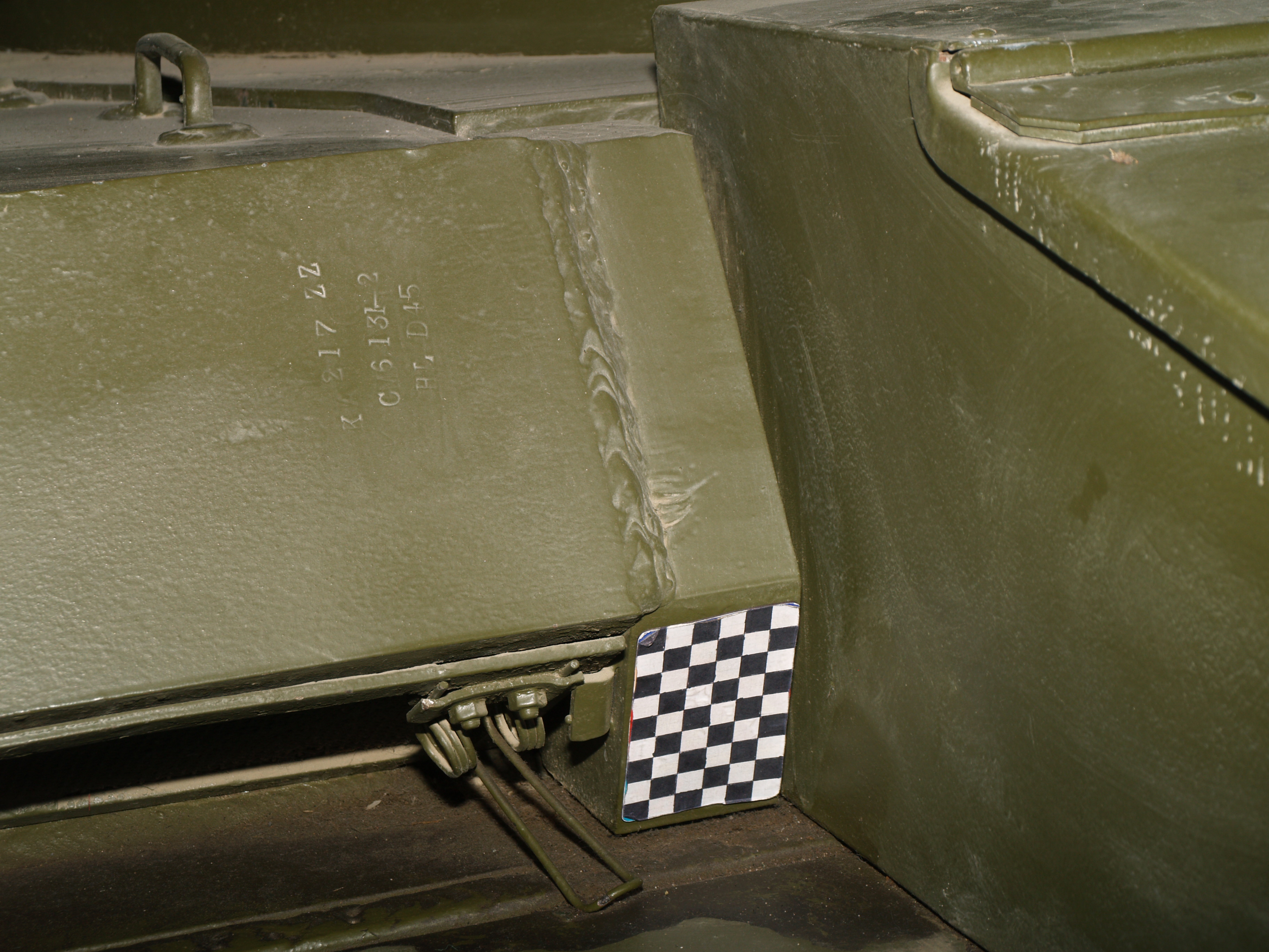

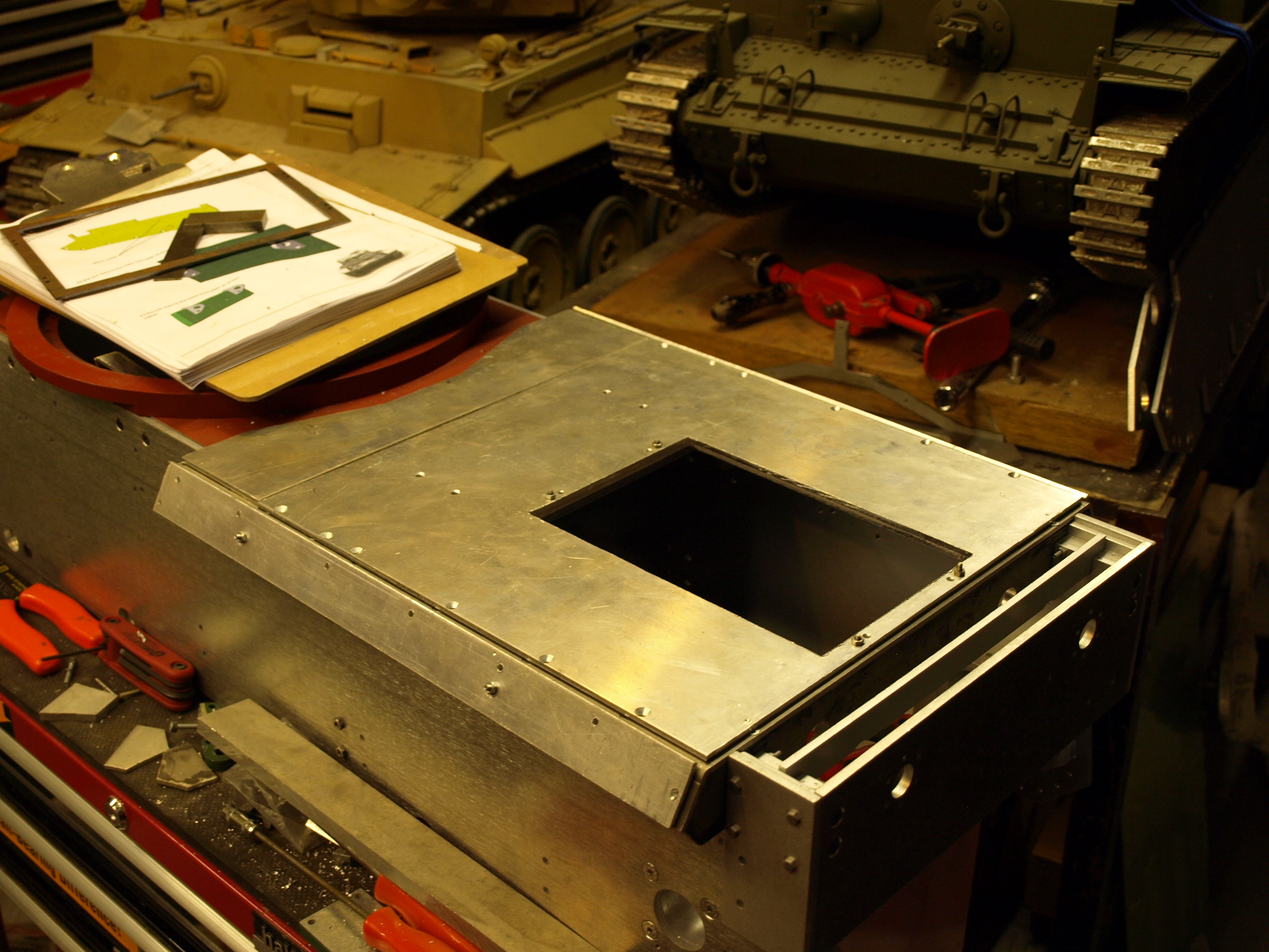

The Rear Deck is an area which needs a bit of attention. The side plates need a sharp top edge, which is found on the Cromwell where they are bolted on, the Comets Plates are welded which makes things simpler. The Hatches on the Forward End of the Deck need to be larger, so it is easier to remake with a new sheet of aluminium the whole top.
This photo is a close up which roughly indicates the area, as I write this I realise I will need to find a better one! To remake the deck I have milled some angled fillets to join the parts together, I have bolted these to the under side of the original deck and drilled the bolt holes necessary for securing the new deck together once the counter sunk bolts I have ordered arrive.
These photos show this initial stage. This is just a progress report, once I have the bolts fitted I can produce some photos to show what I am trying to achieve with this work.

I have followed up this link; https://nl-nl.facebook.com/pages/BAIV-B ... 7456456403 This from the Comet wanted posting placed by Armortek.
Very interesting to see the interior of the hull. Some photos have relevance to the rear deck. I feel that I will have to compromise so as to achieve strength in the model, plus serviceability in the model and this helps in my planning.

Slow progress on the deck, it is going round in circles to get everything in place to get to the details. My aim is to have a strong structure for the deck and the hull as the deck is not going to be bolted down.

Re: Comet No 34
Hi Steve,
I bolted a piece of angle to one of the bearers and then a bolt with a wing nut under the vent which can be accessed from the rear hatches, easy to remove rear deck and just fixed with one bolt.
Dennis.

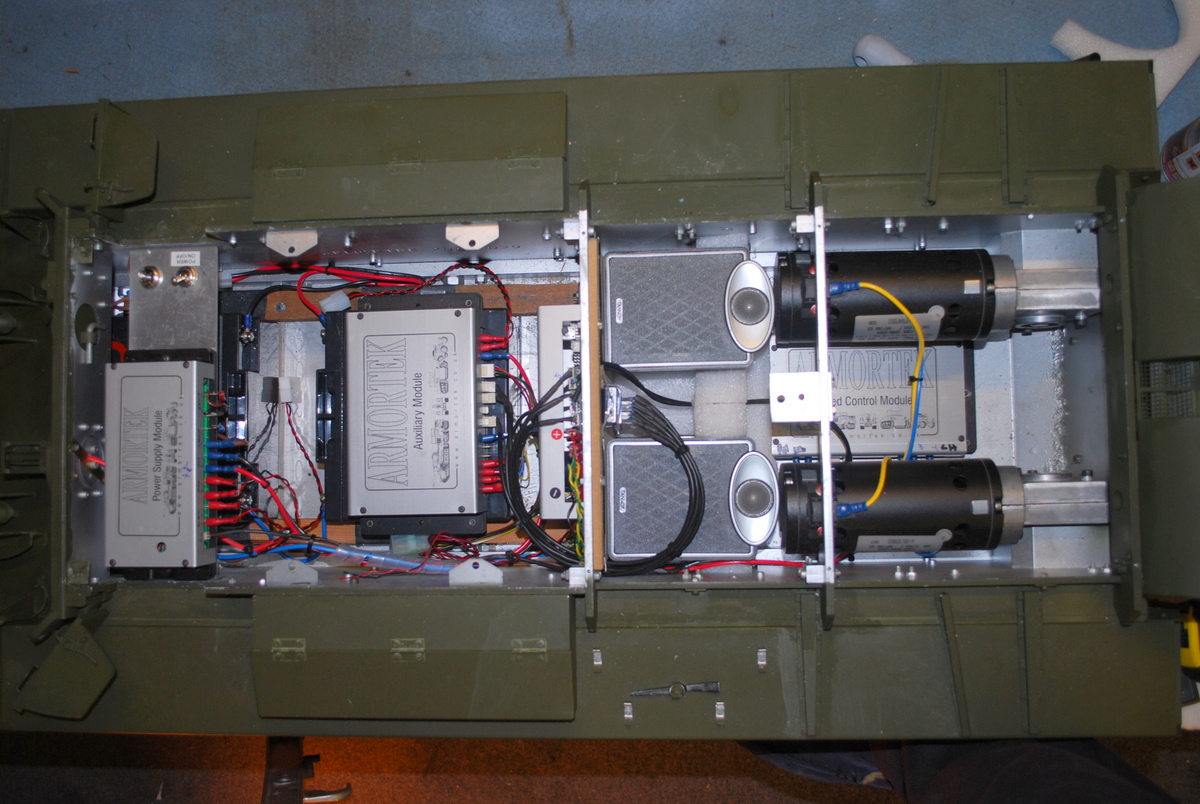

My sentiments as well, the installation of the modules is very neat and makes my Tiger Tank look like a complete disaster area.
This reminds me that when I had Comet No 45 (whilst my Tiger was not really mobile) the Tank was attacked by Panzer Mice over the winter and they chewed off the insulation on the wires. I was really lucky not to have switched the Tank on as it could well have caught fire with bare wires and shredded paper that had been brought in....
