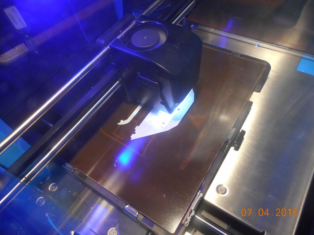

Watching plastic melt :lol: :lol: :lol:
Sherman return roller brackets being made from PLA.
Lots to learn :roll: but good fun so far and out of the cold and the wet for a change.

Nice,
Which machine do you use? I had an Ultimaker for several years but recently switched to a Zortrax

This is a Cel Robox.
It's quite odd having to think about how to make parts by adding material, rather than by removing it.

Ahh the cell robx. 3d hubs had some nice things to say about thar machine.
Personally Iwould use ABS for parts like rollers. ABS has a decent amount of flex to it and it tends to bend rather than snap when put under pressure. PLA is more brittle.
Enjoy!

I had a read through some of the reviews and "Best Of..." lists and this one seemed to be favourable, plus it's one of the few to advertise 20µm layers.
I have a roll of ABS on order, but am playing with the PLA roll with which it arrived.
It seems to use Microsoft minutes to the print timings - the last one said it would be ready in 10 minutes and it took over 7 minutes to complete the first of seven layers !
