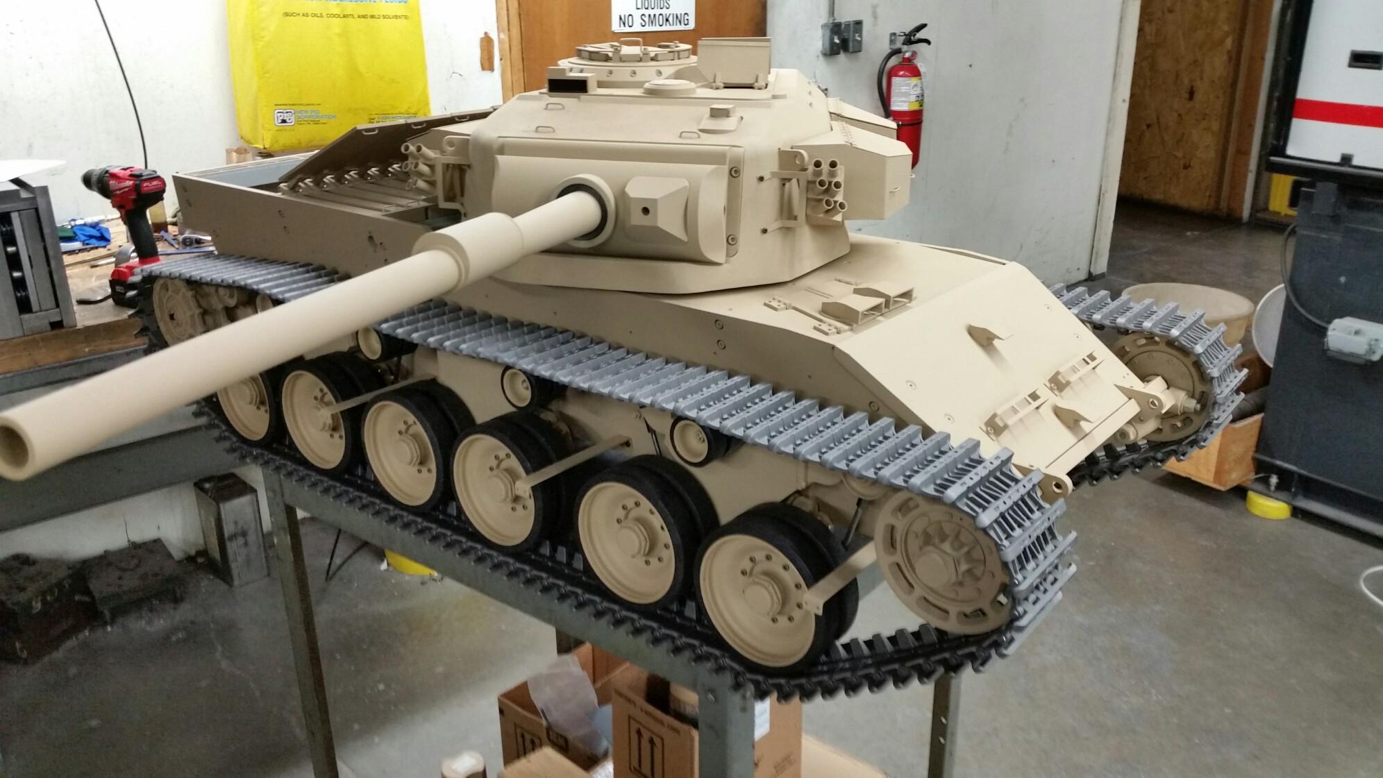

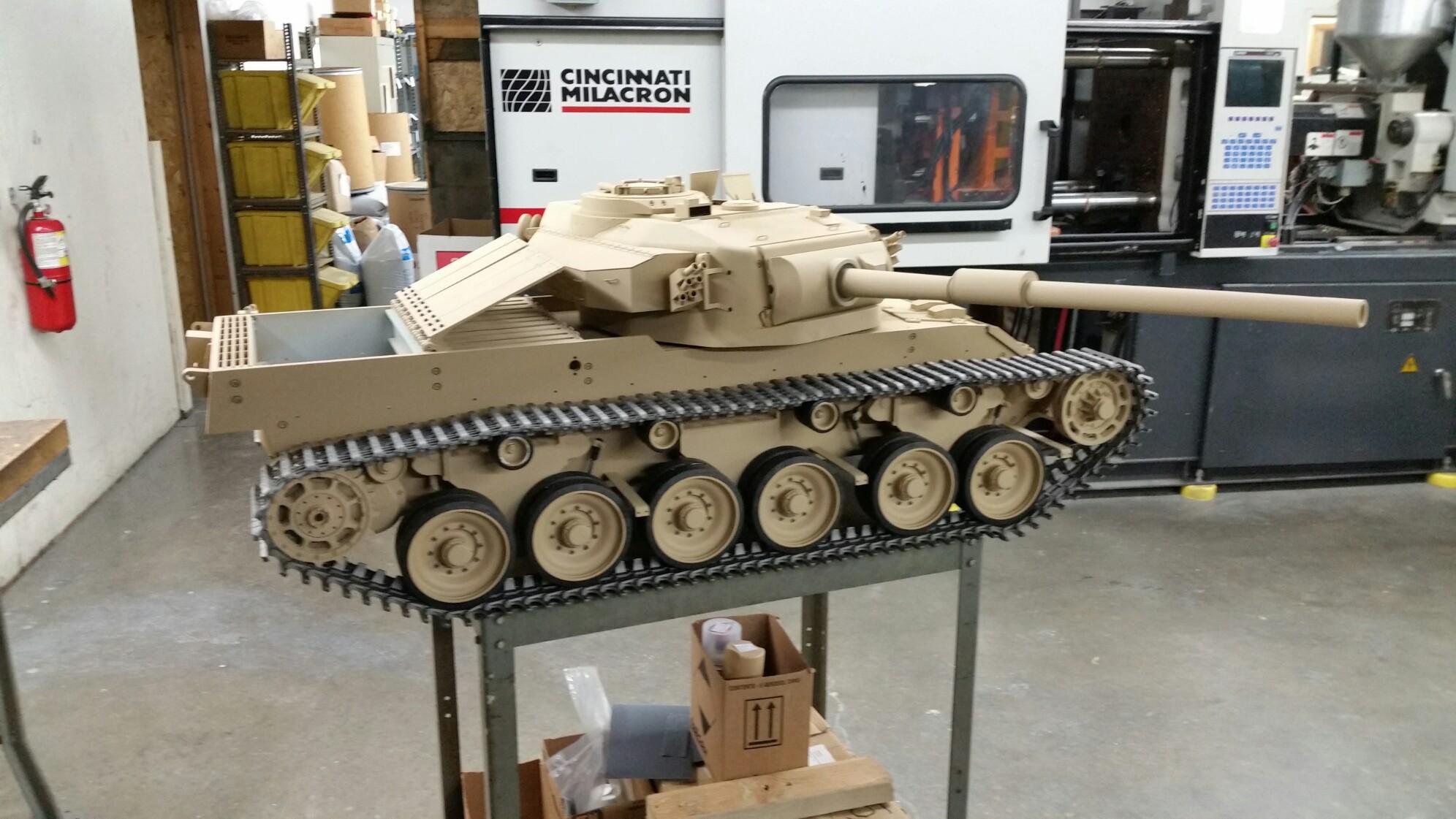

After many months of work and lots of trial and error (it's my first 6th Scale tank)
. Centurion Kit 49 in finally starting to look like a real tank.

She's looking good Martin, seems to have gone together well. Hope you've enjoyed the build so far. Looks like you're heading for a desert scheme - have you selected a final paint job? The workshop tooling looks like it rivals Mark's at Armortek. The bench looks like a brave move though.....

Hi Stephen, Thanks for the feedback. Yes I am very pleased how the build is coming together although at times it has been a real challenge. This is my first attempt at a kit of this size and the engineering is sometime beyond me. However, I am learning fast and hopefully the next kit will be a little easier (Tiger 131).

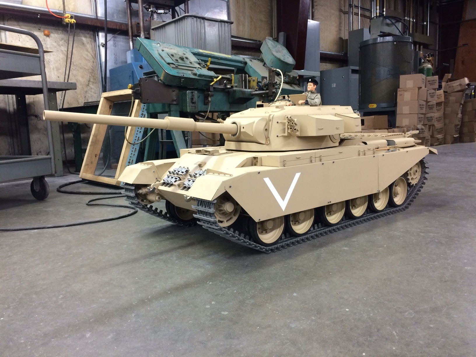

Its finally all falling into place. This weekend the DX9 Arrived and I got Centurion #49 rolling. I would like to thank Dennis for his advise which made programming the DX9 Handset much easier than I expected.
This is a youtube link to its first drive up the workshop and outside:
Also I have posted a few more pictures showing the inside of the hull and also the tank when it is assembled. I still have some more detail work to do but I am pleased with the result so far.
I would like to thank Amortek for creating these wonderful kits and also my friend Walt who has helped me through out this project. Its nice to have an electronics expert on the team when it comes to wiring etc.
