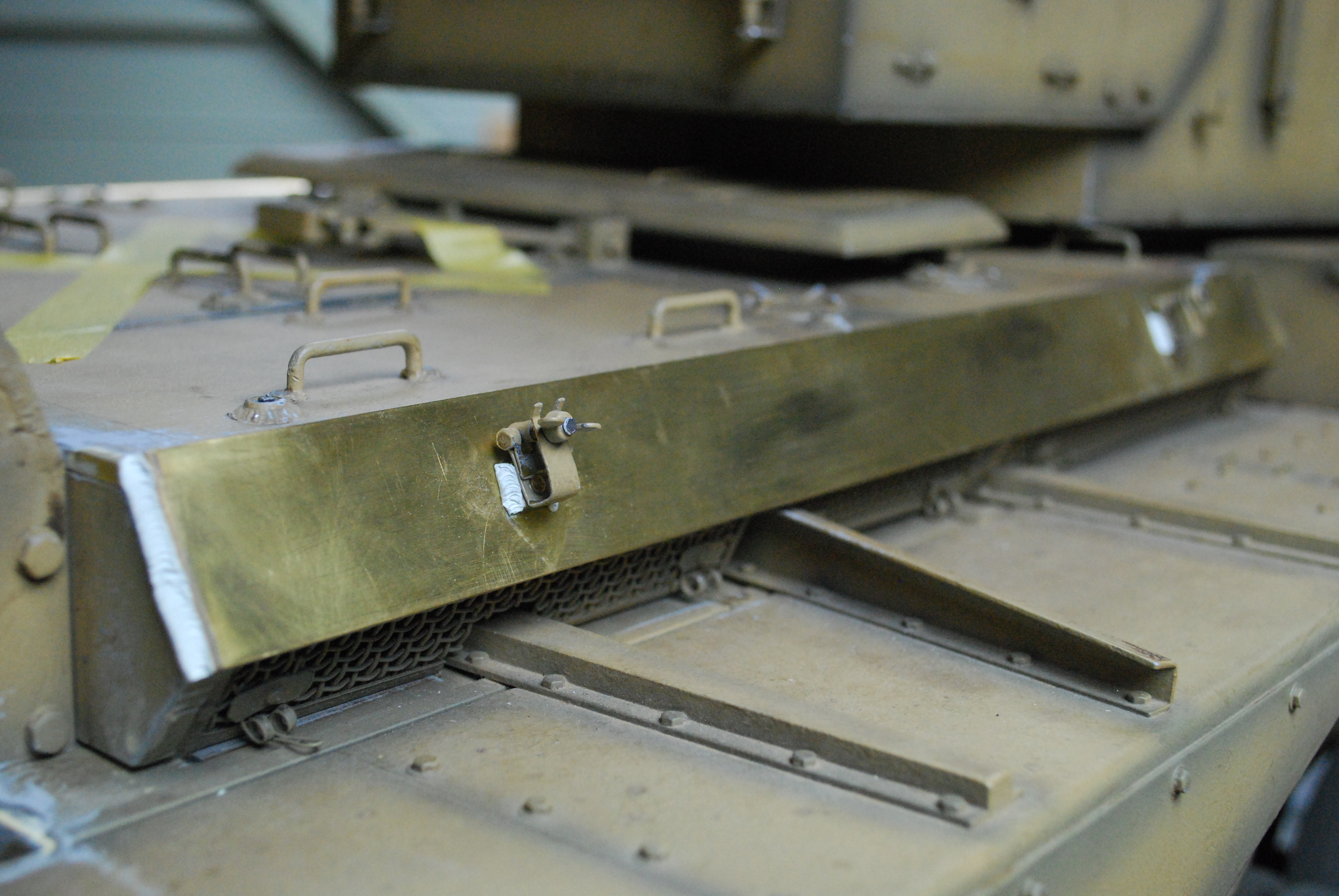

Engine deck: following a chat with Marc and Dennis it was pointed out to me that the sides of the engine deck should have an angle to the top edge, so after checking references I made up two side plates to give the correct profile using brass, the side armour thickness is an 1inch so I used flat plate of 1mm thick and ‘L’ angle of 3mm x 2mm soldered the angle to the top edge with the 2mm side and using the 3mm side as the return edge to give the armour thickness (4mm = 24mm close enough for me). Brass angle was soldered to either end so that Milliput Putty could be used to form the weld profile. This was to allow for the engine cover to be removed without damaging the welding. The two side plates were then fixed to the original engine deck sides using Gorilla Epoxy (I am have trouble finding Araldite) it’s good for big areas.

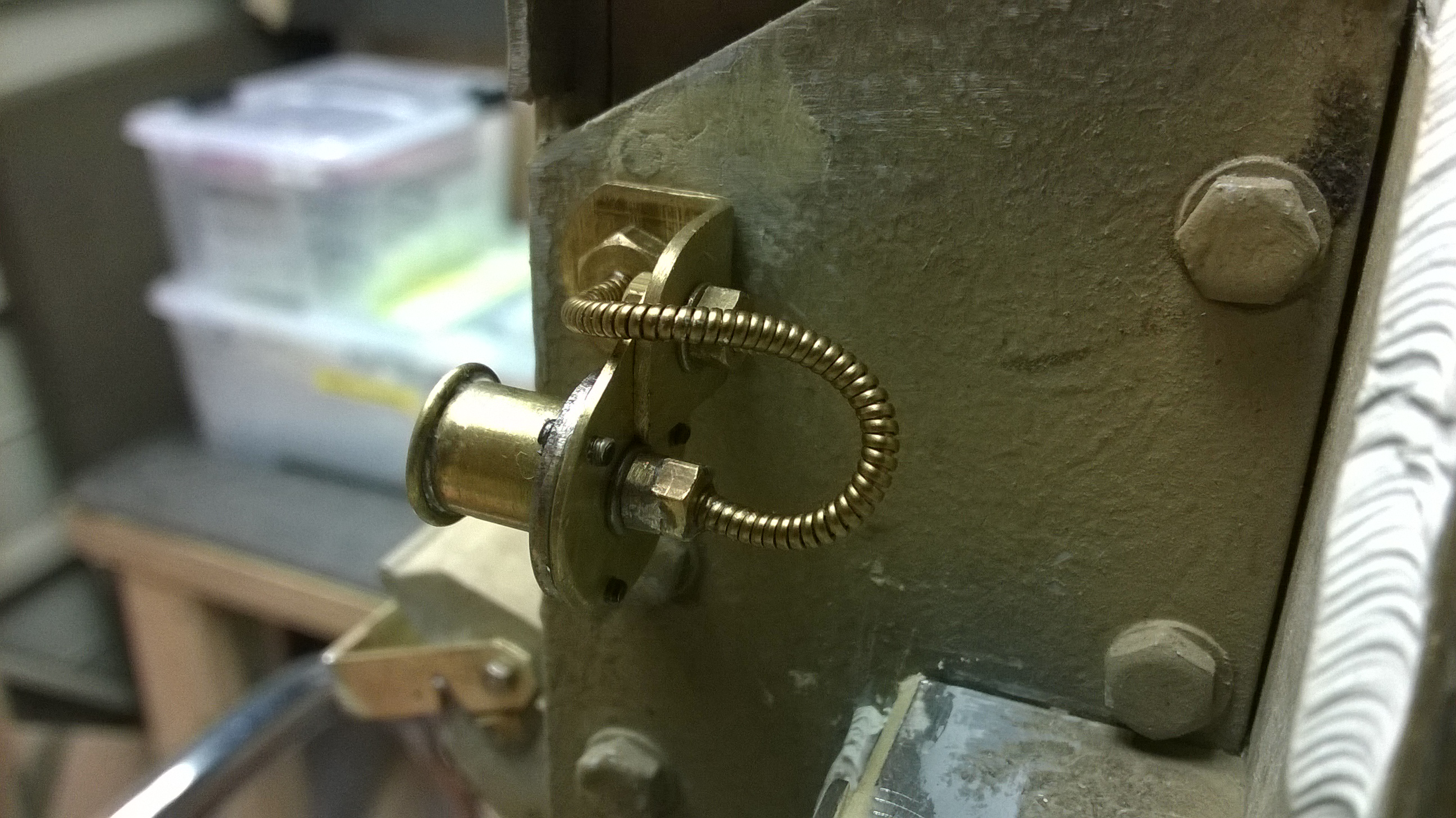

The rear tail light: I removed Chris’s light and reflector from the left side and made the correct period one and fitted it on the right hand side, I hope this is the correct one? The lights on the two Comets at Bovington are both screwed up and the Littlefield example looks to be a later addition so I went with the War &amp; Peace pictures I took which do match one of the Bovington offerings.<br />Material of choice brass with a re-cut lens from the post war lights that I removed and armoured cable from Prime-Miniatures (prime-miniature.co.uk worth a look if you’ve not seen them) with copper electrical wire in side to stiffen.
The rear tail light: I removed Chris’s light and reflector from the left side and made the correct period one and fitted it on the right hand side, I hope this is the correct one? The lights on the two Comets at Bovington are both screwed up and the Littlefield example looks to be a later addition so I went with the War & Peace pictures I took which do match one of the Bovington offerings.

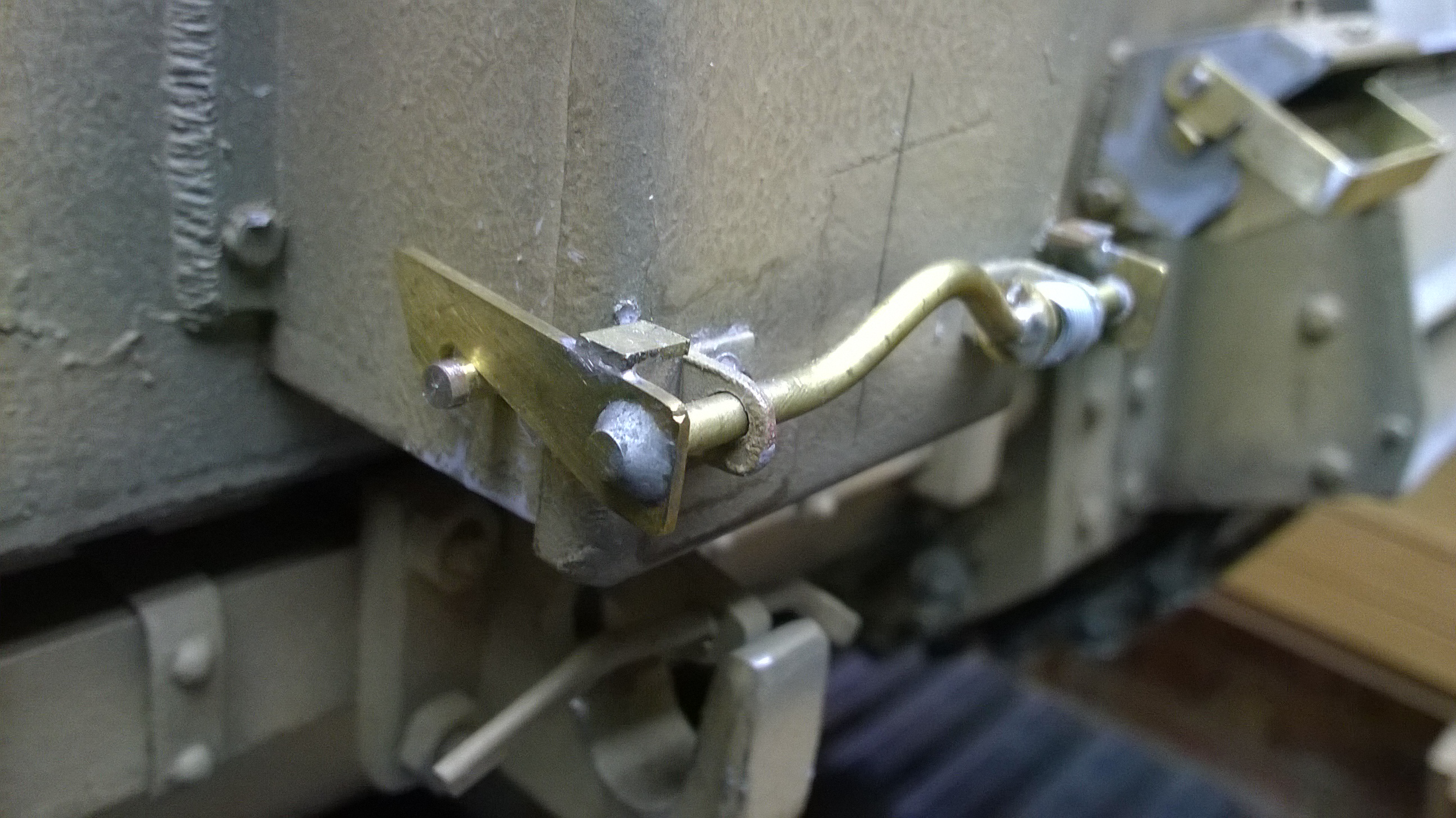

Moving to the back: <br />I have remade the smoke discharger latch bars, in brass, as the white metal ones’ were broken (me!) I opted to strengthen the corners of these by folding an angle and soldering the bar across the two ends, not prototypical I know. Also after checking with reference materials (the Comet book, both Bovington examples &amp; the Comet I have photographed at the War &amp; Peace show) all show these bars as deeper that the white metal supplied.
Moving to the back:
I have remade the smoke discharger latch bars, in brass, as the white metal ones’ were broken (me!) I opted to strengthen the corners of these by folding an angle and soldering the bar across the two ends, not prototypical I know. Also after checking with reference materials (the Comet book, both Bovington examples & the Comet I have photographed at the War & Peace show) all show these bars as deeper that the white metal supplied.

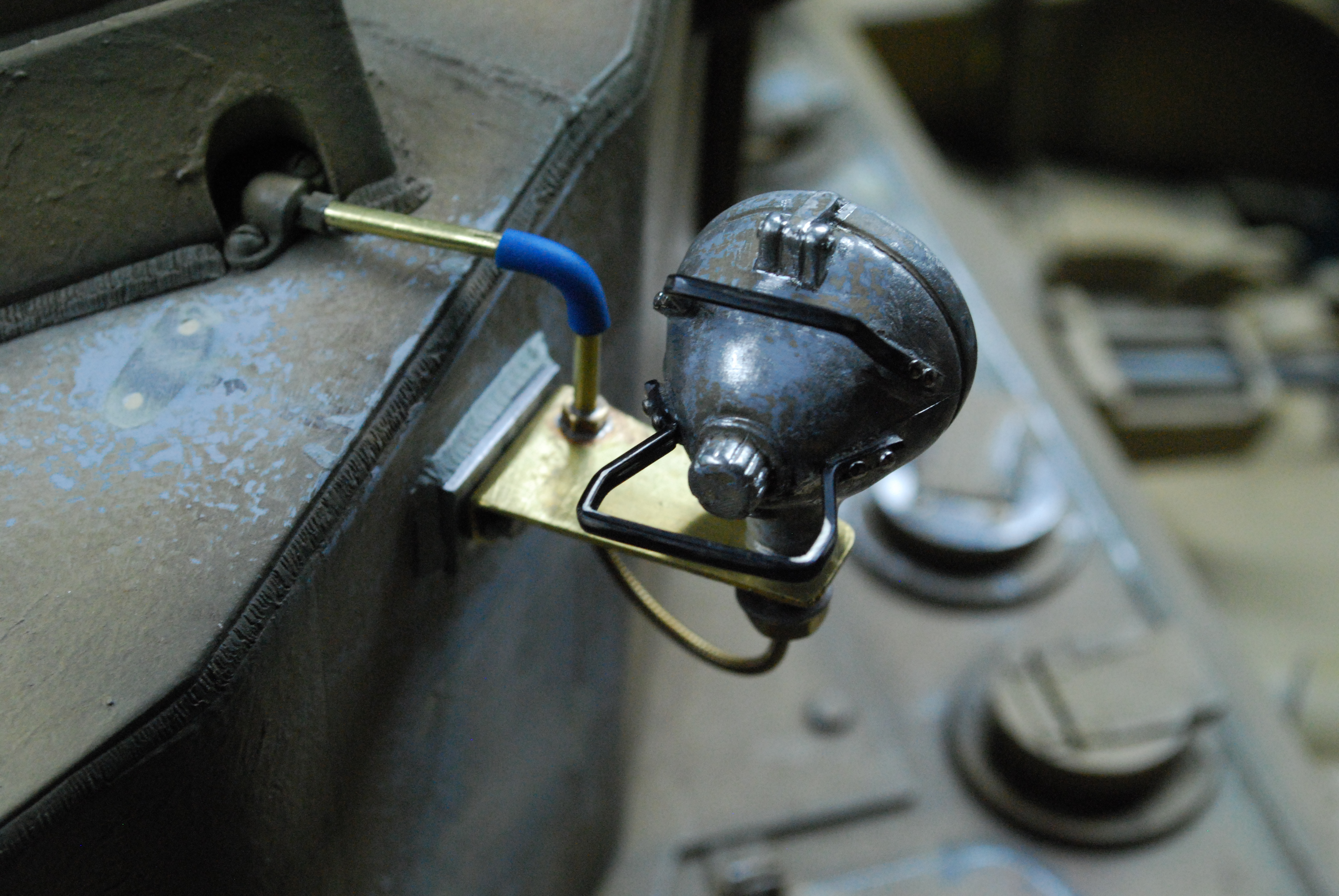

The other spot light view.

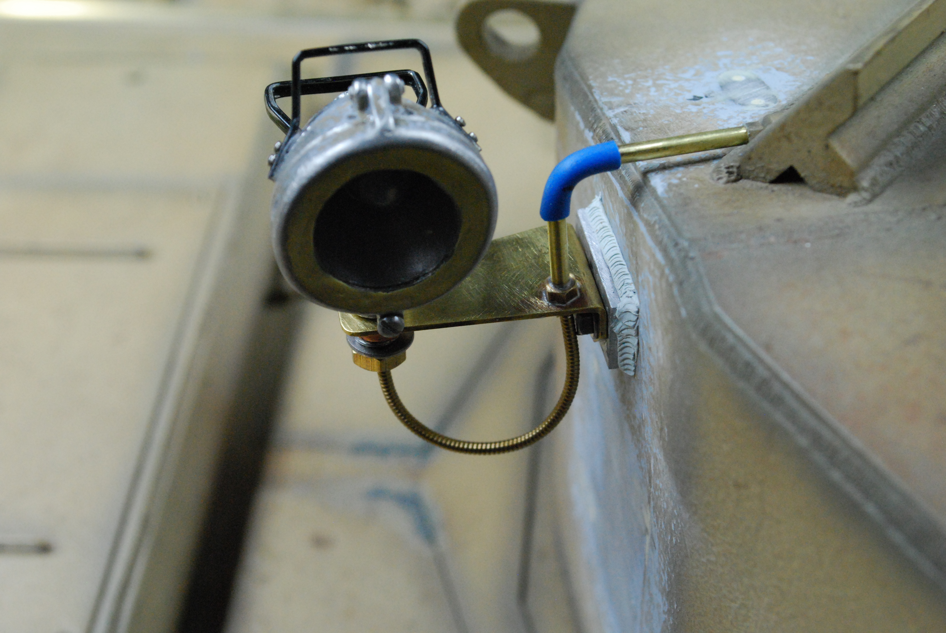

Turret: the search light bracket and light handles had become bent, so I used the ARMORPAX components as templates and remade it all except the lamp body.<br />On the, actual, search light bracket the web underneath stops short of the ball mount for the light, this is where I have bent mine  so I extended the web under the bracket to meet the underside of the light ball mount represented by a copper ring and soldered these together making a stronger unit. A compromise for strength.<br />The light body I cleaned up and remade the handles using spectacle frames (these are rely strong, and the screws small, used them on the rear side light) and pins for the screw heads. Drilled out the white metal spigot and self-tapped a M3 brass stud into it which I had drilled a 2mm Diameter hole about 3mm deep to take the armoured cable. Spring, washer and nut as per 1/1 scale, but will be Araldite in place. I re-used the reflector insert, added a bead as bulb re-painted silver and added a new clear glassing. Armoured cable (Prime-Miniatures) with brass wire inside to stiffen it, from the light spigot to the bracket and brass tube for the trunking and electrical wire (2.5mm I thick) for the elbow, I could not recover the white metal one. I also added the welded fixing plate to the turret side (2x3mm Ally) with Milliput welding.

Do you have any drawings/plans that you made for producing the Bird Cage? I likewise have remade the searchlight bracket in brass so as to produce a more robust fixture, it has worked out well so far! Keep up with your re-workings, they are giving inspiration.

Nice upgrades you are doing there. I have made my searchlight bracket in brass too.
I am planning to do the bird cage again and if you have a drawing that would be useful
to have as Steve said.
