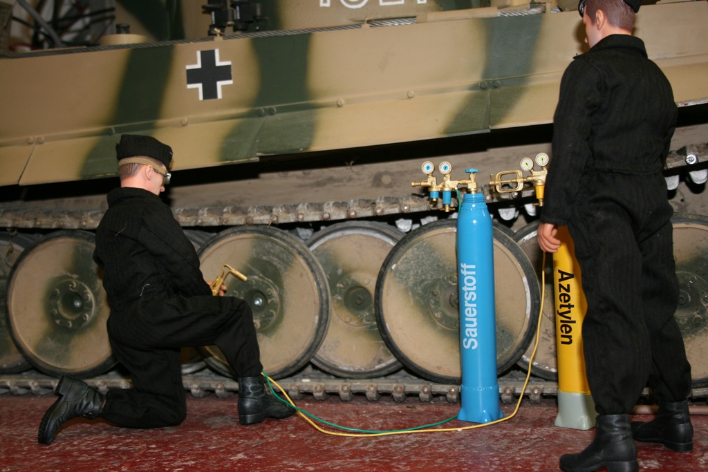

The fitters started work on her this morning and found every track pin rusted in. It wasn't the best idea of ours to run at the beach :shock:
Out with the blow torch :wink: its going to be a rough day.

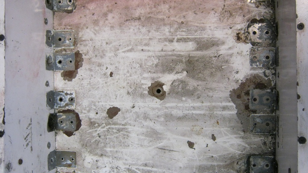

A bit of a long week away but I managed to get some time on the tiger.
After 10 years service the only part that the paint has peeled off is the left side around the suspension and the drive. it looks very smooth like I haven't sanded it enough to give the paint a good key.
The paint inside has been affected by the use of the blank firer, I used it a lot at one point and the dusts is everywhere. Poor housekeeping as my old Sargent would say! :roll:
Its all to clean and sand back so it can be repainted. no blank firer this time though :lol:
Paul. :wink:

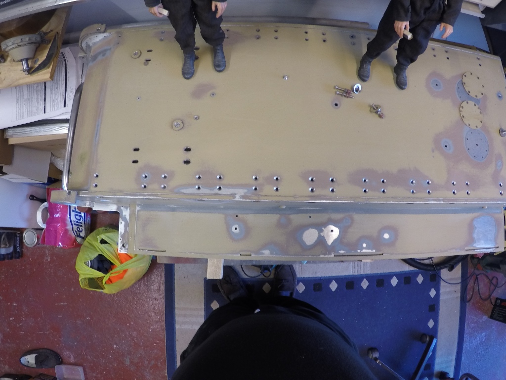

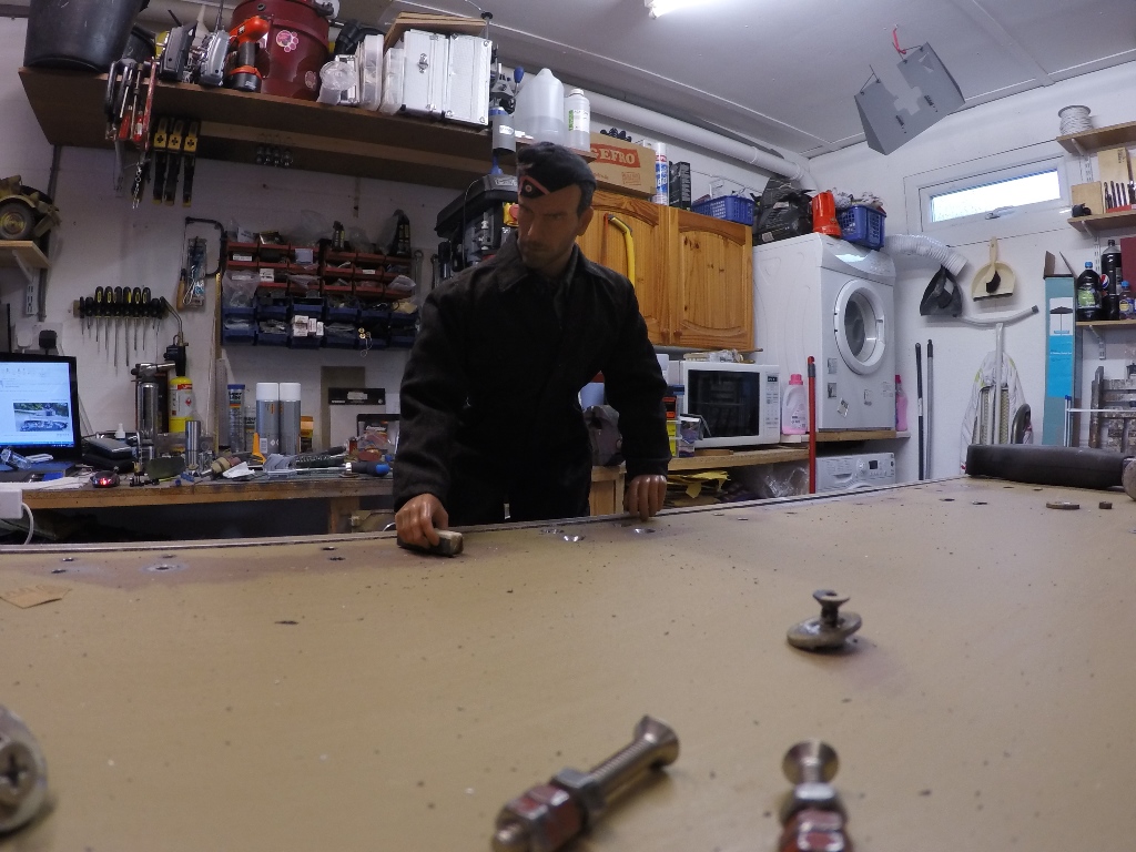

Stripping the old girl has left some opportunity for a bit of fun and to make some of the field gear shown in maintaining the panzers, its a great book. here's the front sprocket jib, I had to change the jib boss to make it fit though.
Anyway, here are some updates, my fitters have scuffed the knuckles to the bone sanding this old girl down.
After a long debate and a few beers, we decided to change the M4 cap heads that hold the blocks in place to counter sinks. I noticed when I started stripping the kit that all the mud that had gathered around the cap heads, so I thought make it flush.
Paul. :wink:
