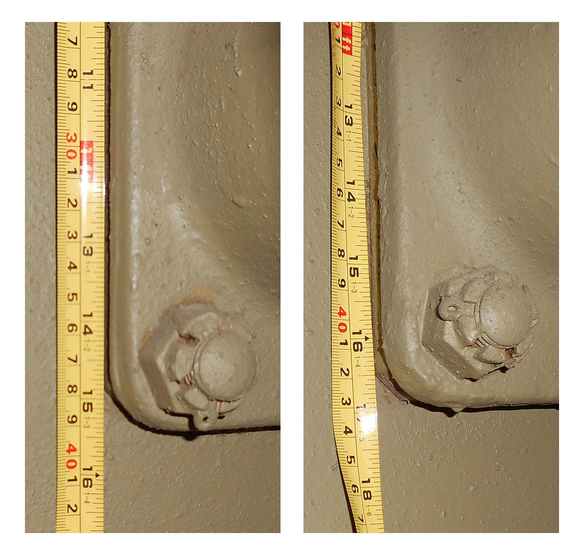

Does anyone have a reference as to how much lower the rear return roller should sit as compared to the other three ?
In one of Graham's threads, Mike Kasputis reckoned it was around 5mm when measured from the Achtung Panzer book.

I finally made it to Bovington yesterday, so was able to measure the return roller mounts on their Ausf D/H.
Bovington Panzer IV Return Roller Heights
There looks to be around 1.5 inches difference, which is 0.25 inches in 1/6th scale.
