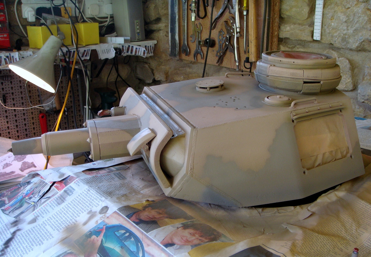

German WW2 Primers. German WW2 AFVs and guns were mostly primed with a red colour, RAL 8012 Rot (Rotbraun). Some builders choose to overspray the etch prime with red before painting the base colour.
