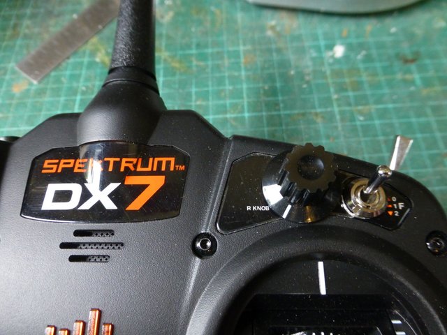

- This description was tested on the DX7 Gen 2 Tx. The DX6 Gen 2, DX7 Gen 2, DX9 and DX18 Gen 2 all share the same software platform and the installation should therefore work on all. The encoder rotary switch must replace a Spectrum switch which is assignable to a proportional channel. On the Dx 7, it replaces the Rotary Knob top right on the face of the Tx and the sprung switch replaces Switch F next to it.

Unscrew the mounting rings for the Spectrum Rotary Knob and adjacent three way switch and place to one side.
De-solder rotary switch
Both switches are redundant but the three way switch can be retained inside the Tx. The Rotary Knob should now be de-soldered and removed, retaining the cable.
