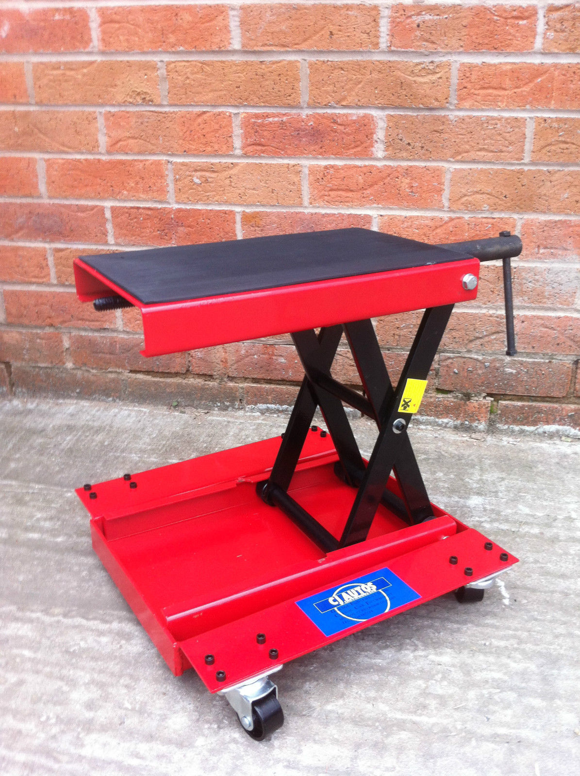

Hi Chaps
I have noticed people have been using low profile lifts of the screw jack type to raise their tank off its tracks.Is there any particular make I should be looking out for or a supplier?
Posts: 5119
Has liked: 1475 times
Been liked: 1674 times
Re: Tank lift
I use the ones from CJ Autos - search ebay for MB04A and also buy their motorbike mover - search ebay for MB04M.
The scissor lift sits in the trolley, only adding an inch or so to the height, but means I can wheel the tank around the workshop once it is up off its tracks.
No connection with CJ, but the two I have bought have done sterling service.
If you go for a different brand, make sure you buy a lift with a hex nut on the end of the lifting shaft, so that you can attach a socket and ratchet handle to it. The first one I bought just had a tommy bar type thing, which meant you could hardly reach it once the tank was on the top and could only turn it in fractions. Lots of chafed knuckles. It's sitting in its box at the moment, awaiting conversion to a hex end.

Hi Adrian
If you, or anyone else wants a conversion I have now done three such lifts by brazing two nuts together and drilling through for the split pin. So just let me know.
