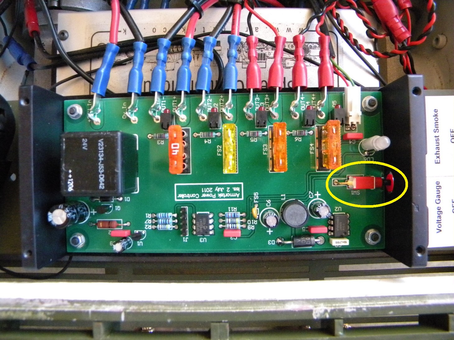

Thanks for your responses. Are you saying I need to remove the circled switch and re-solder wires to another switch. That's the way I understand what you've written.
Picture below.

Posts: 5119
Has liked: 1475 times
Been liked: 1674 times
Re: Power on off switch
You don't need to remove the switch, just solder the new one in parallel across the existing one. Then you can easily return it to "stock" condition should you need to.
Ray Brown

You mean like this picture..................

Dennis Jones
Posts: 893
Location: Poole, Dorset
Has liked: 10 times
Been liked: 224 times
Post by Dennis Jones »
Yep just like that.

Thanks a million. Is there anything I shouldn't use or do?

Dennis Jones
Posts: 893
Has liked: 10 times
As long as the push button switch is non latching and push to make. Current is very small so doesn't need to be a big switch.

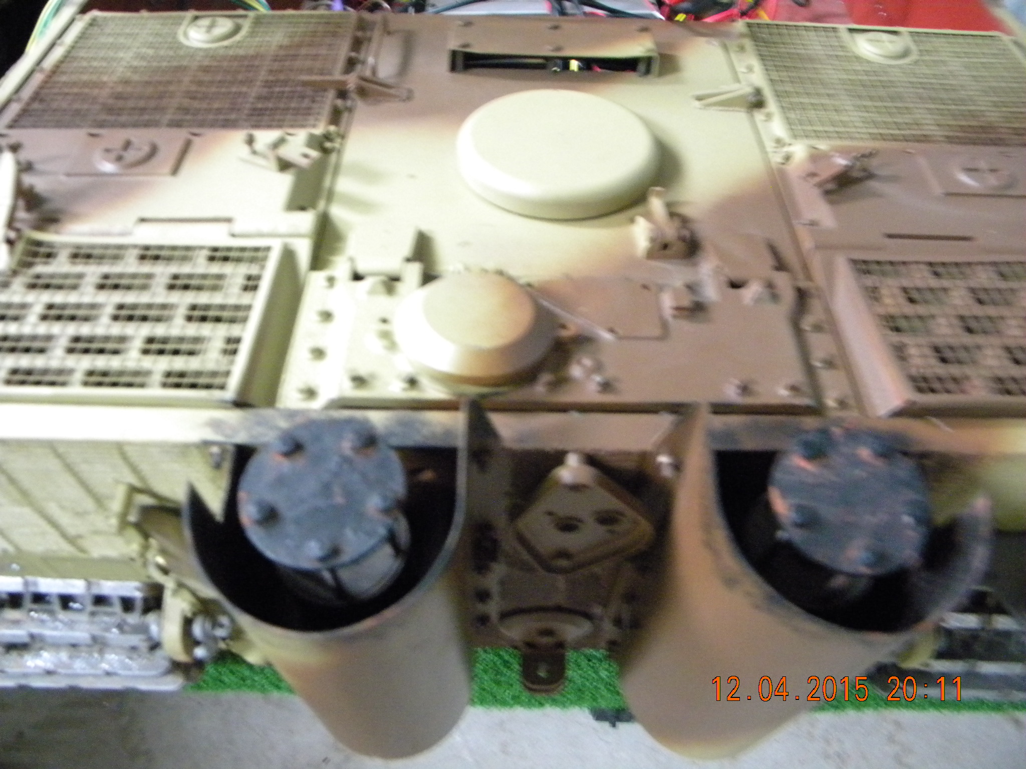

thanks for the help. i've mounted the new switch at the rear.
