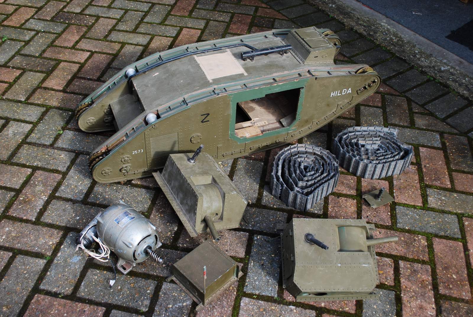

I have been given the task of putting this MkIV or V back together. Apparently two of them were made for a film. The tank was powered by 240 volts, the motor you see in the photo is 240 volts and it drove the two tracks via a gearbox and chain drive. The tracks were controlled by two dog clutches which were pulled by two 240 volt solenoids. The whole lot was controlled by a multi-way escapement rotary switch again operated by a 240 volt solenoid. There is a belt mechanism driven from the main drive shaft which turns a pulley assembly linked to which by a rod makes the guns in the turrets turn and raise and lower when the tank is in motion. Needless to say for health and safety reasons I will not be connecting up the electrics. The b/w photo shows the man who I assume originally built the tanks. The hull is made of wood but all of those u bolts are threaded with nuts holding them on, a labour of love I would think. There are also bulbs in the ends of all the barrels. I will post a photo of the completed tank when finished. I must be a glutton for punishment.

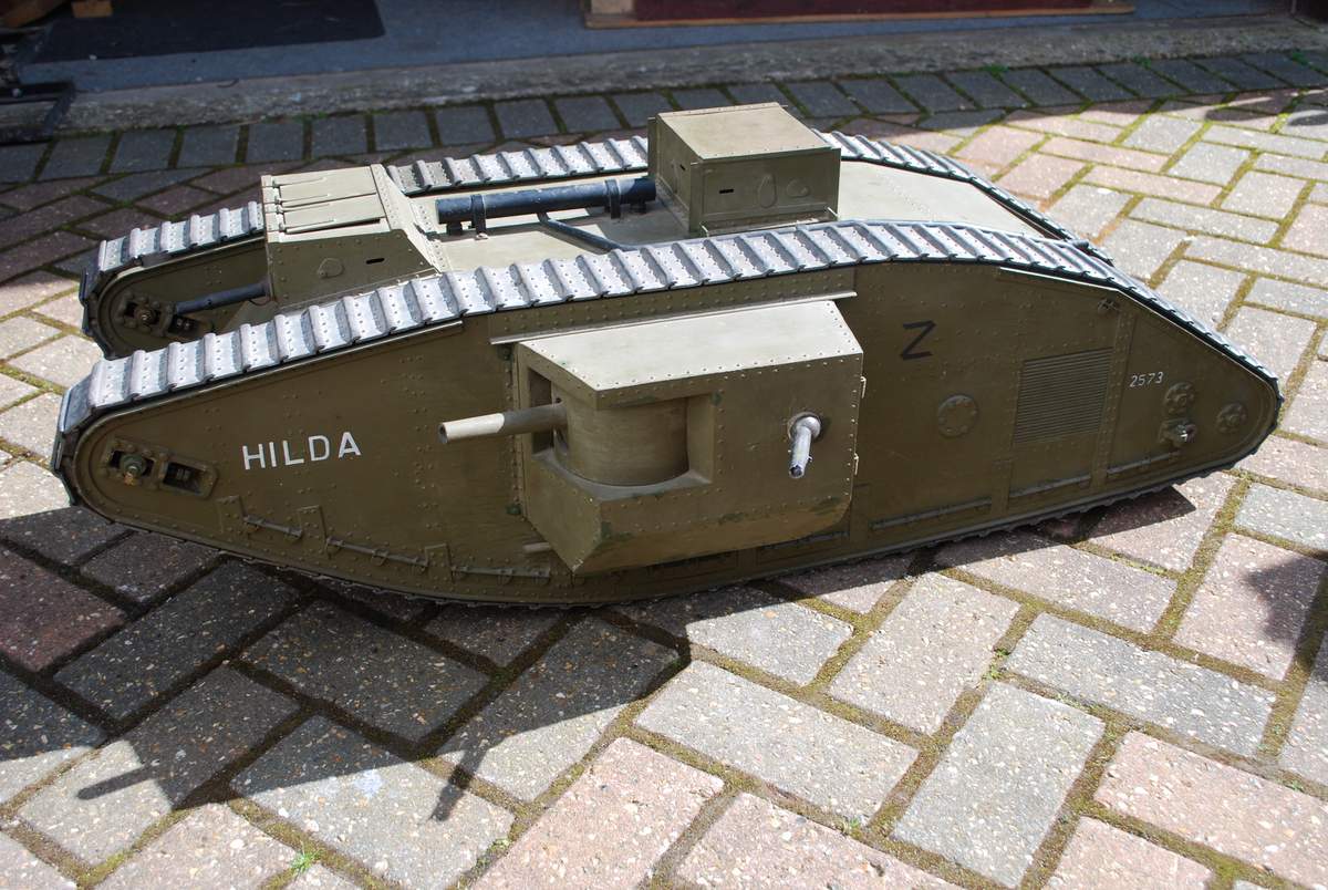

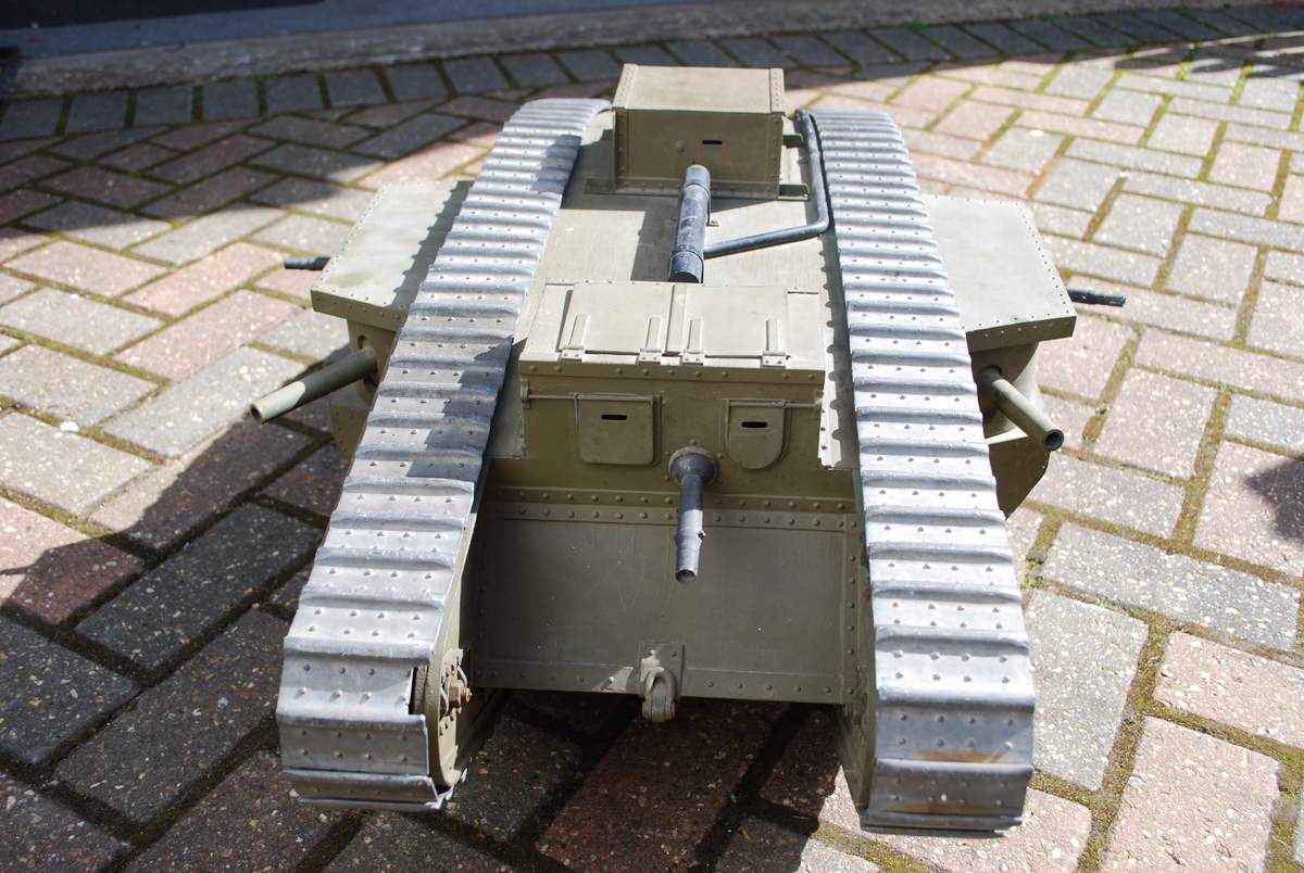

Finished putting the MKIV back together not in running mode though.
Dennis.
Dennis.
