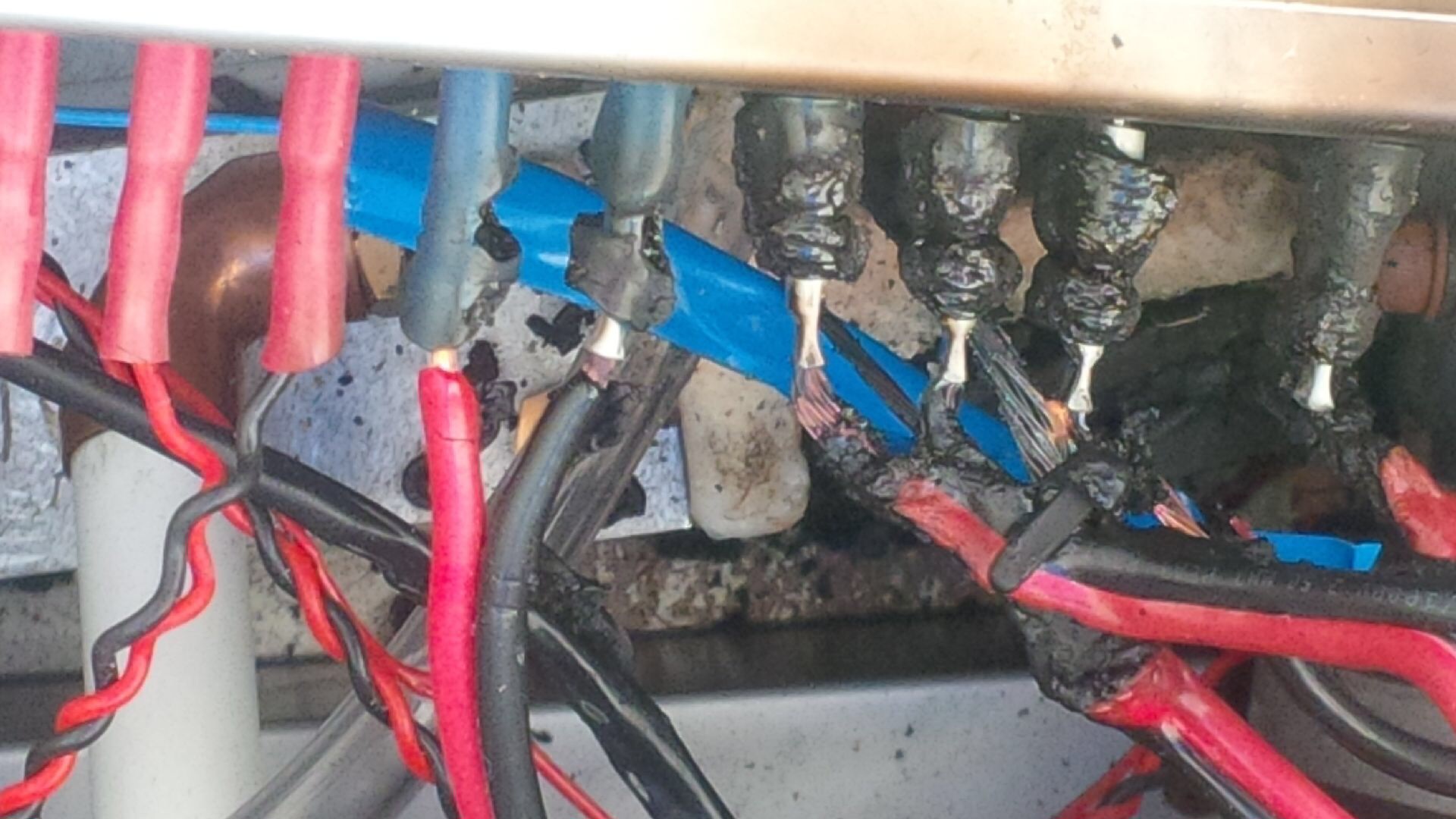

Thought you may wish to see why you should never run the smoke unit dry - well, not for too long anyway! :oops: :oops: :D
