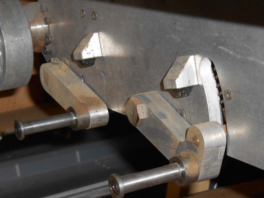

A little later than I expected but running over Dennis's bridge at the show on Monday proved that there was very little travel in any of the suspension.
Now the track pins have arrived, I've broken the track on the left hand side and found that the CSK bolts which hold the internal suspension bars to the hull sides have come loose, and are rubbing on the suspension arms:
I'll need to move the arms out of the way, add some loctite to the bolts and get them tightened up properly.
Once that is done I'll be able to see how well the suspension works.
I don't think this will be a cure-all but it can't help but improve the situation

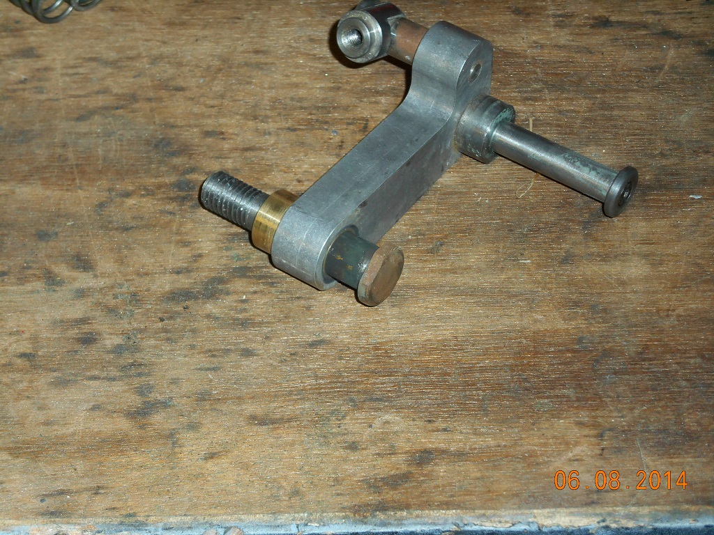

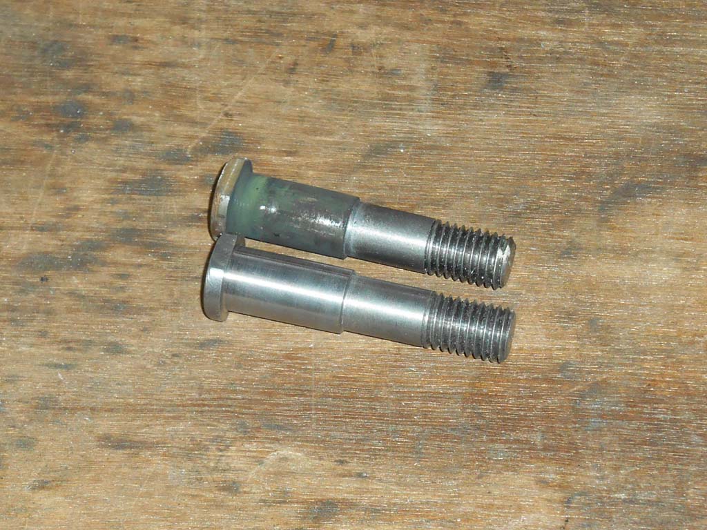

I've stripped down one side and found where the problem really lies:
The pivot pins were completely stuck in their bushes, to the extent that I needed to use a vice to push them out.
Once extracted, they cleaned up nicely though:

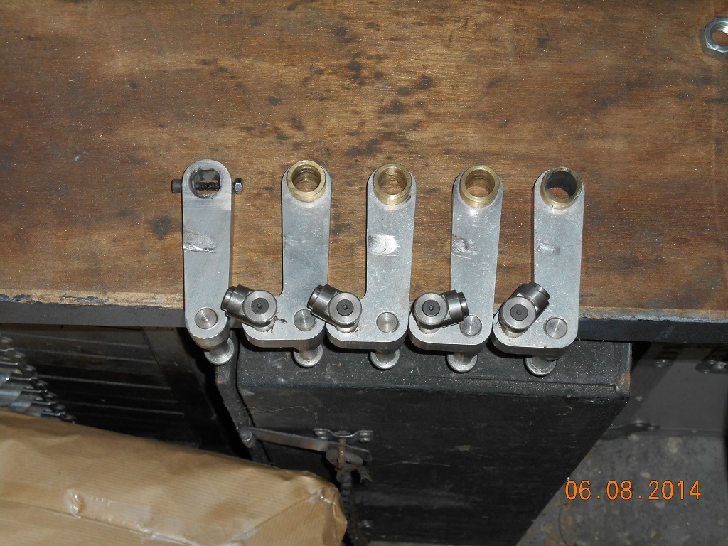

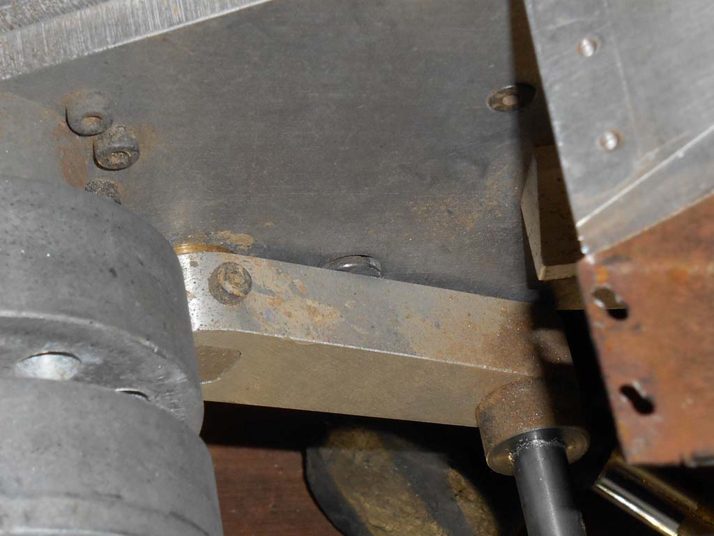

I was worried the CSK screws mentioned above might have damaged the inside faces of the swing arms, but the marks were quite minimal, apart from the front arm:
After a quick rub down with some emery cloth, they cleaned up quite nicely:
They also now move nice and freely within the bushes.

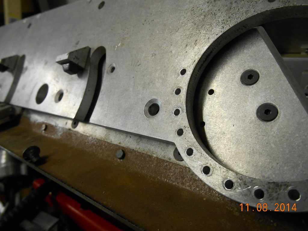

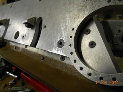

Once I'd got all the suspension parts removed, I could see that the countersinking of the holes was too shallow, so the head protruded slightly even when fully tightened:
Bolt as found
Countersunk hole as found
Bolt as found

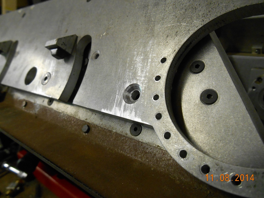

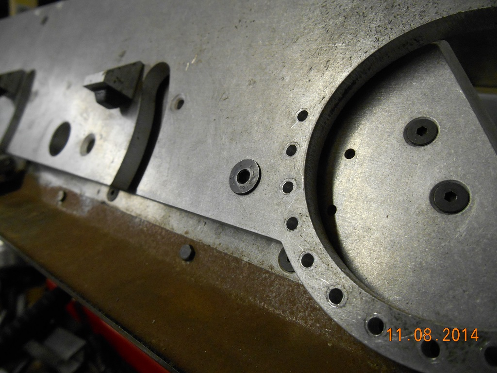

I've removed the whole hull side and increased the depth of the countersink, so that the bolts are now fully recessed into the hull sides:
Hole after deepening
Bolt after hole deepening
This has the added benefit of increasing the amount of thread usage, as these are only 12mm deep CSK bolts, and deepening the holes would allow for a couple of mil extra to be engaged.
The holes in the hull suspension bars are approximately 25mm deep, so I have decided to fully tap them and use longer bolts to secure the sides, thus lessening the risk of the bolts working their way loose again.

I added ptfe lube paste that comes in a small tub from a model shop on my comet build
as its the same set up as the T34 I was worried about brass to steel contact if it got wet.
I see your corrosion is with a green tint which would indicate a reation with the brass.
Hope this helps
Hope this helps
