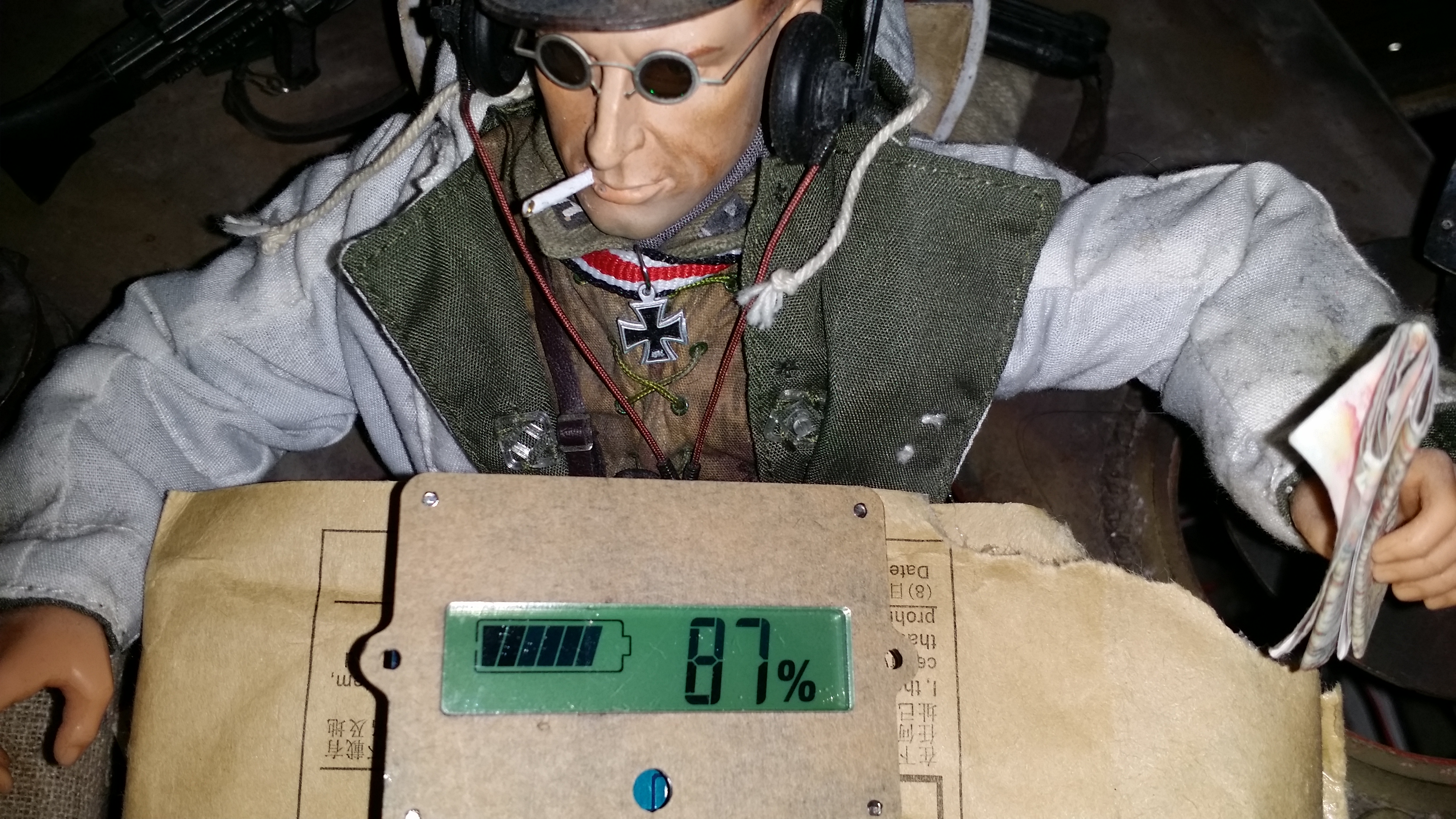

ho folks
just got my 24 volt metering for my JagdPanther and the Jagd Commander is taking good carer of it as you can see 8)

Purchase interesting:
you would you explain to us how it is connected and how it works?
Where you bought it and what?
Thank you!

hi Lacopo
This is the link to the unit which is called a indicator Batterie capacity Tester for 24v Lithium LiPo / LiIon Battery Lead-ACID
http://www.ebay.de/itm/301064569829?ssP ... 1439.l2648
The Price was 12.59 Euro and free shipment
I have had mine now for almost a month and it Works actually very good.
Had the JagdPanther out for driving for almost 1 hour and the battery meter showed a 70% remaining battery capacity which is ok, as I can run the tank for almost 3 hours with the capacity of the installed batteries.
cheers
Steen
