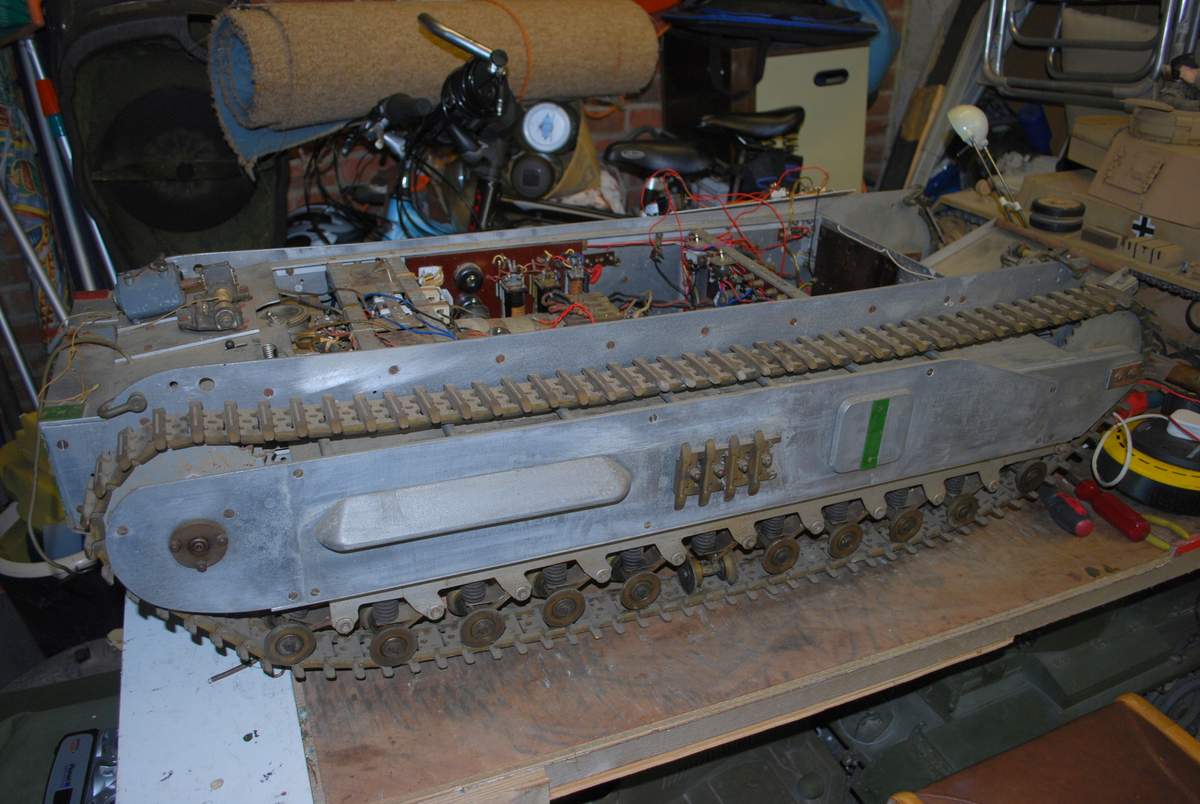

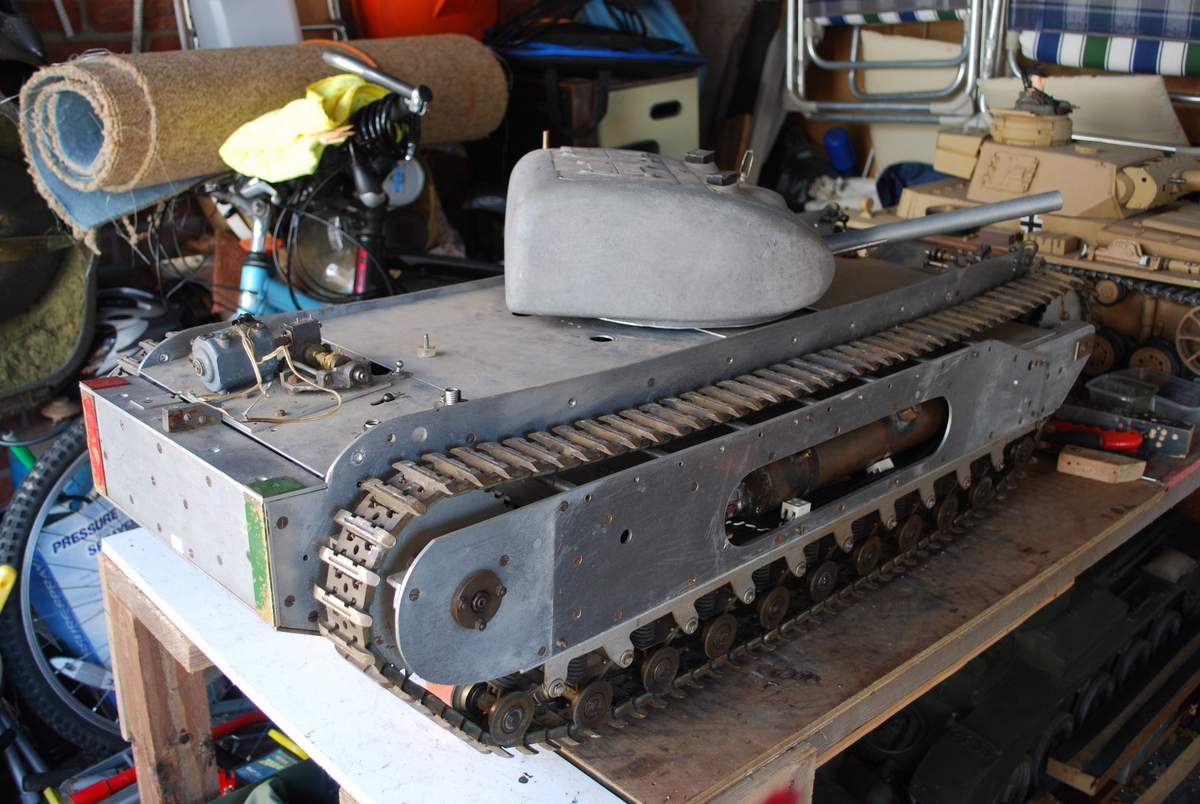

Gill has given me permission to publish this article and photos on the website as we thought it would be of interest to some people. It was donated to the Tank Museum at Bovington in approx 1960.
This an approx 1/6th scale Churchill MK IV tank (50 inches long and weighs a lot) with an SBG bridge attached. It was built in 1952 by Allan Tamplin and took 5000 man hours, it was exhibited at various Model Engineer Exhibitions and appeared in the UK and Foreign Press. It was a running and functional model. I have been asked to try and restore some of it's working functions but as you can see that is a daunting task. It would appear that it was powered by 12 volts, the battery used was a car battery by the type of terminals used. The big motor in the centre drives two gearboxes on either side via two chains and solenoids operate clutches. There are also two other solenoids under the gearboxes which operate brake shoes against the clutch housings. The control box (that handle is one foot long) operates over two wires and has an escapement rotary switch in the tank, similar to the old reed radio control sets. A lot of the wiring has perished, at present I am looking to get the motor running but it has 5 connections and is difficult to know what goes where as I have no plans or diagrams.

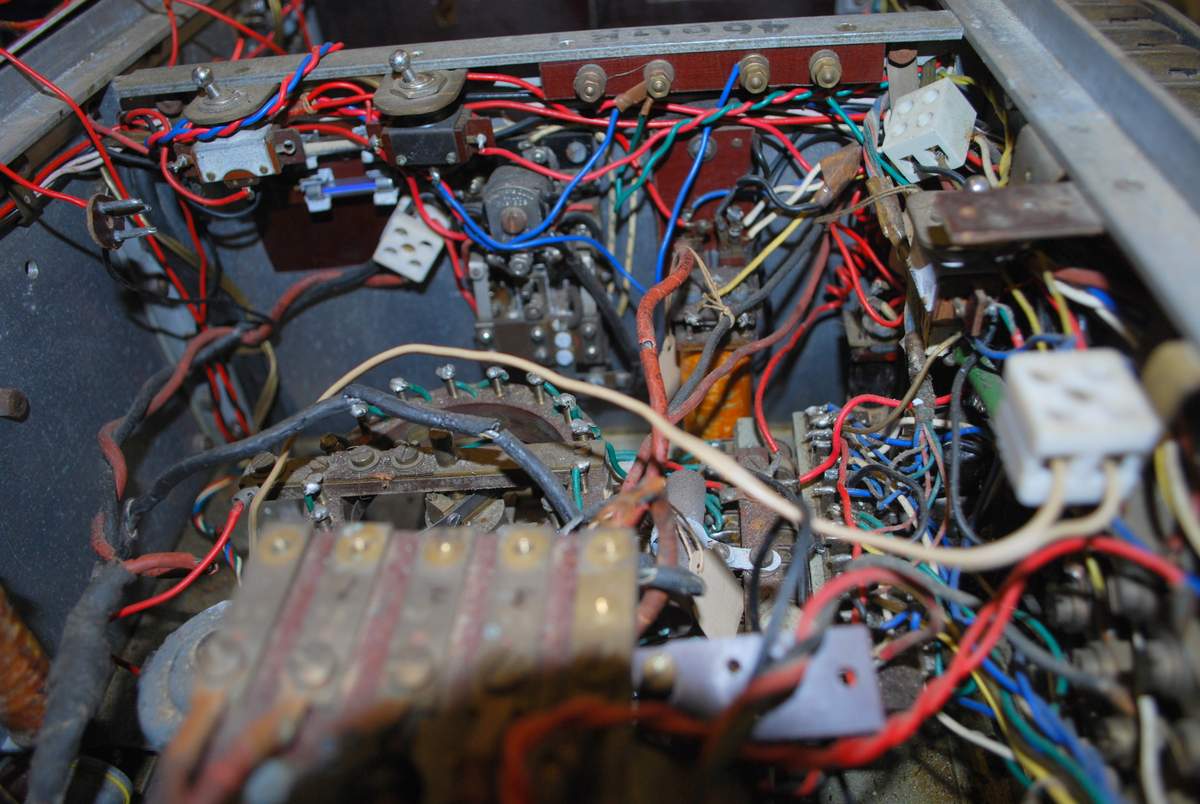

The track links are made of brass and as far as we can tell must have been made by hand. The two winches at the front and rear are to raise the bridge assembly. The are ten switches dotted around the tank and goodness knows what they do. It also has a turret with moving parts in that as well.
Anyway I will keep you posted on what transpires.

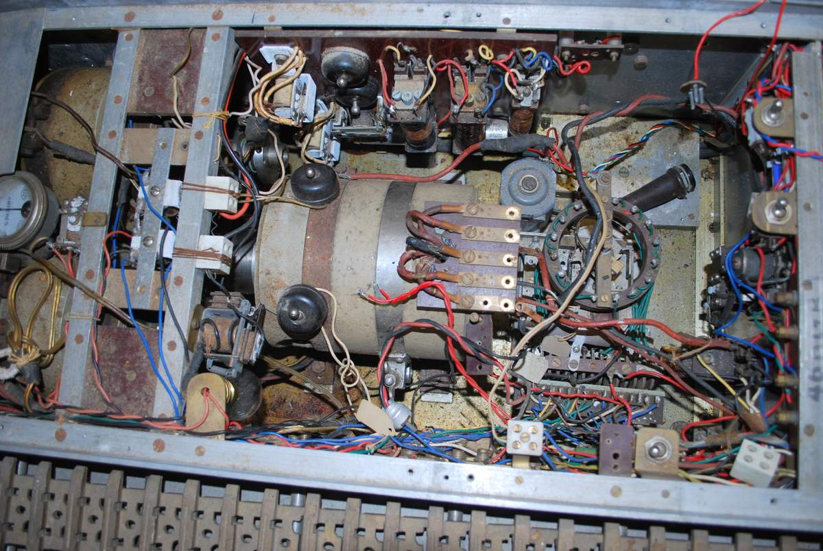

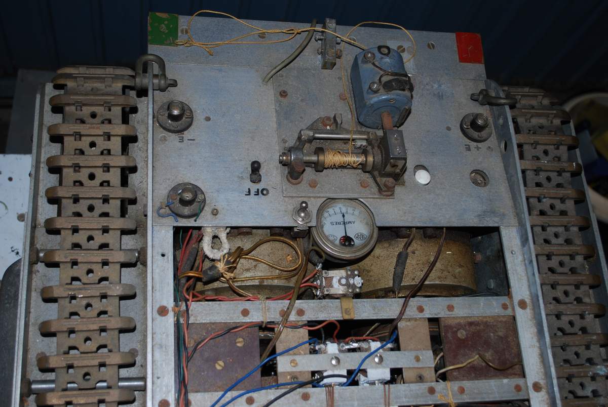

After 60 years in wind and rain we have signs of life. Sorry the video not very good.
We are operating with 12 volts and found it is a compound dc motor and by trial and error seemed to have found the right connections, there are five going into the motor. The clutches are operated by two solenoids, left and right and there are two other solenoids which I thought might be for reversing the gearboxes but it turns out they apply brakes to the clutch housings. We can reverse the main motor by reversing the connections to the armature connections on it. We have also tested the bridge winch motors and they work as well.
Dennis.
Dennis.

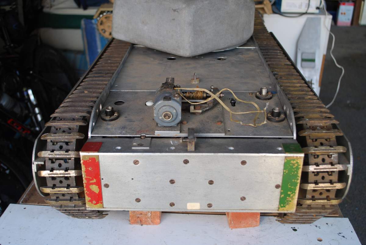

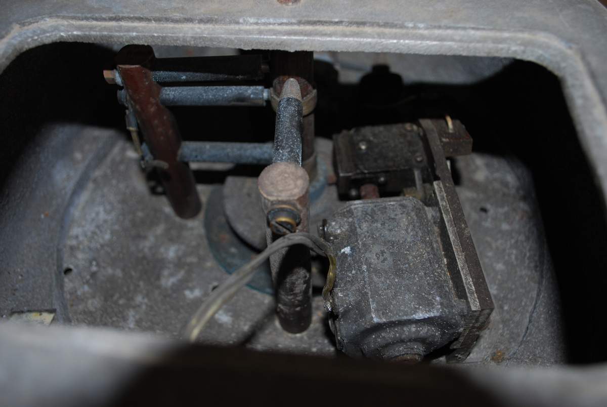

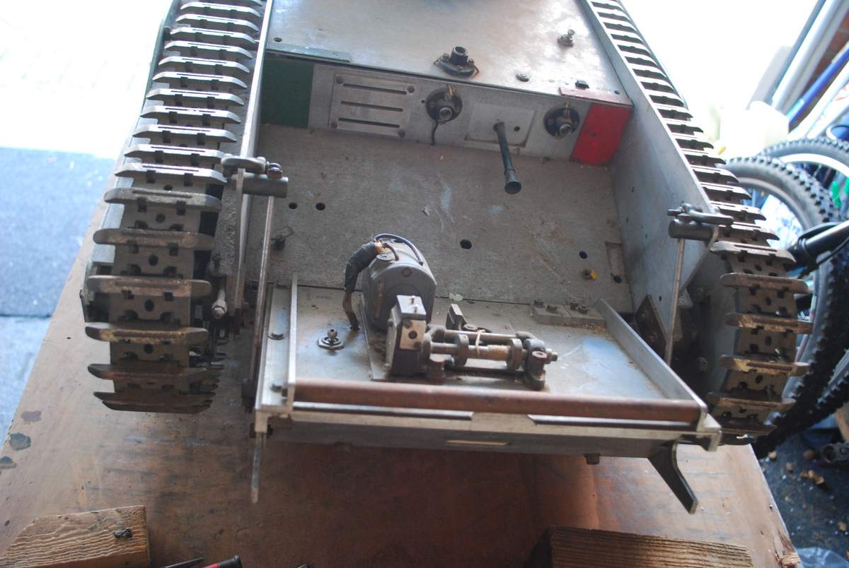

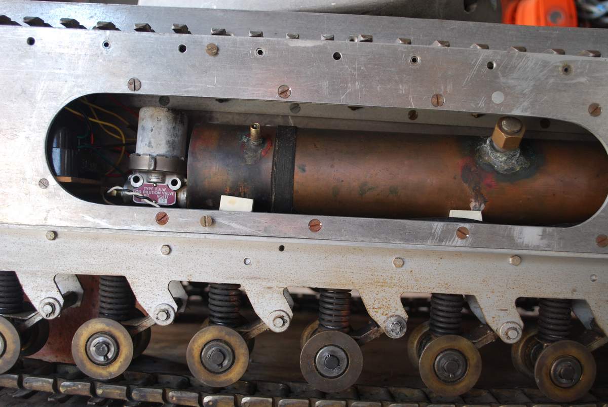

Some more photos showing the tank with the turret on. The motor to drive the turret is inside the turret and is powered by slip rings and brushes on a central shaft. It works but unable to reverse the direction of the motor as again it is a compound motor and this one unlike the winch motors is wired internally. We removed a side panel as you can see and lo and behold there is a copper cylinder with the outlet pipe connected to a 12 volt operated valve whether this is some form of smoker we are not sure. We have now since found out it was used for "spraying water on little boys wishing to tamper with it".
Dennis.
Dennis.

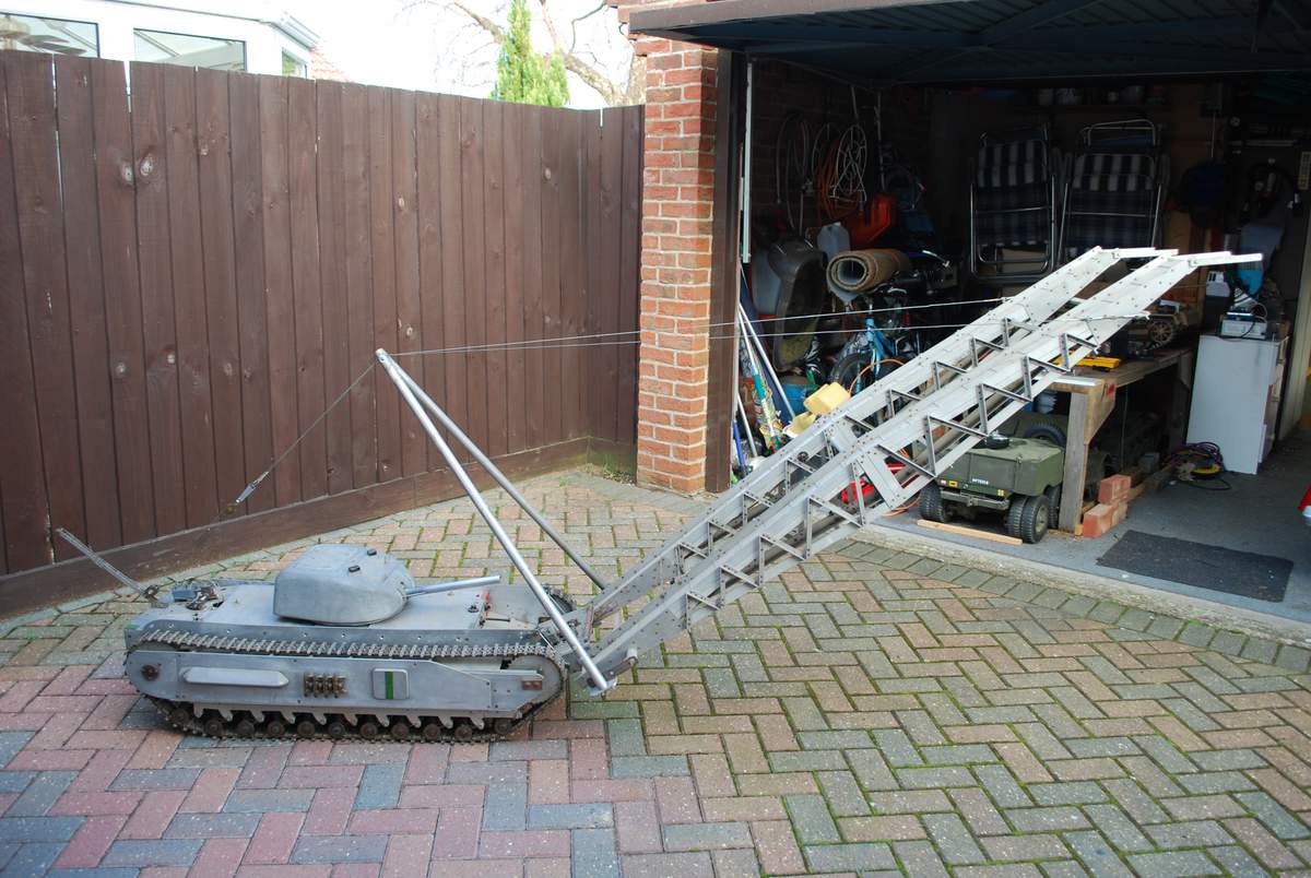

Managed to get a photo of 1/35th scale of the tank. At least we can now see how the bridge was controlled. We thought that the A frame was mounted on the tank but as you can see from the photo it is mounted on the bridge. We had only one half of the A frame but I have managed to fabricate an identical one to match.
Photo of 1/6th scale version, some work to do on the pulley and cable system as the winch motor did struggle a bit. Looking at the 1/35th scale version if that is accurate then it looks as though the bridge was raised by hand winches. Total length when down 10ft 6ins or 3.2mtrs.
Dennis.

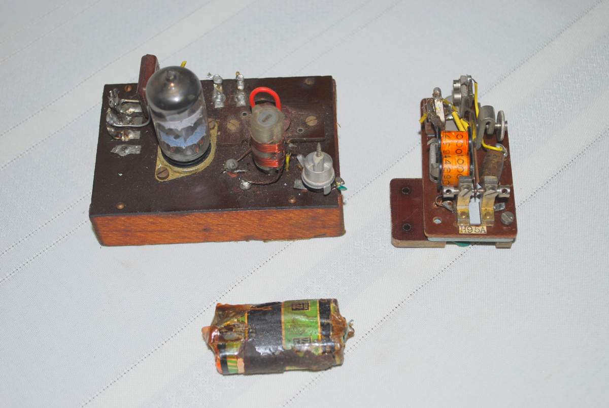

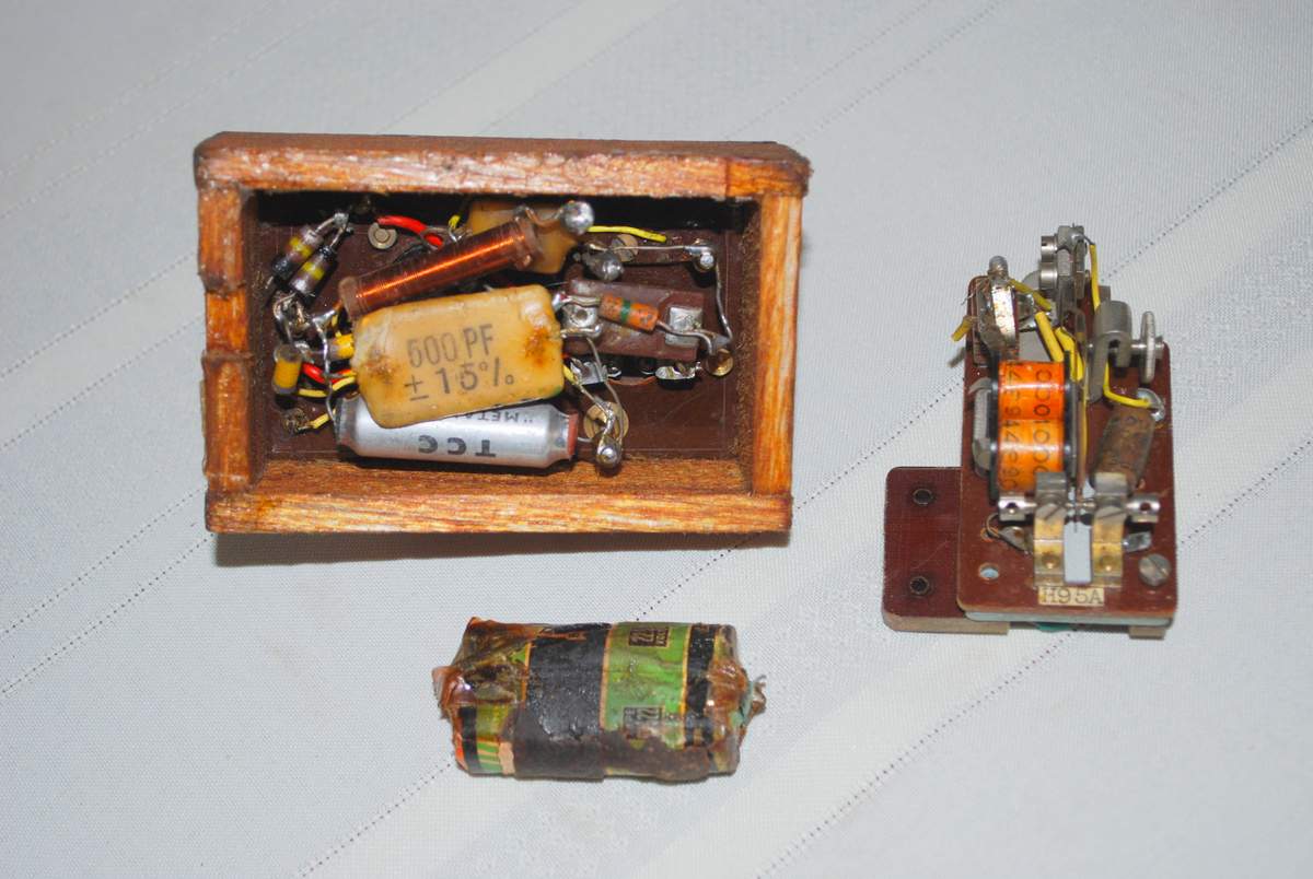

Removed an aluminium cover yesterday as there seemed to be a lot of wires going through to it and low and behold the radio control receiver was uncovered. The battery in the foreground is 22.5 volt used as ht for the double triode valve. Have had to replace both winch motors as the old ones didn't have enough power to raise the bridge. New radio control equipment arriving ths weekend.
Dennis.
