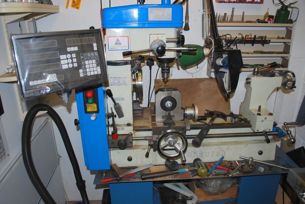

I would agree with Stephen on most points. I bought a Chester Model B about 10 years ago, it being a combined lathe and milling machine. A similar machine is sold by Machine Mart. The main reason I bought a combined m/c was lack of space in my workshop/garage. I do have the advantage of being able to swing 9" diam in the lathe chuck. I am building a 1" steam traction engine at the moment and for this I have to quite a bit of milling but I must admit it involves quite a bit of igenuity as to positioning the workpiece. So if you have got the cash and room, then go for two separate bits of kit. You might want to look at http://www.chestermachinetools.com they do a large range of lathes and milling machines.
