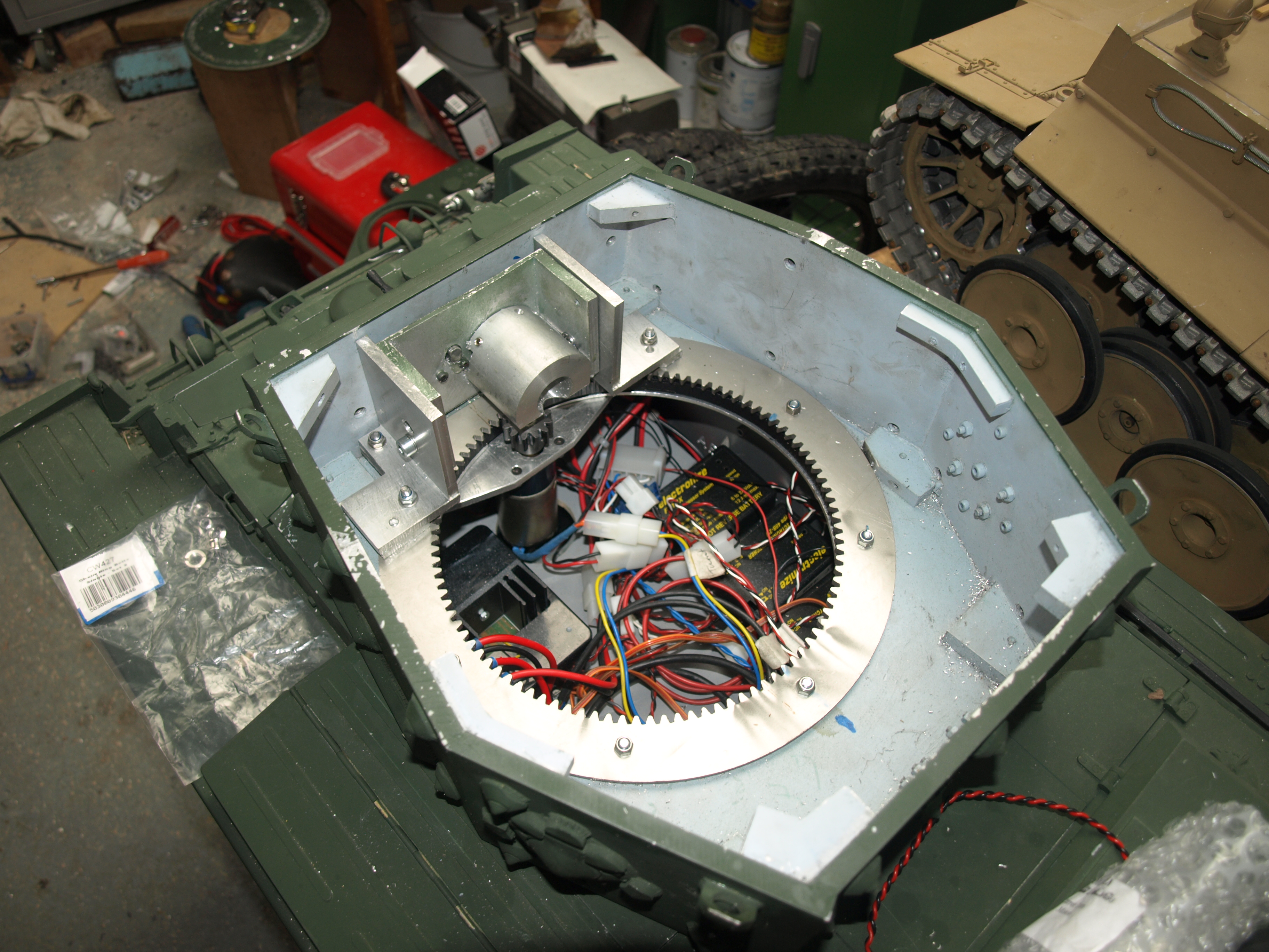

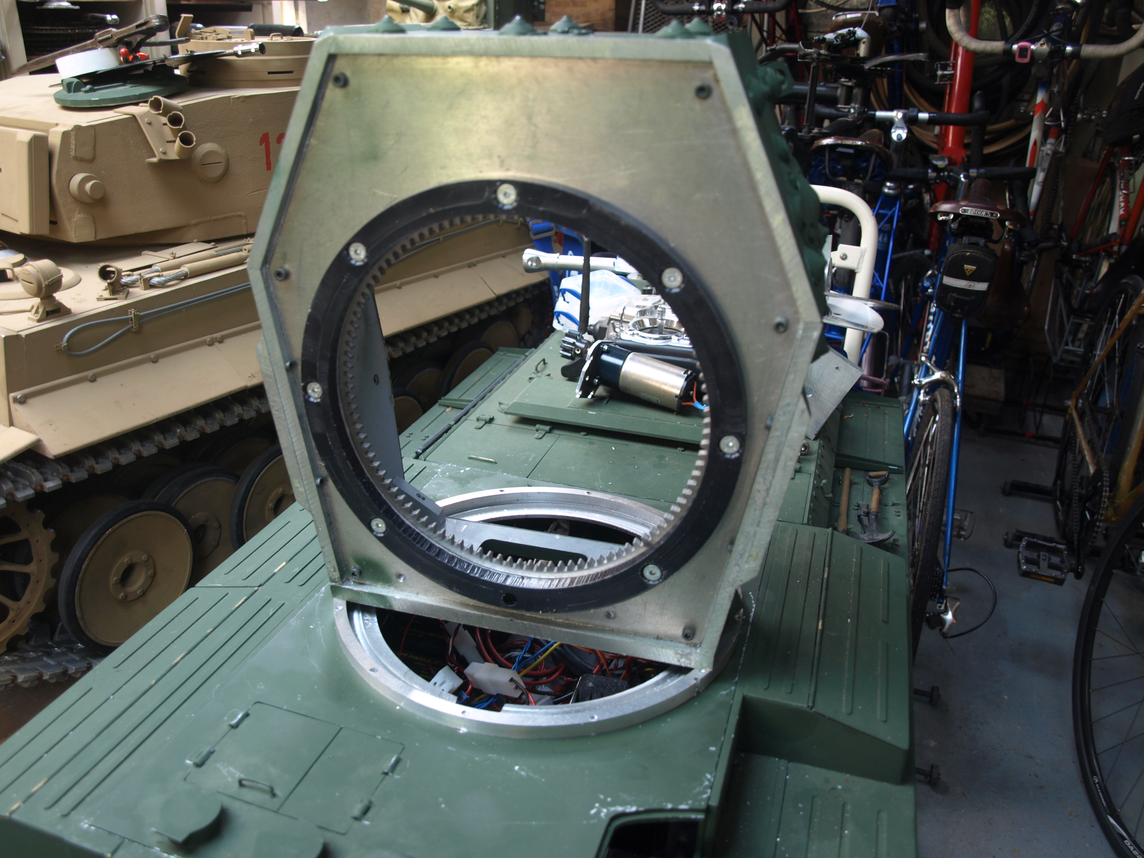

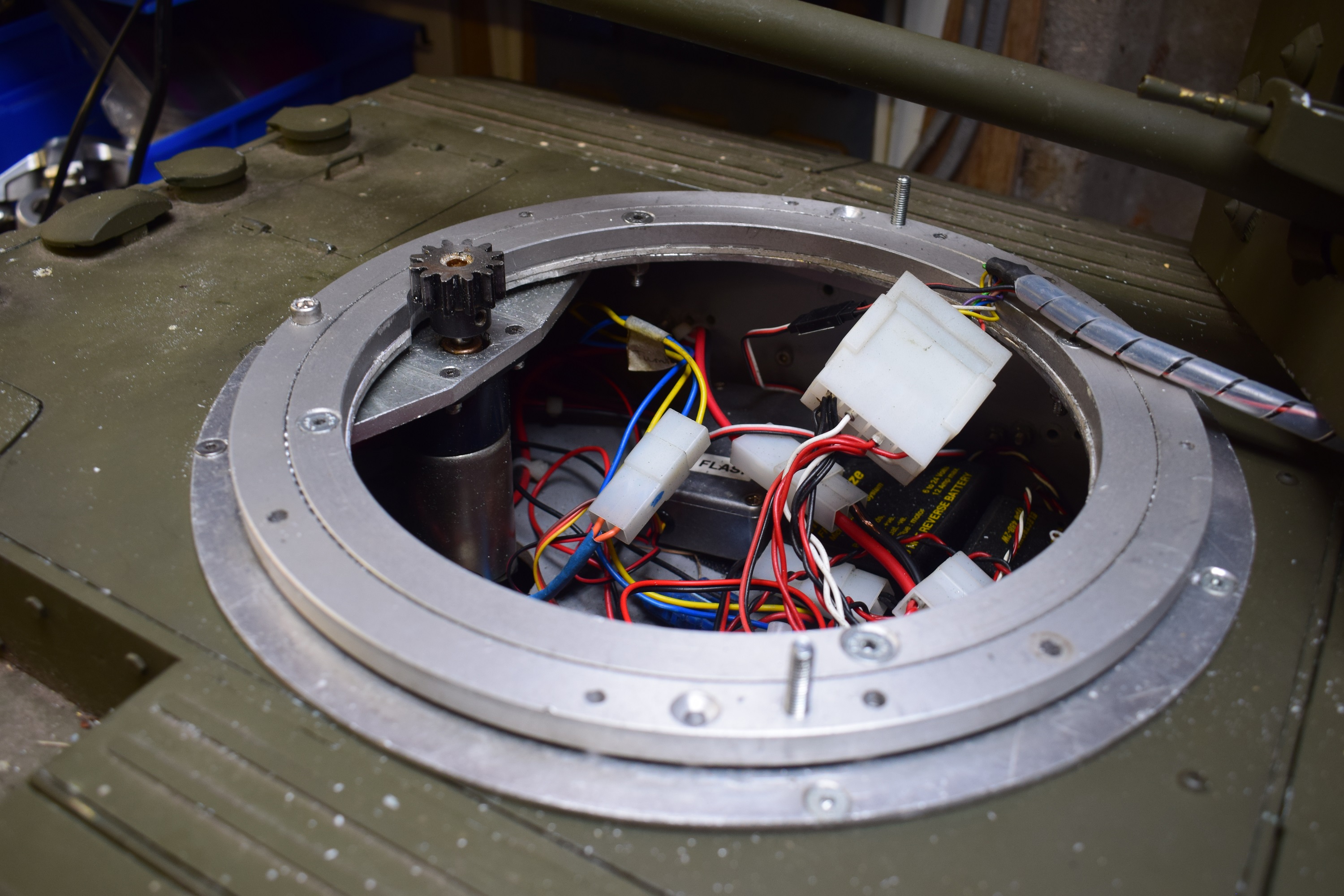

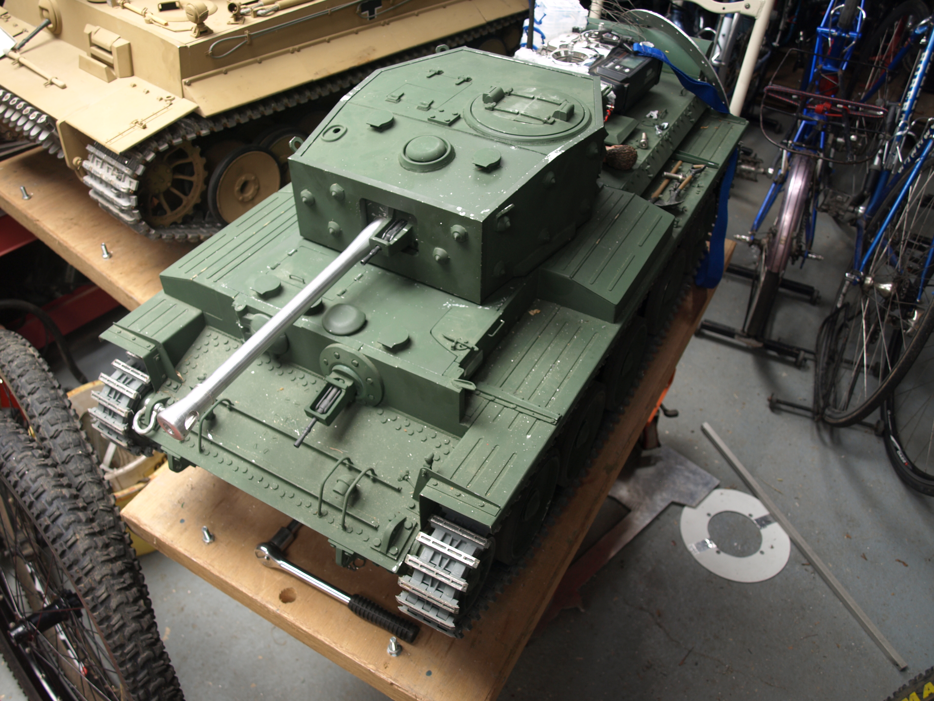

Having taken on the Cromwell I have been working slowly on the mudguards and have now completed producing a turret gear ring and then installing it. The original system was a lazy-susan.
But I wanted to open out the hull as it is a bit tight for space.
Getting the gear ring made was achieved with the help of a local engineering company who's designer produced the CAD drawing and then referred for the me to someone else to cut the gearing itself. I had to cut large holes in turret base and the deck of the tank to suit the bearing and the gear ring. I milled the two halves of the bearing out of a thick sheet of nylon and an equally thick slab of aluminium, producing three dustpans full of plastic and metal swarf! Once made it all bolted together reasonably straight forward way, and I then made the mount for the turret motor and rejigged the mountings for gun. Now it is completed it looks no different to how it was originally!

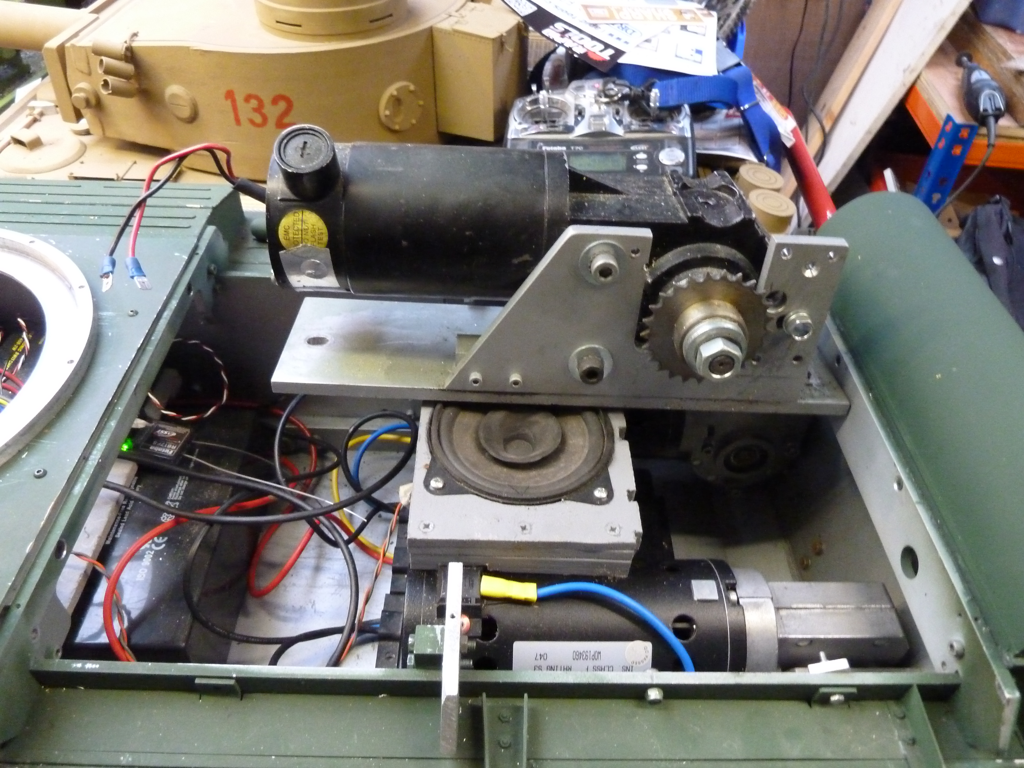

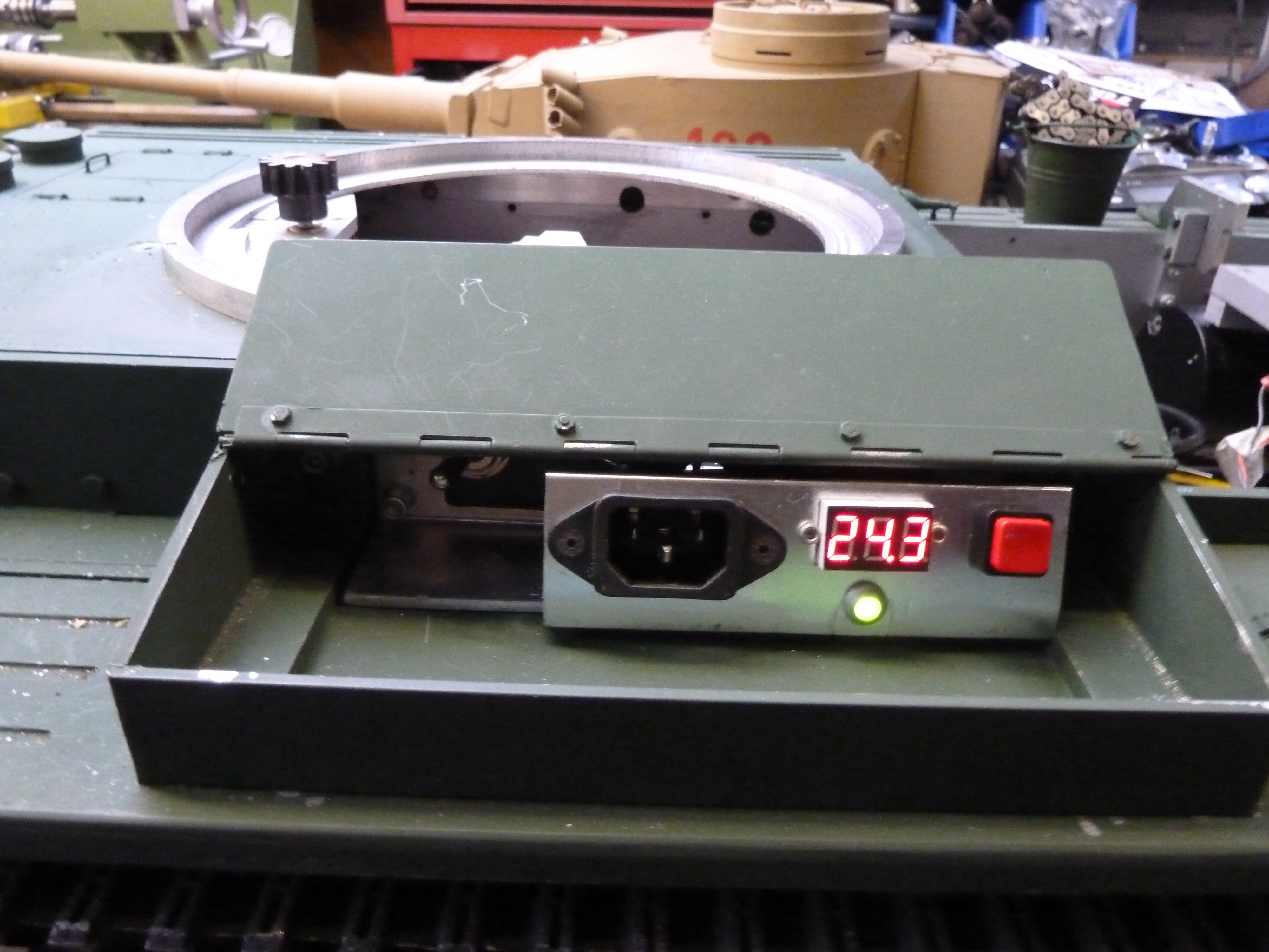

I have used the option packs from my Tiger which I upgraded to the latest generation to go into the Cromwell which only had the motors left in. These motors are quite big and use chain drive which takes up a fair amount of room, which when using the Electronise and 4QD units means there is not much space. So I fitted the Tiger motors into the hull instead. Including fitting new engine mounting blocks, which meant each side of the hull had to be taken apart to get them in, fun and games. This photo shows the end result
Whilst doing this I have fitted a remote Momentary Switch and Power on Light for the Power Supply Model and using the Component Shops General Purpose Voltage Meter created a means of telling when the battery is switched on. I have fitted a charging socket and a Toggle switch to turn the charge circuit or the power circuit on and have the tank turned completely off. All for safety and to avoid embarrassing mistakes

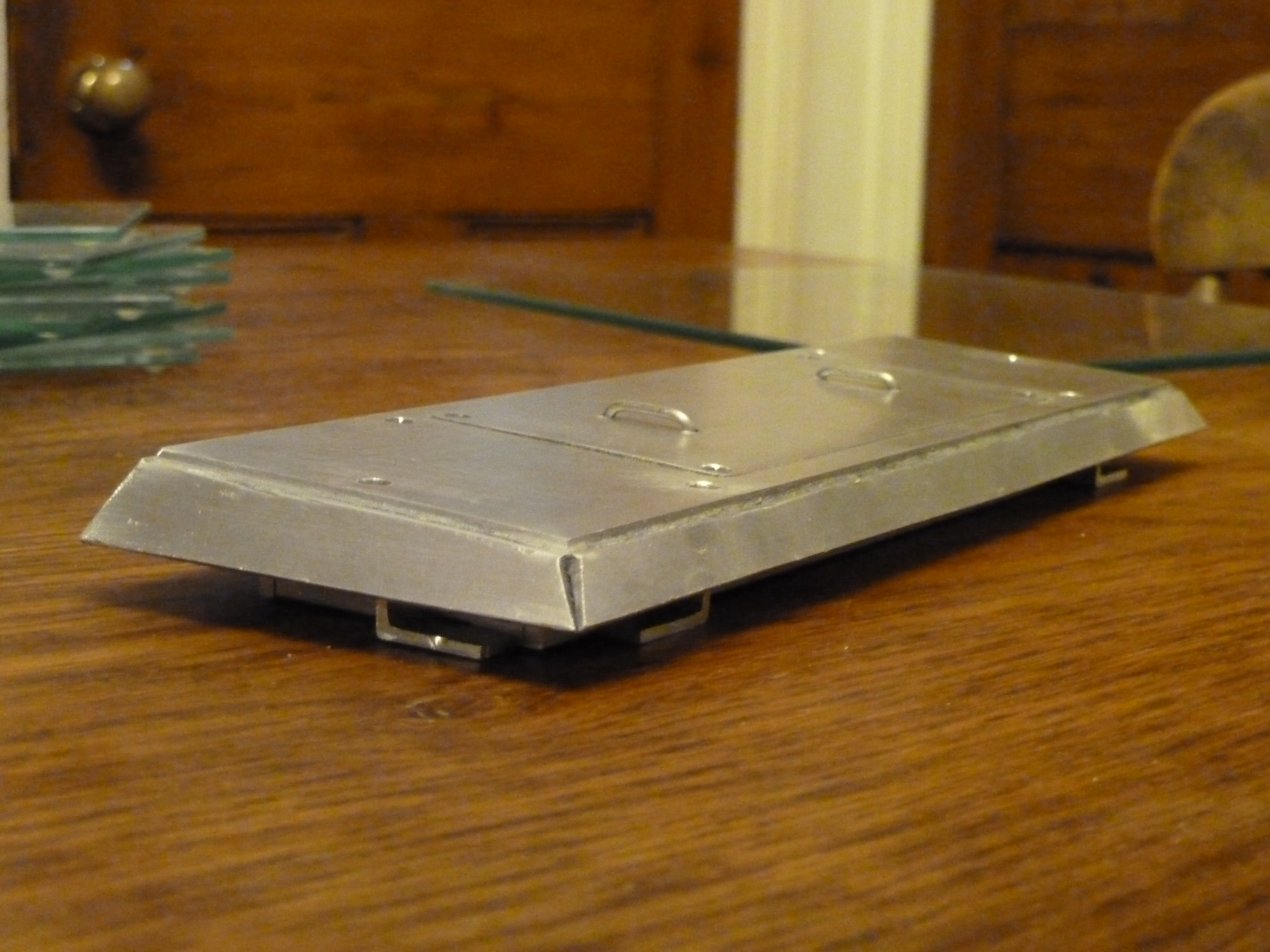

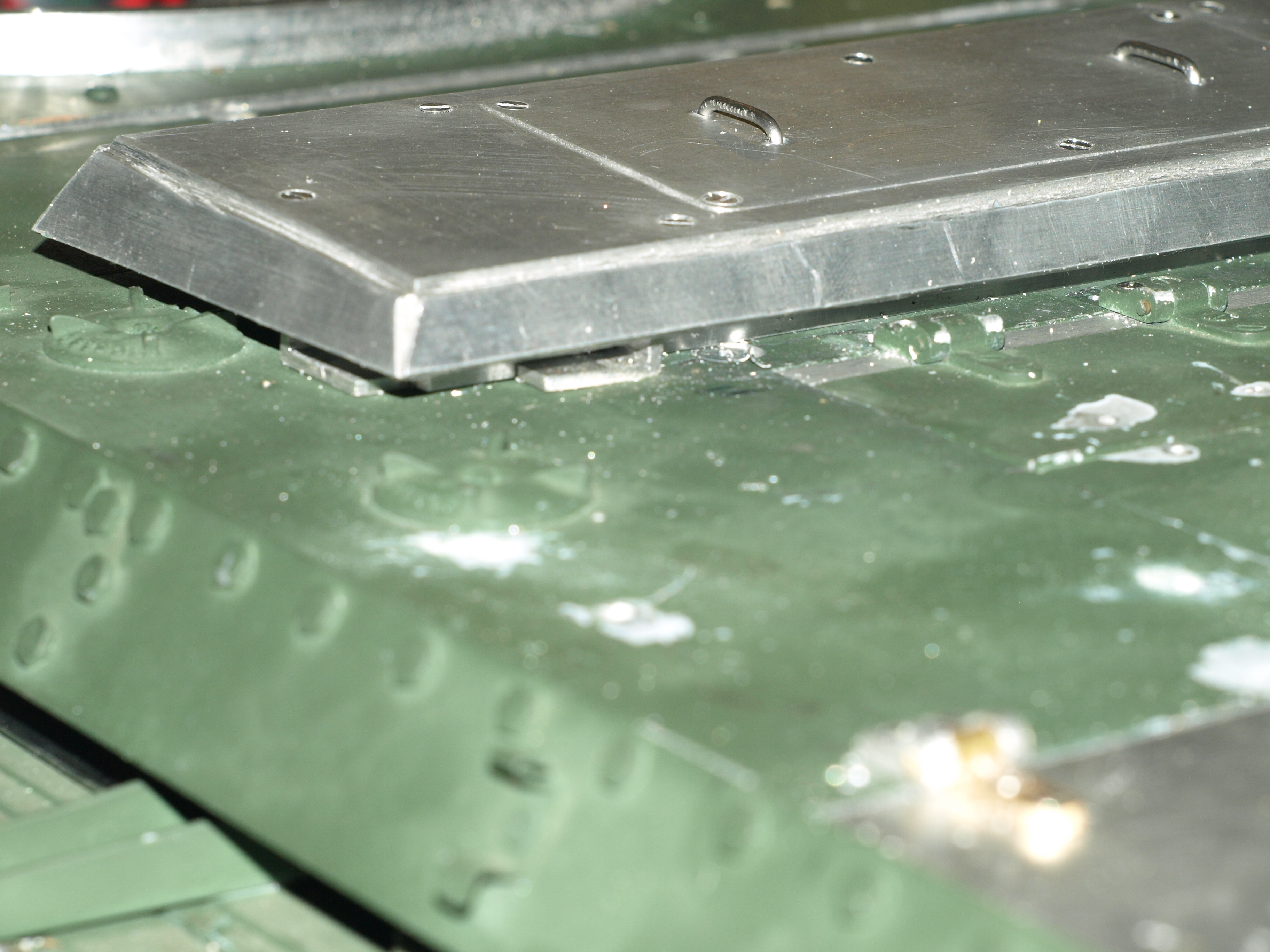

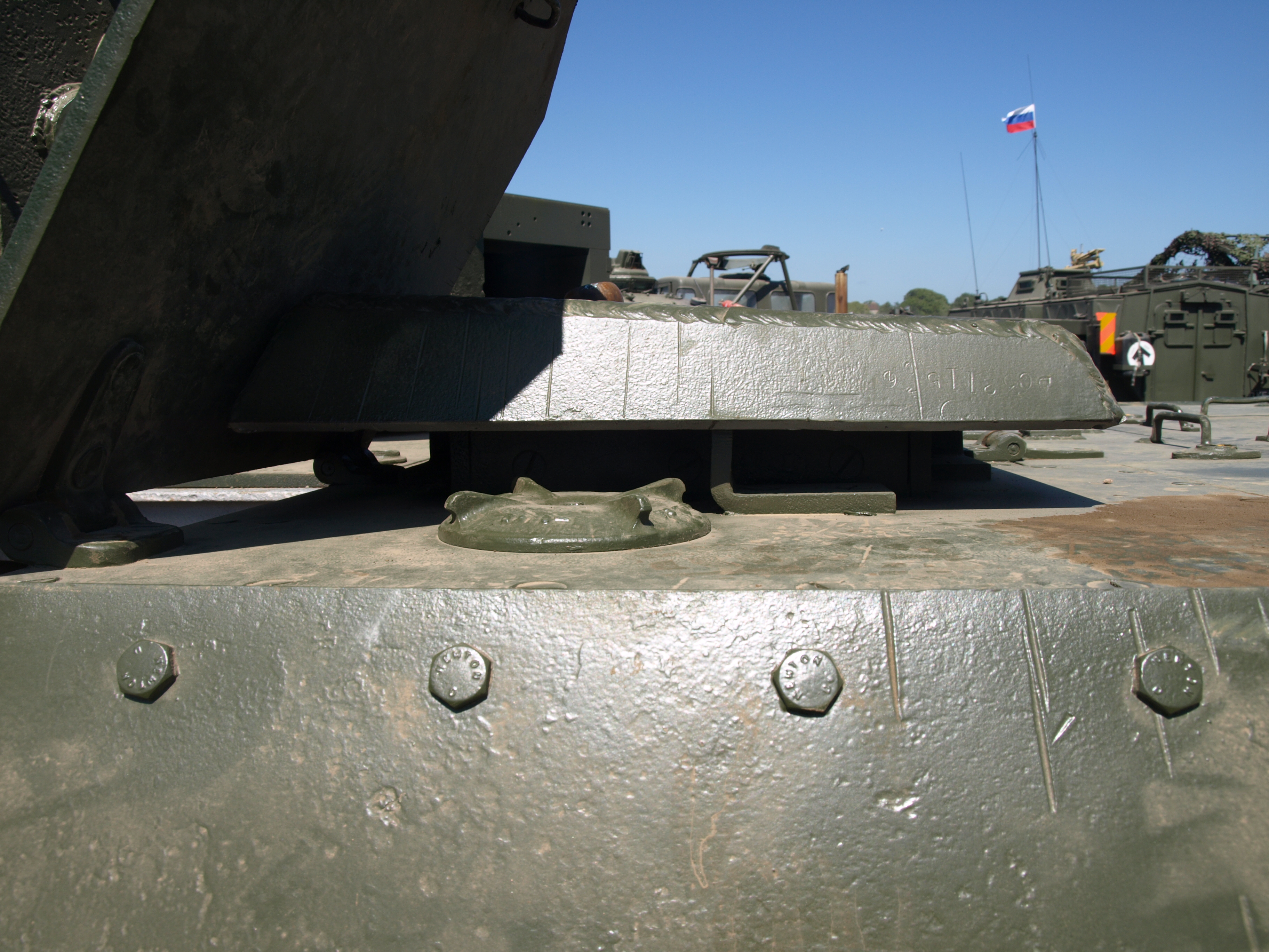

The cold spell has not made working in the garage in the evening too pleasant but my next project has been to make a new Engine vent for the Cromwell, in real life it is simpler than the Comet, however the less robust supports for the cover are harder to replicate and caused me more brain strain the ones for the Comet.
The real Engine Vent on Shufti Cush The Model Engine Vent I have now to fill the bolt holes and prime the cover and Milliput the welds. Then onto adding a couple of extra hatches on the rear deck, to get the hull to be closer to an earlier D Type Hull.
Now warming up in front of the computer. Steve

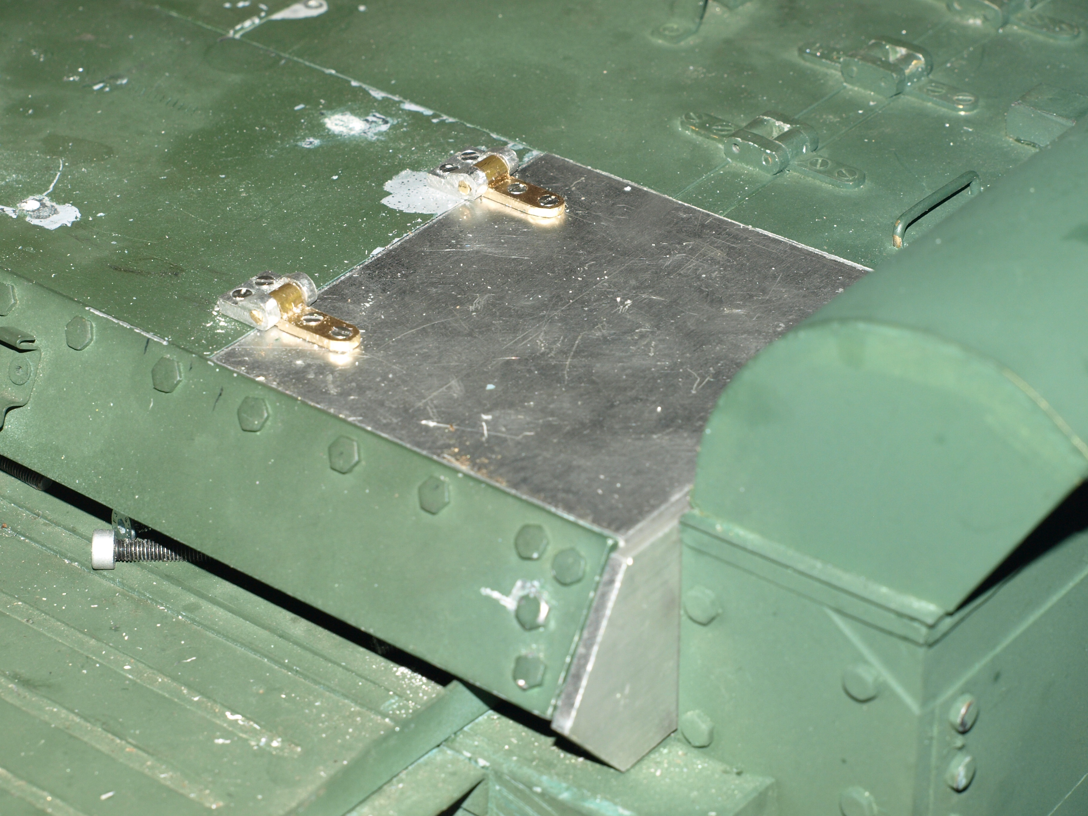

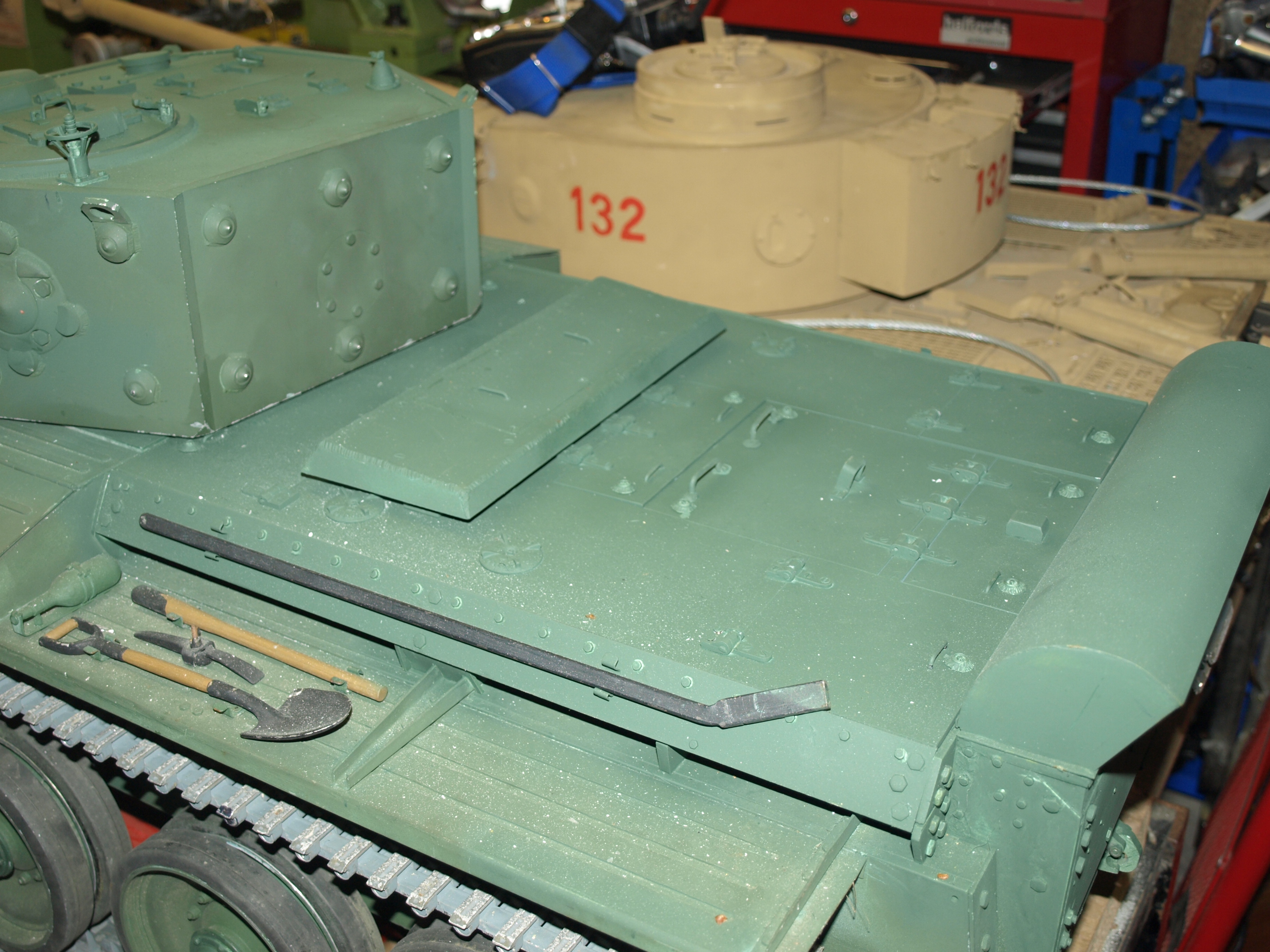

I have now made the extra hatches to make the deck an earlier D type by copying the existing hinges and doing quite a bit of support work under the deck to allow for the new hatches.
The new vent is also installed, which entailed moving the central line of hatches back a bit with a fillet added to the deck. To improve the engine sound I have cut a hole beneath the vent which allows free passage of noise from the loud speaker underneath.
More hatch handles are next on the list to be made and fitted, then a whole lot of holes to fill before repainting the deck!Steve

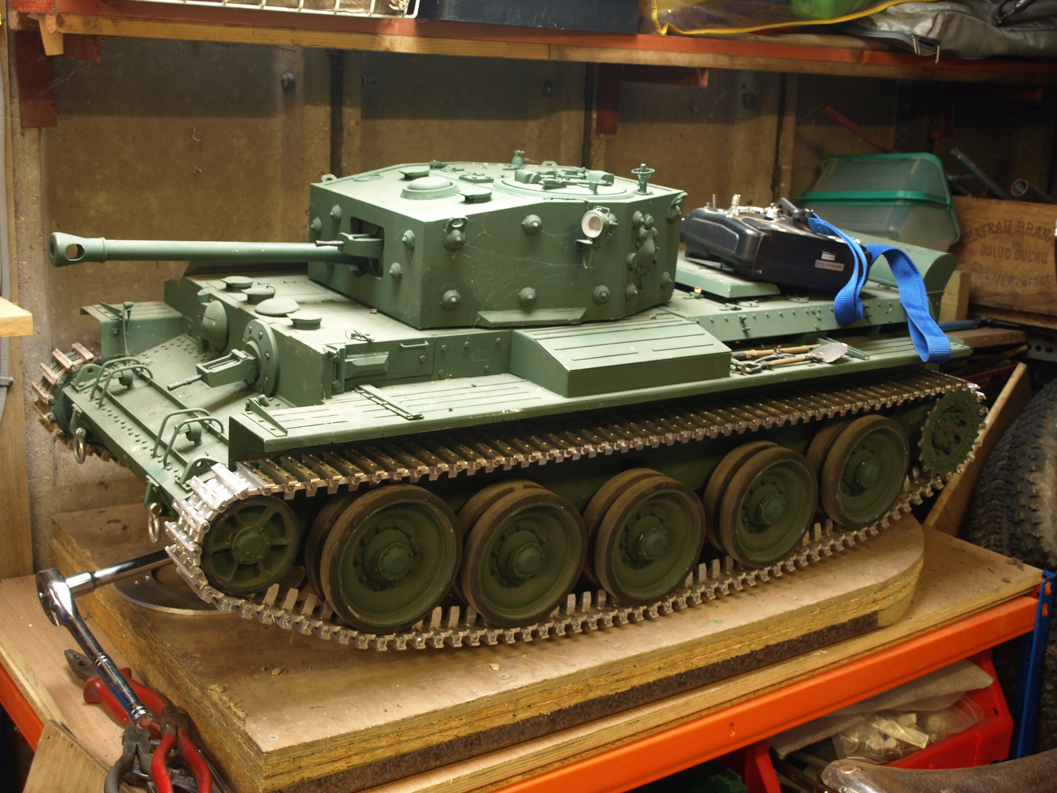

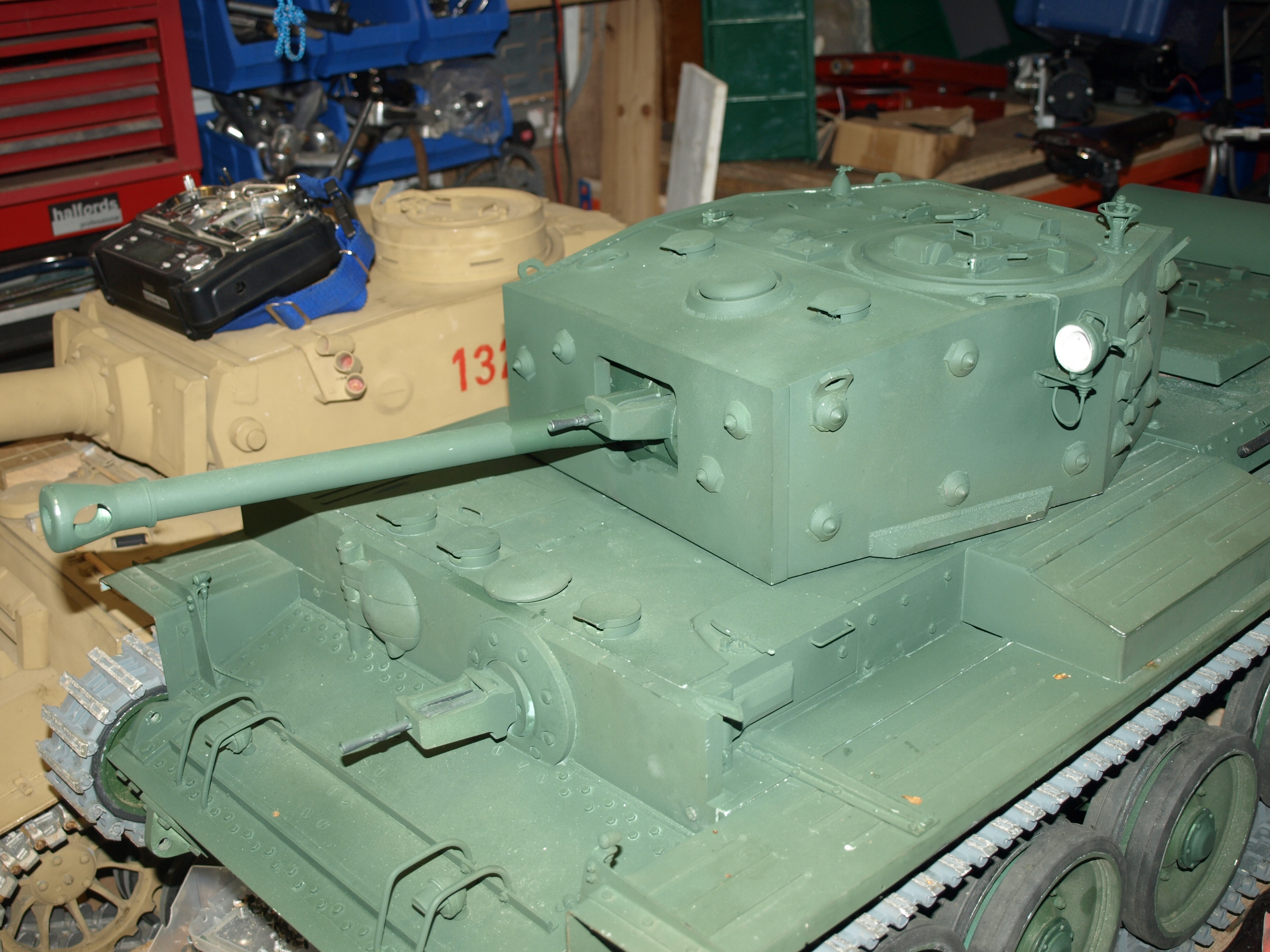

Ironically I have just been down to the Garage to photograph the Cromwell and loged on to discover Derek has also posted on the Comet. So here is my contribution to British Tank building!

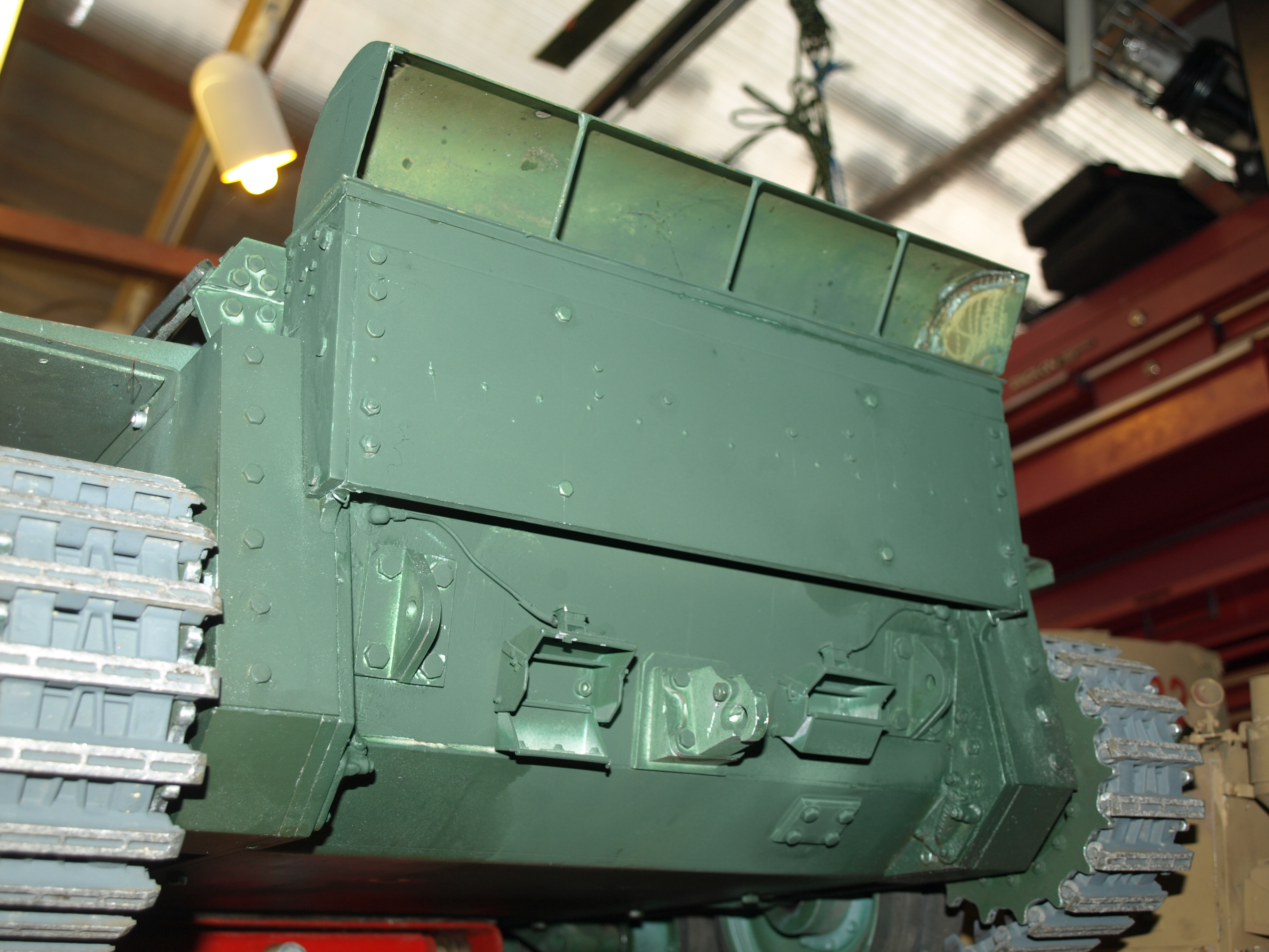

I have now pretty well finished the top of the rear deck: The Rear of the Cromwell had lots of holes drilled and taped for various sizes of bolts to replicate the profusion of fastenings found: My latest work has been making, copying Armorpax Comet, Turret Hatch Latches. I have used his fittings as a basis for what are similar but different fittings. I have been experimenting using Tiranti supplies making moulds and casting in white metal, a satisfying challenge. I hope to have the Cromwell at Shepton Mallet this Saturday so not much more tinkering time.

I really like these bearings - they are not very expensive, I'm going to try and retrofit all of my older Armortek models (Sherman, 2007 Late Tiger 1) with this type of turret bearing.
Really nice work on the conversion. The Cromwell is a very seldom modeled subject. Nice job on the new tracks, were these die cast, or spin cast?

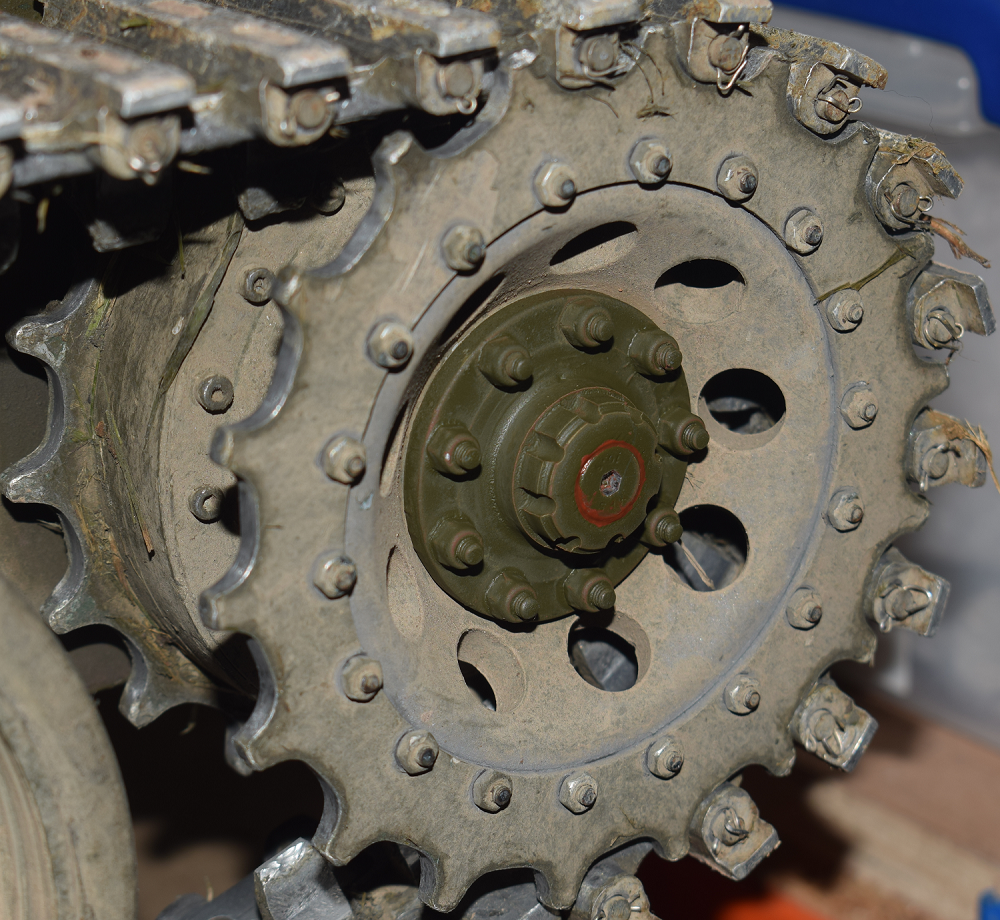

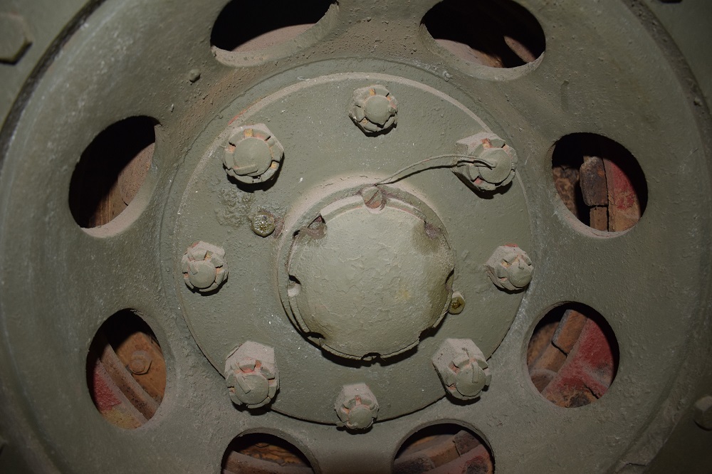

Comet drive sprocket centre cover made me react to the naked 5mm cap head bolt to produce something more like the prototype.
The sad thing is that the weathering has been lost so more running through muddy water is going to be needed. I hope this sequence effectively shows that a model is a work in progress. There is always something that can be looked at again and worked on.
I have now got my Rotary Table sorted so that I could produce the indentations.
