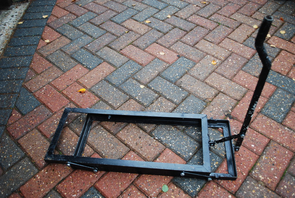

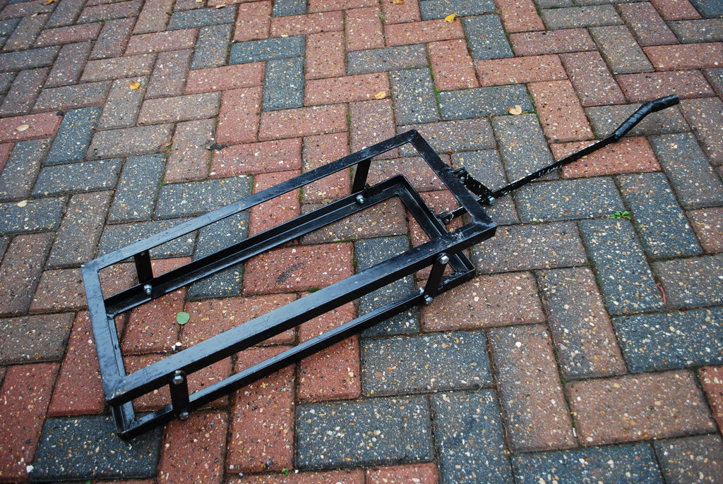

Re: Test Drive
Hi Jason,
This is one that I built cost about £10, it has lifted a King Tiger, Panther, Comet, Panzer 3 and a Tiger 1. Just pull the lever and it's up with enough clearance to get the tracks off the ground and it is very stable. Handle comes off so very portable. If you have access to some welding gear then I can supply dimensions.
Dennis.
Dennis.

Re: Test Drive
Very nice. You should go into production. Looks quite portable.

Re: Test Drive
Hi Dennis that's quite nifty. I think John is right, there's a market for that.
I have no access to welding gear unfortunately.
I did manage to find a dirt cheap motorcycle lift on evil-bay, should do the trick.

Re: Test Drive
I like that dennis. Light and fast. Great idea
