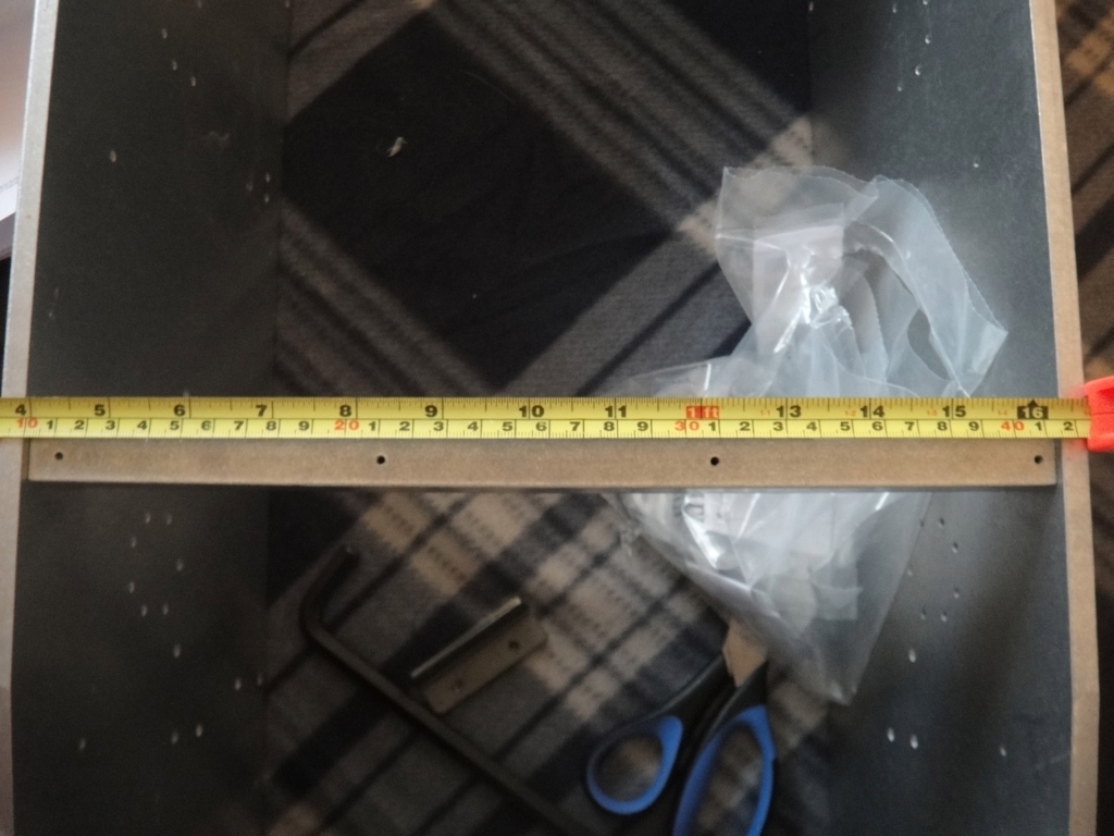

Waiting for lifting trolley to arrive - one of the occupational hazards of island life! Meanwhile have borrowed the dining room table to try dry fitting parts and have hit my first snag
The forward fixing holes in the main deck plate don't line up with the tapped holes in the front stretcher bar. The difference is such that reversing the stretcher back to front makes no difference. Anyone else had this issue?
Presumably solution is straightforward.... Fill existing stretcher holes and re-drill / tap to suit holes in the deck plate? Thought I had better check first.

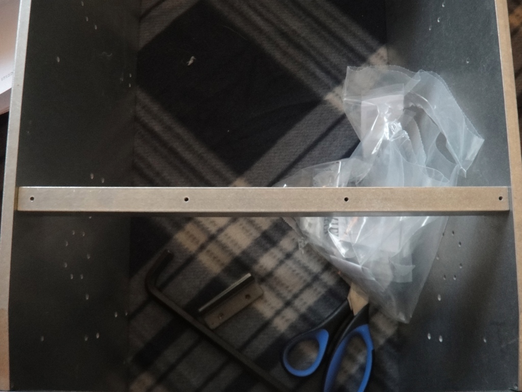

Sorry about that - problem is lateral. The holes in the 2 parts are aligned fore and aft but the holes in the stretcher are just under the edge of the deck holes. I reversed the stretcher end for end and the problem was same, just displaced to the opposite edges of the deck holes.
Hope you can visualise from the description as not sure it will photograph clearly. I'll try tomorrow though......
Kevin

As promised.....
Sorry about the image quality - I reduced the resolution from 3.8mb for sake of forum server space but essentially you should see that the 4 holes are not central on the stretcher. The hole on the outside left is approx 12mm from the side panel, that on the right is about 7mm.
Hopefully you can make out the "half moon" of the drilled hole beneath the deck plate. As previously mentioned, reversing the stretcher moves this to the opposite side. The deck plate is square on the mid stretcher,those holes line up, and the gap between it and the side plates is equal both sides. Presume the gap is "normal" or should it be a snug fit?
Kevin
Kevin

Hi Mark - my latest post crossed with yours. Trust you can now see what I mean.
Appreciate the offer - although the corrective measures I mentioned earlier are just about within my capabilities. If you can stick one in a jiffy bag it will save me the hassle though? See what you think when you've seen the pics.

hi kevin, you certainly have got a faulty part there, i got on with my hull build this morning and all holes line up perfectly with pin point precision.Glad you gave us the info though as it made me double or triple check everything as i built the hull.
