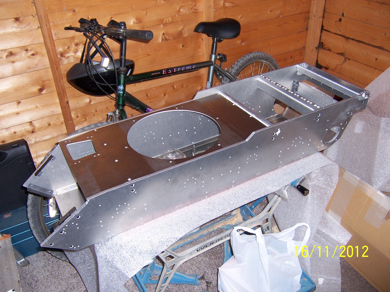

Yesterday we moved the hull parts to the construction area and loosely screwed them together. The plan is to build the basic hull, paint it and then add to it, I'm assuming the motion pack bits will still fit trough the engine hatches and turret ring?

The weather has been quite bad, the hull in the shed was getting covered in condensation so we brought it in from the cold to the spare room - just temporary.

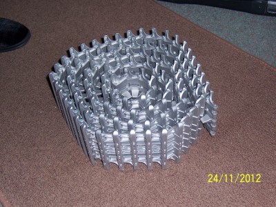

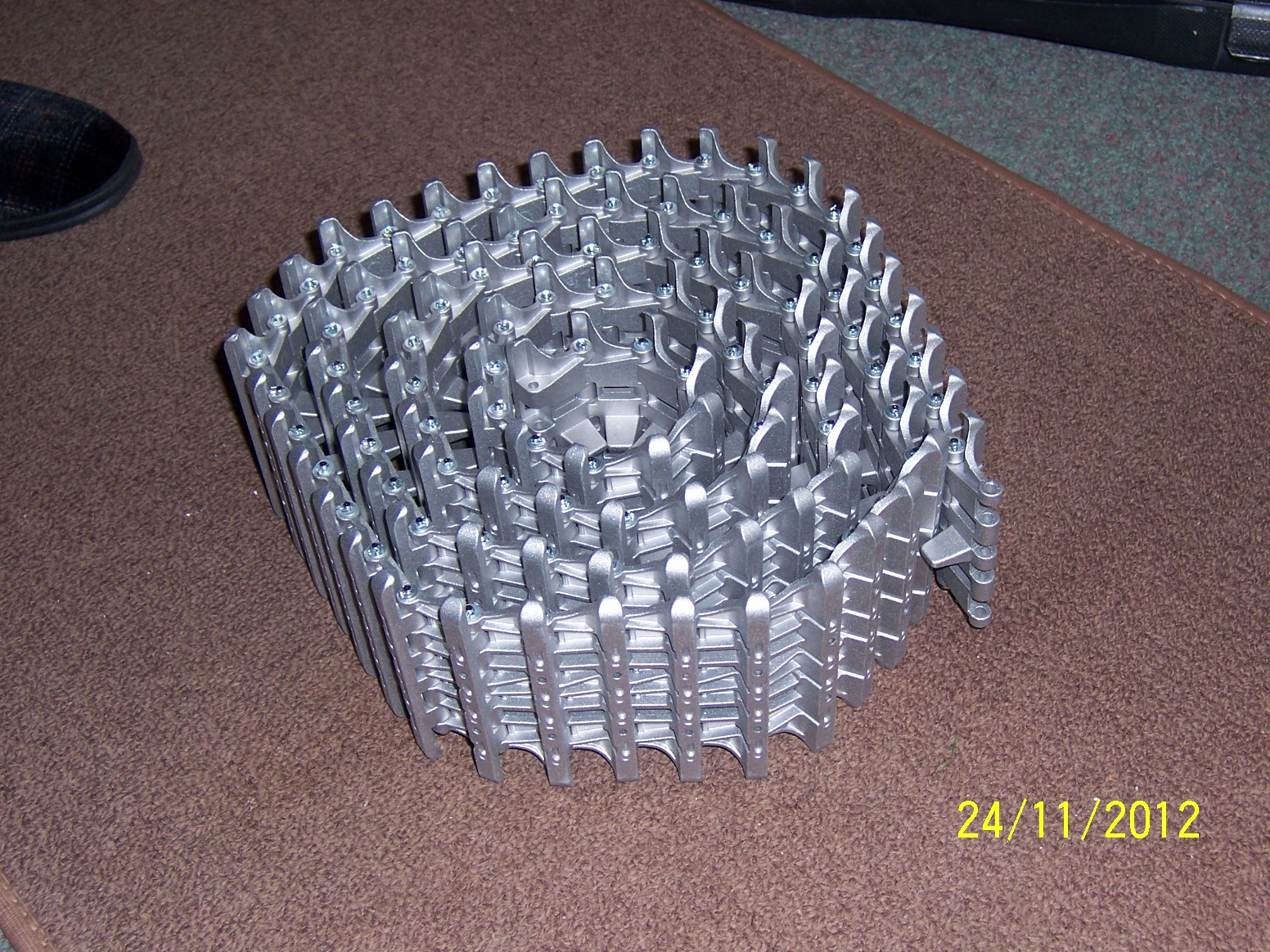

Here is 100 links
Here is 100 links

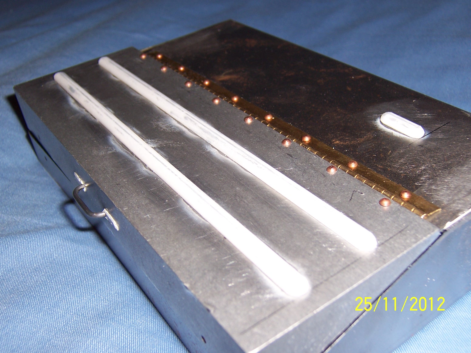

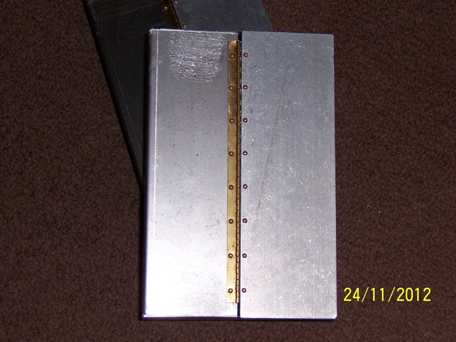

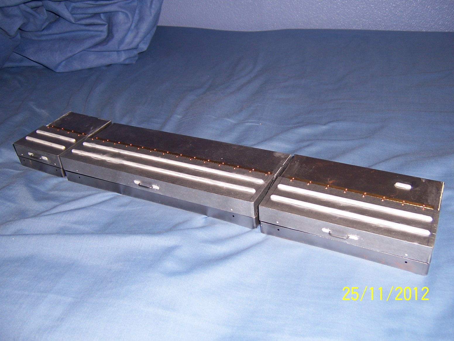

Riveted side bins
Riveted side bins

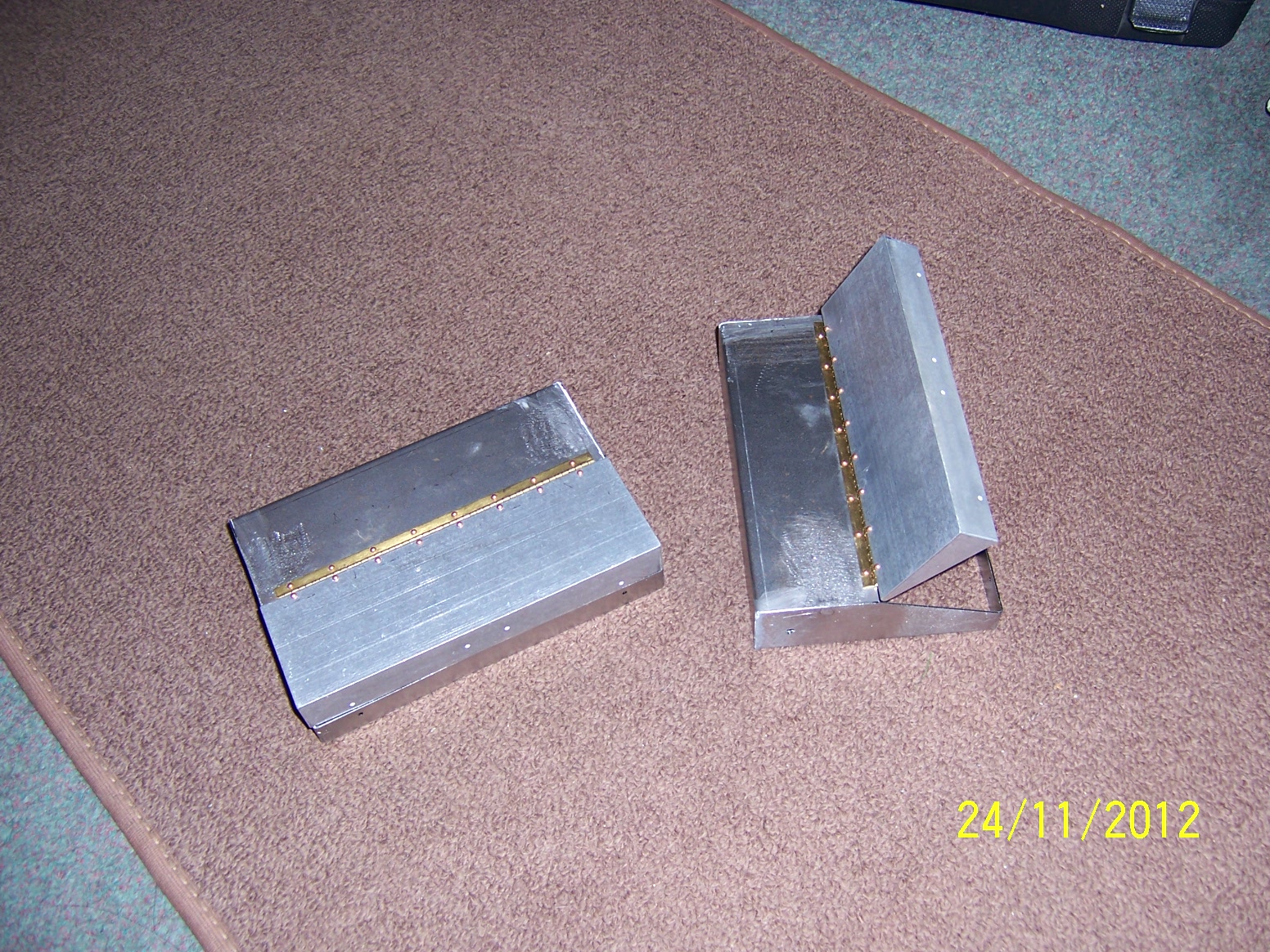

We managed to create some tools for riveting, drilled a dimple in a piece of metal to keep the domed head during the hammering. It took one of us to hold the pieces together while the other hit them.
Detailed bins
Detailed bins
I got some Evergreen quarter round strip for the raised strip on the lids, couldn't find big enough half round :(

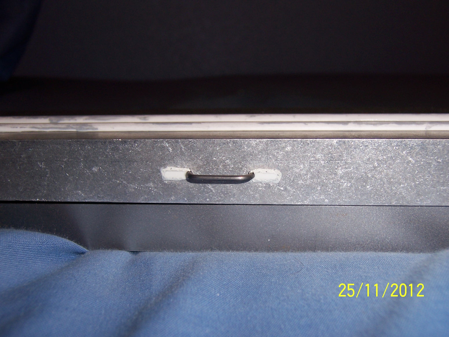

To make the handles look flattened and welded I used a small piece of plastic and some Milliput.

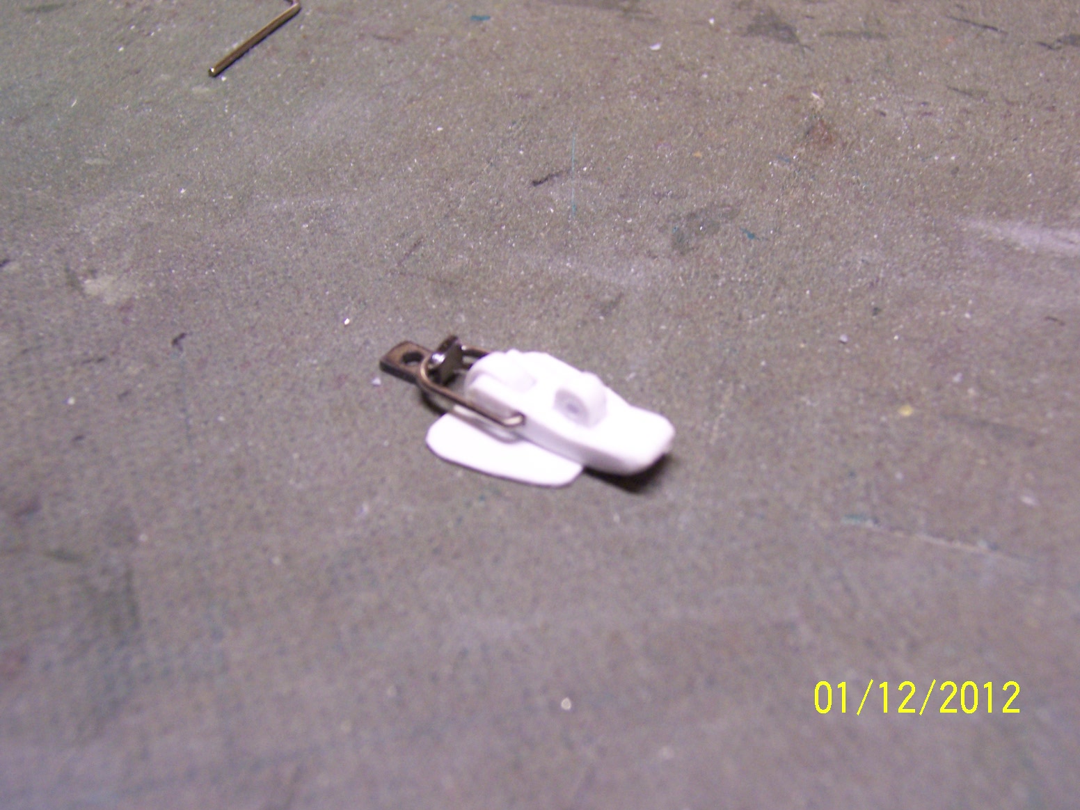

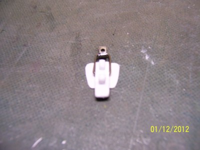

After a lot of thought I decided making workable bin catches was beyond my skill, so I'll attempt some resin casting.
the master catch
the master catch
I'll also do the filler caps.
