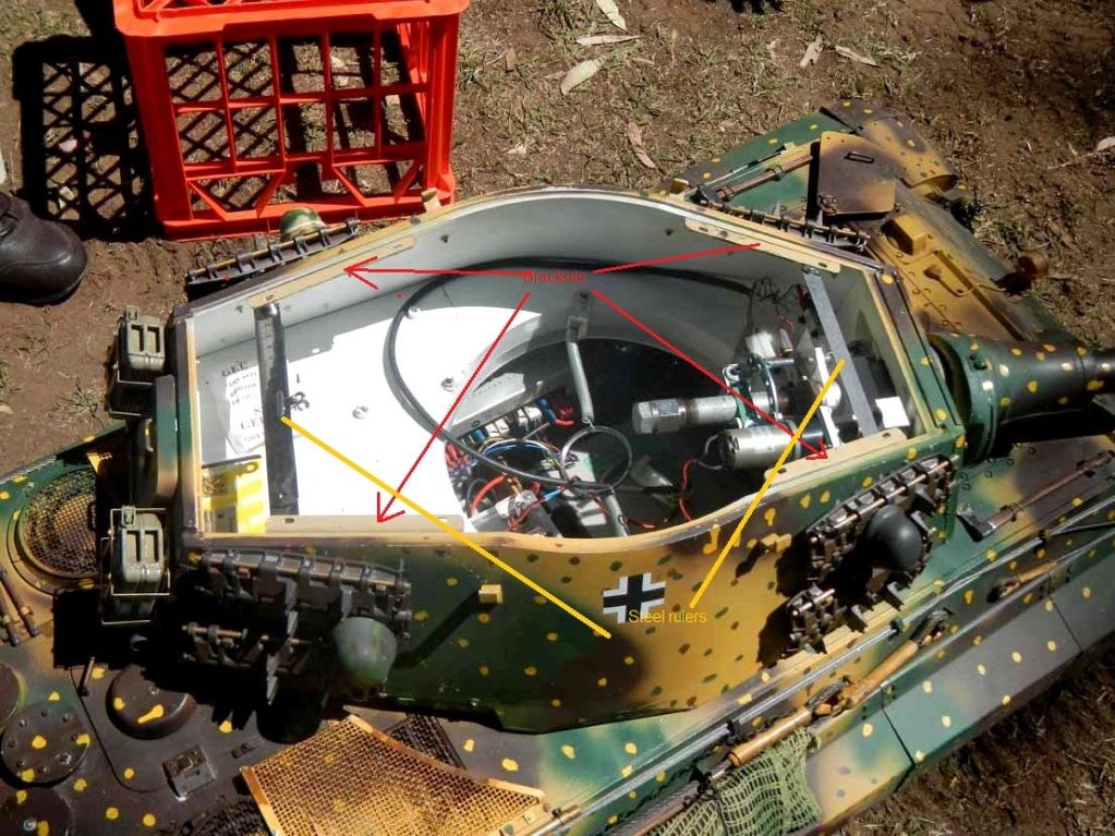

Hi Chaps,
By reading Ray's topic of Tiger 1's turret lid, I have similar question:
Without locking the lid with screws on 4 brackets, how to keep the King Tiger's turret lid stay where it is? So far I have not experienced dropping it out while in action. But is there better way to more secure it?
I am thinking of magnet (as you can see two steel rulers already stayed there by 4 strong magnets. All I need is 4 more magnets glued on the down side of the lid to attract the steel rulers. But I am not sure is this a good idea?)
Any better idea? Thanks in advance.

Velcro!! :lol:
Just jocking, im probably going for magnets too i think

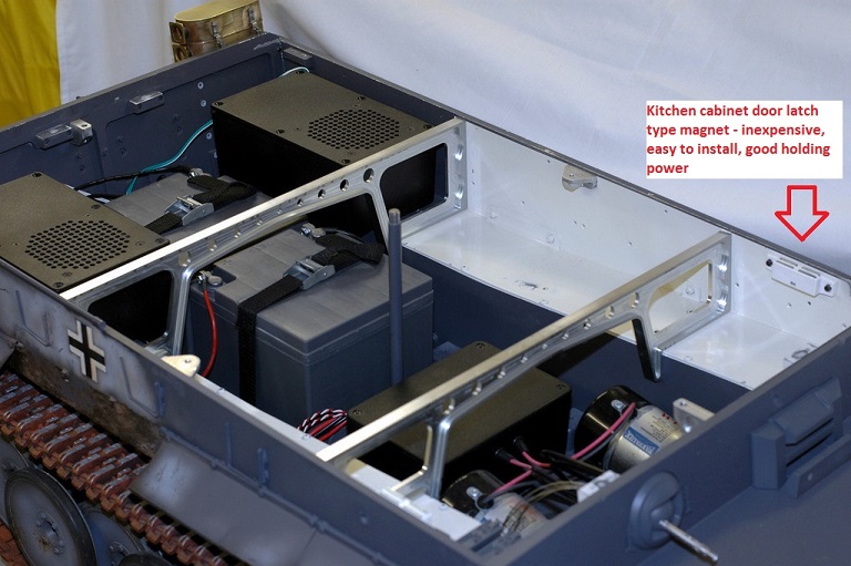

I'm going to use a method similar to what Robin describes to make the weld line around the turret roof. I used rare earth magnets drilled and epoxied into the roof plate on my Tiger 1. This seems to hold ok.
But I think a better solution is the cabinet latch type magnets - similar to what Vince Abbot and John Fitzsimmons used. See image below. This type magnet are inexpensive, generally easy to find, and hold well. One does need to add a small steel plate to the roof or deck (assuming it is aluminum).
Vince Abbot hull:
This will work equally well in hull or roof situation.
Greg Stephens
Posts: 128
Been liked: 11 times
Re: Turret lid
Post by Greg Stephens »
That looks like the technique I am going to use. Those are beautiful deck supports. Did you make them?
Posts: 2355
Has liked: 163 times
Been liked: 849 times
Re: Turret lid
Hello Greg
I could CNC machine them but those were made by Vince Abbot. He was a member of this forum very early on (2006-7). He made some exceptional parts. So no those are not mine. I tried to save as many pictures of his stuff as I could.
Sadly he left 1/6 scale modeling to do special effects for movies. Go figure!
