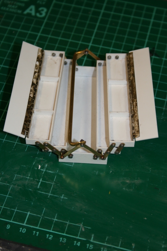

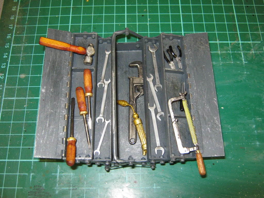

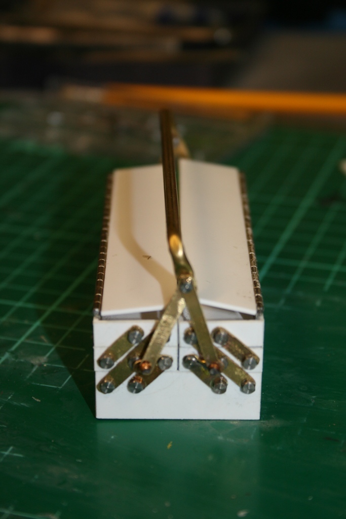

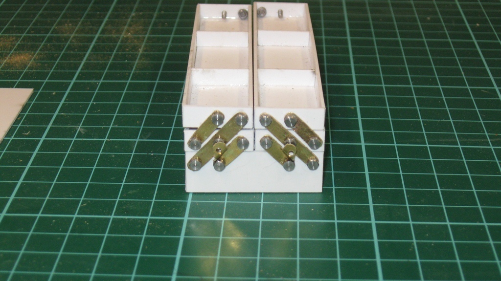

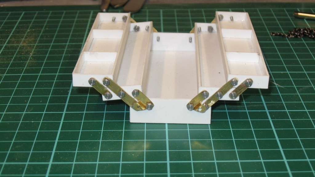

Been working on a 6th scale tool box for a month or so now and I have finally got it finished :shock: 8)

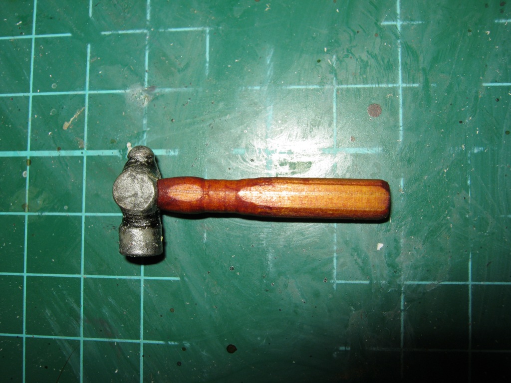

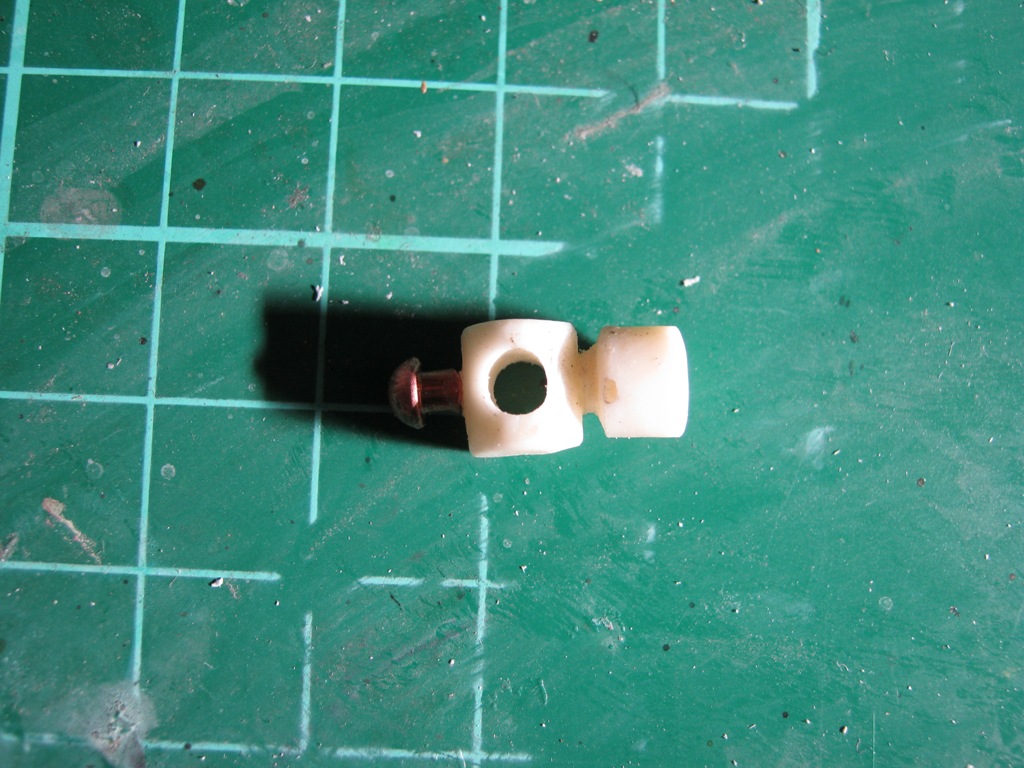

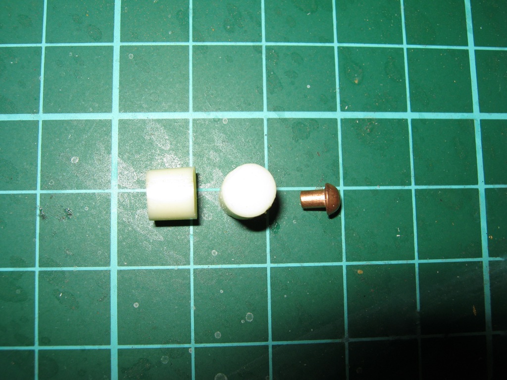

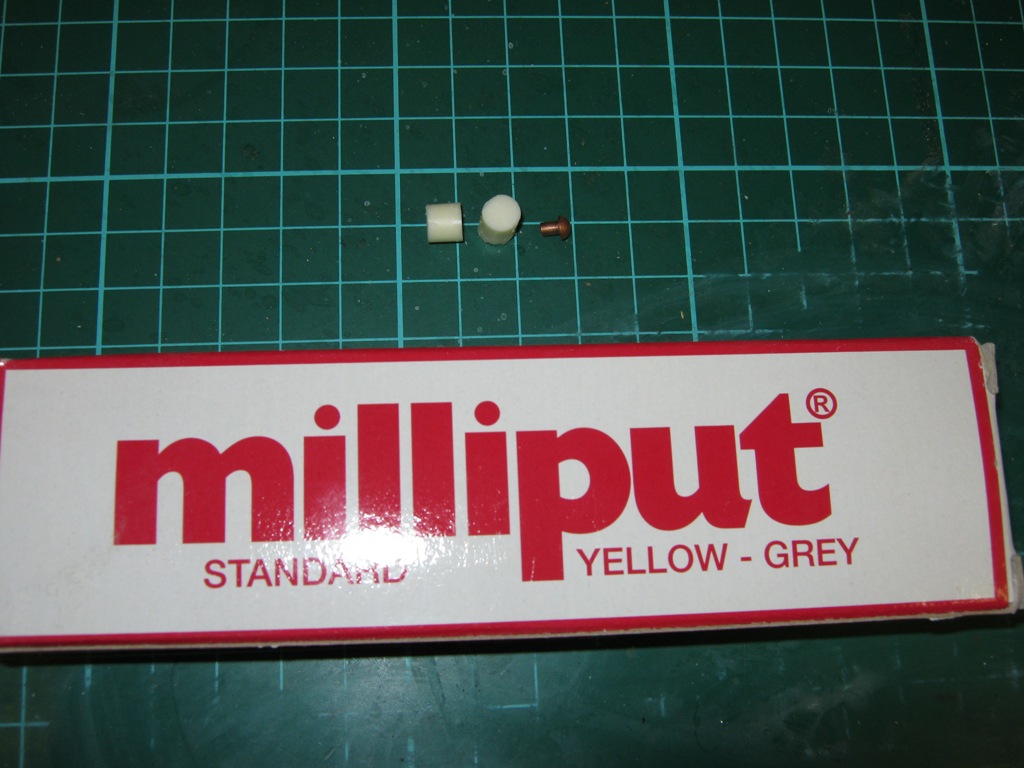

Thanks for all your constructive comments and not sure why the hammer has attracted attention, but I have had a couple of emails asking how I made it. well hear goes, I cut two pieces of 6mm diameter plastic rod, one 5mm long and 7mm long. drilled a 3mm hole in the 7mm long piece, then some milliput and a rivet. the handle is made out of 6mm dowel filed into the shape I wanted. just follow the pictures and it will make sense :)
Hope that's of some use!
