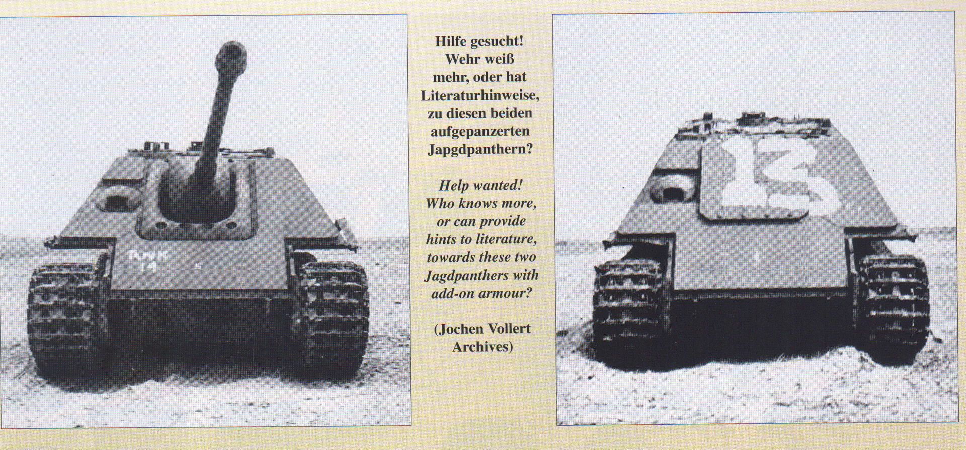

PS This photo shows that we were experimenting with welded angled applique plates on captured JagdPanthers as early as 1946. It would be interesting to find a link to the 1956 Cent upgrade requirement.
uparmoured JagdPanthers 1946
