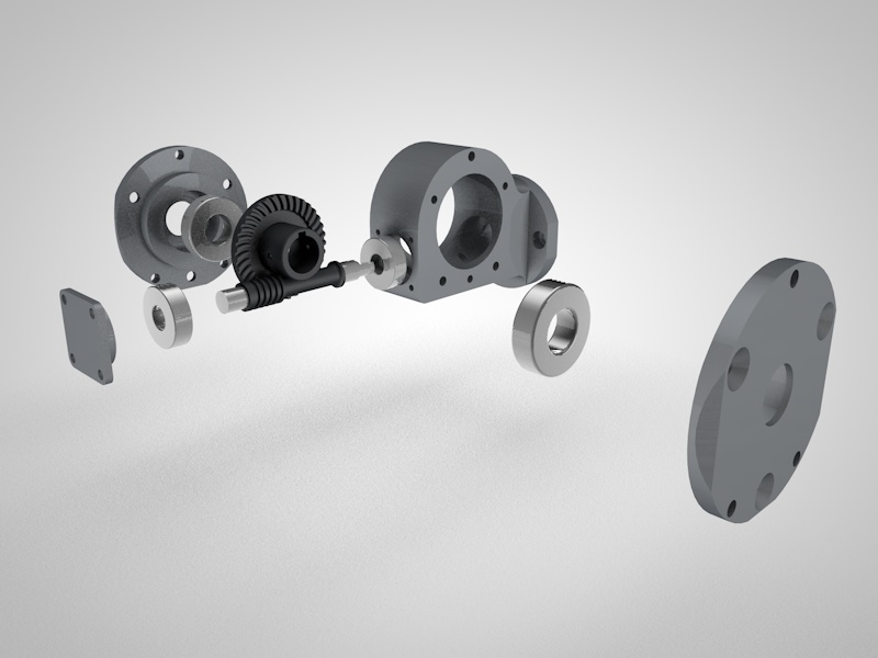

Here is an exploded view illustrating the construction of the new high efficiency gear box.

A great upgrade and wonderfully clear exploded view.
I have explored the Davall website which shows the enormous range of their products - I'm sure there must be scope here to develop and build a single input/dual output tank gearbox with steering brakes.

Wow that new gear box is amazing! Hopefully the cost of the motion packs will not increase too much! Regenrative braking - sounds like a Toyota Prius! 60 miles per gallon, or in this case more hours of run time per charge?

Looks like the sort of continuous development we've come to expect :D :D
This may be too late for this particular increment but does this gearbox have the ability to disengage the motor :?: That's always been one of the tricky things with tanks this heavy, moving them around when the drive system is discharged :oops:

Hi Adrian
I did try to include this feature when designing the new gearbox. Unfortunately it was not possible to do, without incurring a substantial cost increase, and making something very complicated. The T34, which now has these gearboxes fitted, does seem to be much easier to push along, when dead, than it was before. I can only assume that this has to do with the increase in efficiency of the gearbox design.
