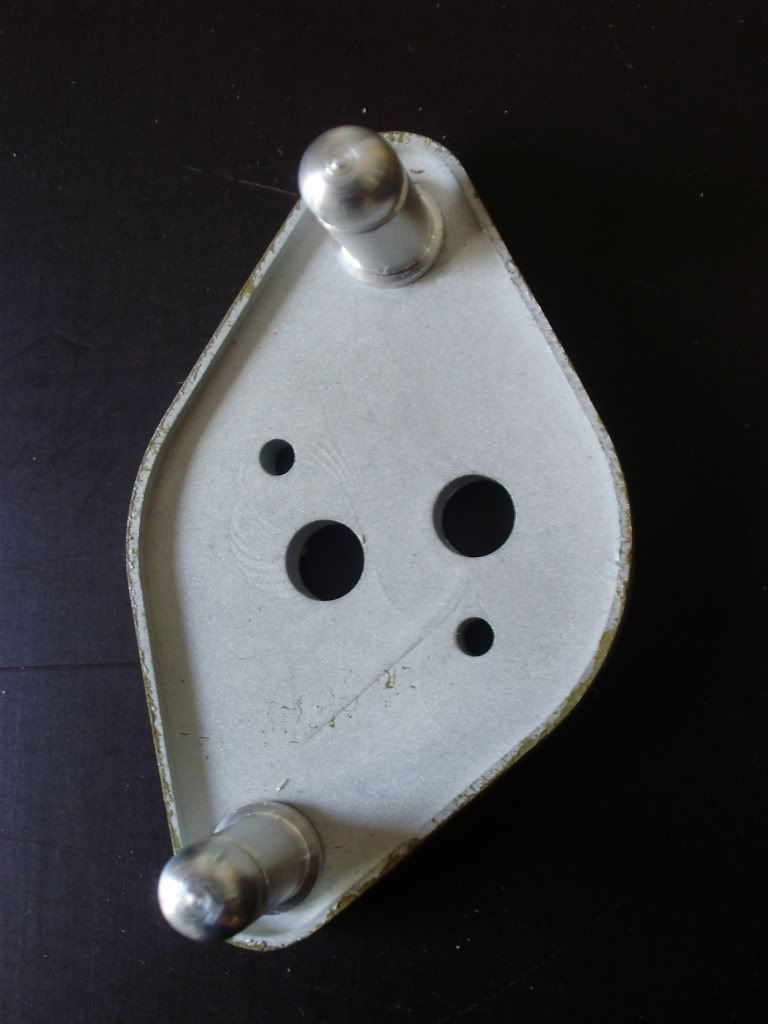

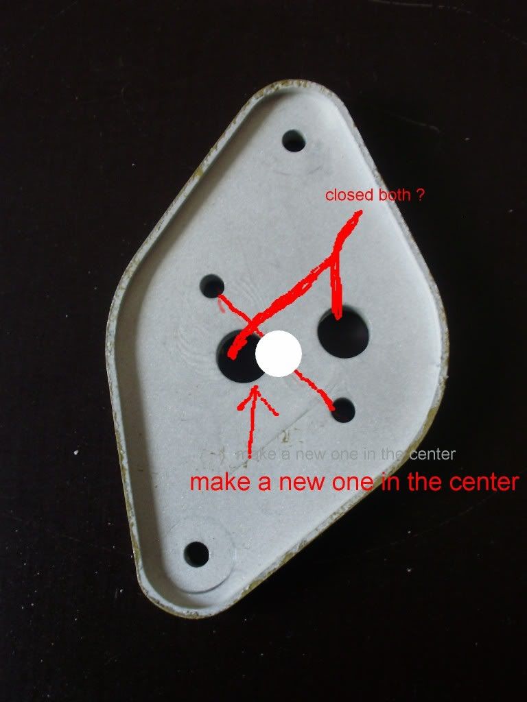

Hello builders :D
the starter plate of a mid Tiger has only one big hole in the center?
Otherwise i can use the late one as show.
I try out what dimension both pin have
Georg

The starter plate is a very non-intuitive part that partly compensates for the sloping rear armor. The two prongs (very nice!) are supposed to be perfectly horizontal when the plate is mounted on the sloping armor. The same goes for the holes.
Check this out:
http://tiger1.info/EN/StarterAdapter.html
The second, offset hole came with the introduction of the HL230 engine in May '43. The first hole was left for backward compatiblity.
It is generally considered that the introduction of the new turret in July '43 denotes the beginning of the mid era.
/Chris

Thank´s Chris,
i know this link but i did not spend an eye on this detail that the prongs must be perfectly horizontal. So it is a challenge for me to make it.
Georg

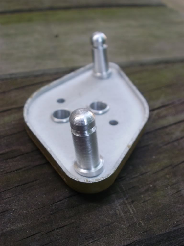

here is the "new" plate.
prongs are in 9 degrees :shock:
some weldings, sandblast and paint ...
looks good to me.

Christoffer Ahlfors
Posts: 702
Location: Stockholm, Sweden
Has liked: 746 times
Been liked: 359 times
Post by Christoffer Ahlfors »
Beautiful Georg!
I will try to copy that... :D
/Chris
