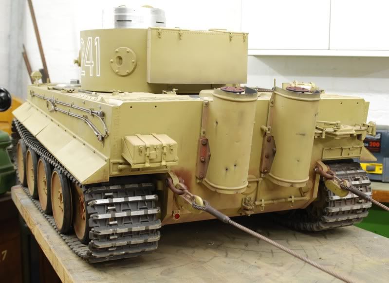

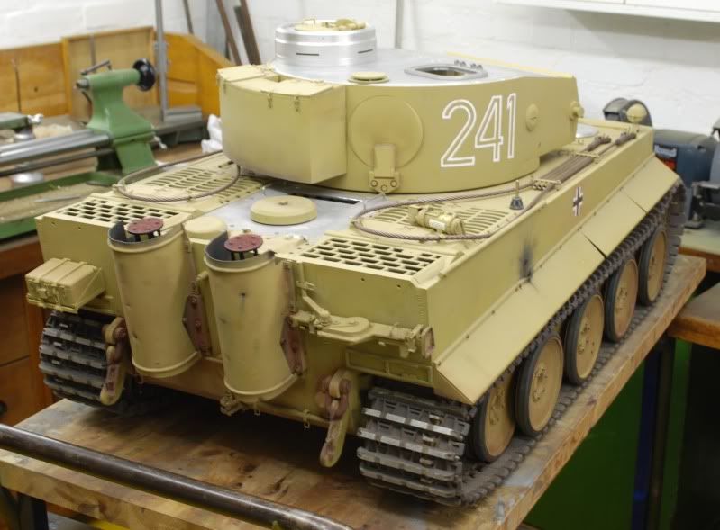

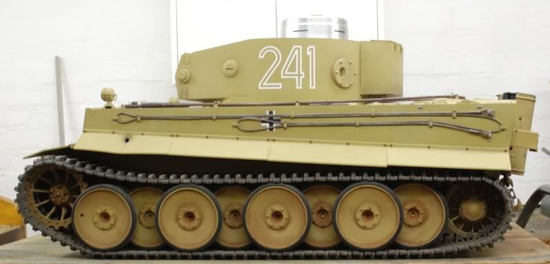

you are pulling my leg. OK its a shame with my build. When my kit was supplied on 06.11.2004 I had the intention to finish it in 2 or 3 years. Now after all I'm over the top but still a way to go. Some pictures to please you and Dale.
And last not least when I pulled Brian out of the problem zone.
The gun was in the overholing shop for a better ( lighter ) recoil. The hatches are not ready, the Feifels are missing, the hooks on the rear grills are missing and and and.
Hope you enjoy the photos - Roland

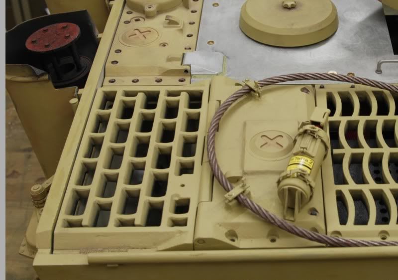

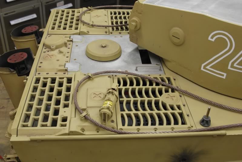

Thank's for the comments Rocky and Brian. I will let you know when the package arrives. For the builders asked questions on the rear deck here some shots on more detailing items.
Those grills however came in white metal and are different to the new alu design. Very havy but after all they look satisfying. The shape of the very rear ones with the curved blades have been a night mare to modify. Don't forget the casing numbers ! :roll:

Great looking modifications Roland :D
Is there any technical or manufacturing reason for the fact the the cross beams on the grills don't go all the way across on alternating beams :?:

Hi Adrian,
those grills are mainly designed for protection against smaller granades from top. Therefore they must be somehow flexible for vibrations created by a granade. If the structure would be completely solid fixed in its frame, it may fall out its framework when stress aplied. On top there are enormes temperature differences between winter and full speed in Africa. Again stress by lenght differential coefficience.
To keep all strenghs for the main task, the design takes care not to build up to many other forces during normal operation.

Adrian: Great question, I had wondered myself why the grates were like that
Roland: Thanks for the class, again!

Thanks for the explanations Roland, I think the changes in size due to temperature would be a problem with such a thick casting.
It's good that the 2010 Tiger grills have such thick bars, but there is a lot of material to come off before they have the correct profile, as yours have.
Maybe now is a good time to buy shares in Dremel :lol: :lol: :lol:
