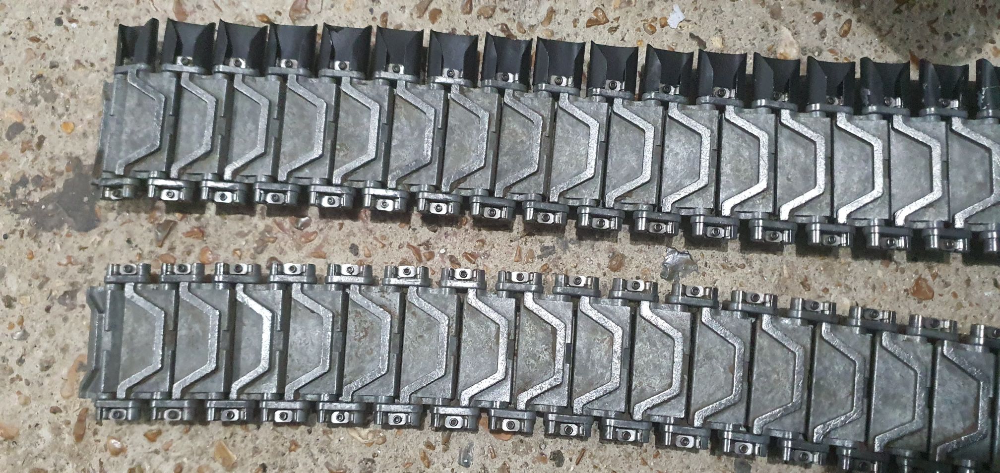

And the build continues after a 15 year gap! I managed to buy my Sherman back 4 years ago now. Roy did a superb job finishing the model to a good standard.
I have since fitted sound and a BEC as charging the small batteries to power the RC is a pain, also fixed a few things, and a recent upgrade was a Bob Morey tow hitch(very nice) but now I'm fitting a set of duck bills, opening up the sprocket to receive will be required. This model has been a favorite of mine as it was the first model that I modified/copied the other builders (Dale and Bob)
A new paint job to make it like the the real tank pictured,and some modifications to the cupola are on my schedule

Re: DB sherman build
Hi Simon,
Yes they add something extra - these were made by Chris Fry, probably 10 years back! he had intentions to use them, but in the end was surplus to requirements due to selling the model.
