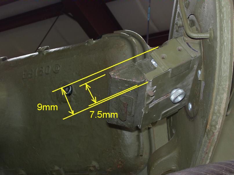

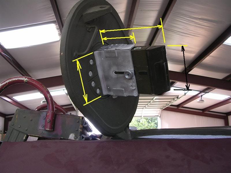

Hi Bob,
Hope the pics below help. I do make an open top section with the top half of the scope but its in the Stuart Hatch set, maybe I should do them on their own :oops:

Hi Dave, thanks for the great info. Are your dims off by a factor of 10? Should be 400mm instead of 40mm? No worries I can decipher it! I have Adrians dims for comparison. Thank you to all who provided info!

Bob - I think Dave has given the figures in 1/6th ...

Hi Bob,
They should be the actual size at 1/6th taken straight off mine, if I got them right :oops: .

Doop of course, I didn't think of that (dims in 1/6). I'm such a Homer sometimes. Thank you guys.
