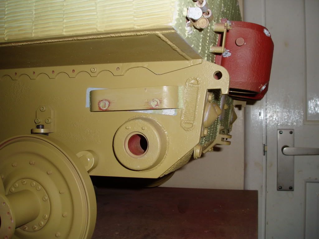

I have put the track pin deflectors back to the original possition as i have decided to build my Tiger as 222 of SS-Pz-Abt 101 (The Tiger Wittmann used at Villers Bocage) This tank would appear to be a April production Tiger with 40mm single piece roof, monocular gunners sight, small muzzel brake, 15mm thick Tiger2 loaders hatch and no drain slits in the comanders coupola. As Kent said in a previous post the track pin deflectors were changed in May 44.

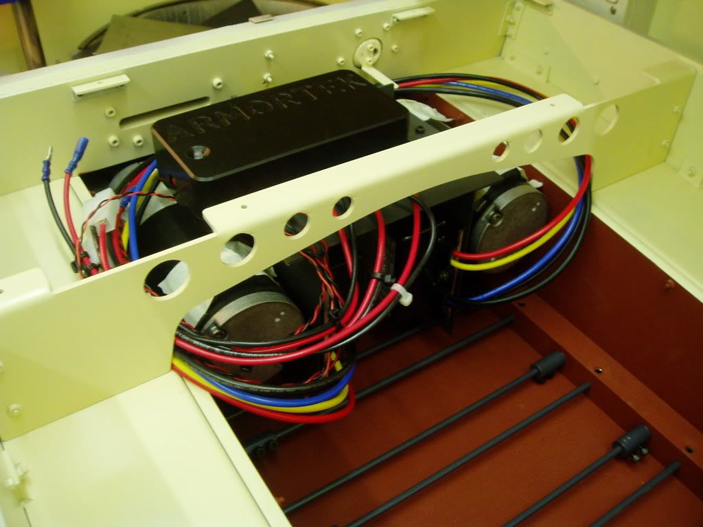

Motors fitted and speed controlers + fuse box fitted to my own mount plate between the motors (Richie Wignals idea).

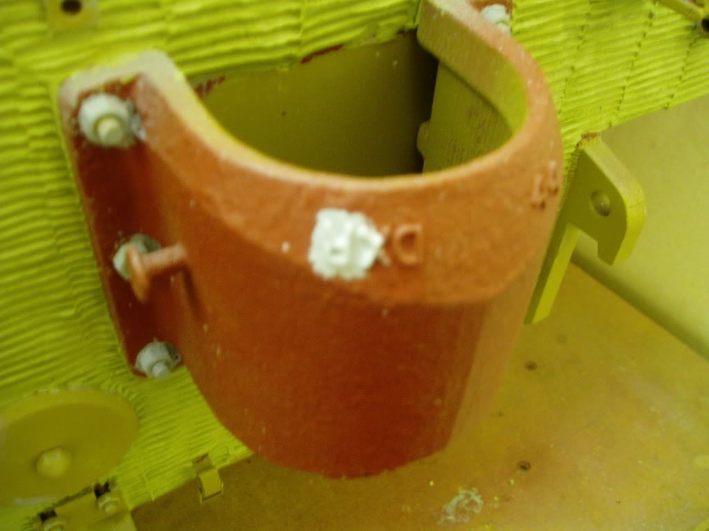

Casting letters changed to DXR from DXP, Thanks to Per Sonnervik for the information.

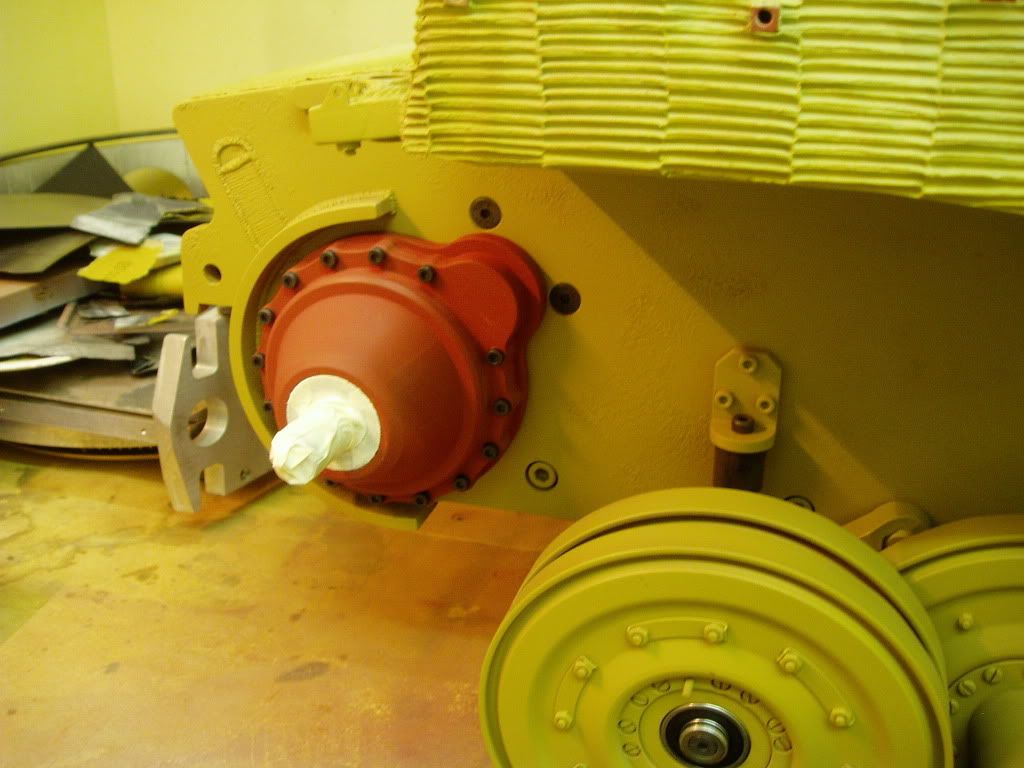

Gear cases fitted, ready for the drive sprockets.
