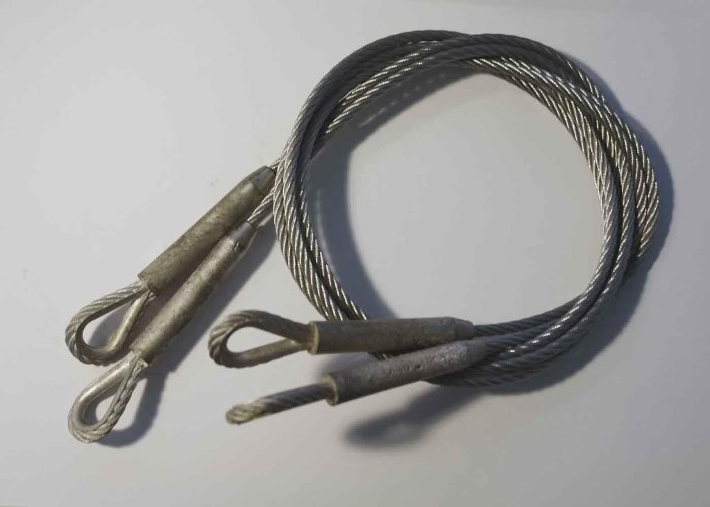

Hi everyone,
I was planning on replacing the tow cables on my late Tiger eventually with ones that are more in scale.The Armortek ones have a metal collar holding the ends together.When I saw the Tiger at Bovington, it's cables had what looked like material or rubber on these said collars.Is this an outer coating to protect an inner metal core? Does anyone know how or what the real collars are made from.Maybe the Bovington ones are not authentic?
Also,I know this has been writen about before,but can anyone tell me the correct size for the cable and where I might purchase it.

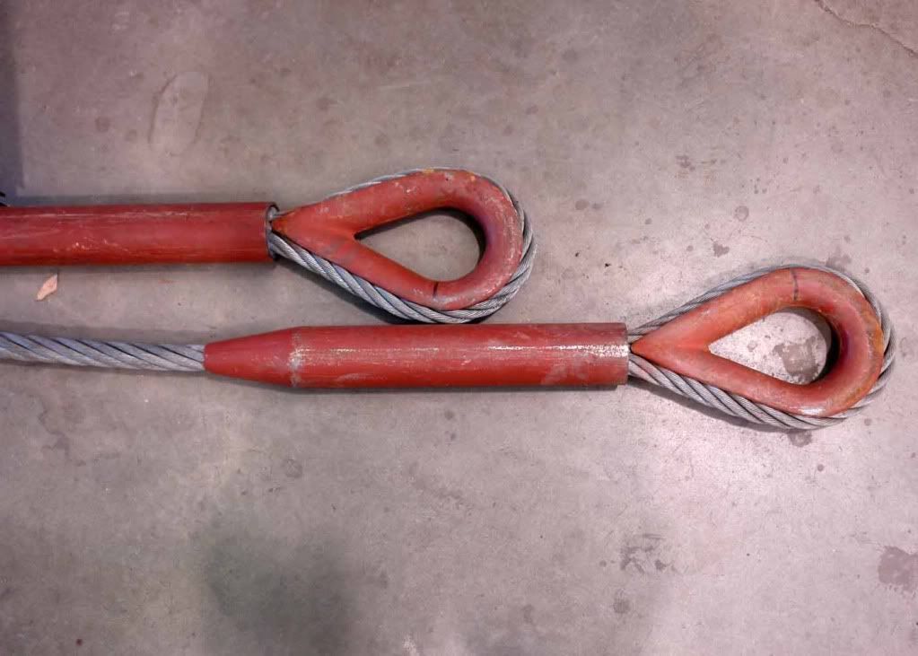

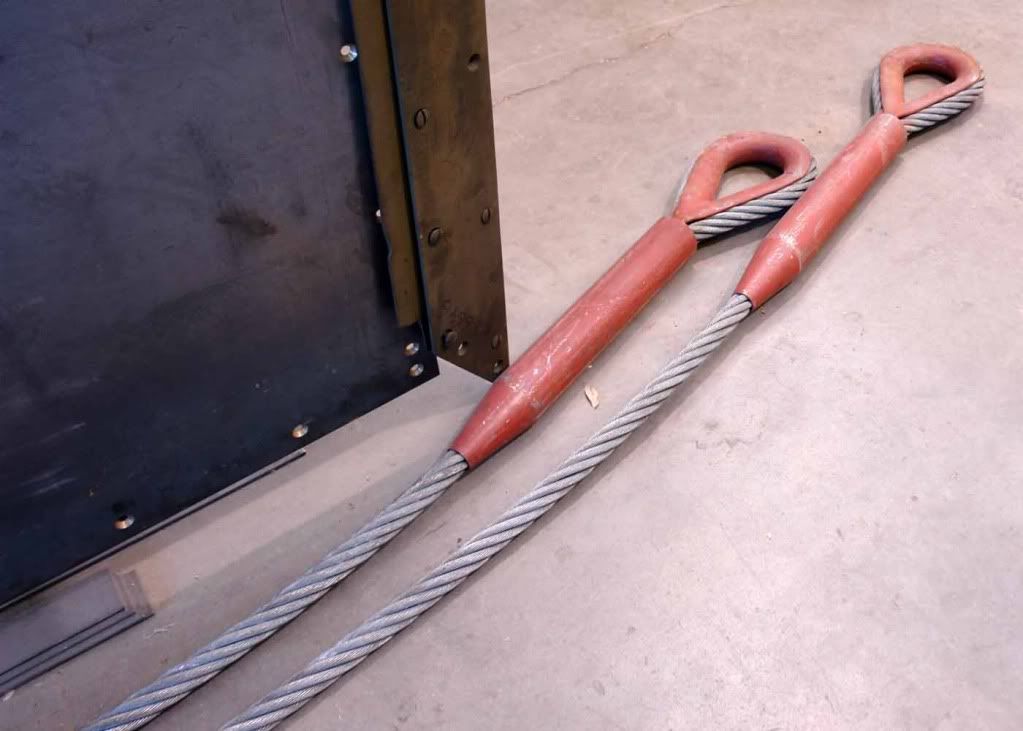

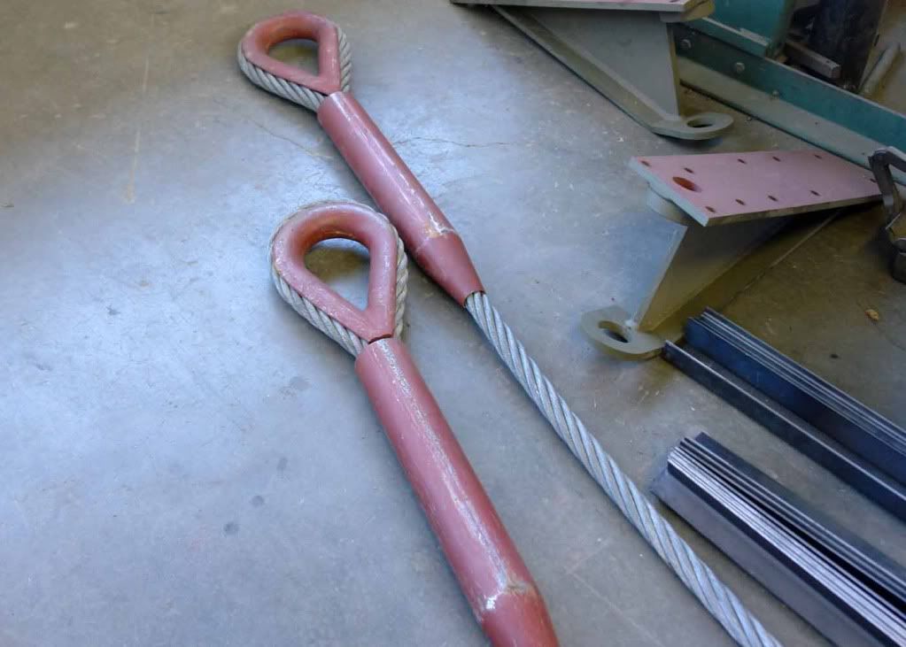

Hi Lionel
Here are the one's Jacques had made for his Ausf A Panther. I assume they are 100% accurate to the original and Tiger 1s had the same detail at the loop-ends. I'm not sure but maybe the ones you describe are post war? Not meant to discourage you from making your own but, just another option, Mike Stannard makes very nice cables for the Tiger 1.

Hi Lionel yes they are metal.
Here is Mikes catalog link;
http://www.afceremonials.com/catalog-pages/
Third item down 02a Tiger A
Regards Stewart

I can remember reading a previous post on cables saying that the supplied ones are not to scale and are slightly to large ( I can't find the said post as I read it a while back). Does anyone know the correct diameter of cable and where it may be brought? Local D.I.Y stores only have a limited choice.
Mike's cables are great, but It is always nice if you know you've made something yourself.
Hi Lionel
Real tank tow cable 32 mm (5.333 mm in 6scale) x 8.2 m (1.3666 m in 6scale) long and track cable is 14 mm (2.333 mm in 6 scale) x 15 m (2.5 m in 6 scale) long. Lengths include towing eyes. I use 3/16" cable for tank cables and 3/32" for the track cable which is the closests I could find.
