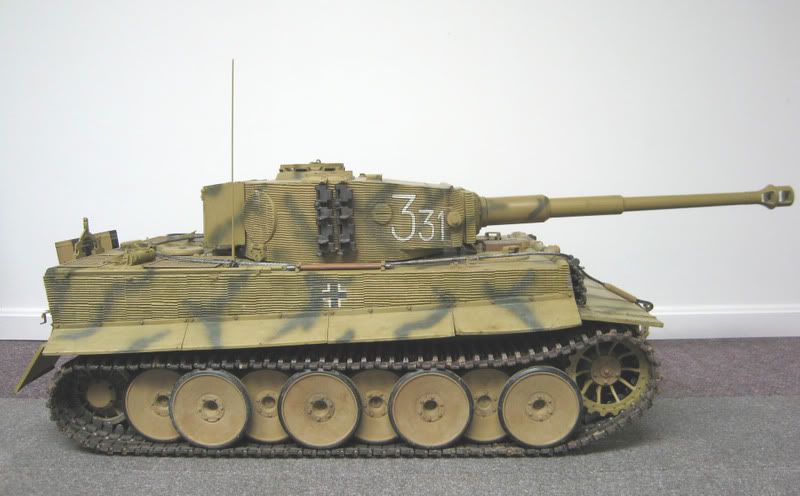

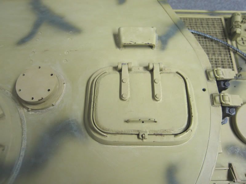

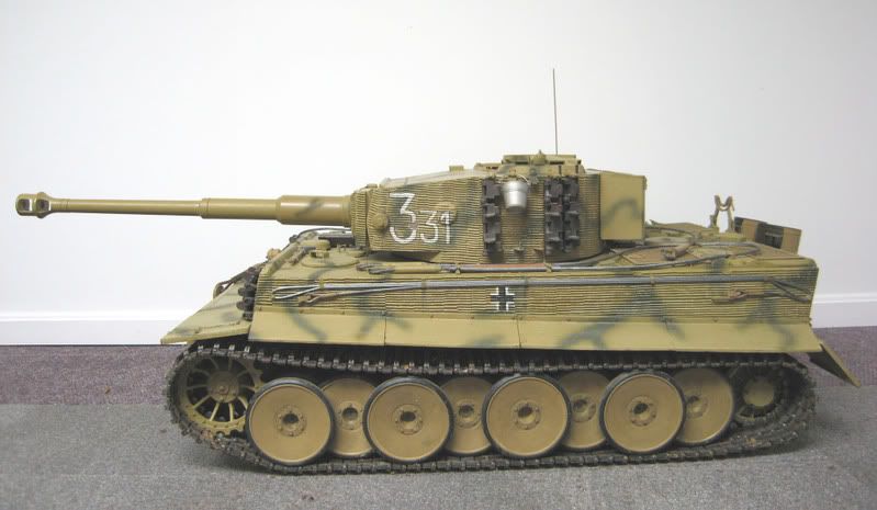

Well I think that it is finished, except for the periscopes, jack and a few other bits.
Anyway here are some pictures of my mid production Tiger that I entered in the SAG contest, did not win :oops: but Tim and his EXCELLENT Panther did :D
I made it as a Tiger that was built in January 1944 and belonging to the schwere Panzer-Abteilung 507.

Hi Mike
Your Tiger looks amazing! Great detail, zimmerit is perfect, paint is perfect. An excellent mid production Tiger. 8) I've always liked the two-color camo schemes.
Thanks for posting the pictures. It makes excellent reference for my current project. :D
Keep up the great work. Are you building something else now?

very nice Mike zimmerit looks supper

A superb model Mike, you mush be very proud of it.

Stunning Tiger Mike well done hope to see it up close one day

Great job ,good to see another Tiger finished and you have put right the error of the drivers visor .

Awesome job on the Tiger. Fantastic detailing. Very cool! Thanks for posting your pictures.

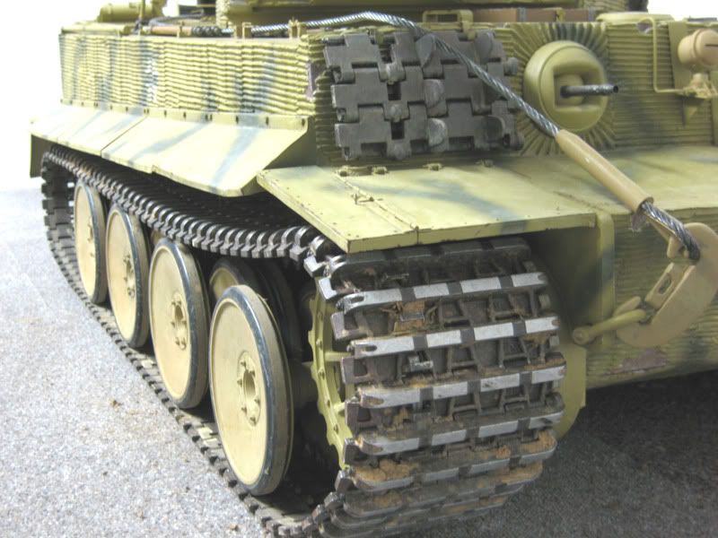

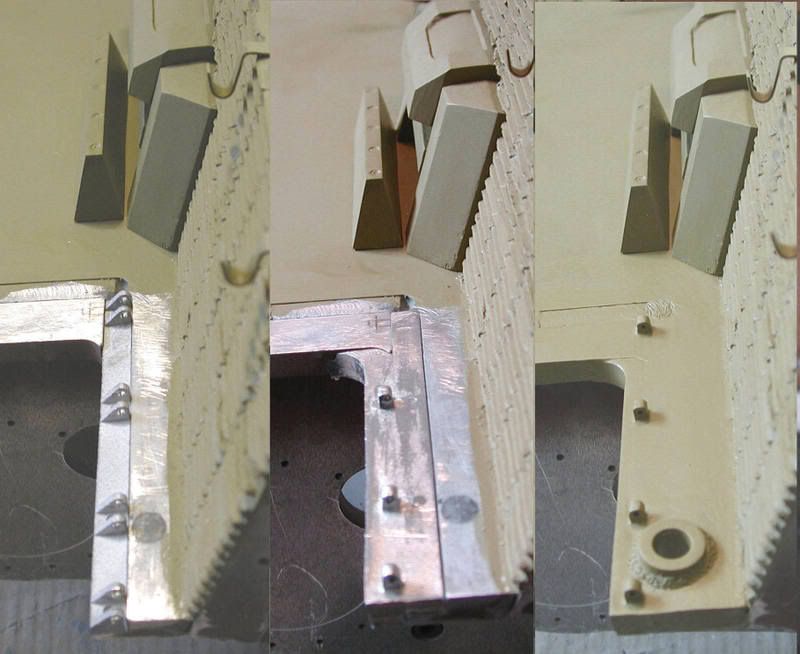

I also modified the front fender and made them the way they are supposed to be. I only know of two others who have done this.
In the picture below you can see the original on the left and my modification in the middle and right.
[/img]
Here it is finished. I made the fenders out of brass.

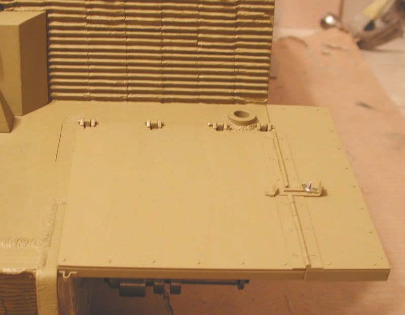

Here is another fix that I did to the engine hatch.
The air inlet is too far back so I moved it to the correct location. In the picture below you can see were it was originally (red outlined yellow rectangle). I also added the tarp tie downs, four recessed bolts and made new grab handles.

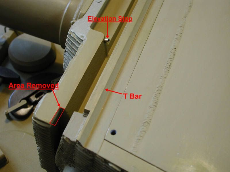

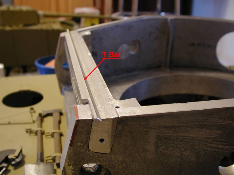

Here is one more mod.
This part does not come with the kit and needs to be added - T bar.
I had this machined, (don't know the dimensions anymore).
Here is a side view, almost finished.
[/img]Image
You can see a front view (picture 9) in the pictures at the start of this thread. I added the recessed bolts and cut in the rectangles, this is part of the seal for gun.

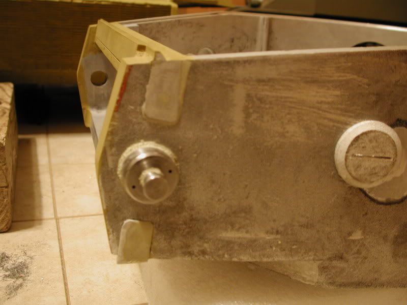

Here it is finished with a modification made to the mantlet also and an elevation stop added.
