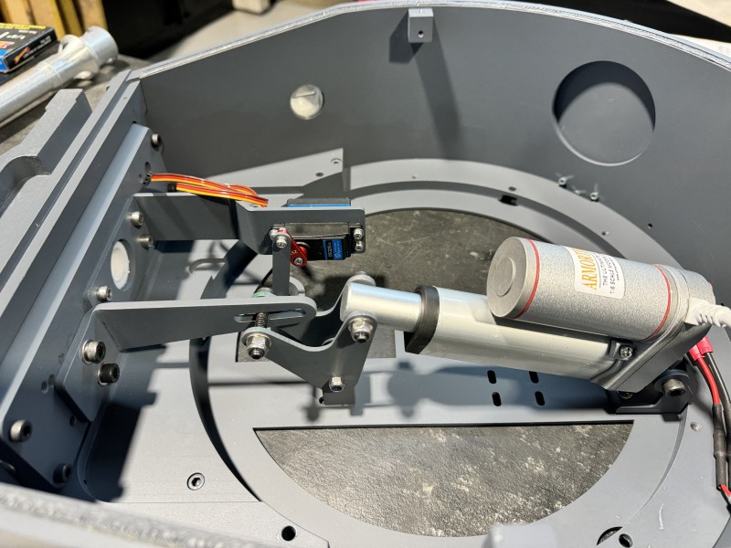

I wasn’t real happy with the amount of flex in the main gun on my Tiger so I had a bit of a light bulb moment and came up with a different design.
Easy to do and there is way less barrel bounce and it uses the full travel of the actuator.
Main gun elevation mod

Re: Main gun elevation mod
Hi Andrew...
Really nice looking mod ! - Minor thought. Possibly worth having a smooth bolt or bush running in the slot, the threads might rip the slot a bit with use.... Just my 2p. But, definitely GOOD MOD...... I'm contemplating similar when I get to the T1.....
All the best,
All the best,
