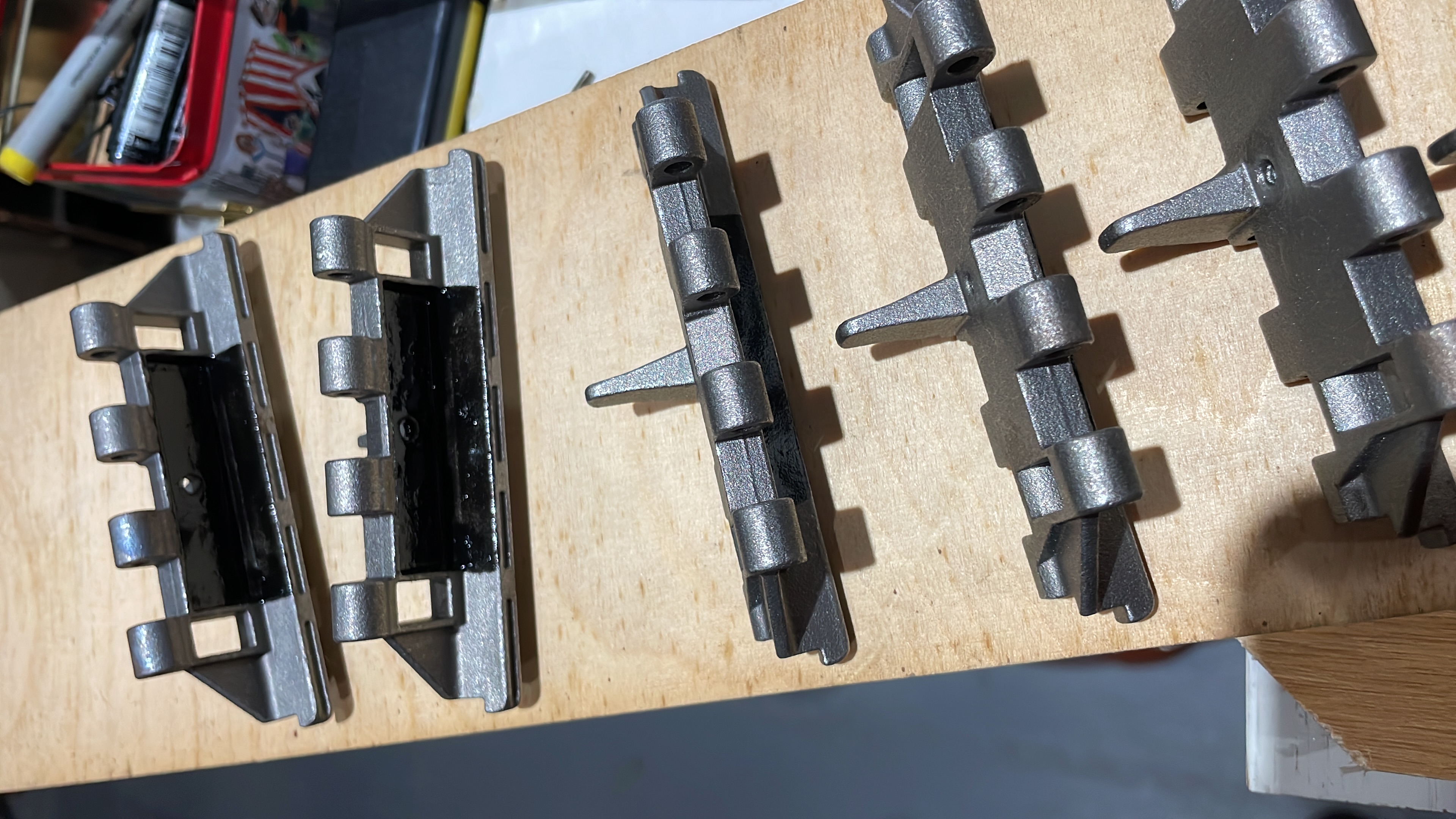

The advise shared with the tracks has been taken onboard and I have painted the tracks under where the pads go with black Finegans, purchased stainless M3 nuts and then applied a little copper slip in the fixing hole to assist with assembly etc. pics attached

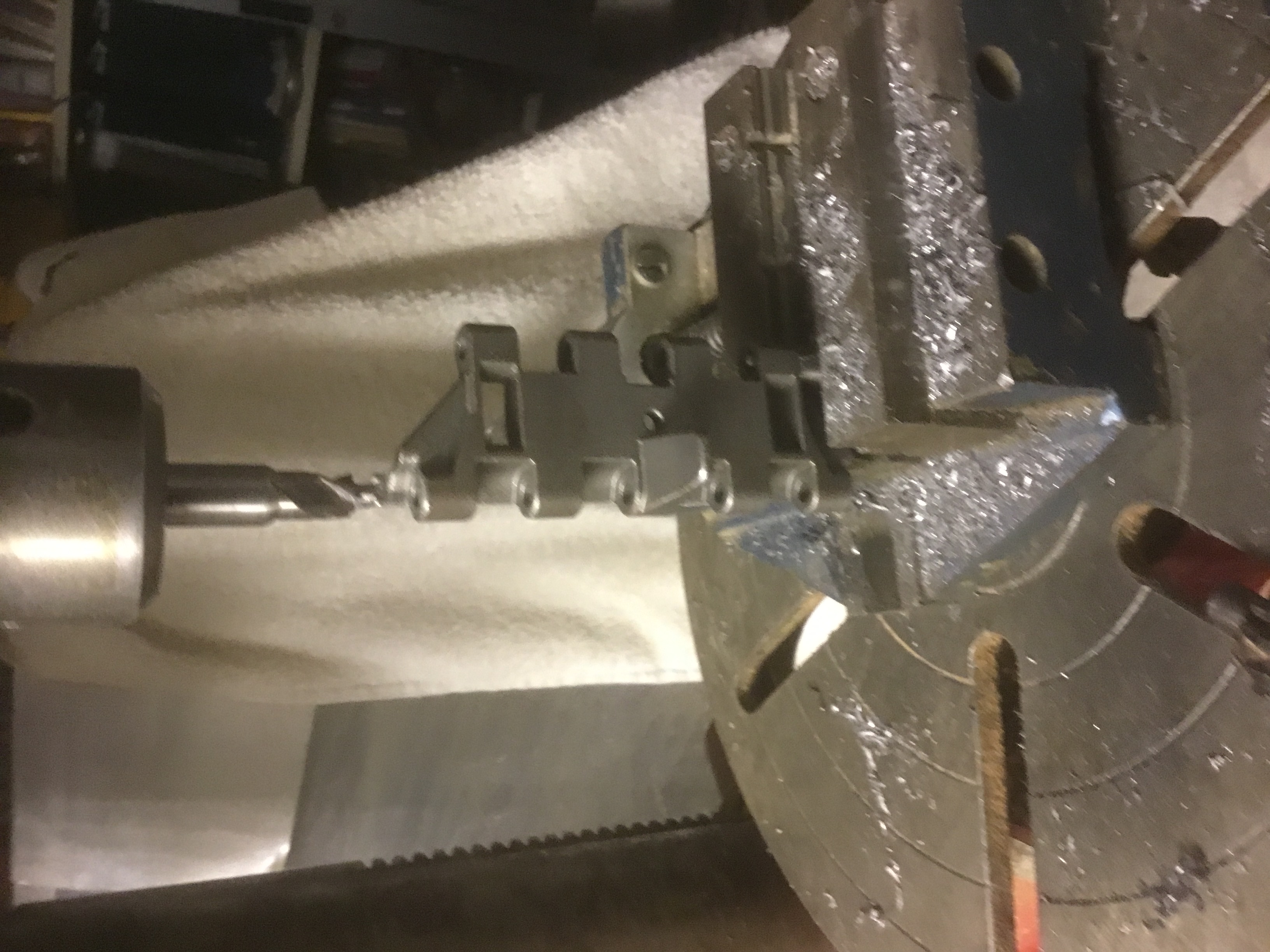

Prior to that I set up a turned up pin to allow the tracks to be machined to 70.4 +0 -.2 to remove any excess from the casting and allow free movement of the pin and split pin movement. Currently considering replacing the split pins with Starlock Washers which I can only find with 9mm o/d and my spotface cutter was 8.2mm. I am interested if anyone has adopted the Starlock modification?
