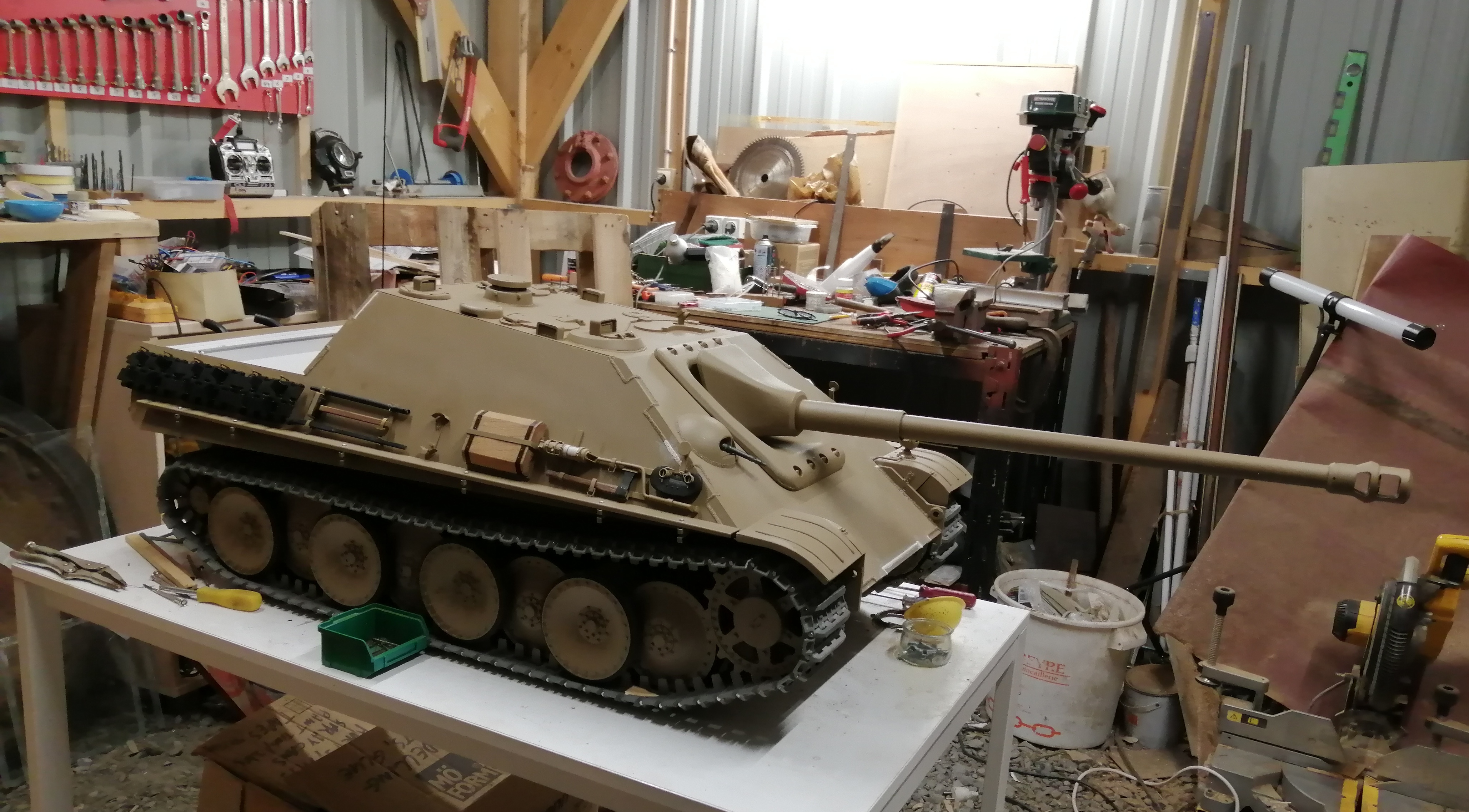

So, a lot has happened since my last posting - namely moving house and taking up new employment. The JP travelled well in the back of my car having been driven in using motorcycle/garden machinery loading ramps. She spent the winter indoors whilst I fitted out my new workshop then in the Spring was moved by trolley into its new home. Problem - how to lift it onto the workbench.
The plan had been to acquire an elevating platform but like most things here in France, these are prohibitively expensive. So I was about to order one from Germany when it occurred that I only needed to raise/lower it on an occasional basis. Having previously lifted it manually, I didn't fancy doing so again and then that's when the idea of an electric hoist occurred. One was found on a large French tool site and duly acquired for the princely sum of 51 Euros with free shipping!
It duly arrived 4 days later and is a real little corker! 230 volt operation, 250 kilo capacity, 3 metre lift and with a long remote cable, it was just the job. I reinforced the workshop's roof truss with an extra crossbeam and triangulating bracing, bolted the winch to same, ran in power conduits and she was ready to go.
As mentioned in an earlier build log, the JP was fitted with nice, scale white-metal towing/lifting shackles but these were only good for decoration so were replaced with temporary steel ones from my local hardware store. Chain, steel cable and larger shackles connected the tank to the winch hook with the rear chains connected to the hull's rear lifting lugs. With balance determined, the winch joyfully hoiked the JP 1.5 metres into the air, the bench was slid underneath, then she was lowered onto oak blocks to take the load off the suspension. So, job done with a minimum of fuss.

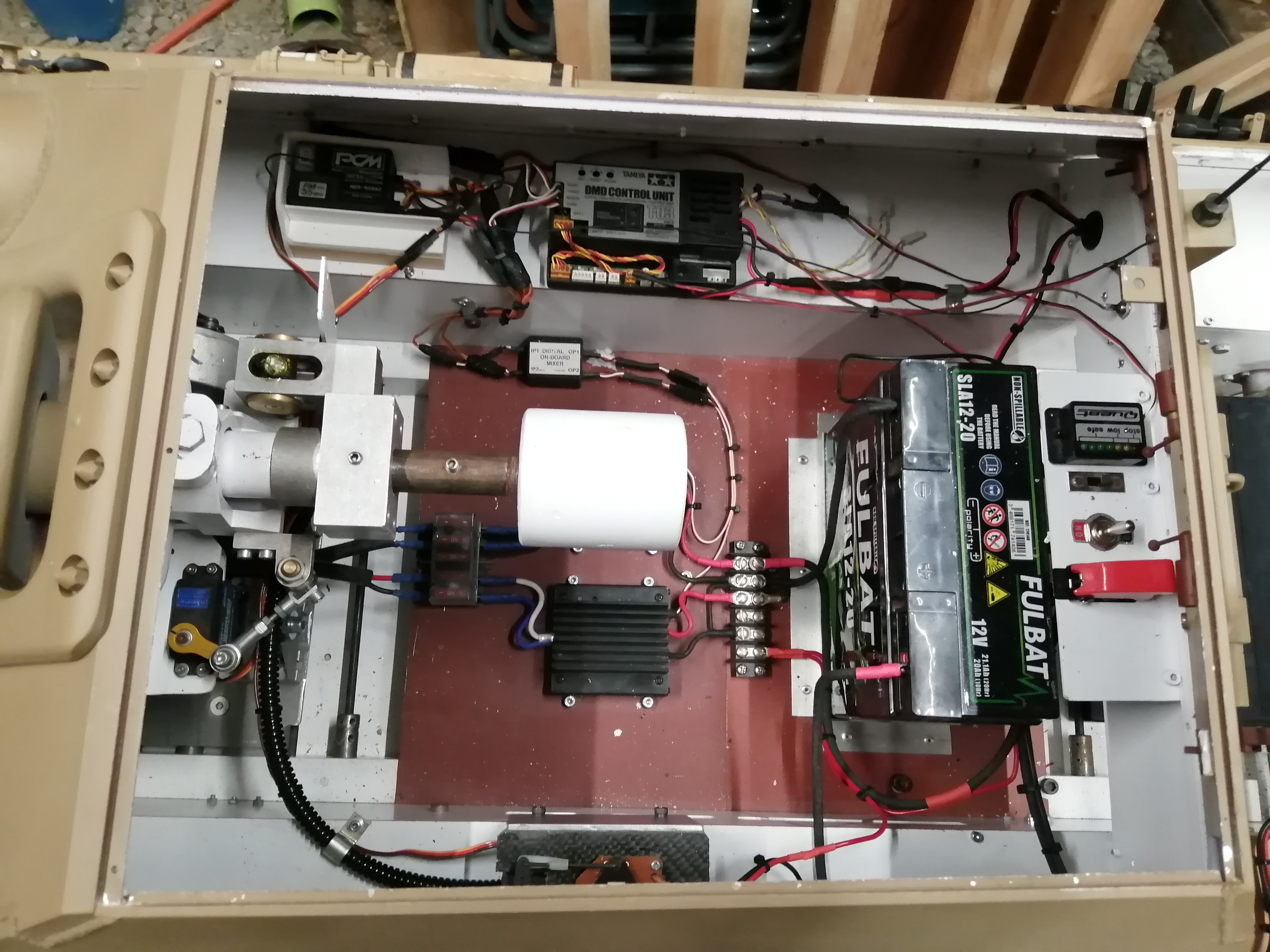

Remaining tasks for completion were to completely revise and rewire the internal space, effect some repairs to minor damage incurred during transit and the unfortunate "crash" described in the previous episode, and to finally fit the gun unit.

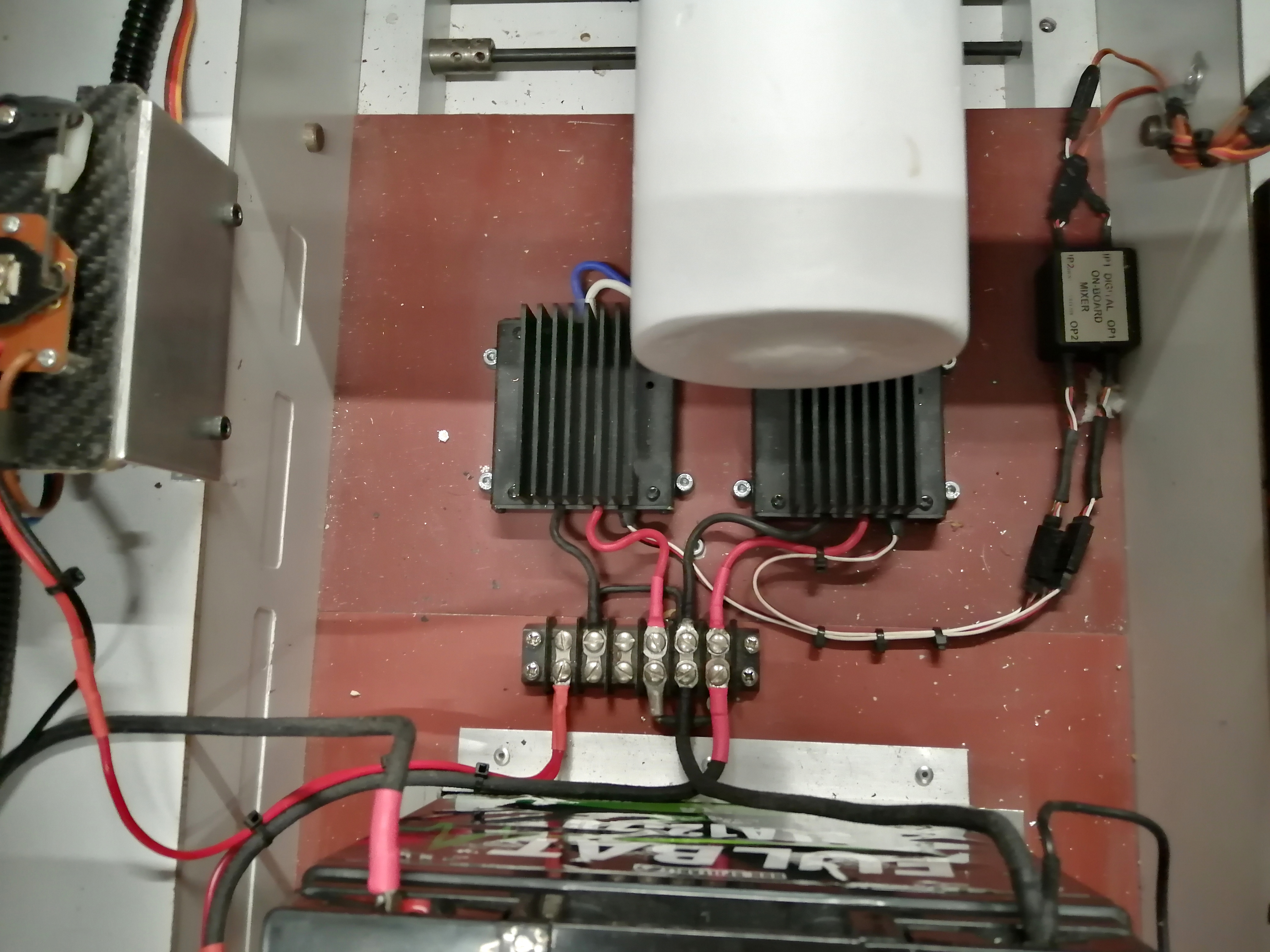

The RC system and Tamiya DMD run on 7.2 volts but I had a 6 volt converter installed to drop the voltage from 24. Figuring that maybe 6 volts was too low and maybe this had contributed to the "crash" through the receiver shutting down into low battery failsafe mode, a 7.2 volt converter from Amazon was substituted to improve the situation. An additional mod. was the fitting of a 30 Amp breaker unit to reinforce the 40 Amp motor fuse protection.
The gun unit was removed from its wooden assembly/test jig and duly fitted to the glacis. Slewing with the 35 kilo servo was fine so all I needed was a digital forward/reverse switch to control elevation. I couldn't find a suitable 24 volt capacity unit so, for the time being, went "old skool" and used a small servo and brass contact wiper board removed from some redundant model years ago. Somewhat basic and a bit agricultural, this works fine and will suffice until I find a suitable digital option. It's mounted on a carbon fibre box mount on the left hand sponson top with just a short wire run to the elevation motor and leadscrew. Will probably switch to one of Armortek's new linear actuators at a later date.

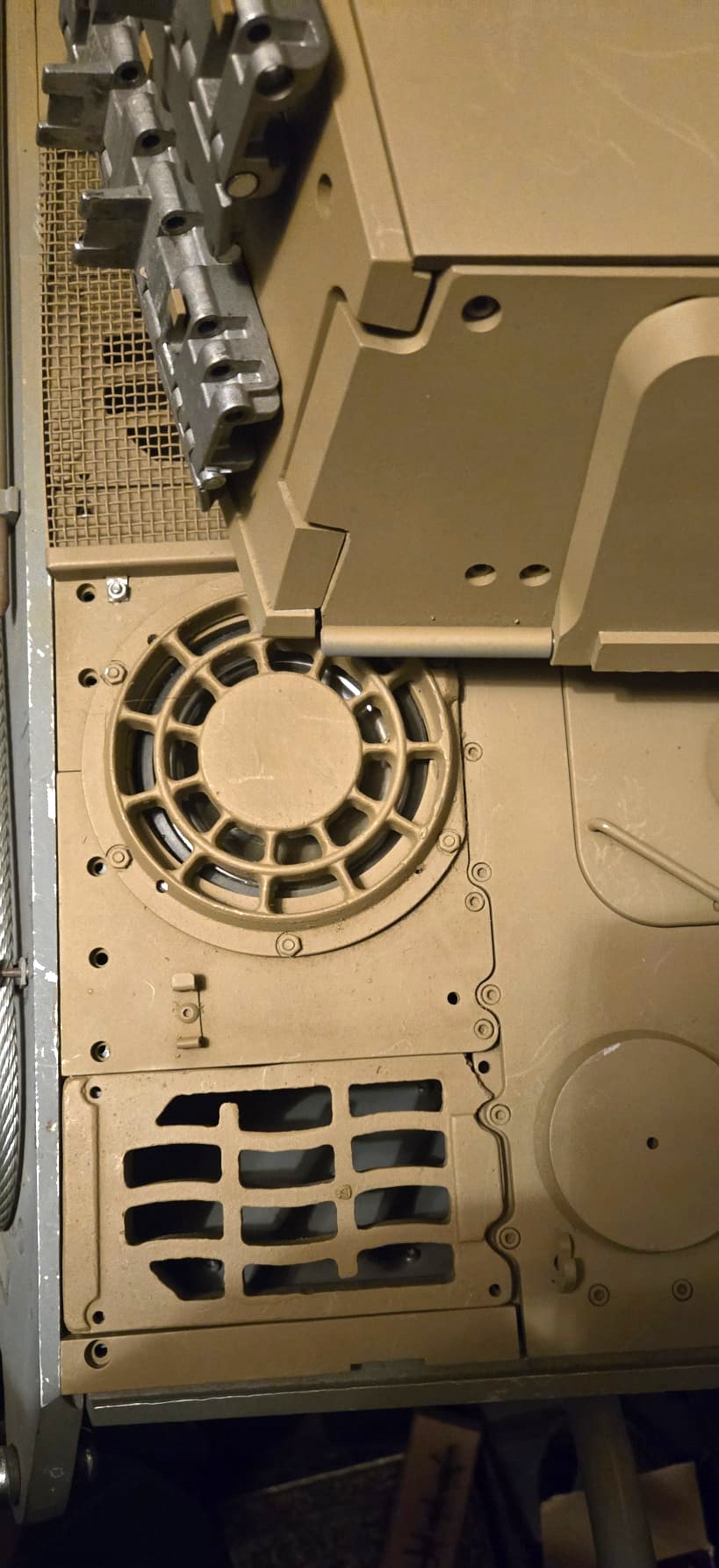

Paintwork was touched in here and there and the roof and engine deck re-sprayed following final fitting of components previously temporarily installed. But I was lacking the mesh grille covers for the radiator cooling fans.
I did have a set of Armortek photoetch brass items acquired at the start of the project from a parts bundle from a UK seller. These didn't look "right" so, following research and my archive photos of The Weald Foundation's JP upon which I worked some years ago, I made a pair from rolled annealed brass tubing and stainless steel mesh of the correct scale weave, hole count and wire diameter. They were quite fiddly to make but once done, looked good. The aluminium fan covers were abraded, the grilles glued on with 5 minute epoxy then the excess glue carved back prior to full cure. Welds were simulated using Miliputt fine white putty in 6 places adjacent to the hold down nuts and bolts as per the real thing. The welds don't need to be that good because these grilles were normally welded on fairly roughly.
The M3 fixings used by the kit are, in scale, too big. The real thing uses M16 studs with nuts fitted on the outside which equates to an M2.5 bolt. The holes were already drilled 3 mm so not wanting to have to sleeve them, I used M3 hex head screws but with M2.5 nuts re-tapped to 3 mm. Just open up the thread with a 2.5 drill then re-tap - fiddly but it looks so much better and one can now get a hex socket onto them rather than faffing about with a small spanner.

Just need to add and connect the left hand cable and she's ready to lift
Using the rear lifting lugs as per the real thing
A pair of steel cables attach to the shackles unlike in  this shot. Hinged mudguard covers are essential...
View showing balance point for an even lift
The budget but well made 250 kilo winch. The hook pulley doubles the capacity like a snatch block
Overall view of engine bay with first of the 2 batteries
30 Amp emergency breaker and bakelite wiring connector block
Main switch panel accessible via the loading hatch.  Small unit on the right is a battery level meter
The replacement DC converter to step down 24 volts to 7 for receiver and DMD supply. The 2 silver sockets are phono connectors for the engine deck mounted speakers
Overall view of the internal layout. Just a pair of 40 Amp Robbe speed controllers, a digital mixer and several Y leads to power the DMD for sound
Tamiya DMD used solely for sound.  Motion functions are not connected as these are controlled by the mixer and transmitter programming menus
Basic rotary switch to temporarily control control gun elevation motor
Overall view of the gun unit.  The rather ugly white cylinder is the 2.8 kilo counterbalance necessary for equilibrium so as not to stress the motor and elevating gearing
Powerful 35 kilo force servo provides more than enough oomph to slew the gun through its 22 degree arc. the slew is asymmetric to save crushing the driver...
The new fan grilles now available in this Forum's Craftsman Market. Note the M2.5 nuts re-tapped to M3
