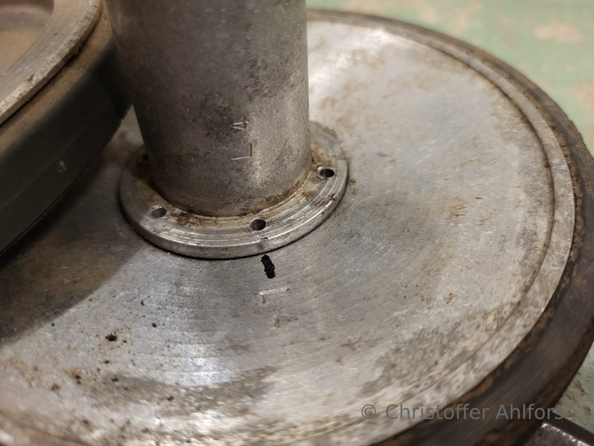

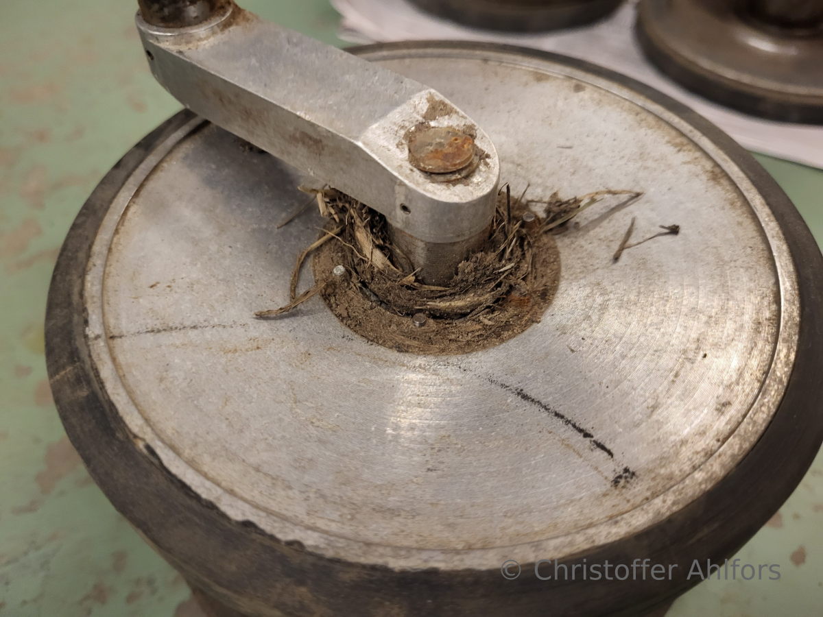

A few pictures to illustrate.
First, here you can see clearly why mud and tall grass is a bad combination. It gets the worst on the inside where there is an axle to wrap around:
Next, you can see how the holes in the wheels stack up. Looks like the bearing should come out of there, doesn't it? Sometimes yes, and sometimes no.
I stamped the parts for easy alignment when reassembling: //
