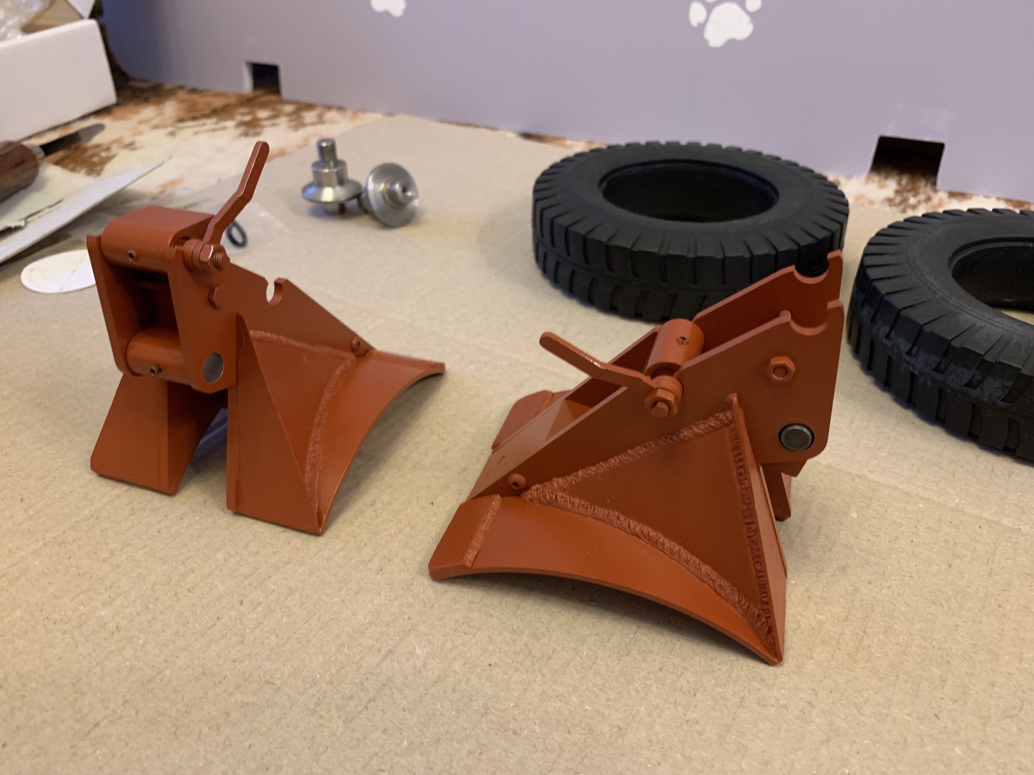

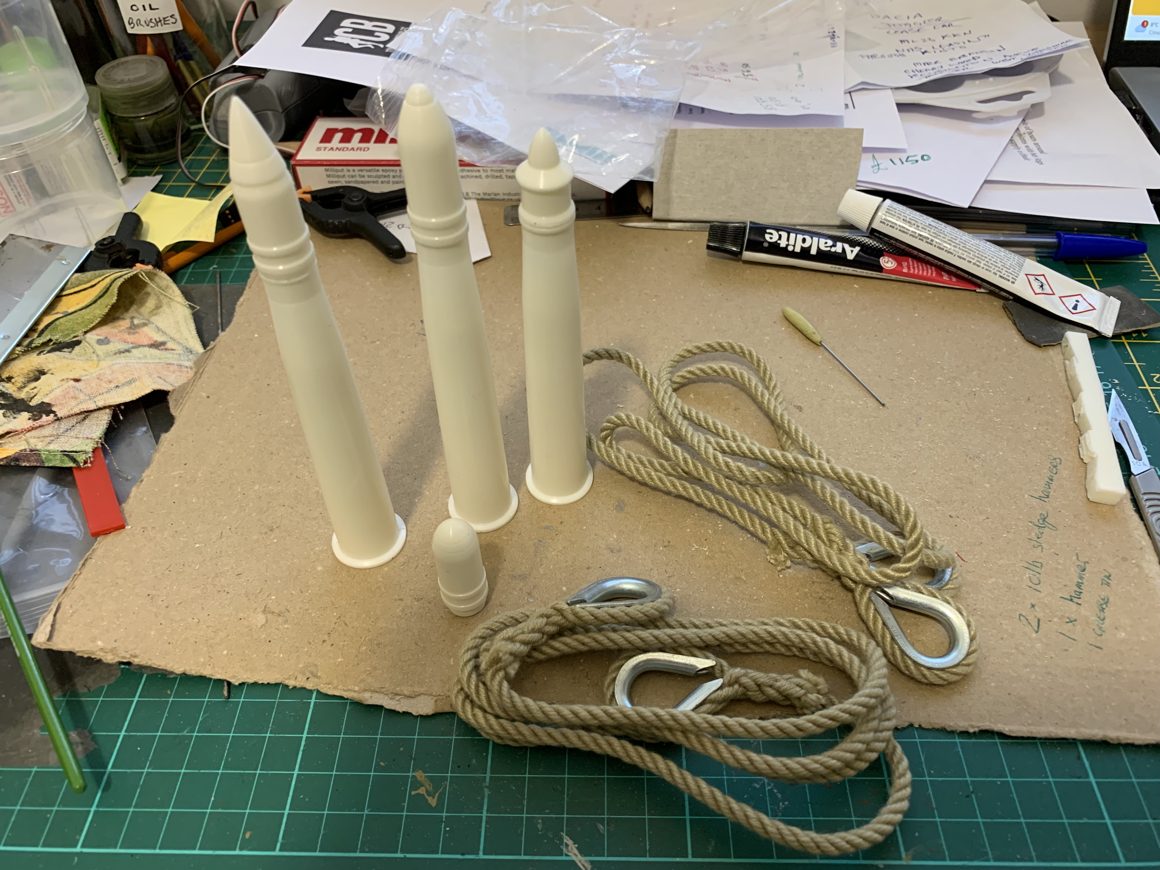

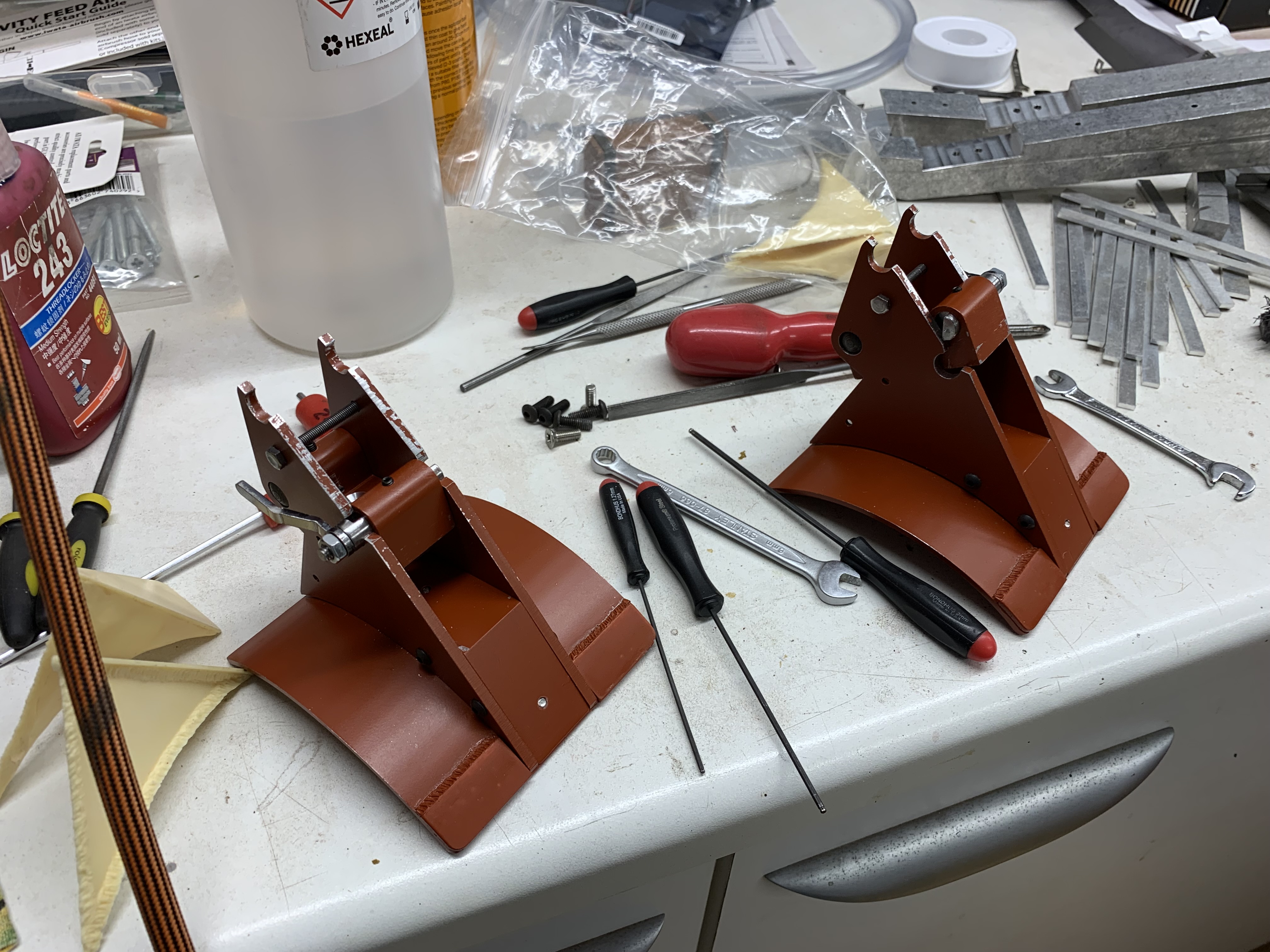

I have made a bit more progress on the 17 PDR. The spade assemblies are complete after a couple of modifications were made. I used countersunk screws instead of the button heads to attach the assembly to the trail arms as the 30mm bolt near the top of the spade was hitting the button head so they wouldn't latch. I also enlarged the middle groove on the latching pin to realign the latches for improved operation.
I have added the Armorpax parts which replace the stock kit parts and am impressed with how well Dave moulded the parts. Very little fettling was required. The 17 PDR needed some of Dave's bling so I have now got some shells with various warheads and a couple of tow ropes, again very well made, Cheers Dave.
I am enjoying this build and finding it very satisfying to see it coming together, well done to Armortek on a great kit. I may have to source a limber as they were used for braking when the gun was being towed.
Next step is the trail arms, lots of hole drilling required for all the additional handles. I have used Araldite to fix the moulded parts as I find superglue unreliable especially when parts are tiny.

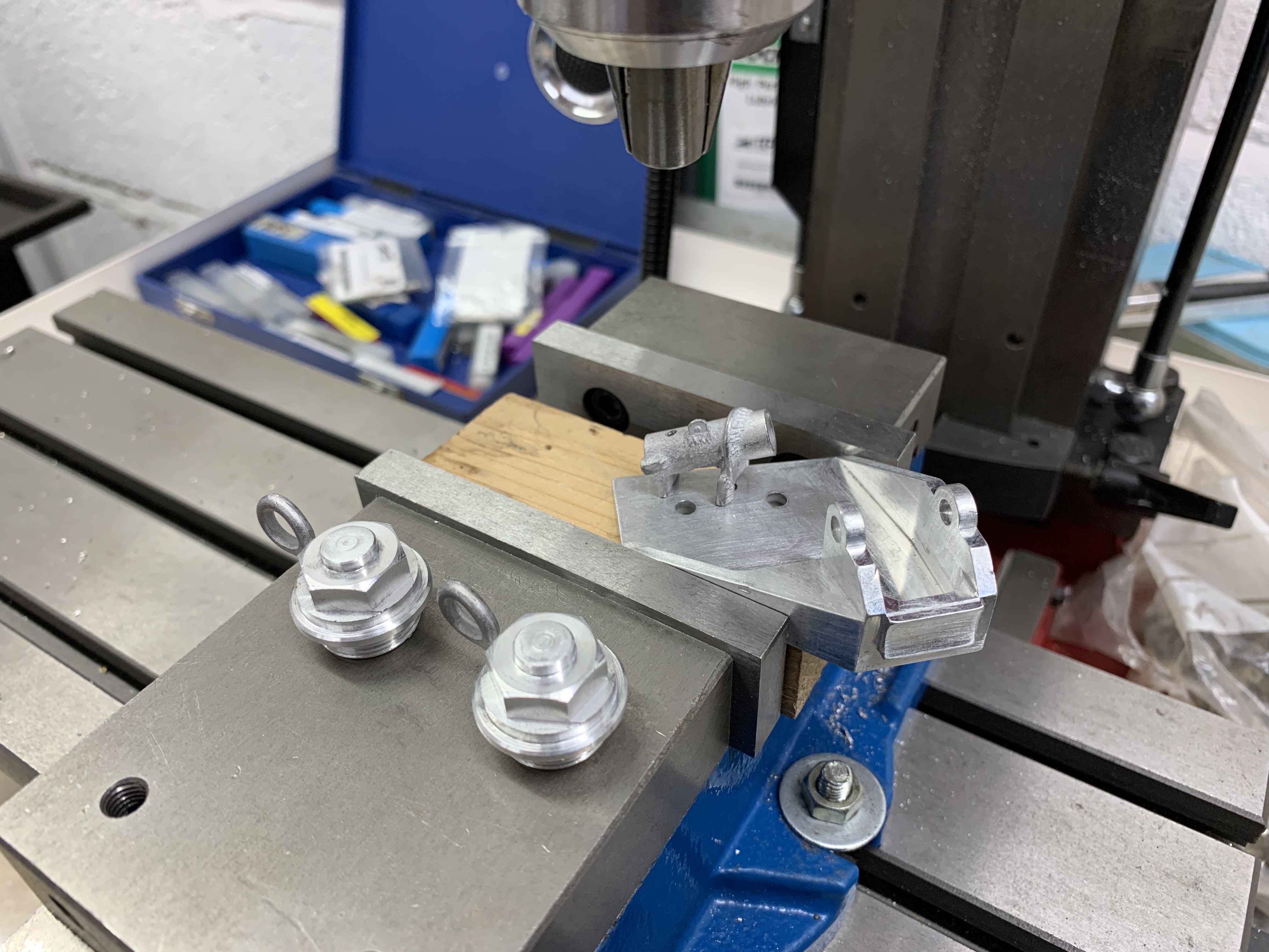

Managed to get a bit more done on the 17 PDR. It took quite a bit of fettling and adjustments using the mill to get the cradle to slide nicely. I kept getting aluminium spools despite spending hours using fine wet and dry to get all the edges curved and surfaces polished. In the end I had to mill the slide and redo the curves.
Next was the cradle nose which needed the holes drilling to locate the Armorpax bling. Very nice....
The trail arms have been sanded to remove any tarnishing and degreased with Upol. I will try and get the holes drilled for all the handles. If anyone has any photos that show the handle/tool holder positions on the trail arms I would love to see them as the ones on the build forum for a walk around appear have vanished.

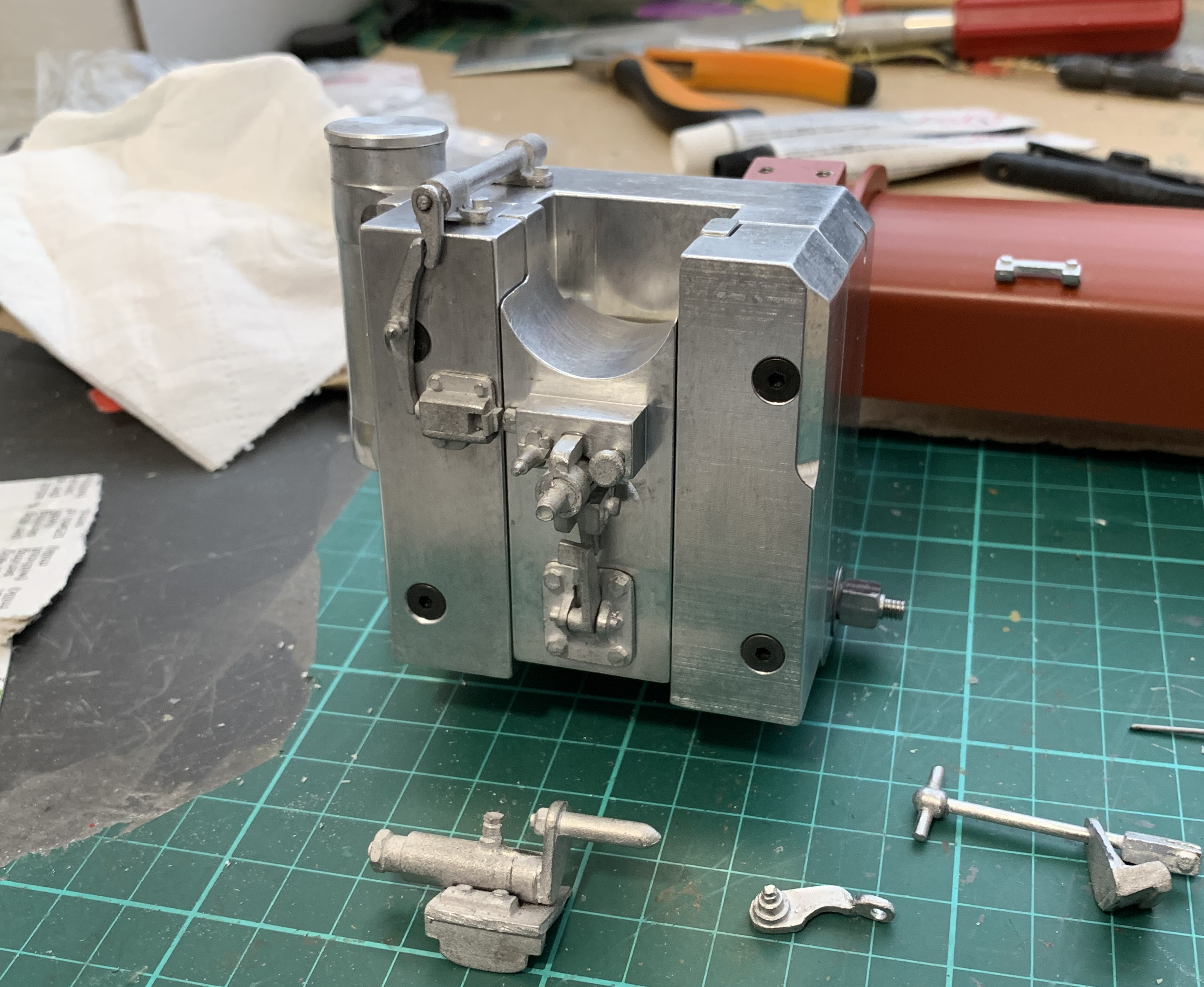

Having finally shaken off a cold I made some progress with the barrel, gun cover and breech. All have been primed and top coated and will have a coat of matt varnish added once the top coat has fully hardened.
The barrel had to be sanded with 800 wet and dry to remove machining marks, it was too long to fit in the lathe so I hand sanded it. It was degreased with Upol and had an acid etch primer added followed by red oxide.
The shield brackets have been cleaned and primed and the front shield has been top coated. I was going to assemble the shields and fix them in place but I have decided to get the trail arms finished first. That will allow me to put the wheels/brake assemblies on and will counter balance the barrel.
